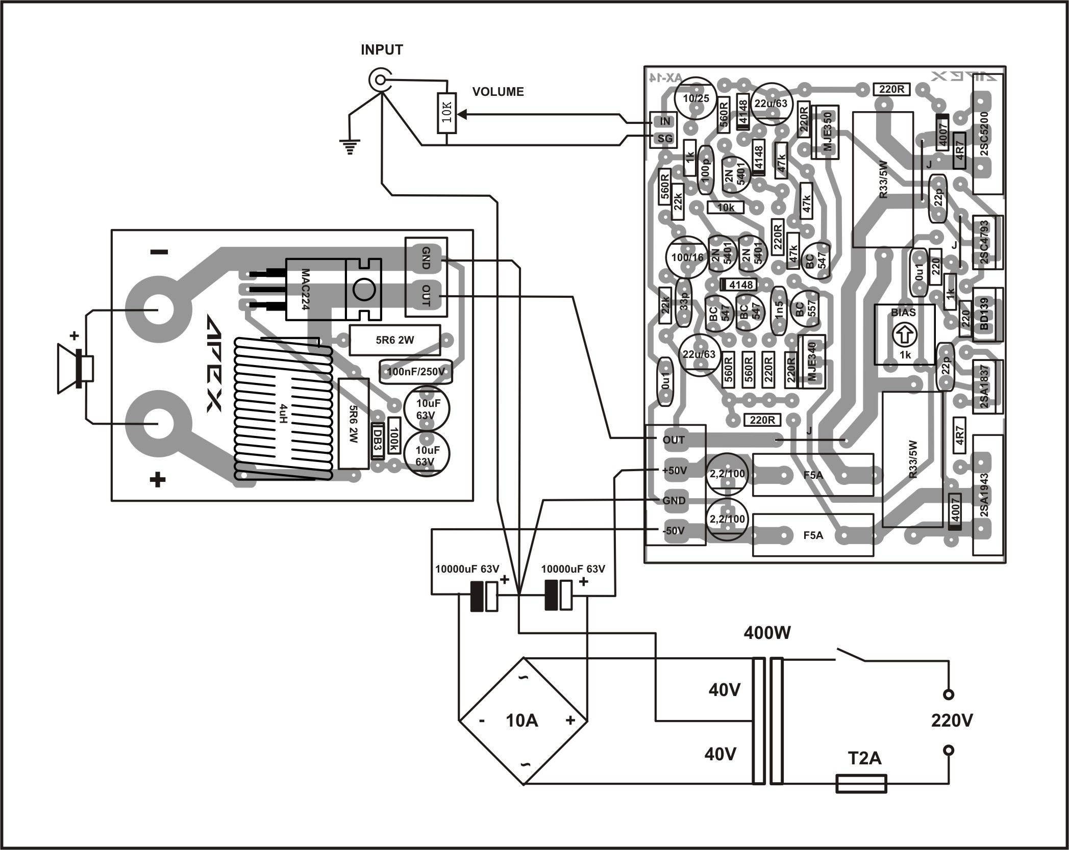

100W Ultimate Fidelity Amplifier
You must add this circuit to AX14 output.
Or add this circuit and wiring as picture

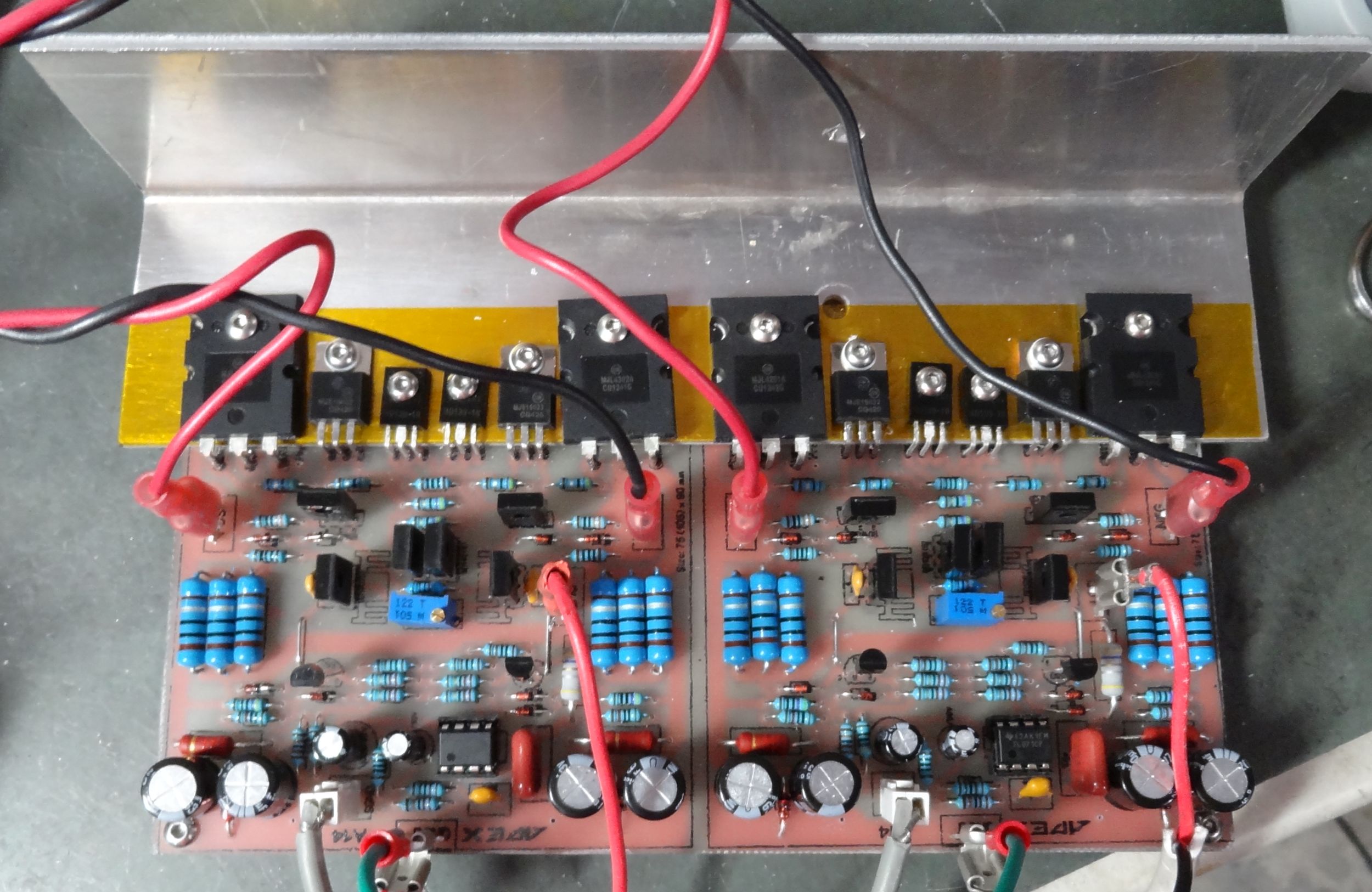

Hi Olaf,
The A14 is singing. I had a little trouble at first until I noticed that the input ground is not attached to anything. I installed a 5R6 resistor from input ground to PGND and all is well. This is quite a nice amp. Square waves are very sharp and the sound is clear with strong bass. Very nice.

Hi Olaf,
Hi Terry, that looks really good.
Separation from SGND and PGND is in some Apex amplifiers. The wiring diagram looks like the AX14 (picture). The resistor is then unnecessary.
Regards Olaf

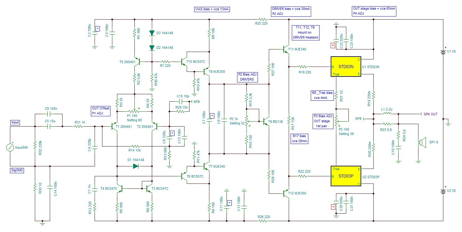

AX14 with STD03 outputs
P-max : 75Wrms / 8R0 @ +/-55VDC
Ao : 28dB
BW (-1dB) : 2,2Hz - 255KHz
Phase : +2,5deg@20Hz
-3,5deg@20KHz
Input voltage noise dens. : 5,5nV/sqrt(Hz)
SN : 107dB
SR : 85V/usec
THD + N (1KHz) : 8,5 E-05 ili cca 0,0001%@1Wrms/8R0
0,002%@10Wrms/8R0
