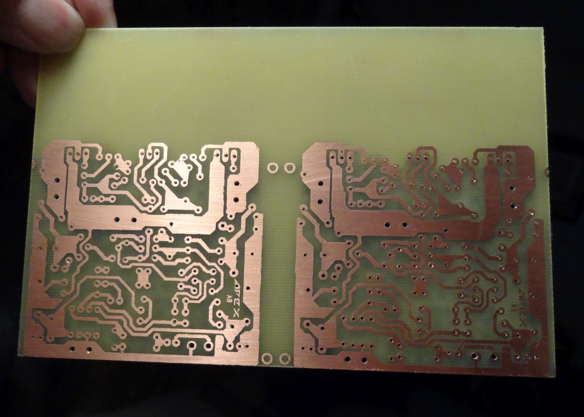

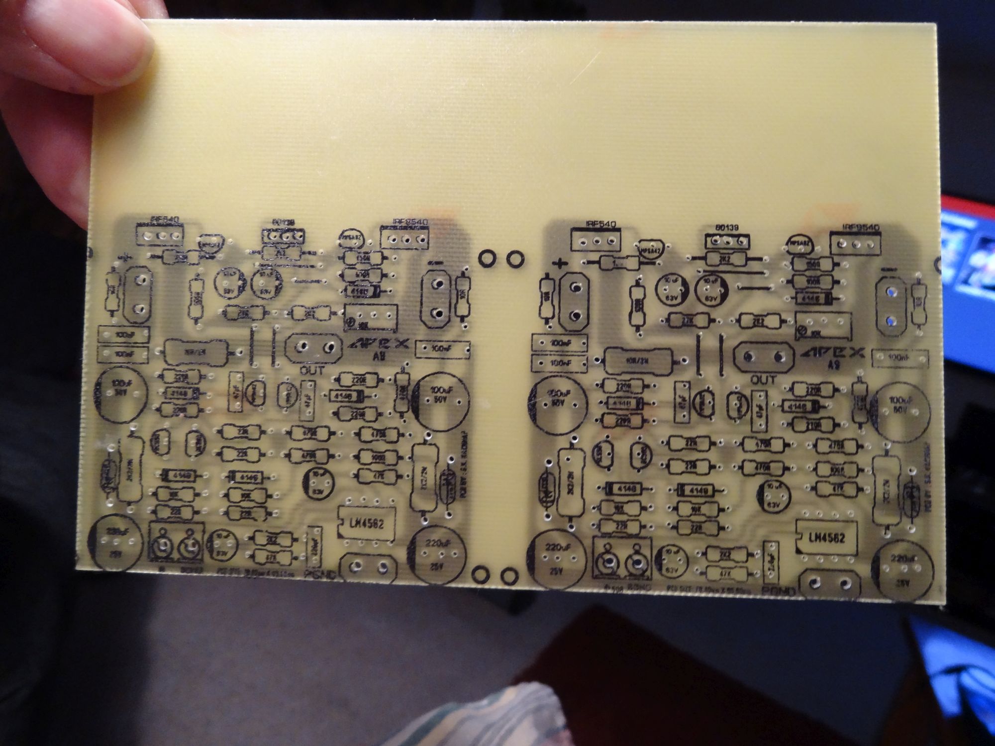

You inspired me. I thought I had built that layout but I dug through all the amps and I don't have one so I etched a pair and will try to get them populated tomorrow. Hopefully this one will measure better.
Blessings, Terry

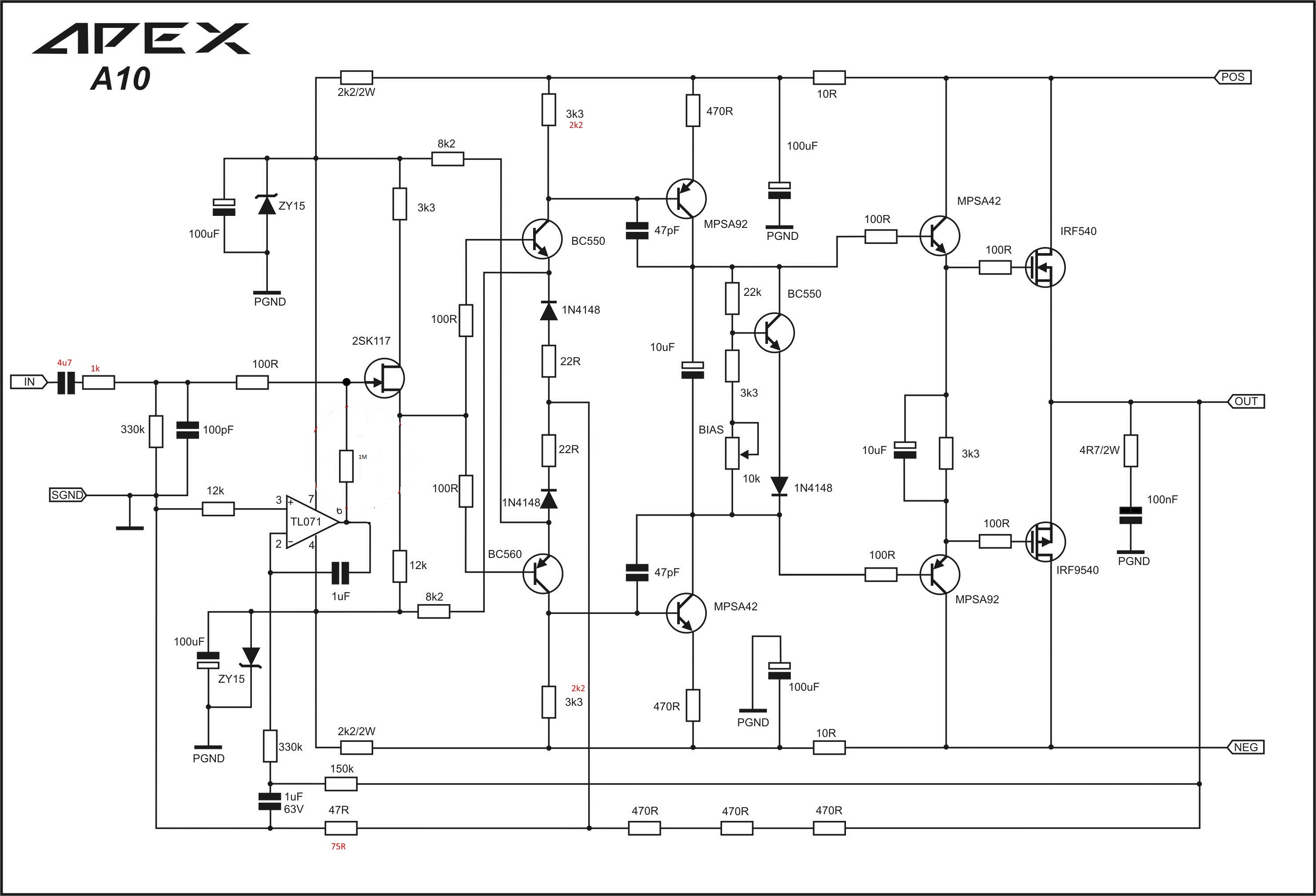

The two amps are hooked up exactly the same way. The scope is attached at the speaker terminals and the sine wave generator is fed into the input. They are different topologies. The A10 is CFA and the opamp only controls the offset. On the A9 the opamp is the front end. The A10 is clearly faster. I haven't hooked them up together on the A/B setup yet because I have been using the same PSU for both. I'm still in bed. I'll do some more testing later.

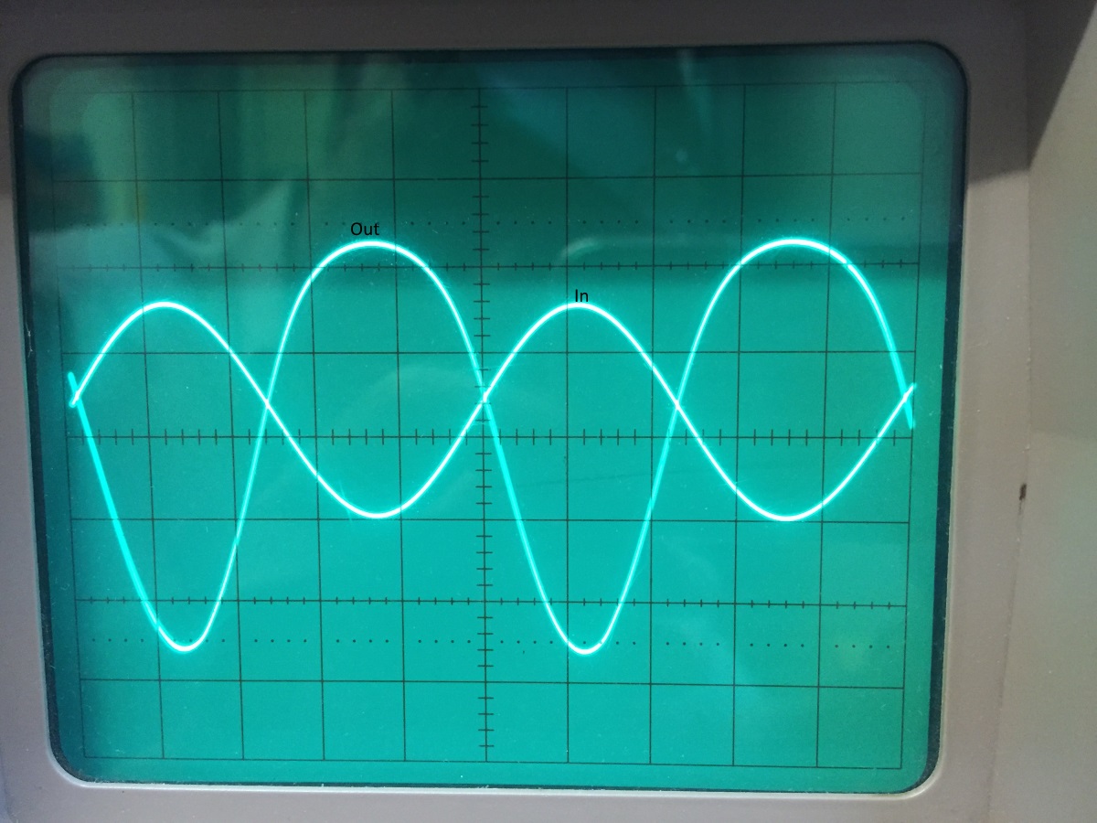

Hi, here are my last results:
At first I measured resistor (8k2 in schematics) with a potentiometer until the offset was 0. The pot I have replaced with 2k2. The sinus was then not symmetrical and signal looked inverted and with music was in the heights a scratching sound (see picture).
Then I tried Terrys variant. I also had to change the gain (47R -> 75R) because the gain fluctuated. The music sounded like the siren of the police 🙂
I will customize the layout with all the changes in the input and the new and old resistors from opamp to gate and source, so anyone can make his own experiments.
I'm not happy with it because I think that the original circuit with the correct dimensioning should also function properly. May be that Mile can give some hints what should be done.
regards Olaf

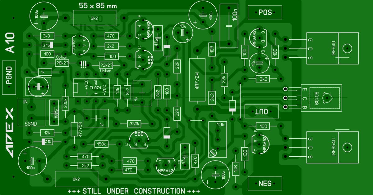

Hi, here is the layout file (Sprint 6.0) and corresponding schematic. If desired, I can make the pdf's.
regards Olaf

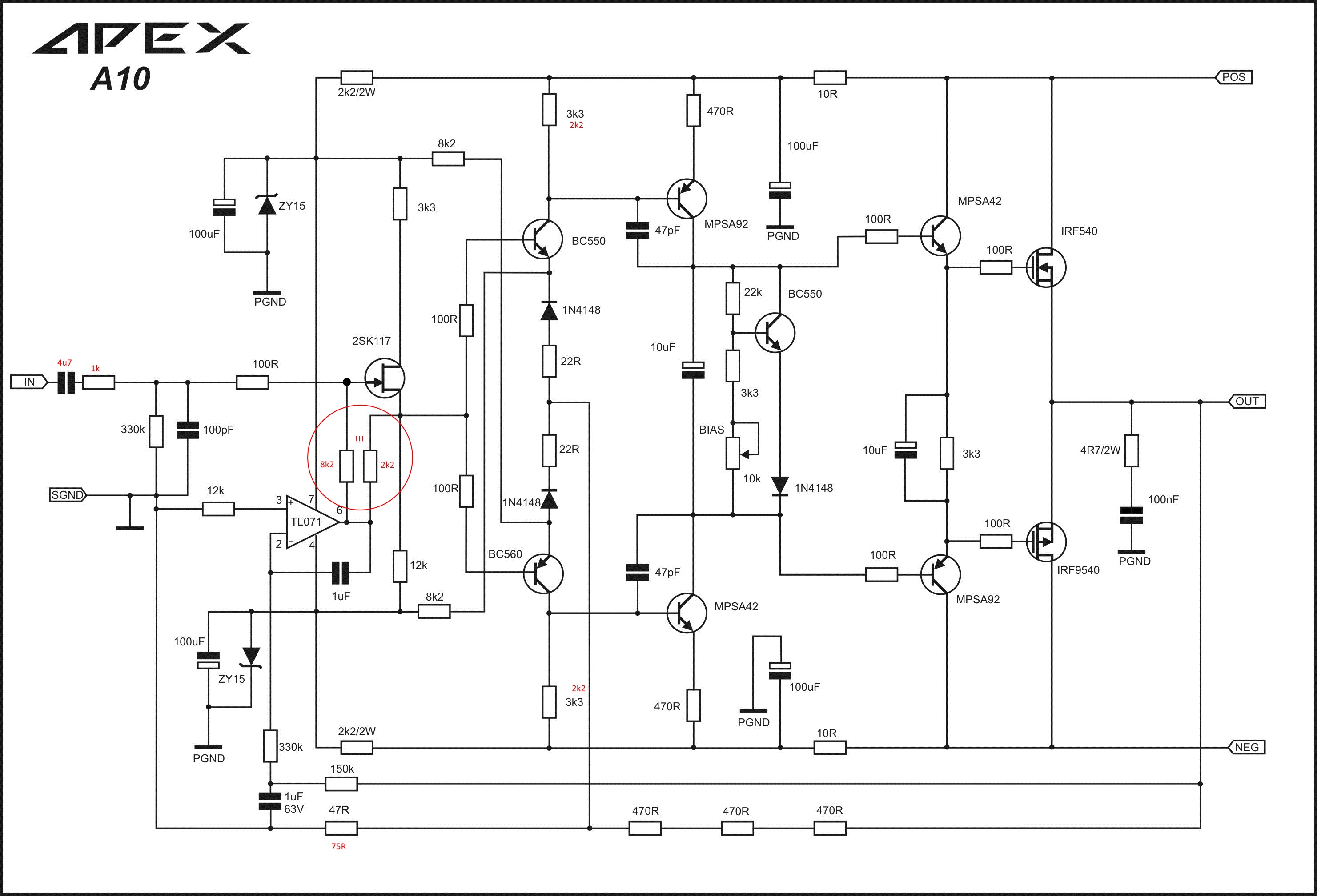

Hi Olaf,
just some remarks for the schematic:
You don't need the 2.2k resistor, if You use the 8.2k. I don't know any practical advantage to send the servo signal to the source of the input stage.
If You use my solution (servo resistor to the gate), and use coupling capacitor (which is mandatory for this version), You can increase the value of this resistor, even up to 1Meg. Using 8.2k to the gate will reduce the input impedance heavily...
IF You use 1M for the servo, You can reduce the value of the coupling capacitor, to 470nF-1uF range.
Sajti

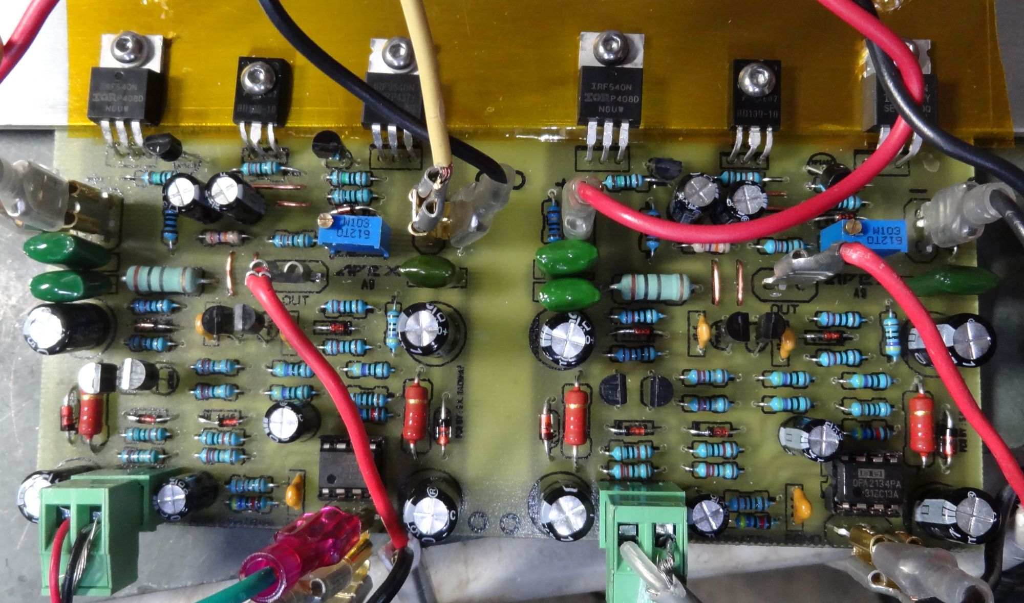

OK, so I finished the latest A9. Very strange little amp. I built both channels side by side using exactly the same parts. One channel plays beautiful crisp square waves and the other channel plays rounded waves similar to the pictures above. The other thing of interest is that I tried OPA2134. They work but they pull the zener down to 8V. One more thing. The channel with the pretty square waves has blown the outputs twice without warning. Something is not quite right. More testing tomorrow.
Blessings, Terry

Reduce the 2k2 2W resistors to 1.5k, it help to set the 15V for the OPA.
Sajti

Hi, I don't use both transistors. It is only for all they want to test both variants. They can choose what resistor they want to install.
What about changing the value of the resistor between opamp and gate? Why is the amplifier pumping or oscillating with higher gain?
regards Olaf

Olaf, your output is showing severe second harmonic distortion. This is typical of single ended as output approaches maximum.
