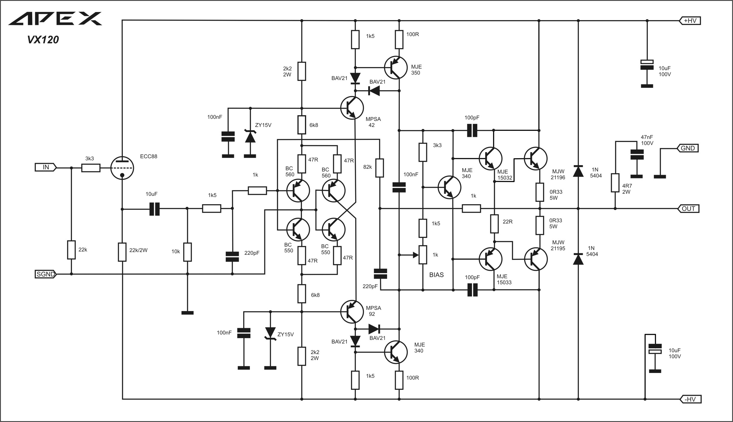

Have you connected input ground to your main (star) ground point? This design requires the input to be configured like this for correct operation.

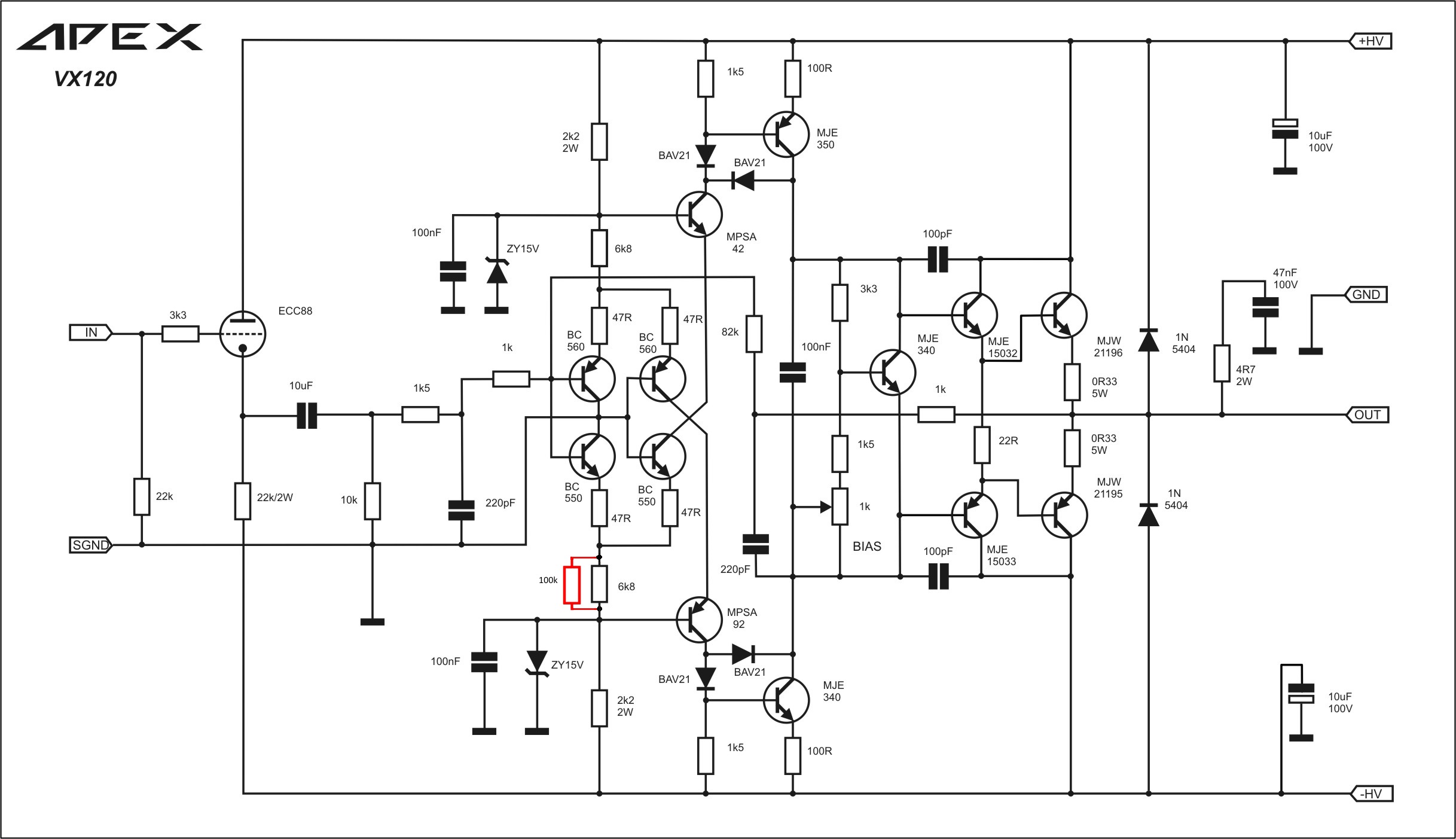

VX120 First Steps

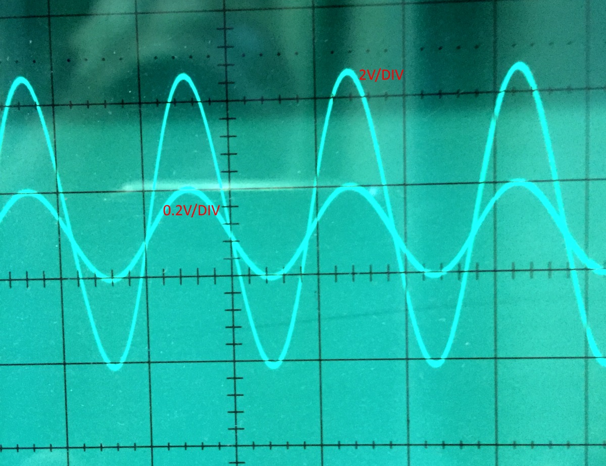

Hi, I started with the VX120 because I wanted to build a hybrid amplifier. The part with the tube I have separated from the amplifier. Comes next. The transistor amplifier running with +- 50V, 40mA bias, sine wave looks good, gain is 30.
Unfortunately, I have -1V offset.
Can anyone give a hint where I start with the adjustment?
Regards Olaf

Yes.Olaf,
Do you have SGND connected to GND?
Sent from my SM-N9005 using Tapatalk
Ok, I installed a 100k resistor parallel with the 6K8 on the negative side. Offset is now -20mV. Fine-tuning later.

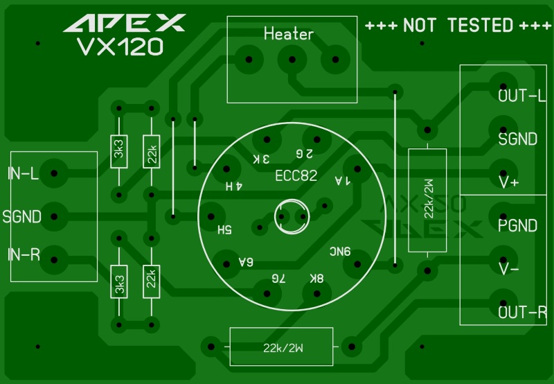

Here is the layout of the tube part. Can be used for 2 channels.
I think that the supply voltage of the amplifier should be very high to provide a suitable anode voltage. Because I currently only have +- 50V (100V for the tube), I'll probably still build a small high-voltage power supply for tests. Was one reason for a separated tube modul.
Every advice and every opinion is really welcome
Regards Olaf

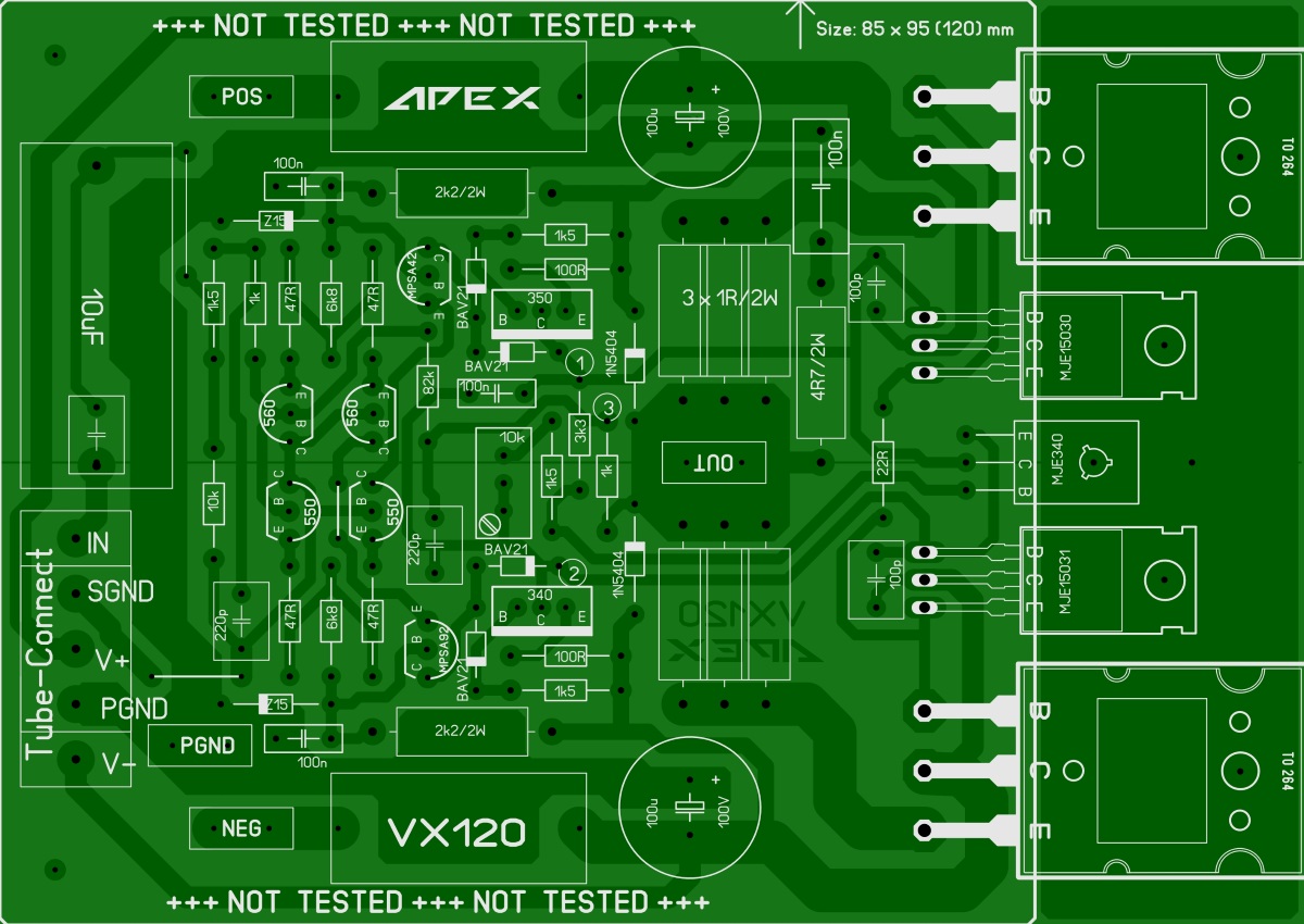

The MJE340 /MJE350 never have an fT specified. I'd use higher frequency drivers - the stabilisation scheme is generally one I concur with but with slow VAS it might not work.
fT of the MJE350 is 10 MHz.
