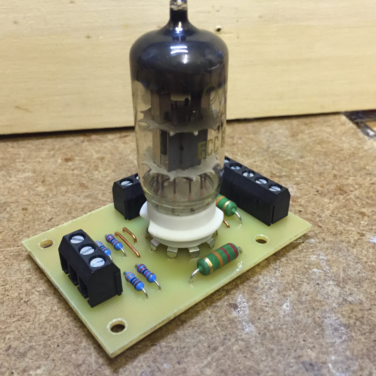

Hi, the first test of the amplifier was quite good. The sound is linear, powerful bass and clear heights. Nothing special to notice. I used only components from the shelf as 2SC5200/2SA1943 and not transistors for higher voltage.
Test module for the tube was soldered only and not tried. It's only a photo to show here. Not enough time 😉
Better would be a ring of solder pads around the tube. They would give more options for measuring and other components...

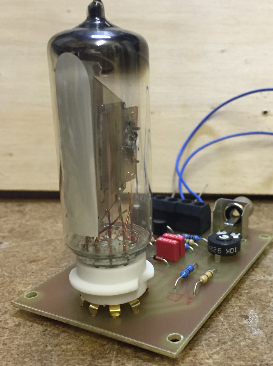

I found a old Tube-VU. For each channel it can give a nice looking amplifier at the end.

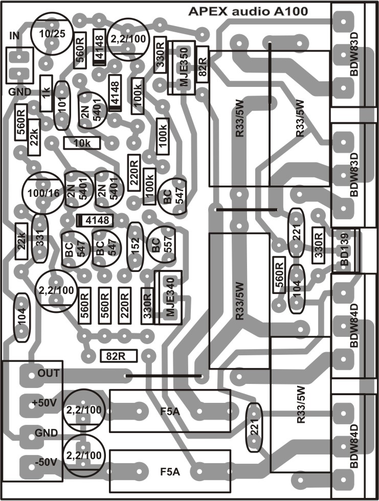

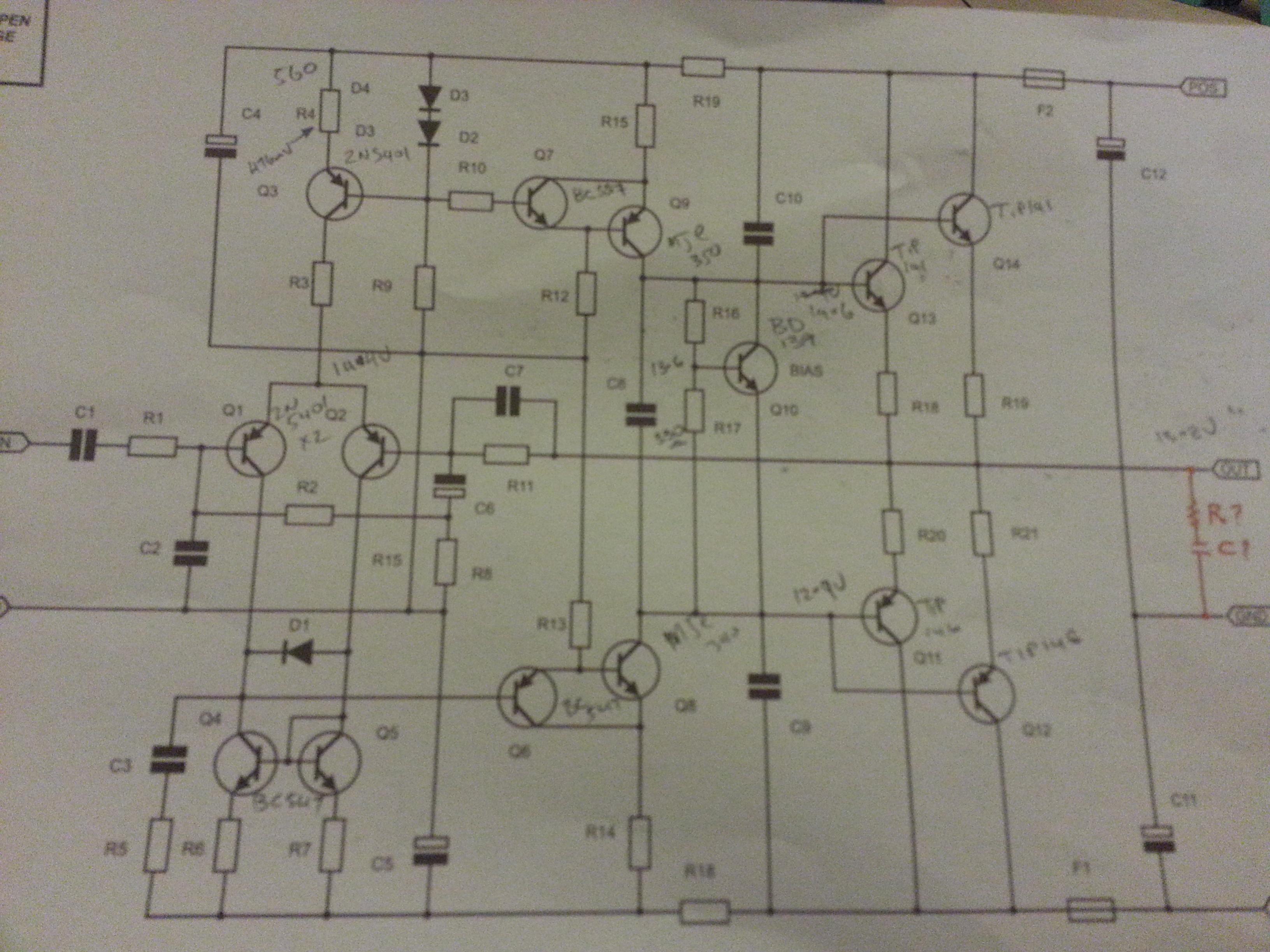

Junction between R12 and R13 should be ground?
Darlingtons are notorious for difficult quiescent current setting. Need to have an adjustable bias, and often higher emitter resistors than usual (1 ohm?). I suspect that the bias was too high, and as the Darlingtons also have poor second breakdown characteristics (derating from 35V) that they may have smoked if the quiescent current was too high.
The MJE340 /MJE350 never have an fT specified. I'd use higher frequency drivers - the stabilisation scheme is generally one I concur with but with slow VAS it might not work.
John.
No Ground between R12 and R13, these are 100K. I lost two output transistors now they are DC. dead short across BE on the TIP146. Im not sure I want to change the transistors at this stage except maybe the outputs, mostly as I don't have any replacements at this stage. Having said that, maybe I get some more suitable outputs for 45V rails. Are the BDW83D and BDW84D readily available? I might ask in the swapmeet.
Do you have any suggestions for the VAS and drivers?
Hello, can some one please confirm that the foil I have and schematic for the D14 darlington version of this amp is correct? I don't want to start buying parts for something that wont work. Thanks.

Hi James, I did not, I just checked it and its not grounded on the PCB. Strange, I have never seen this before. Is it possible that has caused the thing to go into meltdown?

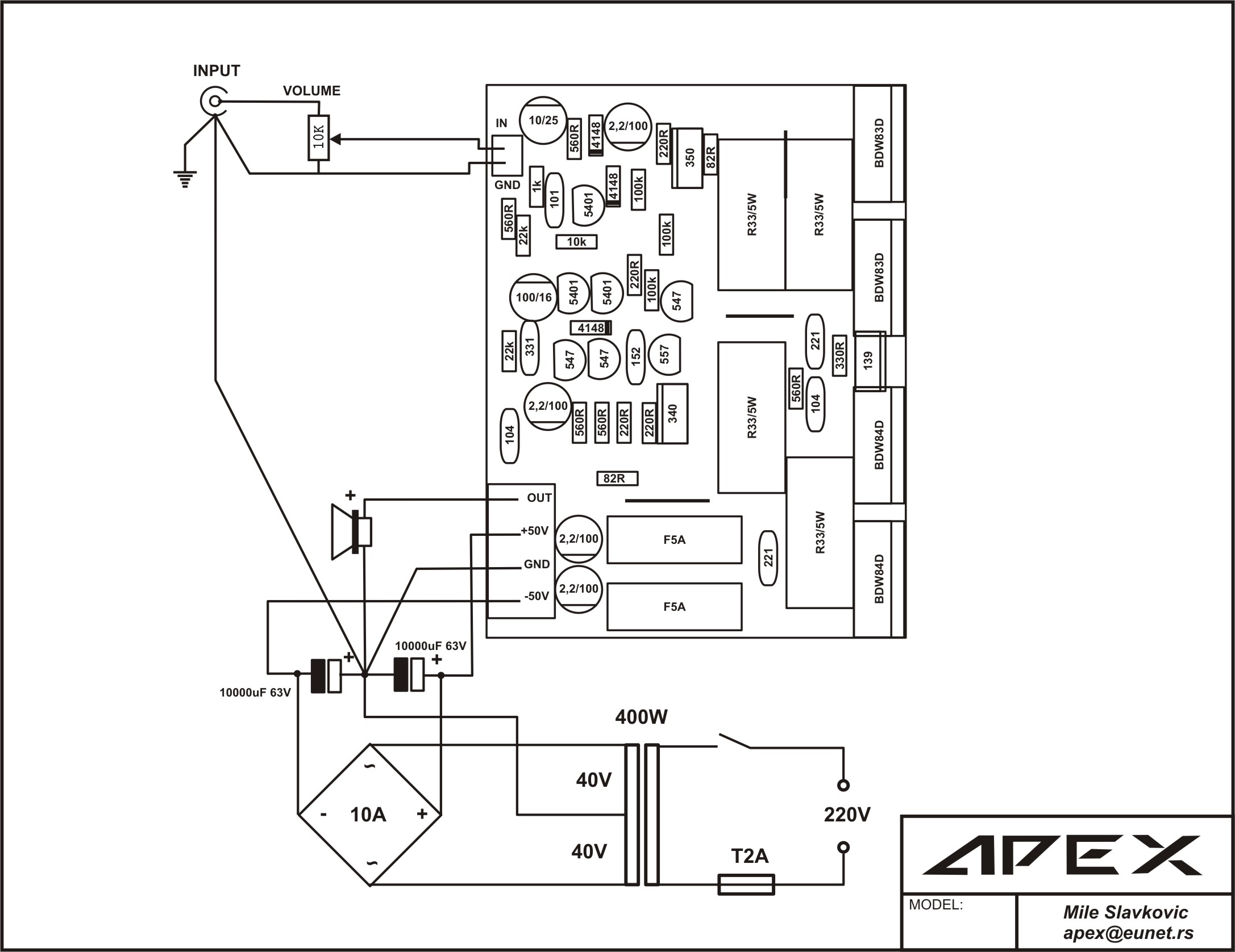

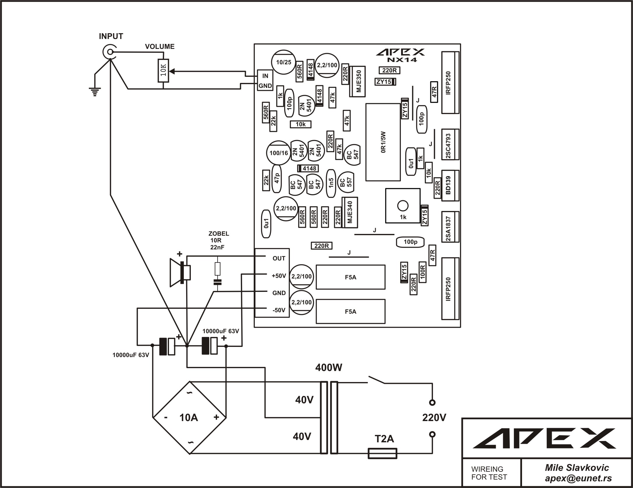

Hope connection diagram will help you. NX-14, AX-14, D-14 etc are connected same way.
I have made this amp for subwoofer duty.
Sonal

Excellent, thanks all for your help, I may get a new set of outputs and use the resistors, instead of fuses as suggested. Anyone got any suggestions on what I should use for the darlingtons, the ones speced here or are there better ones? I never used darlingtons before. For one thing I need better voltage tolerance than what I have for 45V rails. The BDW83D and BDW84D 120Vceo are better suited to what I have any way.
Use resistors to check amp, if it's working properly replace them back with fuse.
10-22 ohm resistor will do the job.

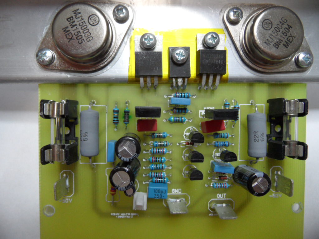

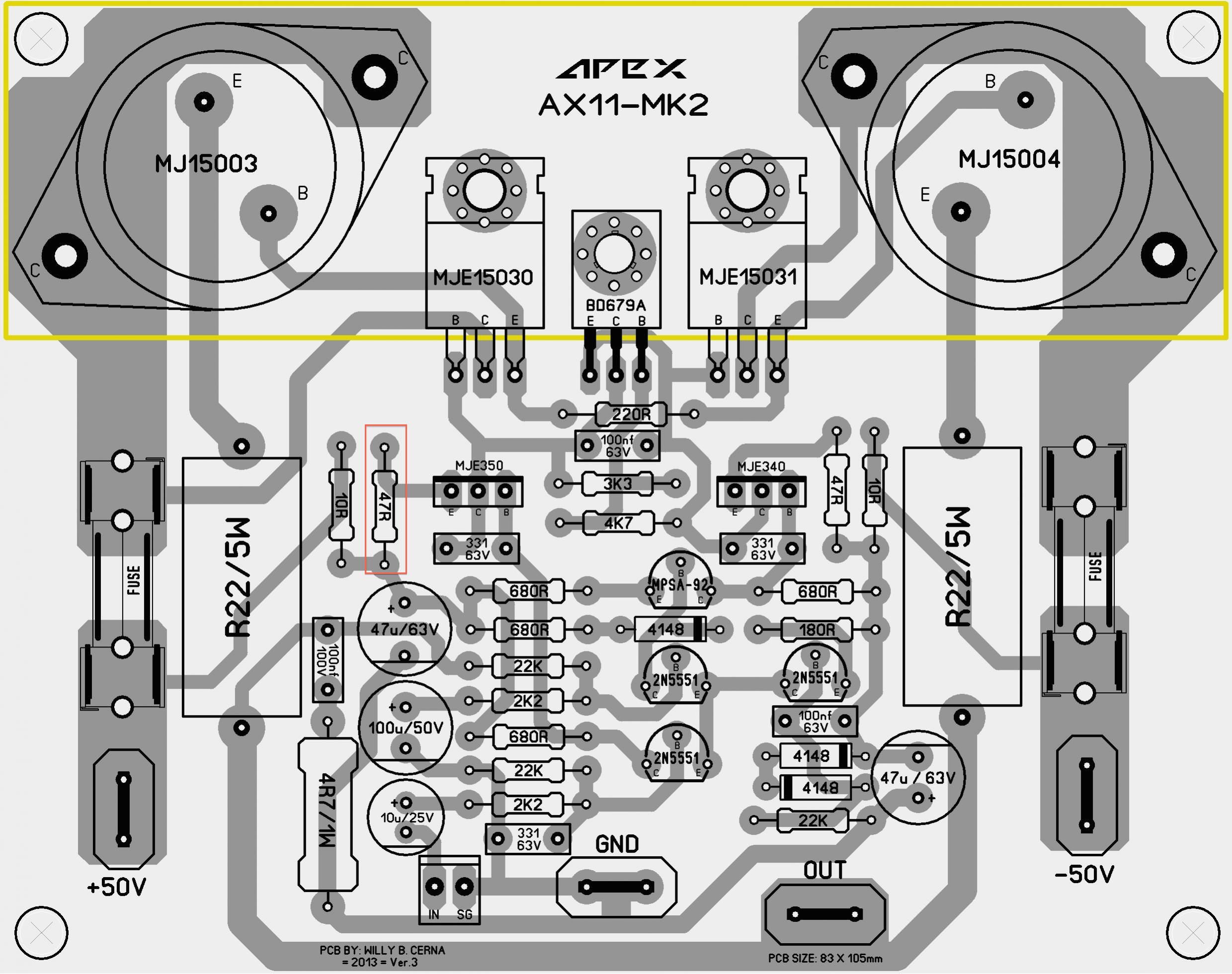

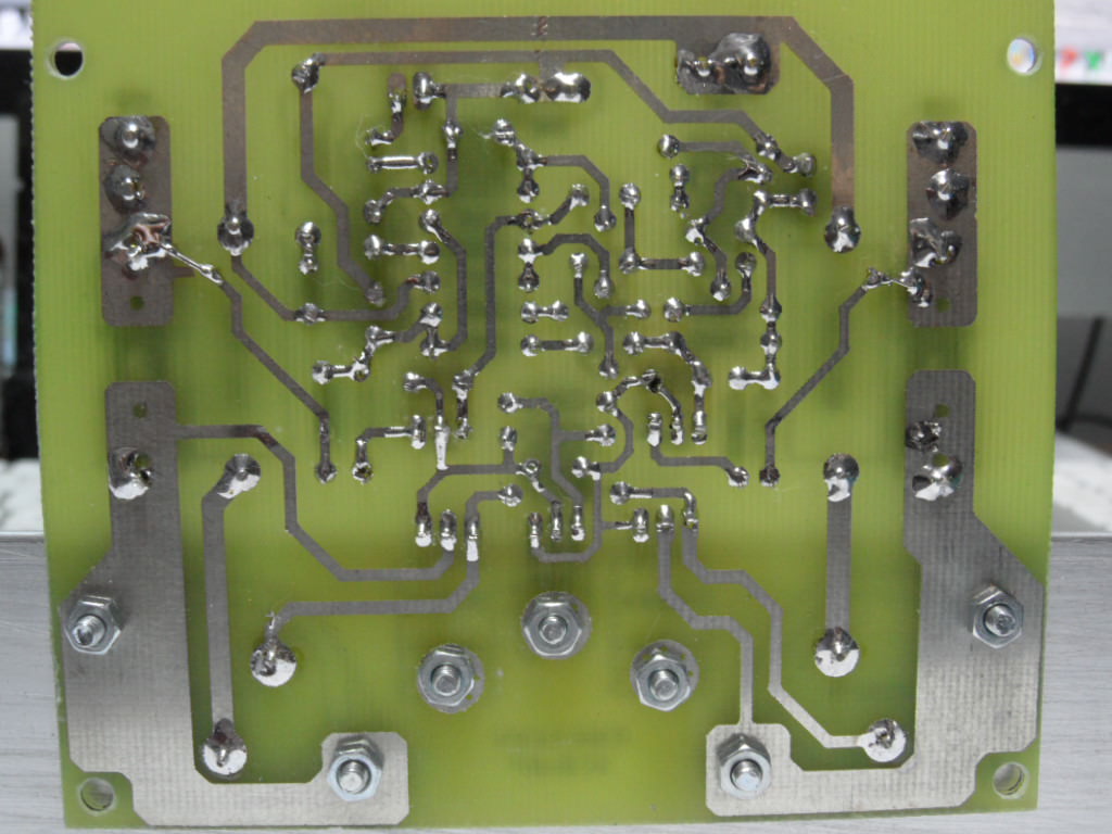

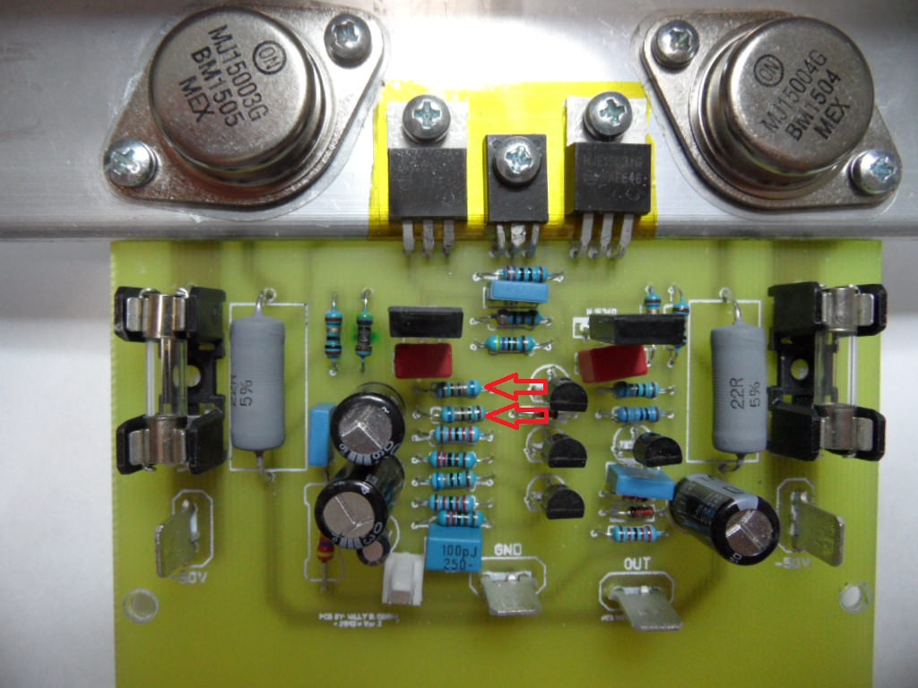

Can anyone help me with this. The 47R resistor outlined in Red Burns up Instantly upon power up. I am using +- 44V rails with 10R/5W resistors in each rail and .5a fuses. I have checked all of the other Transistors & all Test OK.

Terry, The MJE350 Tested good, but i replaced it anyway with a new one. Same results. Can't find any Solder bridges. See if you see anything wrong here. I had cut the 2 traces to put the fuses in front of the +-44V that feed those 10R 47R combo. I fixed the cut traces, as the fuse still didn't blow.

Hi Rick,
I don't see any solder bridges. However, It looks like you have two more burnt resistors, see attached. I see you have Kapton tape installed but have you done a continuity test between all the the transistors and the heatsink? I sure acts like there is a short somewhere.

Hi Terry,
Both those 680R resistors were ok.Measured 674R & 679R. I replaced them anyway.
Also i went over the GND again. NOTHING from the Heatsink to ANYTHING. Also went from GND Tab to everything and only those parts that connect to the GND had continuity. This is Really WEIRD! Don't know if anybody else has built this to see if it works. I am WAY out of my element here. Thanks for looking it over & helping out. Think i will just move on to something else for now. I have built the AX11 Standard one & it sings Sweetly. I had hoped this one would be the same but with more Grunt.

This likely isn't your issue but it looks like you have 22 ohm(22R) emitter resistors instead of .22 ohm(R22).
