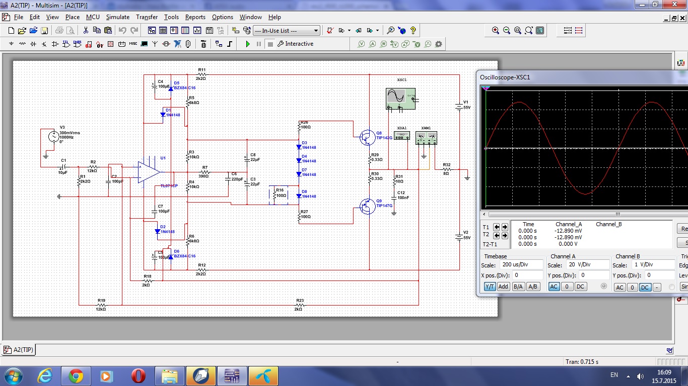

100W with OP and 2 outputs... just for fun.
You have my attention. Layout? 😀
