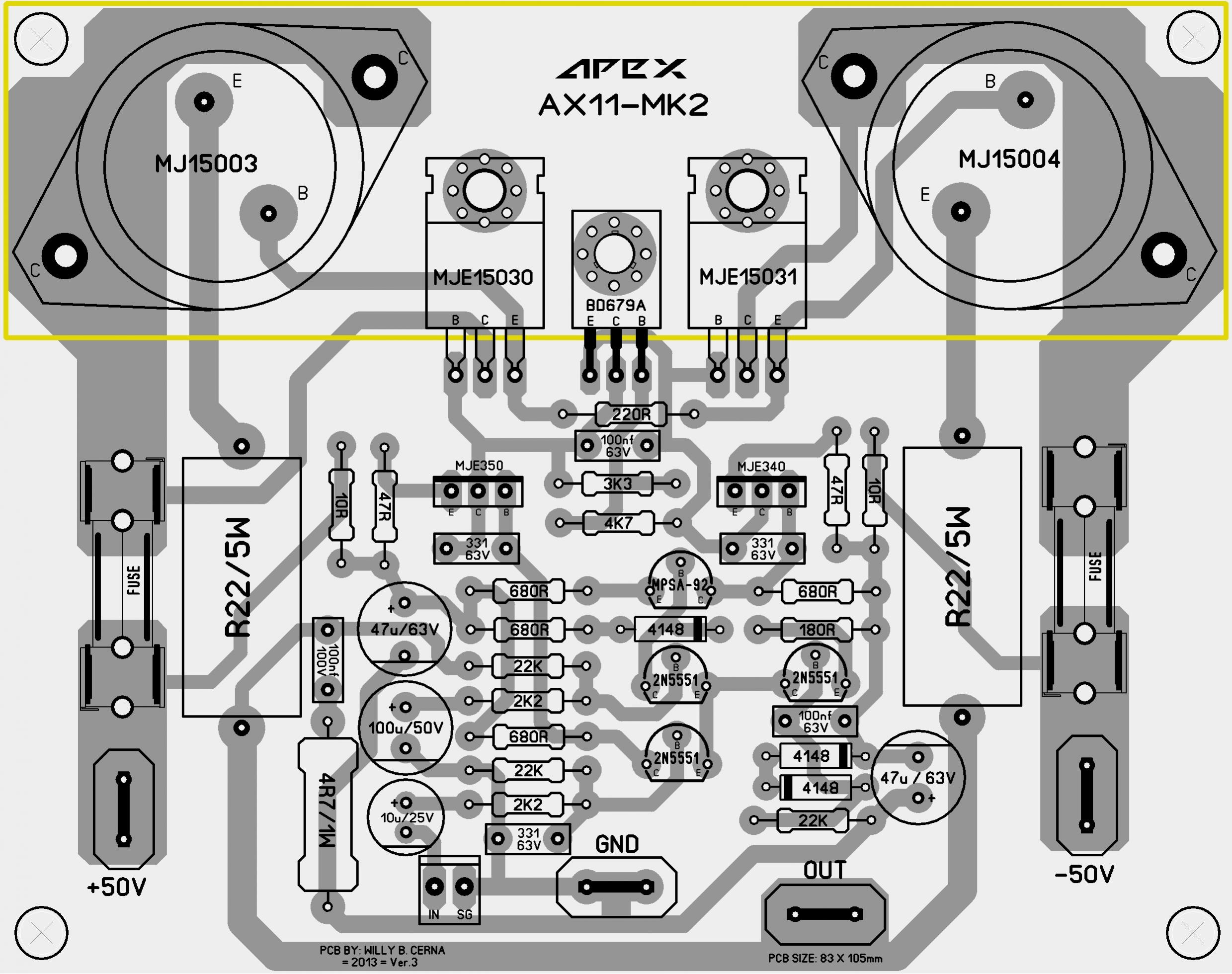

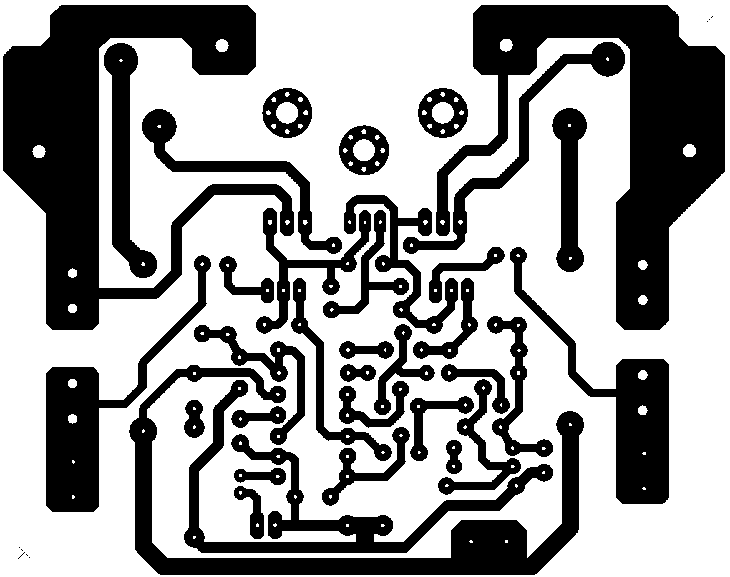

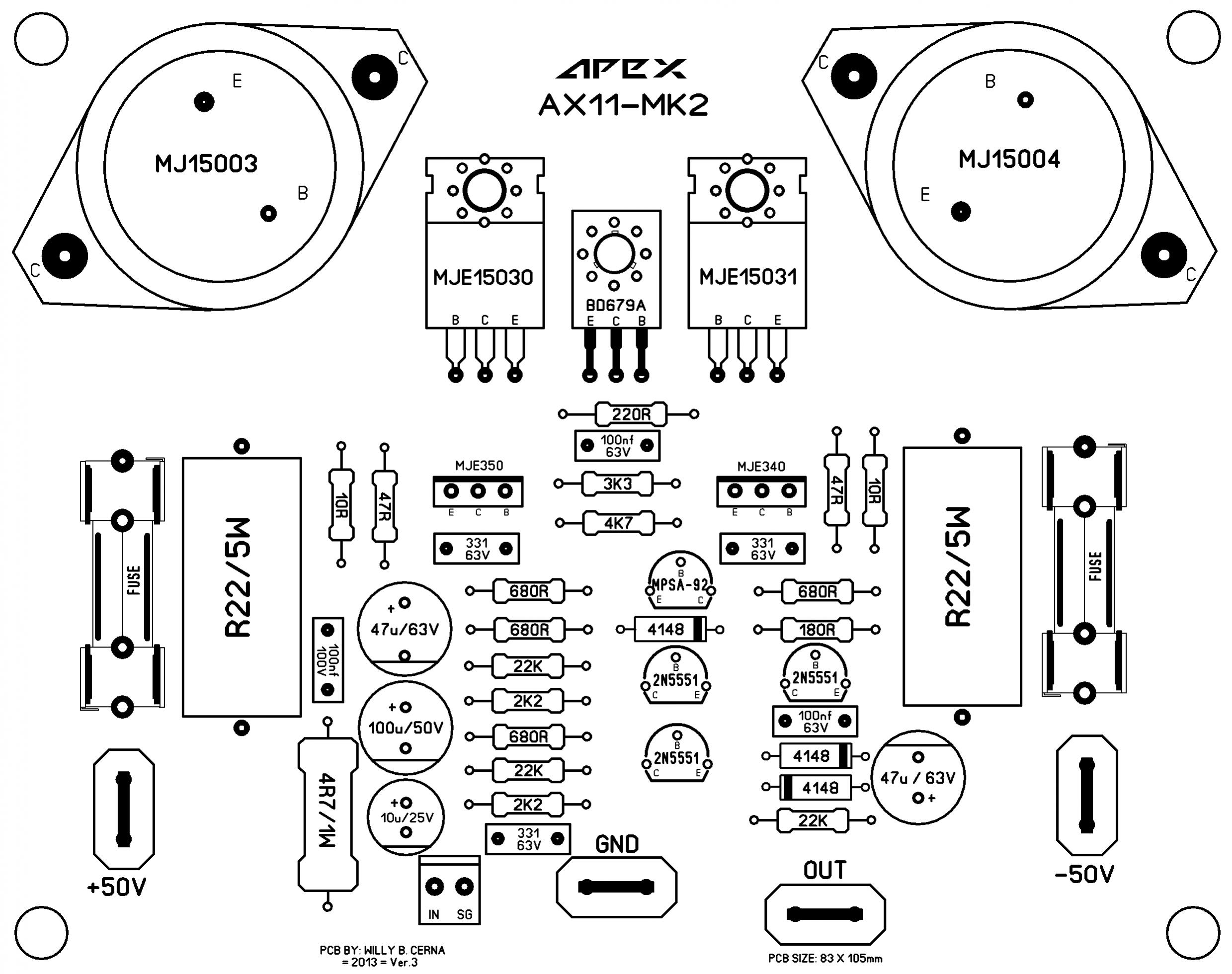

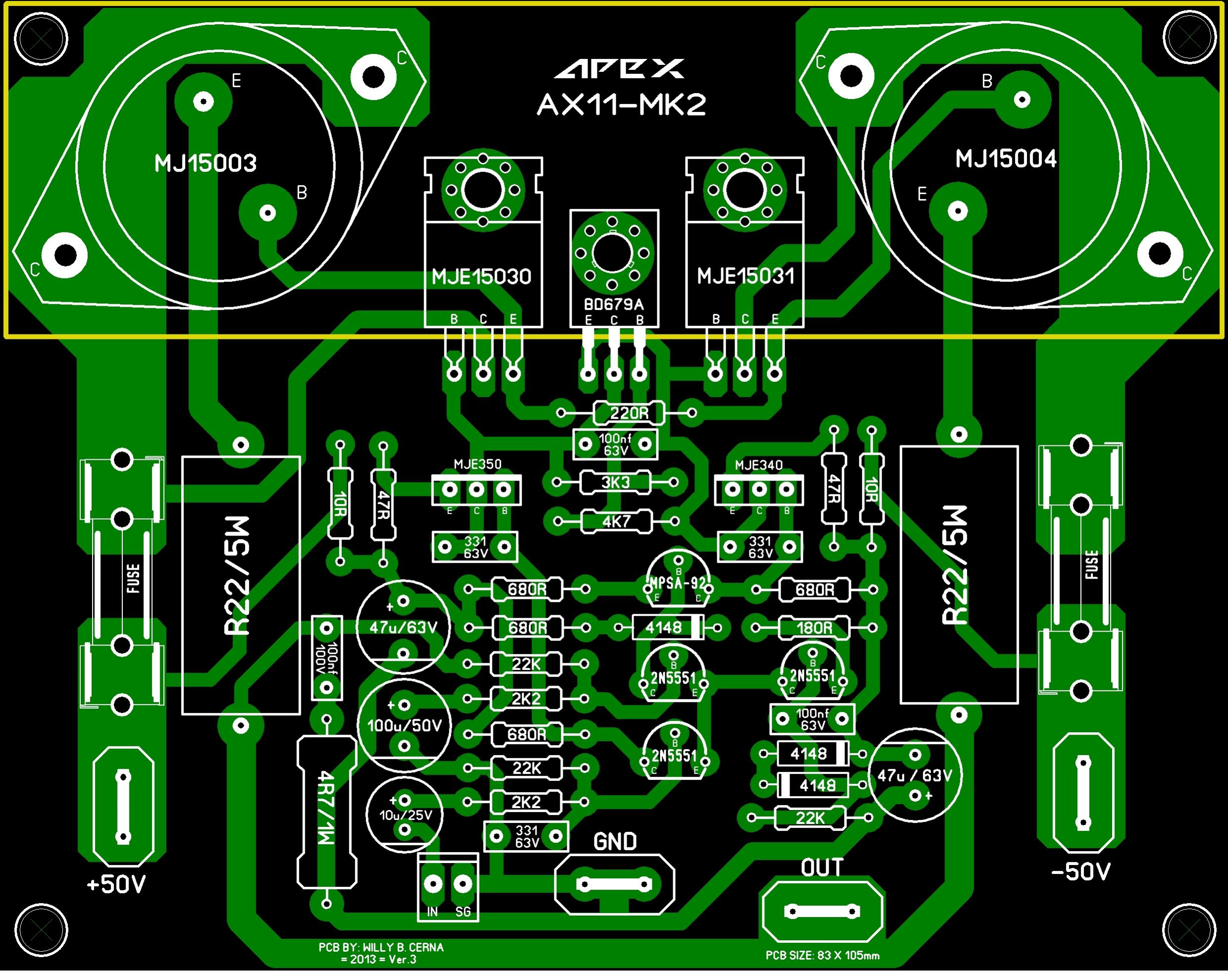

Hi Willy,
Can you send me the corrected copy including the PCB. I have 2 pairs of MJ15024 & MJ15025.
Thanks.
Rey
Hi Rey,
Here it is.....
  • APEX AX11-MK2 PCB.pdf

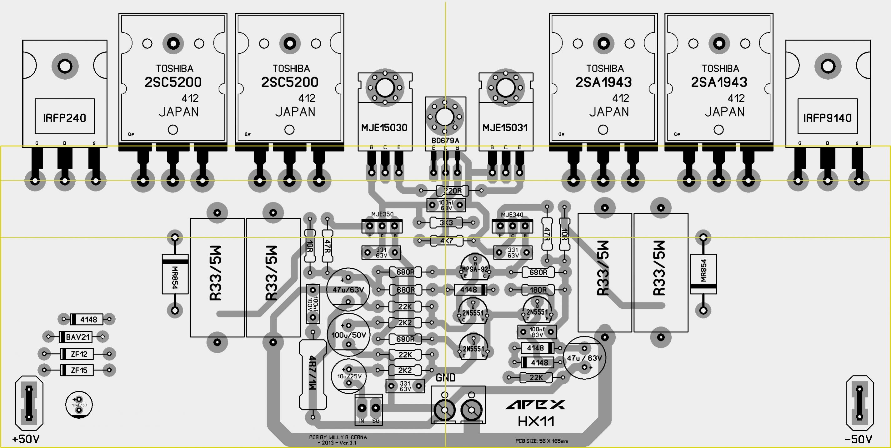

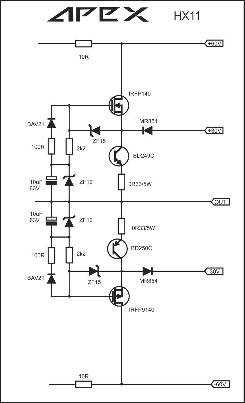

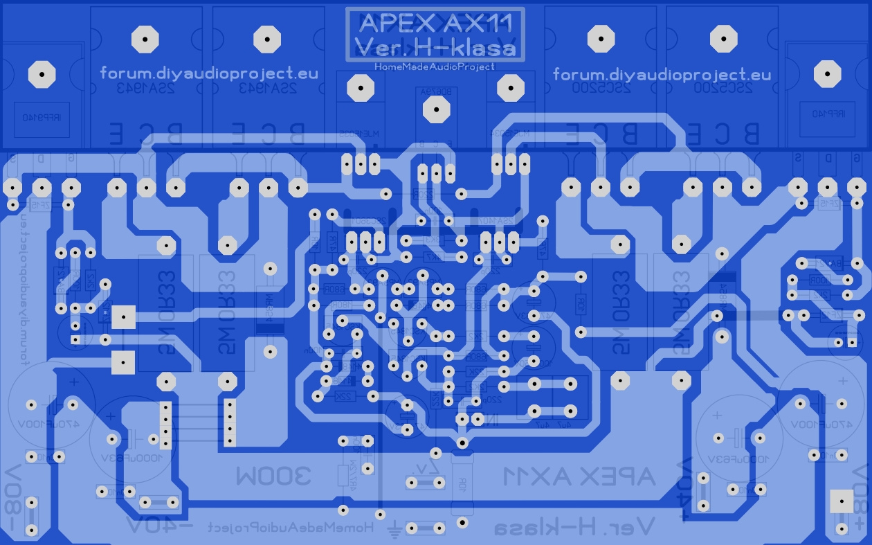

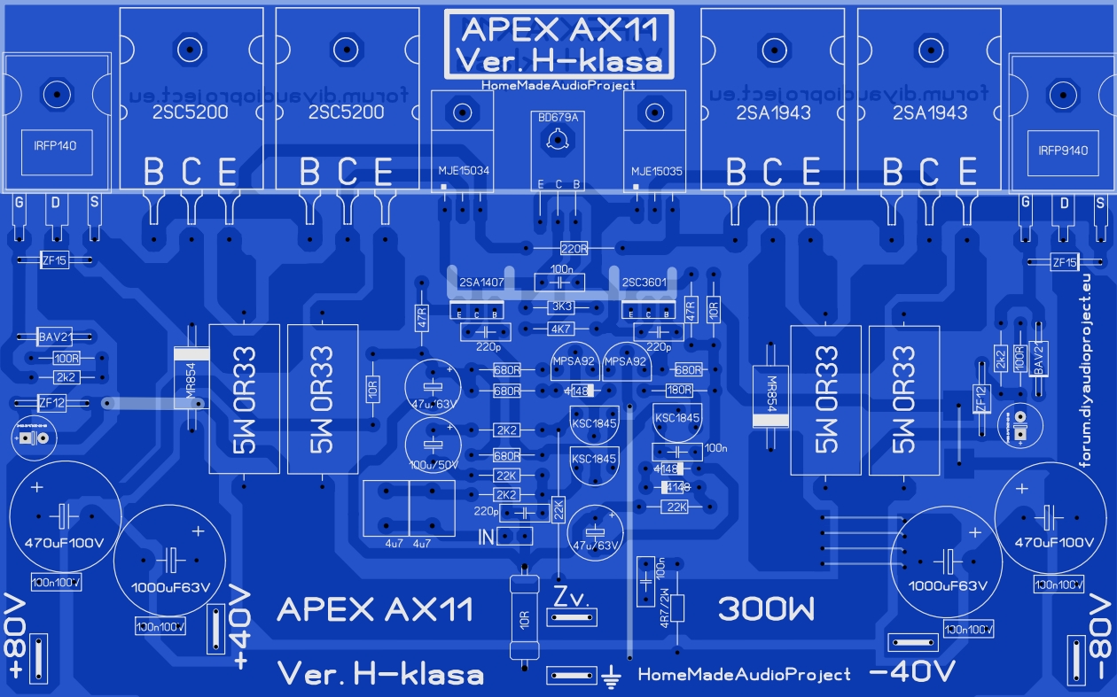

AX amplifiers can work in class H, just add this circuit 🙂
This looks interesting small class H amp Mr. Mile.
Will this stay in the same thread?
FYI work in progress...😉 but will continue tommorow as it's getting late now and have to wake up early tommorow for work.
Have a great weekend to all...
I suggest to use single pair of outputs 2SC5200/2SA1943 no need for two pairs, and step transistors can be TO220 like IRF4905/IRF3205 or IRF540/IRF9540.
You have some about simple classH amp H100 in thread:
http://www.diyaudio.com/forums/solid-state/162081-dc-servo-mosfet-amplifier-6.html
Regards
