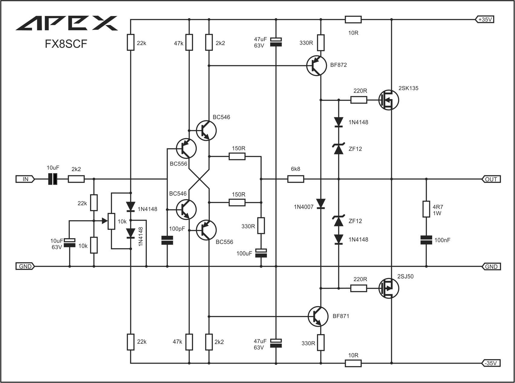

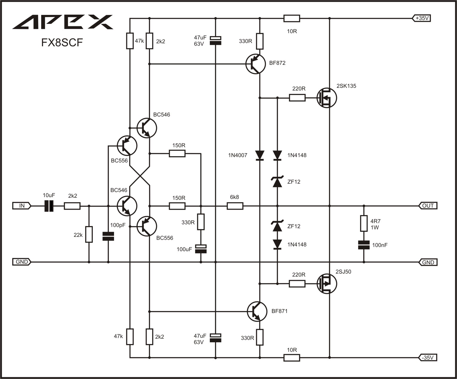

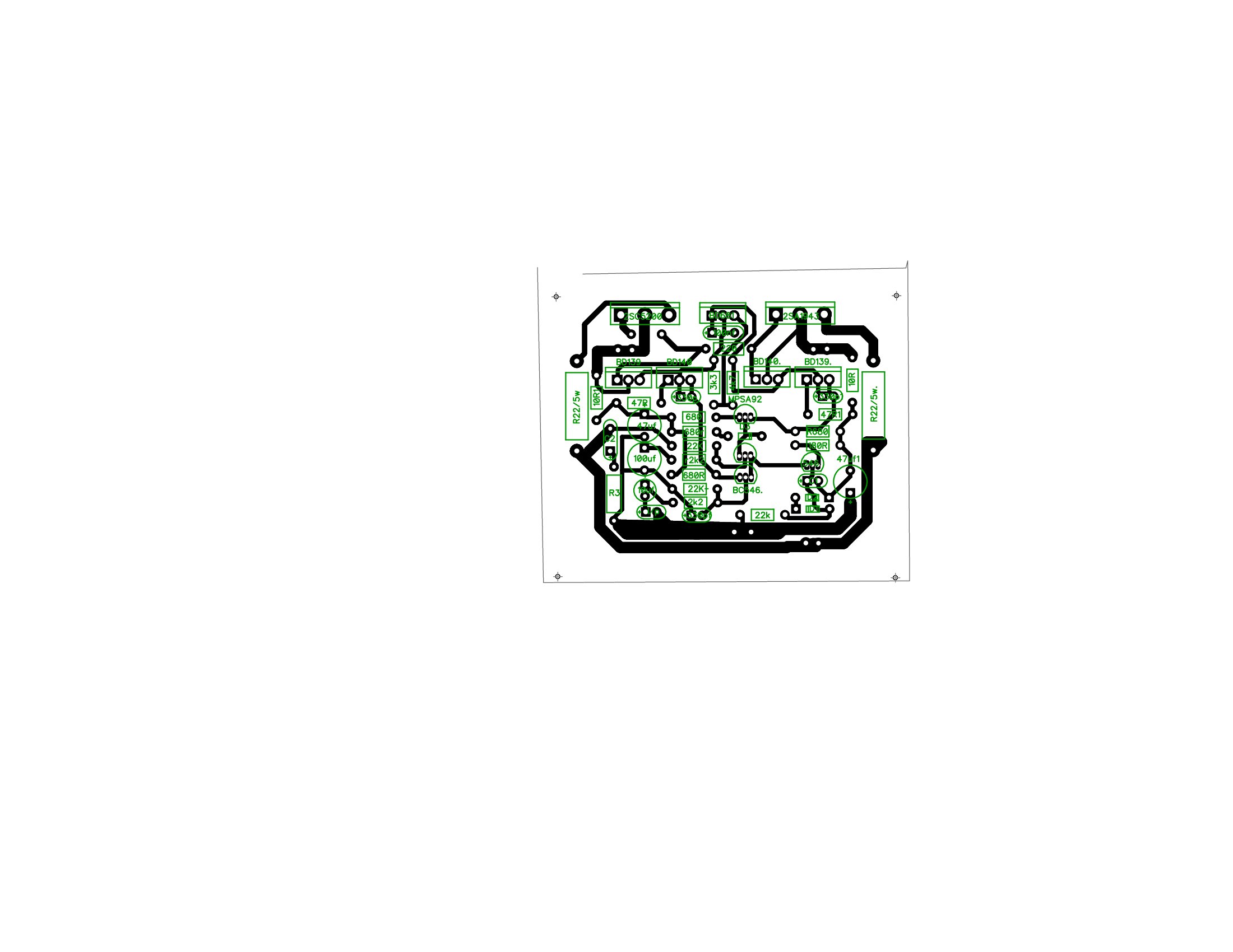

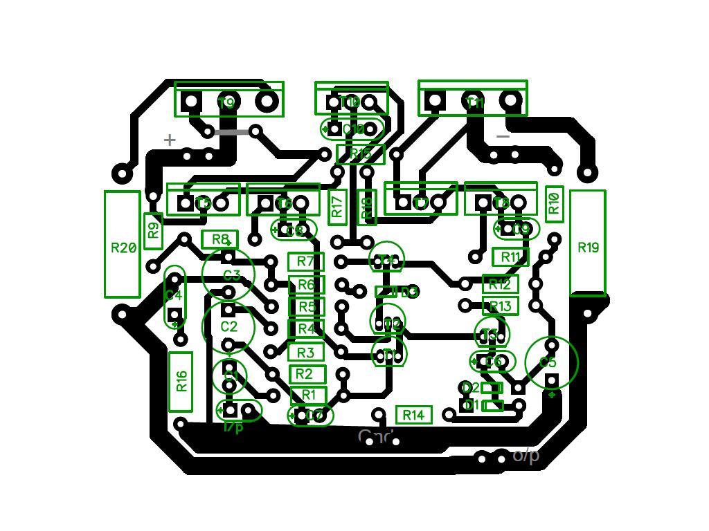

100W Ultimate Fidelity Amplifier
is any tracking is missing sir....
