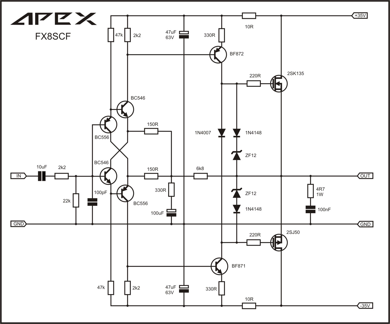

hi, could input be used as line buffer ?

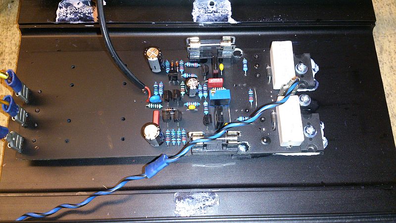

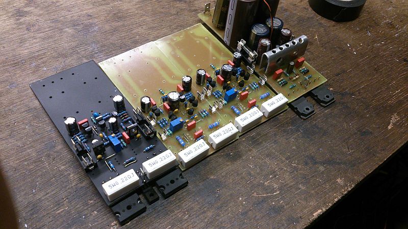

Thanks for ax14 amp. I have just finished in 80% one channel (big caps missing) and must say this is an excellent amplifier!!
I just plugged it in seted bias 120mA and voila. The amp have hard competition (symasym and vssa) but I can say that all of them are equally good.
Small question, I didnt have 22uF caps so putted 100uF instead, and in vas didnt have 100pF so putted 33pF. So far I have no zobel and amp seems to be stable, can I leave it as it is ??
Bass is superb

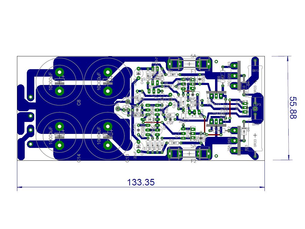

Nice work, 100uF and 33pF is OK.
Can you share your AX14 PCB design?
