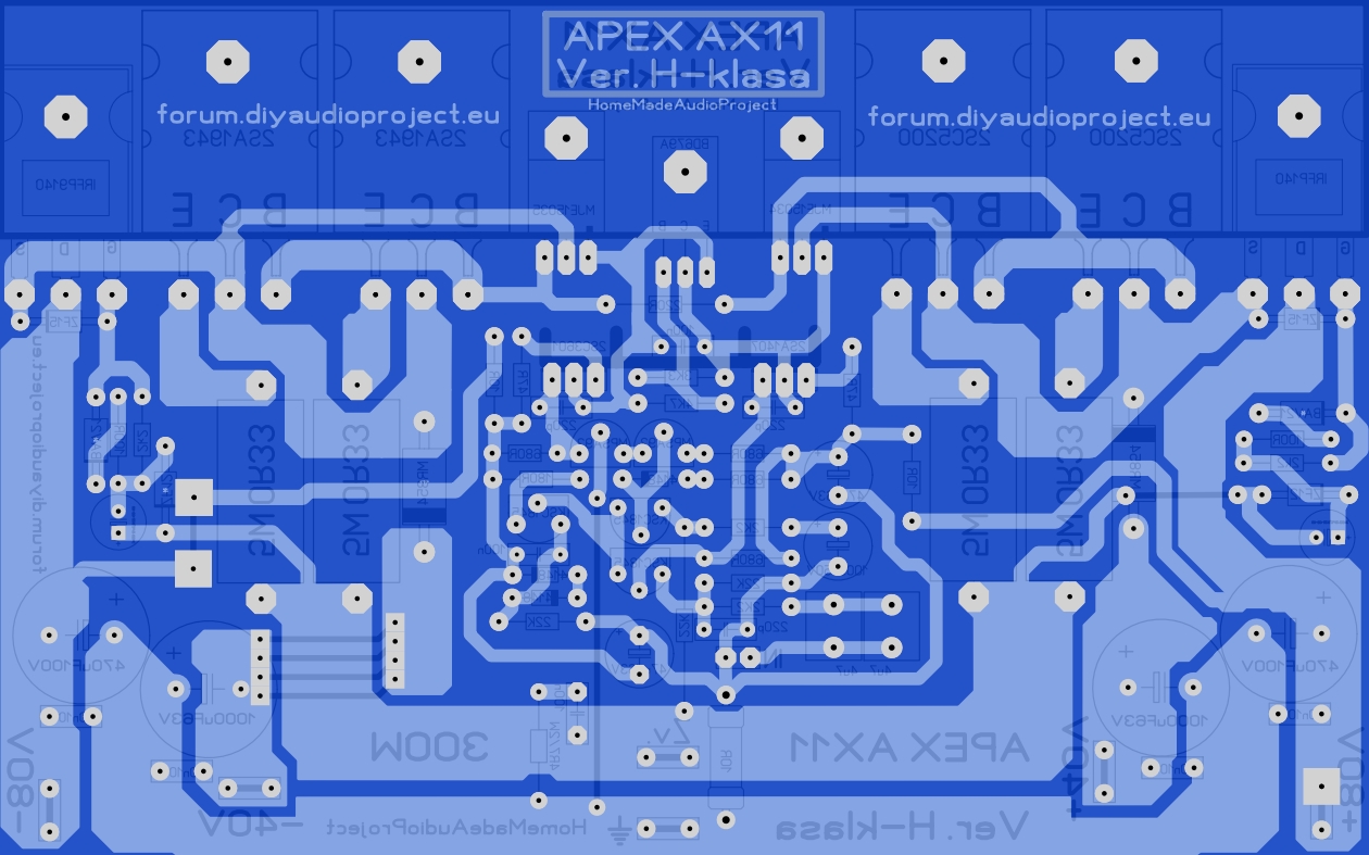

euro-format pcb 160 x 100mm:
Nice work, is it tested, can you post schematic? 🙂
Regards
.Nice work, is it tested, can you post schematic? 🙂
Regards
i have checked it visualy for a few times and haven't found any mistakes, if anyone finds some please let me know. the input-voltage stage is done by Dude's layout wich was based on wiljj78's pcb,that part was tested in to3 version only i aded one MPSA transistor as suggested. i believe that Dude will be the first to test it and i'm sure that he will share video,pictures,impresions and some measurments.

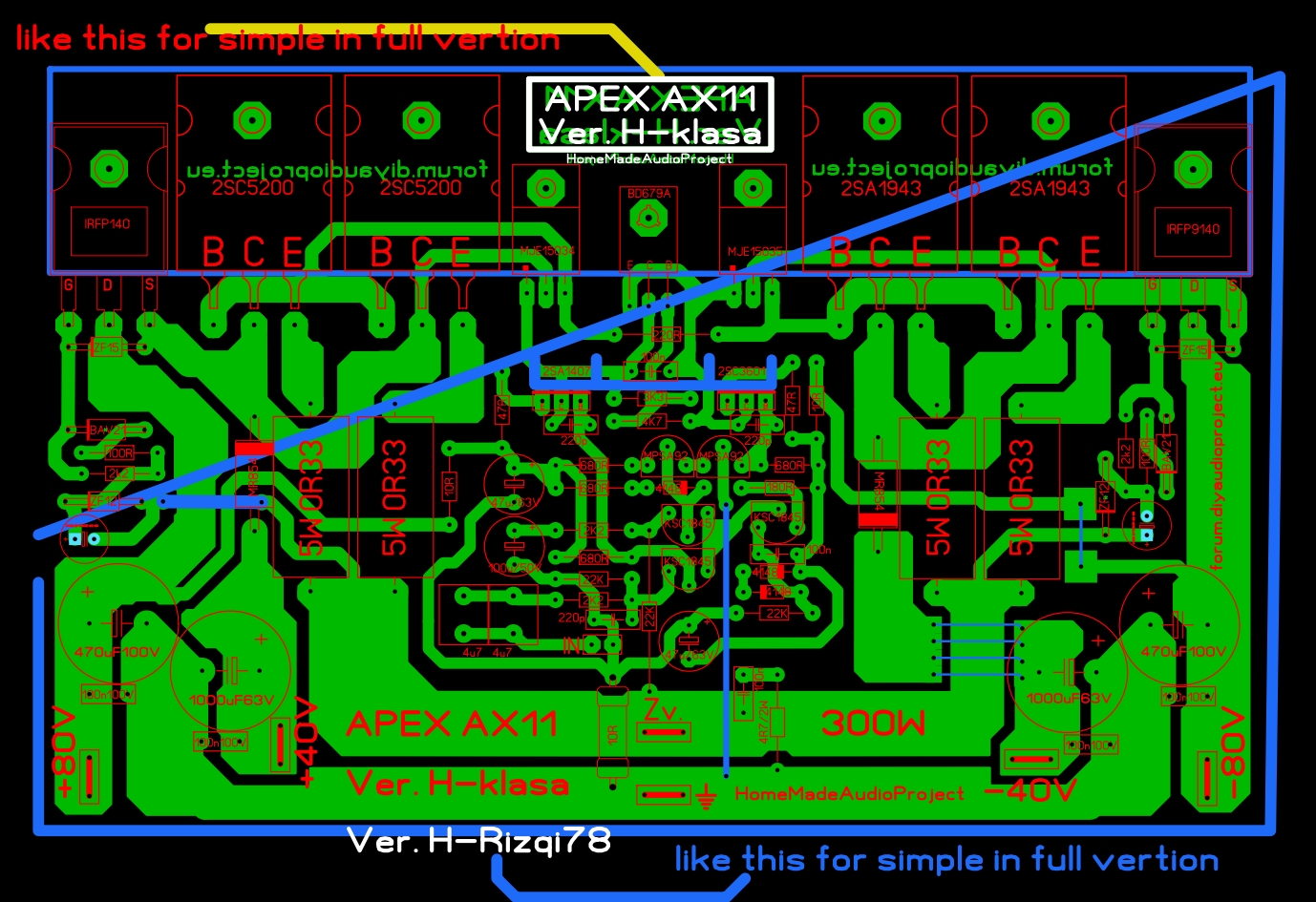

sprint layout 5
: Eek:: Eek:: Eek: I has not sprint Layout 6; : Eek:: Eek:: Eek:
Upload in SPRINT LAYOUT 5,Please.
sprint file in ZIP:
sprint file in ZIP:
I found the: sprint-layout_6_setup.exe.
but still I can not open the file you uploaded.😕
Sprint Layout 6
This is my sample in full vertions
Regards
maybe your progam still demo vertion,... in full vertions, could be edited with best layout,... thanks... 😉I found the: sprint-layout_6_setup.exe.
Regards
AX 11 Sprint ^6
thanks and regards
thanks for sharing 😉, really helped ease in editing this layout, although this has not been able to build amplifiers, due to limitations of the components in my area.how to do that out of sprint6 version program?
thanks and regards

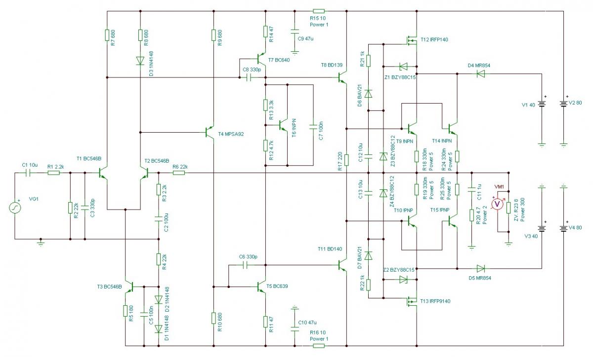

If anyone has drawn out the circuit for AX 11 in class h,
Would you please share the circuit.
Thanks a lot
Thanks a lot
Thanks a lot
This is very close 🙂

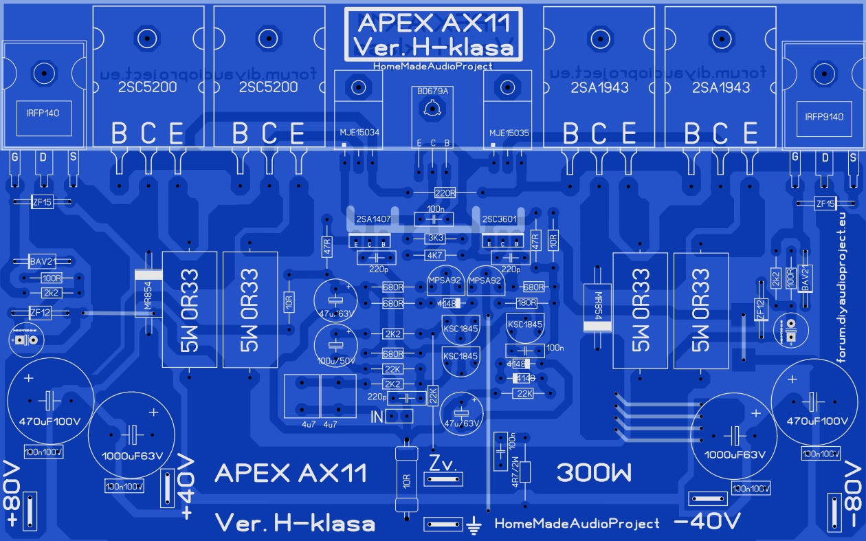

H-klasa in pdf (a bit changed...)
maybe this will help:

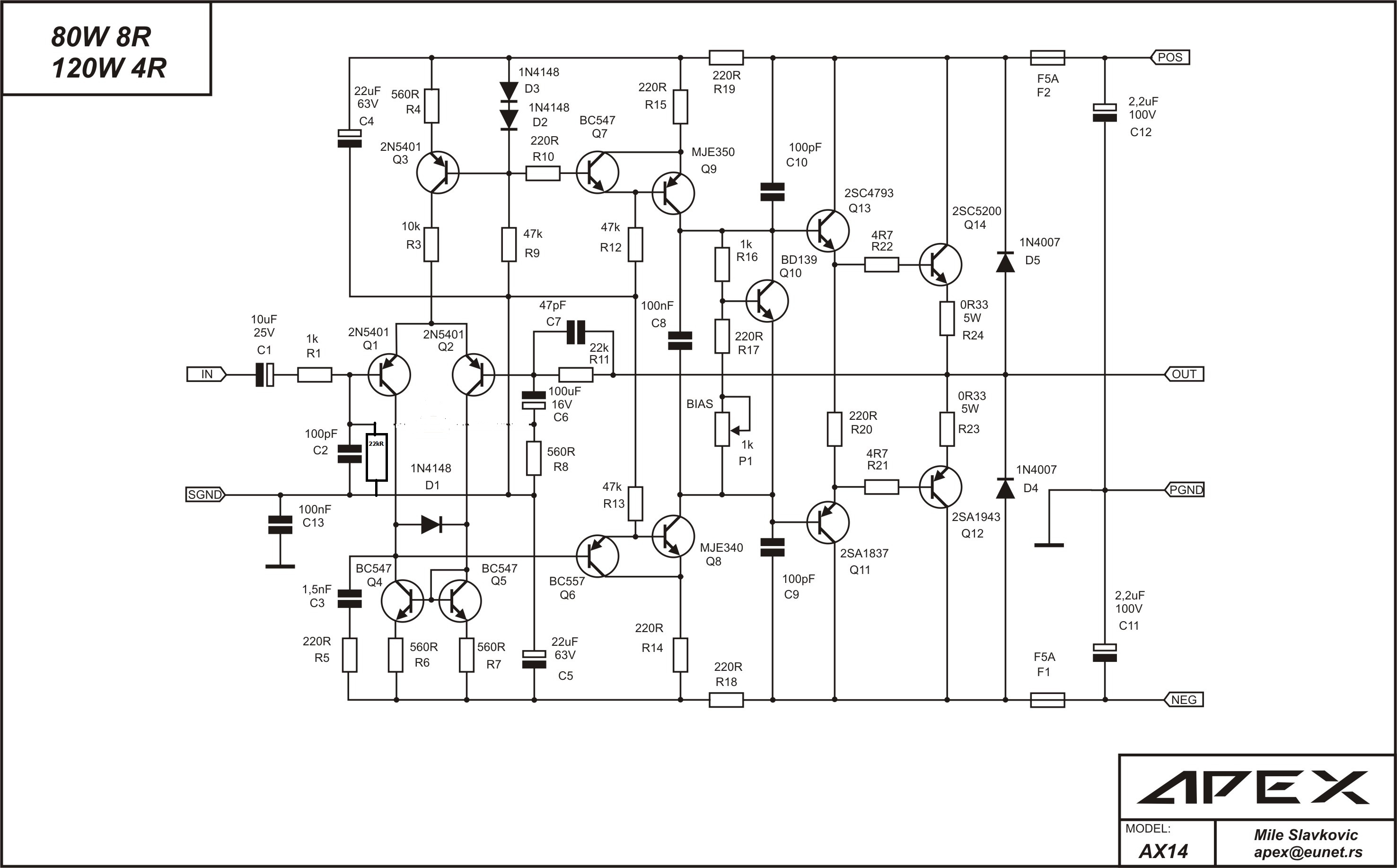

Hello
I have small question, I had some small problem with brumming noise from ax14 amp when input was not connected (prapobly due my board), I have made small change with r2 22k resistor and problem is gone. Now question is if I can leave r2 resistor connected between input and gnd ??
Hello
Yes you can leave r2 resistor connected between input and gnd.
Regards
