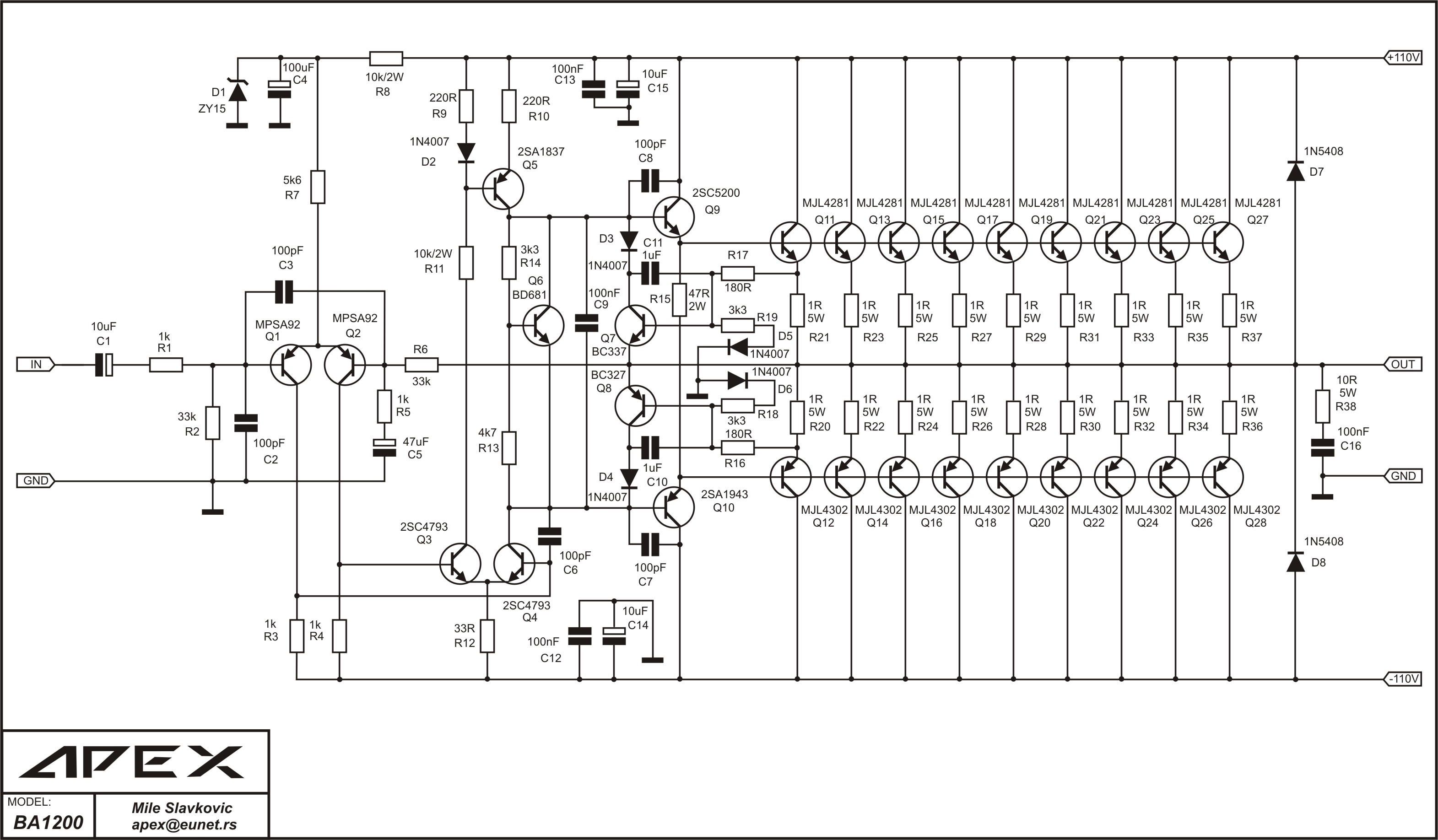

1000W Simple PA Amplifier
regarding 2SC5200/2SA1943 (driver?)
would you suggest Fairchild or Toshiba ?
I have 8pair of MJL21193/94
Maybe I could use one pair in place of the 2SC5200/2SA1943 ?
and 'just' have 7 output pairs
I will probably use slightly lower voltage
for home use, bass guitar :clown:

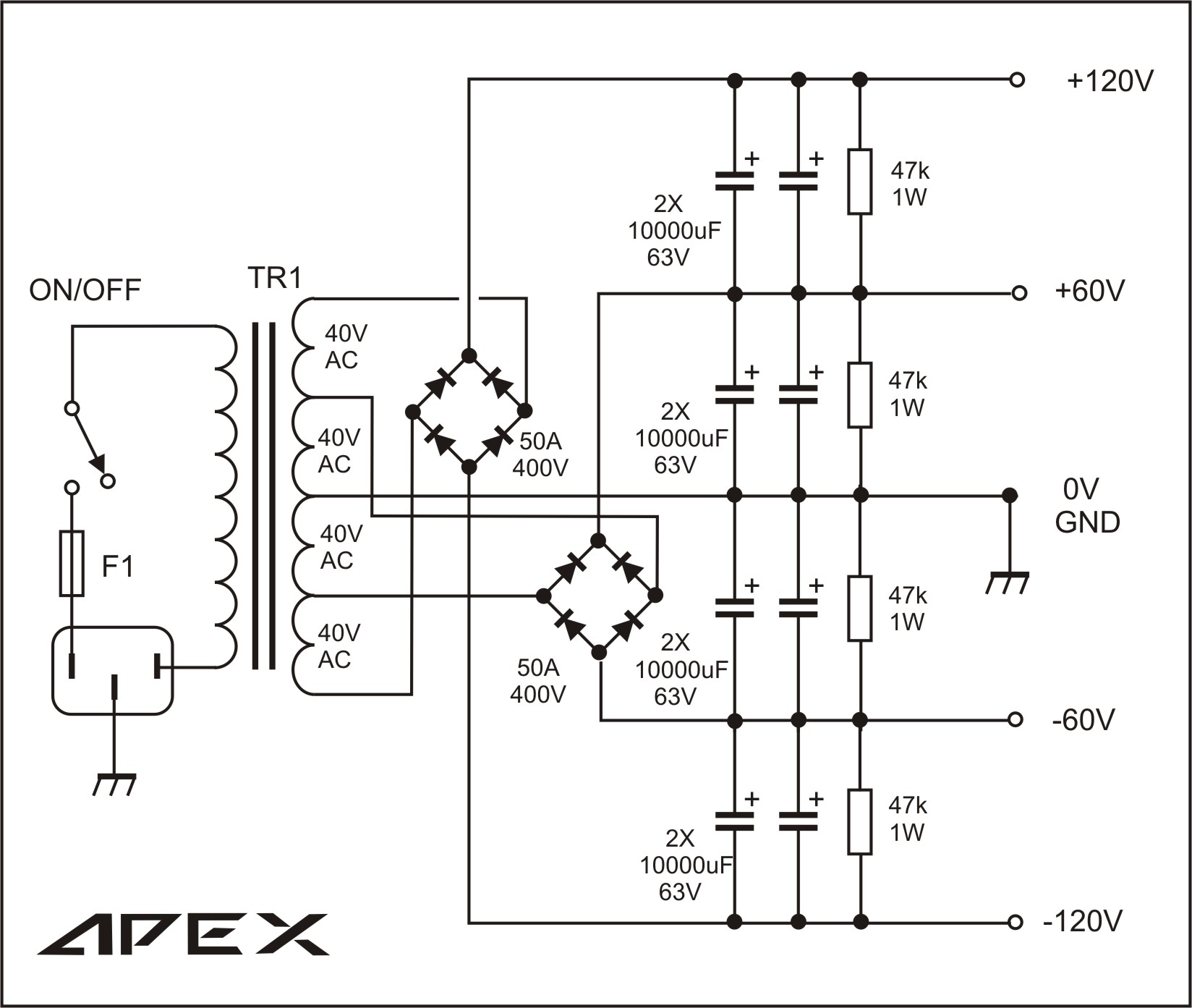

Use 160volt rated caps if available or this circuit with 63volt rated caps.
The use of this scheme for the power supply is not very good idea. If any of the capacitors have problems, the fault could be massive and could be extended to the other capacitors, being able to destroy much of the capacitor bank.
Even the capacitors would have to be fairly well matched to ensure a proper distribution of voltages and prevent perforation of dielectrics.

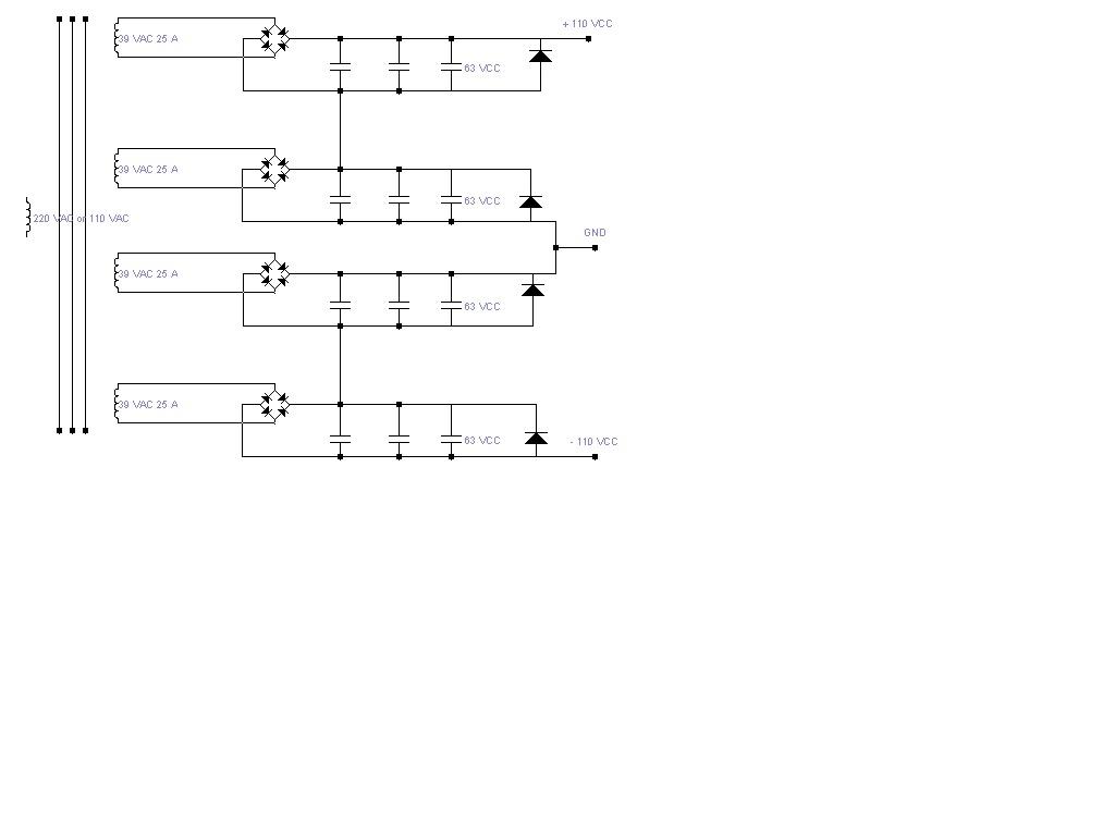

I can suggest this new scheme for the power supply. It can even be much quieter and more reliable than the first. Remember: A capacitor is always more expensive than a diode bridge!!!.

attachment.php

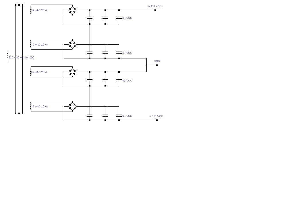

This solution has potential problems: If the diode bridge on the right of the schematic is opened for any failure, we return to have any chance of massive failure. Even if a capacitor is shorted, it can cause damage in another capacitor placed in the higher voltage rail or vice versa.
Here is a version even more reliable. If a diode bridge opens for failures, no problems. It is even far more silent.
regards
attachment.php
