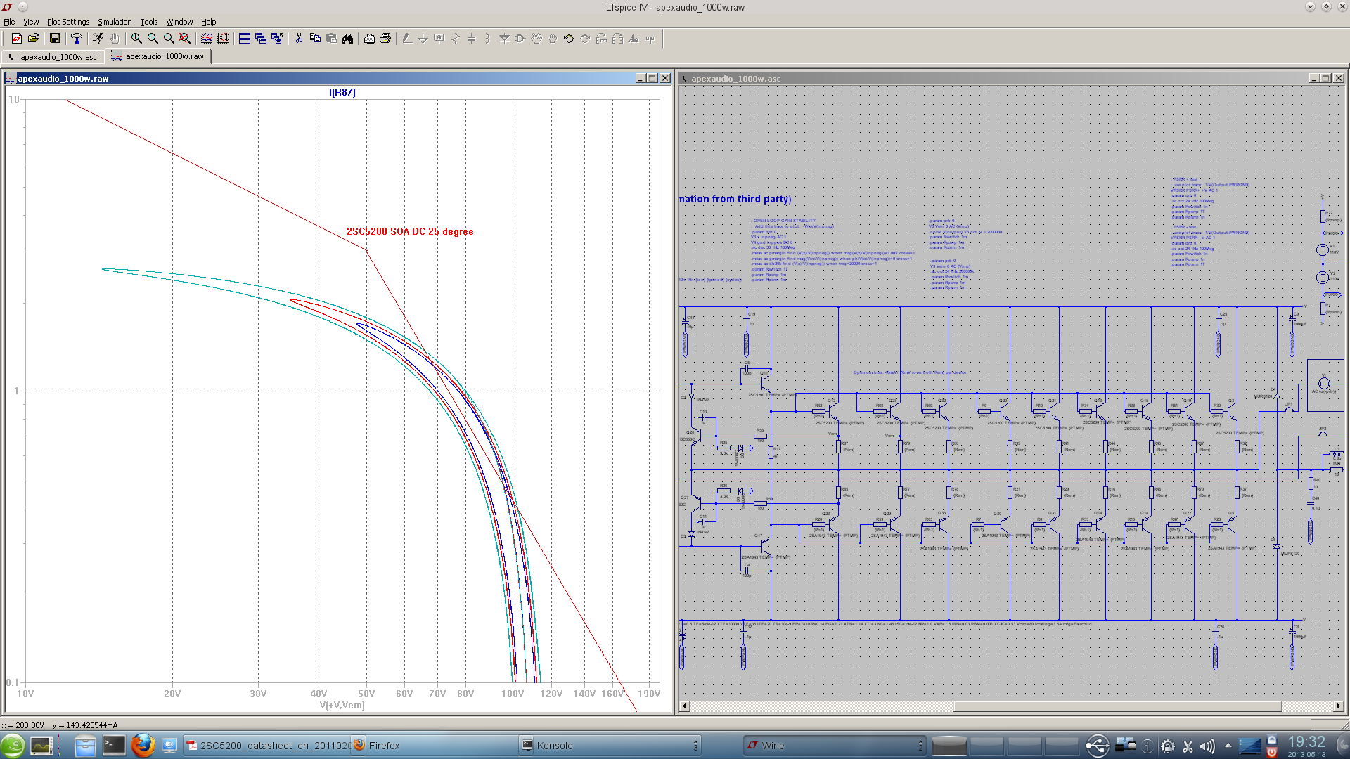

SOA problem
What about SOAR of a 9pair 1943/5200 stage when operating from a 110Vdc supply?
You are right. There is a very clear SOA problem. See attached picture.
Simulations show 400W to 1000W resistive load @4R.
SOA worsens with real reactive load. 😕

I use my usual Pmax guide.
Pmax ~ total BJT output stage wattage divide by 5 or 6.
Since the 1943/5200 have terrible high voltage SOA, I would use divide by 6 if I can keep them cool enough.
9pr of 150W devices = 2700W.
Pmax ~ 450W if kept adequately cooled.
That's why I raised the comment, particularly since Apex is suggesting it for PA duty.

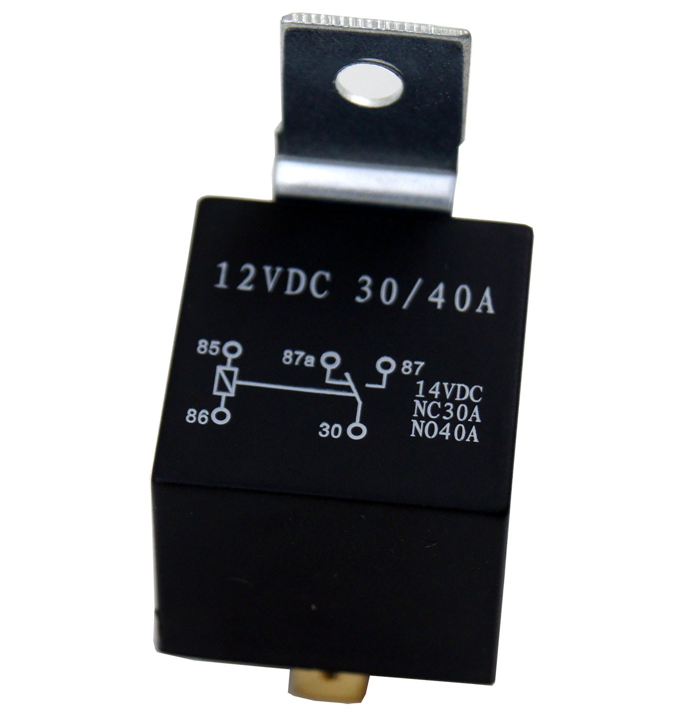

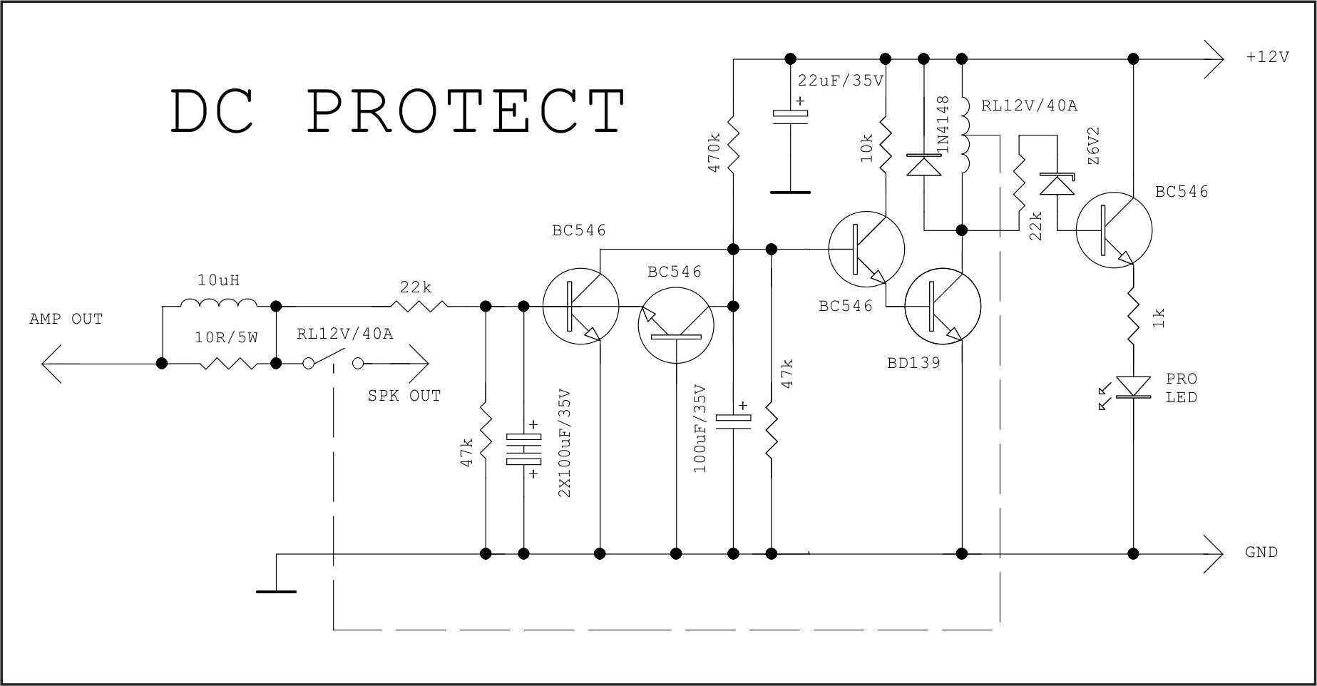

You can use this simple DC protection with 40A relay (12V for car)
It is a reoccurring theme trying to use a Low Voltage DC contact rating ( 14VDC) to construct a Speaker protection circuit. 110VDC@40ADC with the suggested relay is impossible, and this is a benign scenario. View the accompanying graph of a typical Automotive relay contact capability before experimenting with welding techniques.

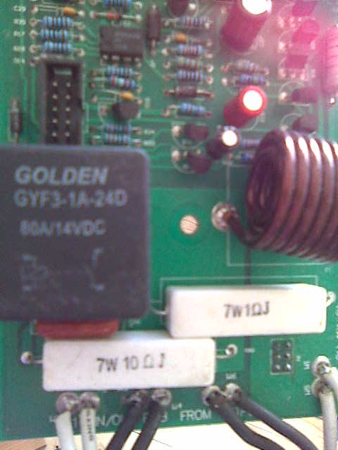

Thanks for warning, I see 12V/80A relay in CREST CA18 and get this idea. I will try this relay with 220vac and 1500W heater for test 🙂
