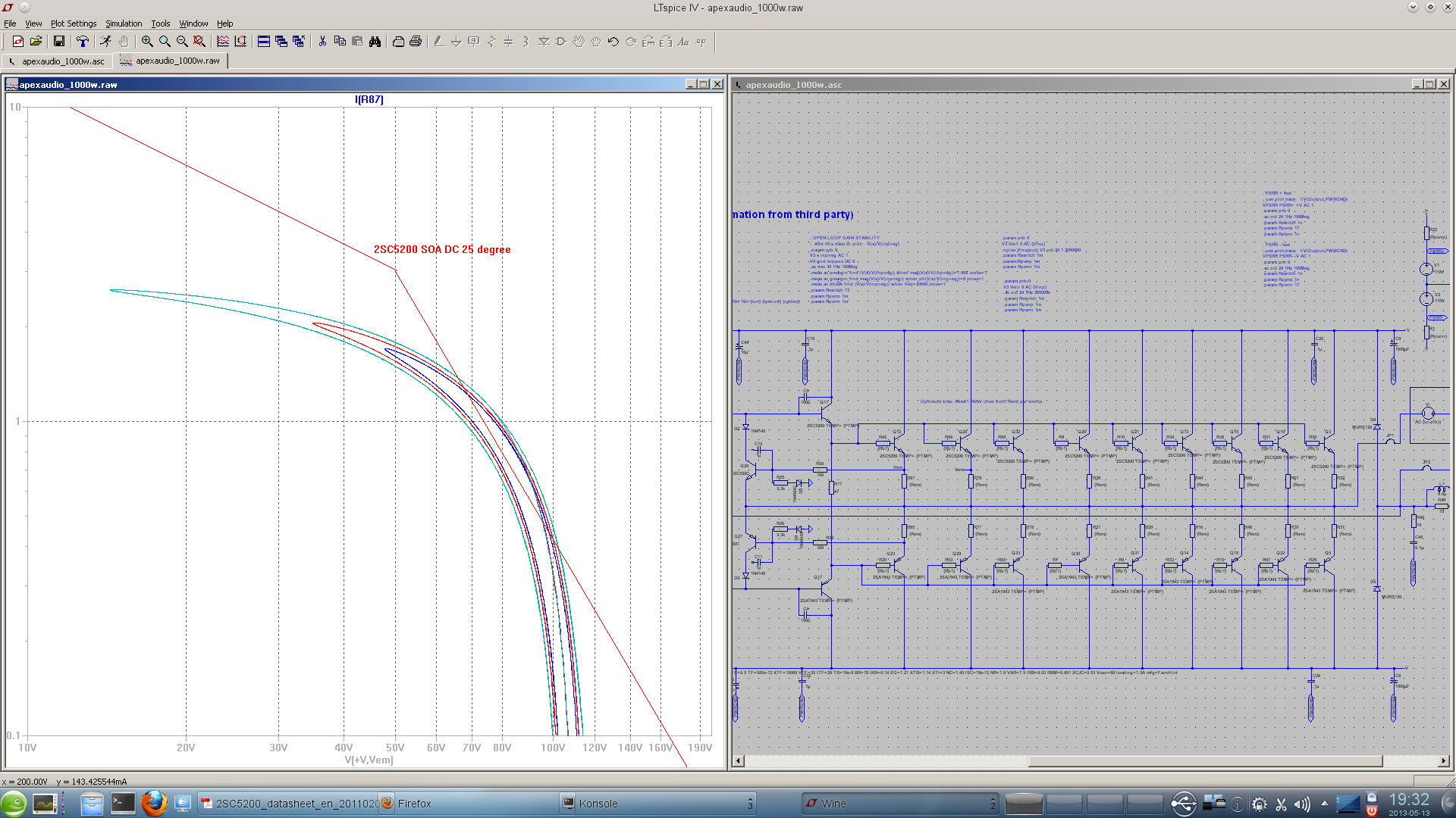

@astx can you share apexaudio1000W LTspice file?
Regards

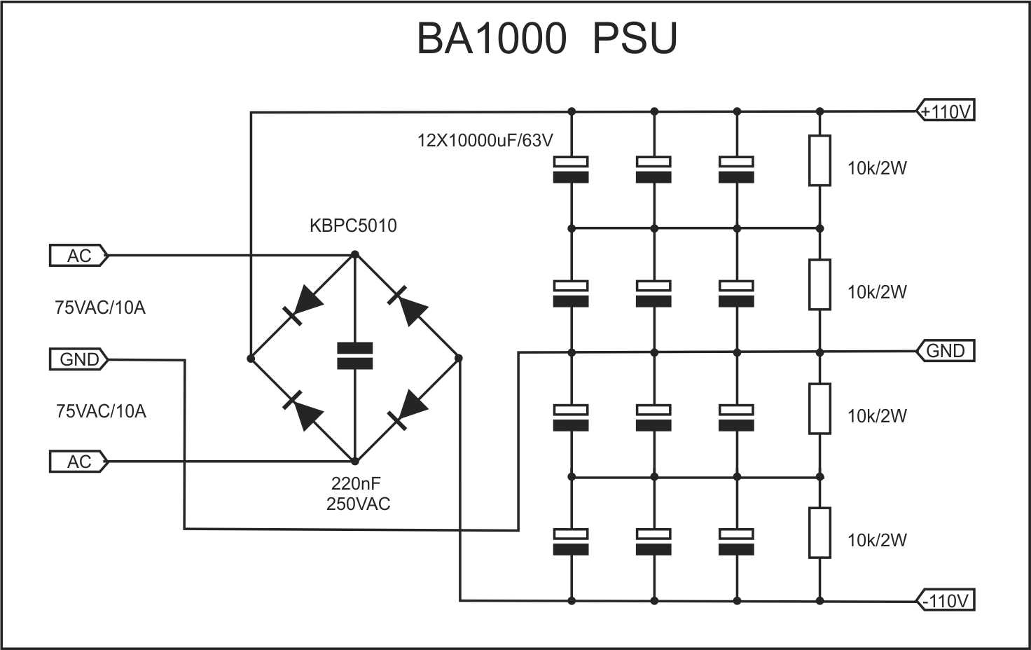

Jean Hiraga coupled big caps with opposite polarity
should work like bipolar cap
with the lower voltage caps, very high capacitance was possible
but capacitance would be half
there was also a single big cap with the correct voltage in paralel, but with lower capacitance
