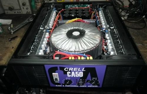

I imagine the 50Kg amp using circuit breaker as a power switch, and install 2 wheels like troley bag just to move the amp like.....😀

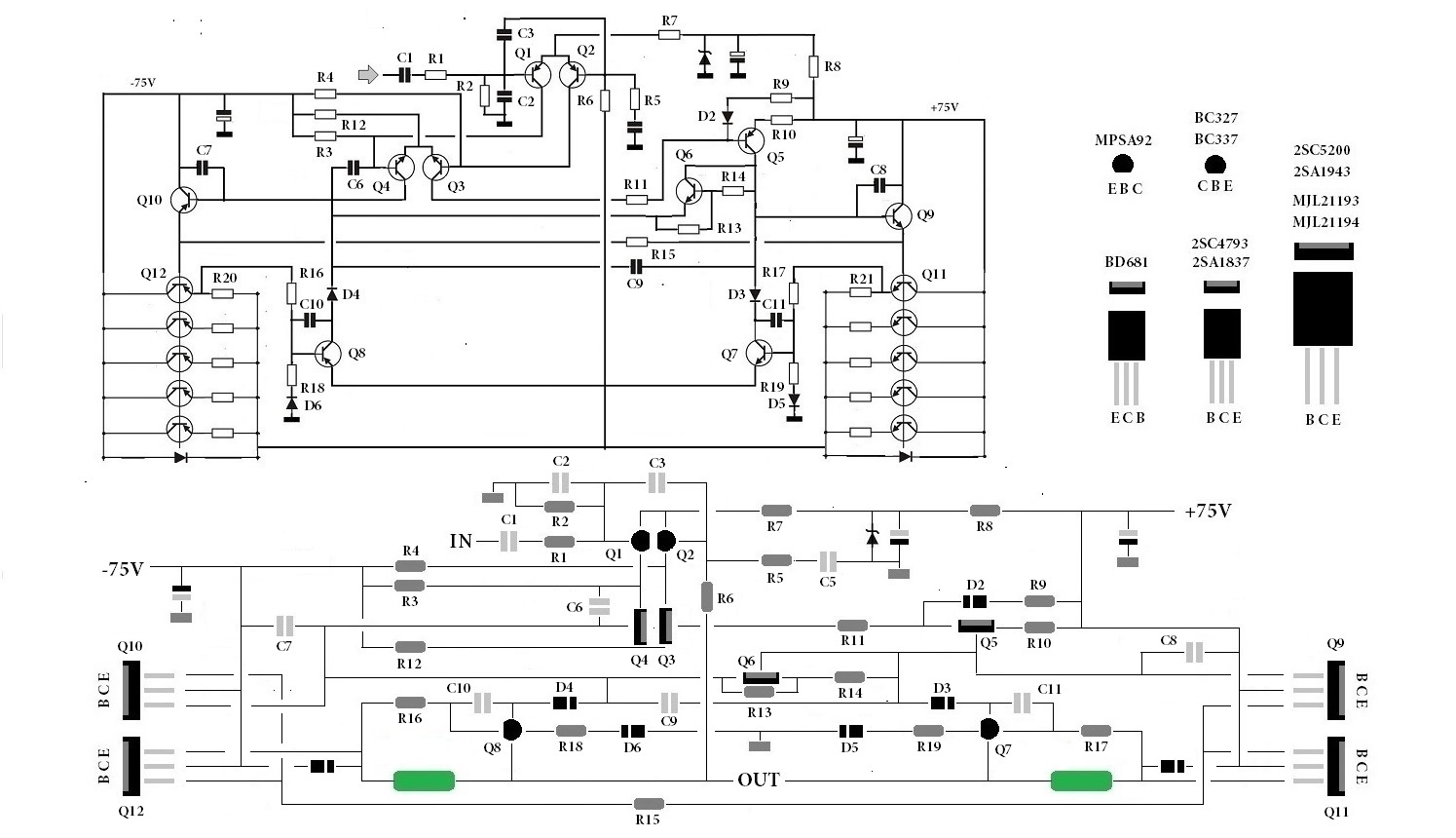

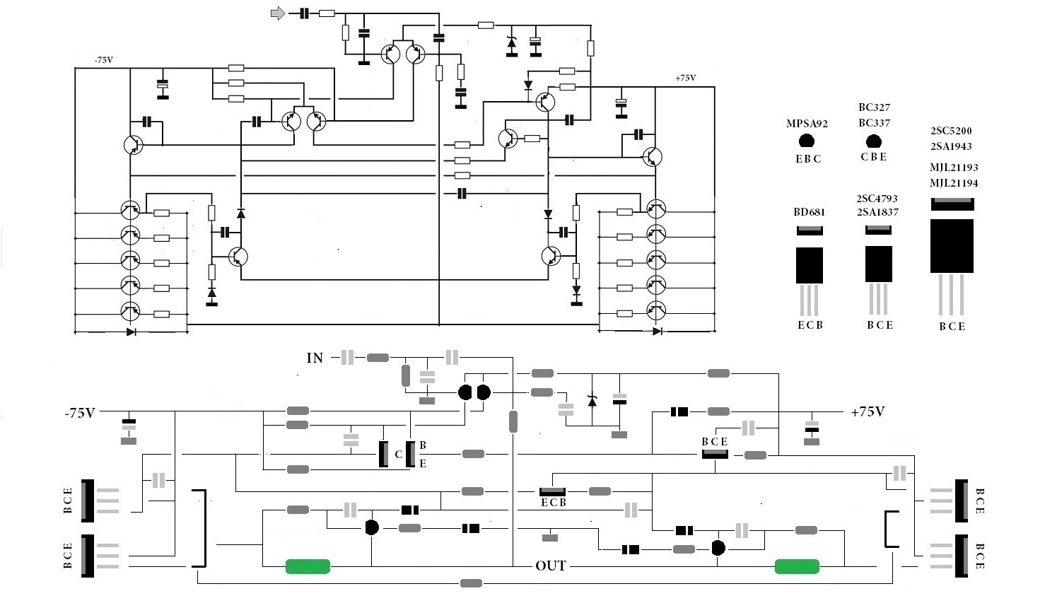

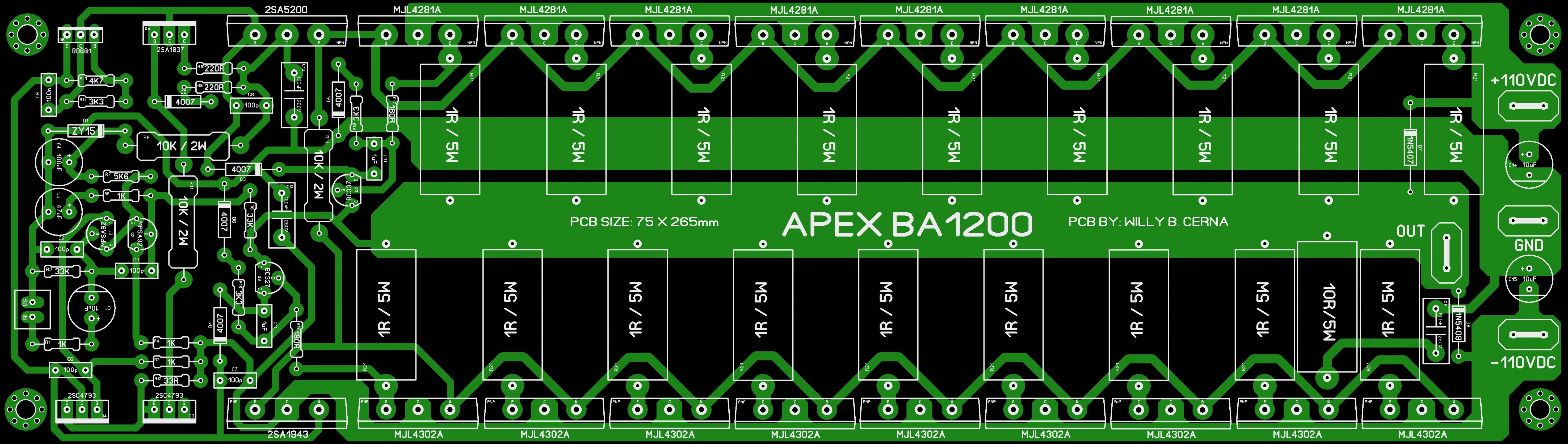

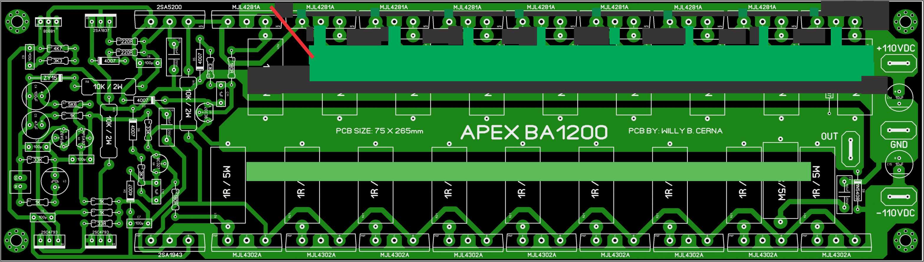

my usual layout preparation exercise :clown:

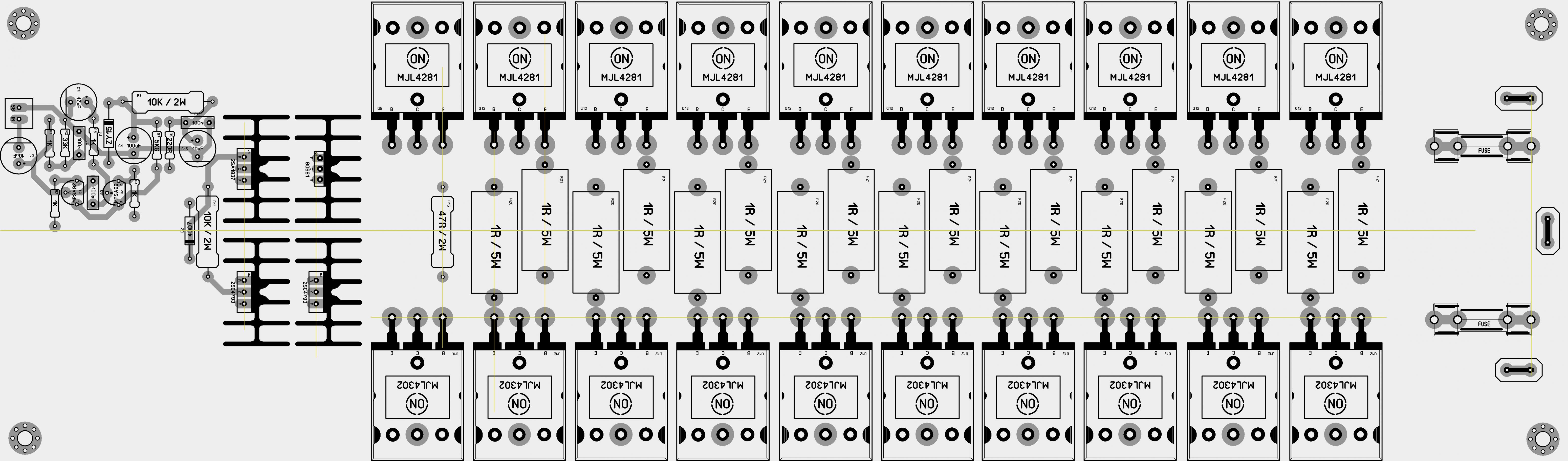

anyway...if I really is going to do this, I have decided for a pro style 19" rack box, with heatsink both sides (300 x 165mm)
to get enough heatsink surface I will use one side for NPN output, and other side for PNP
input/VAS will be placed on a long board connecting the two sides
input in the middle, and VAS closer to driver/output
