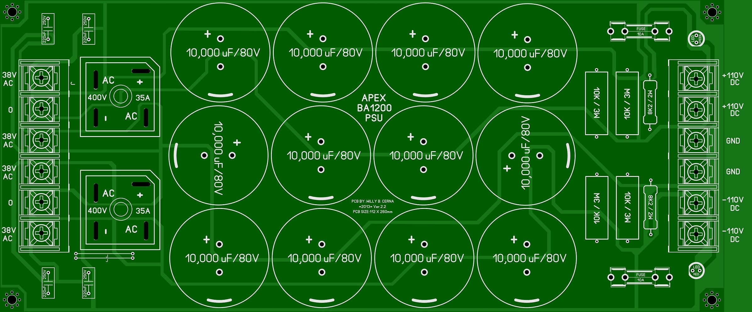

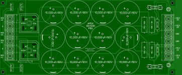

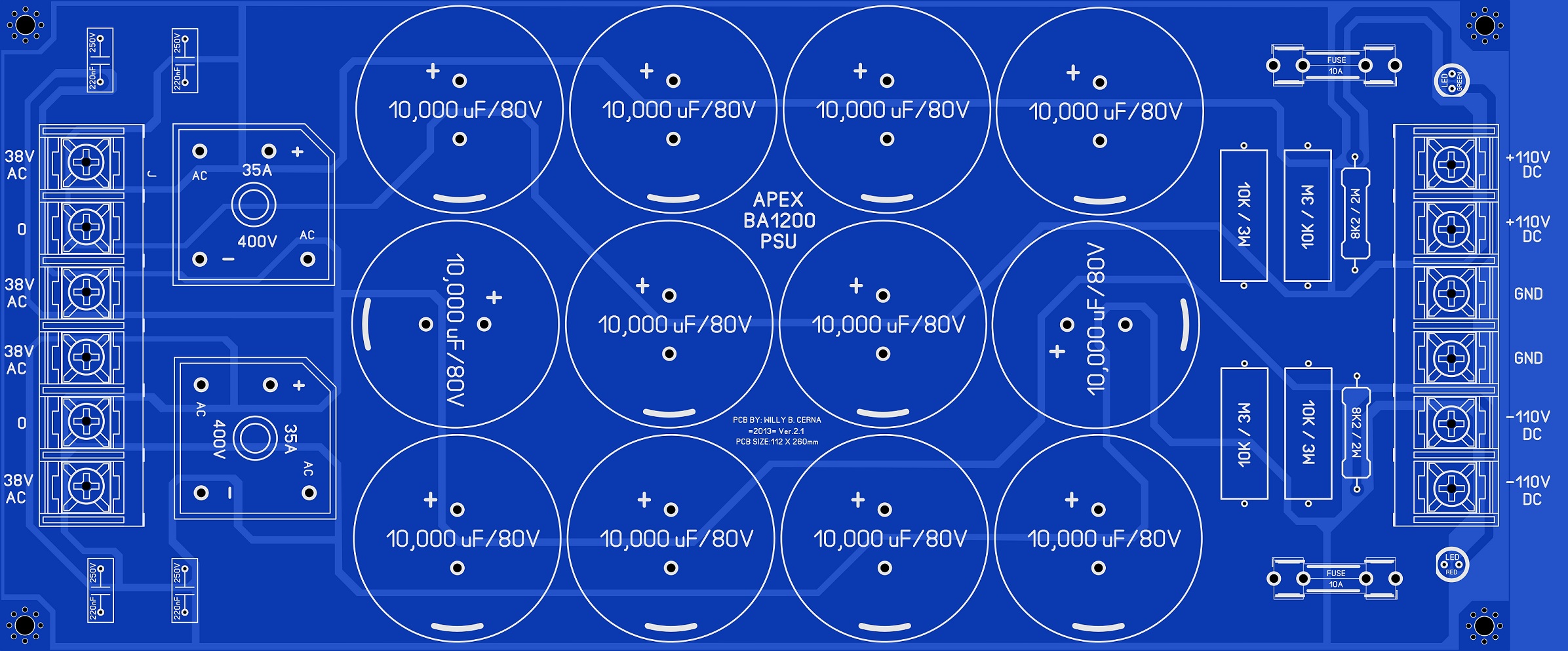

Try to fit it in 260x112mm, it's same dimension as amp pcb for 3U.
Regards
Ok, here are the 2 Versions for optional diode.

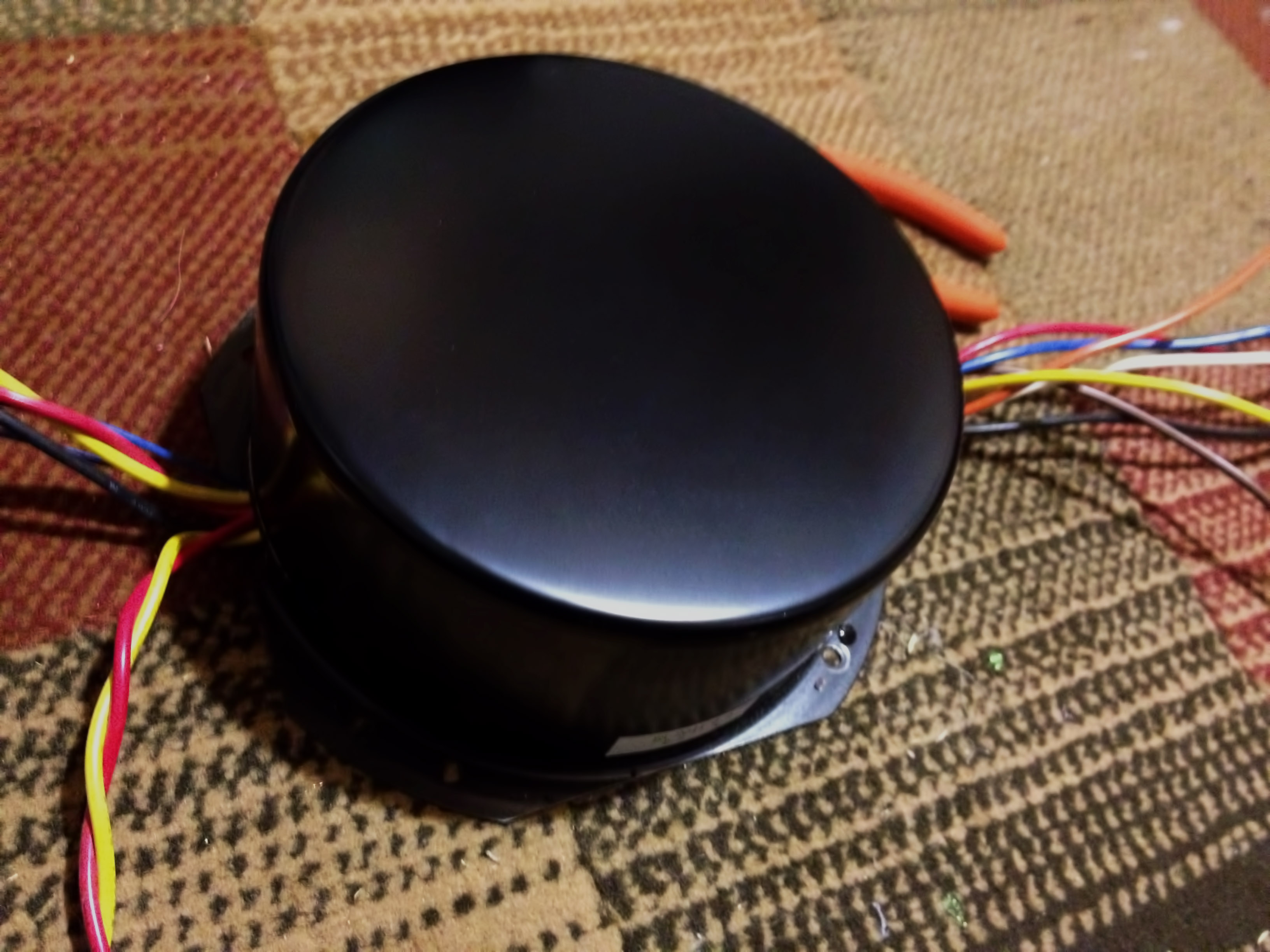

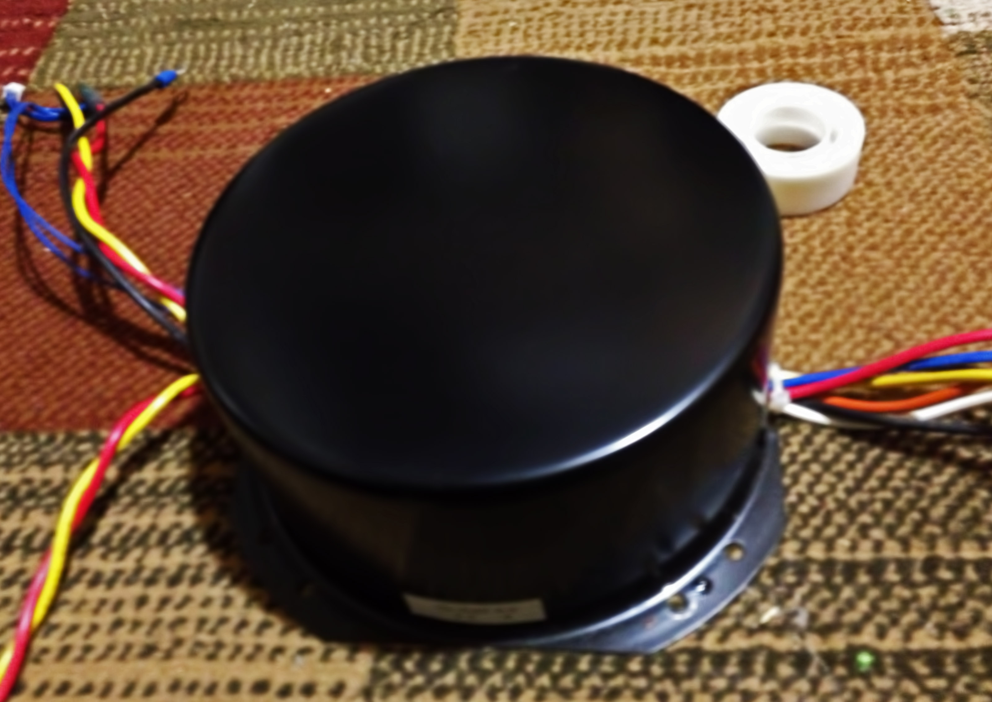

Anyone want transformers
I have a few of these I need to offload soon. Ping me if interested.
Input 100v/110v/220v
Output: 62- 0 -62 or 69-0-69vac or +/-84vdc or +/- 99vdc
700va
Metal encapsulated
Can parallel 2 to get 1.4kVA
These are very tight tolerances. There is less than 0.1mVac difference in secondary voltage of 2 transformers.
They are pull outs form Adcom GFA-555ii's

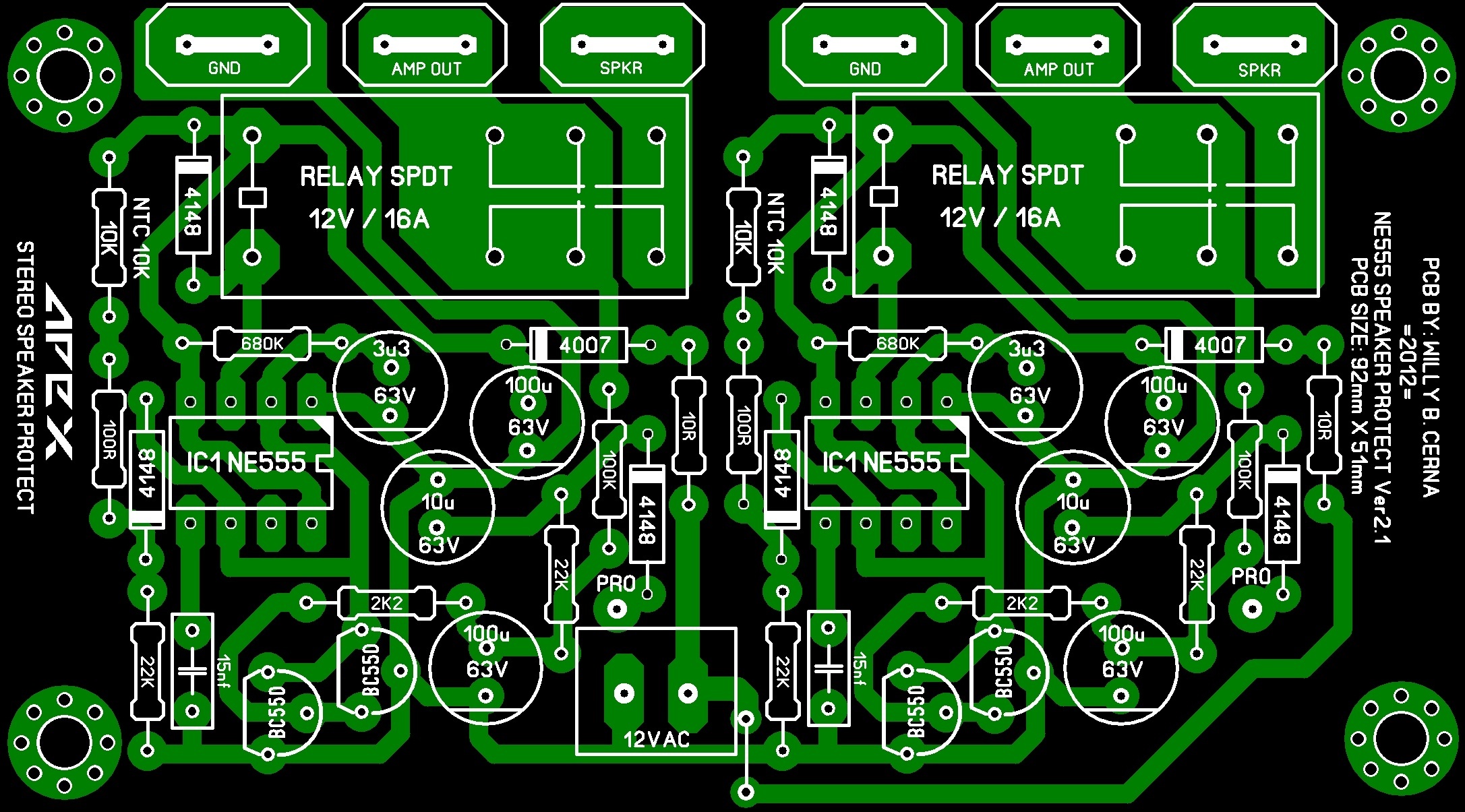

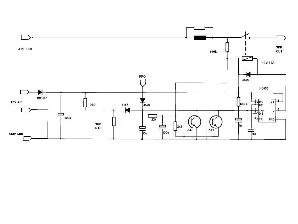

Thanks that is very good idea to integrate this circuits on same pcb.
I suggest to use protect with NE555 for BA1200.
Regards
I'm currently using this protect in my amps but I don't remember if i posted this protect before.
...This is tested and working circuit, just needs to change T9 relay and should be fine for BA1200.

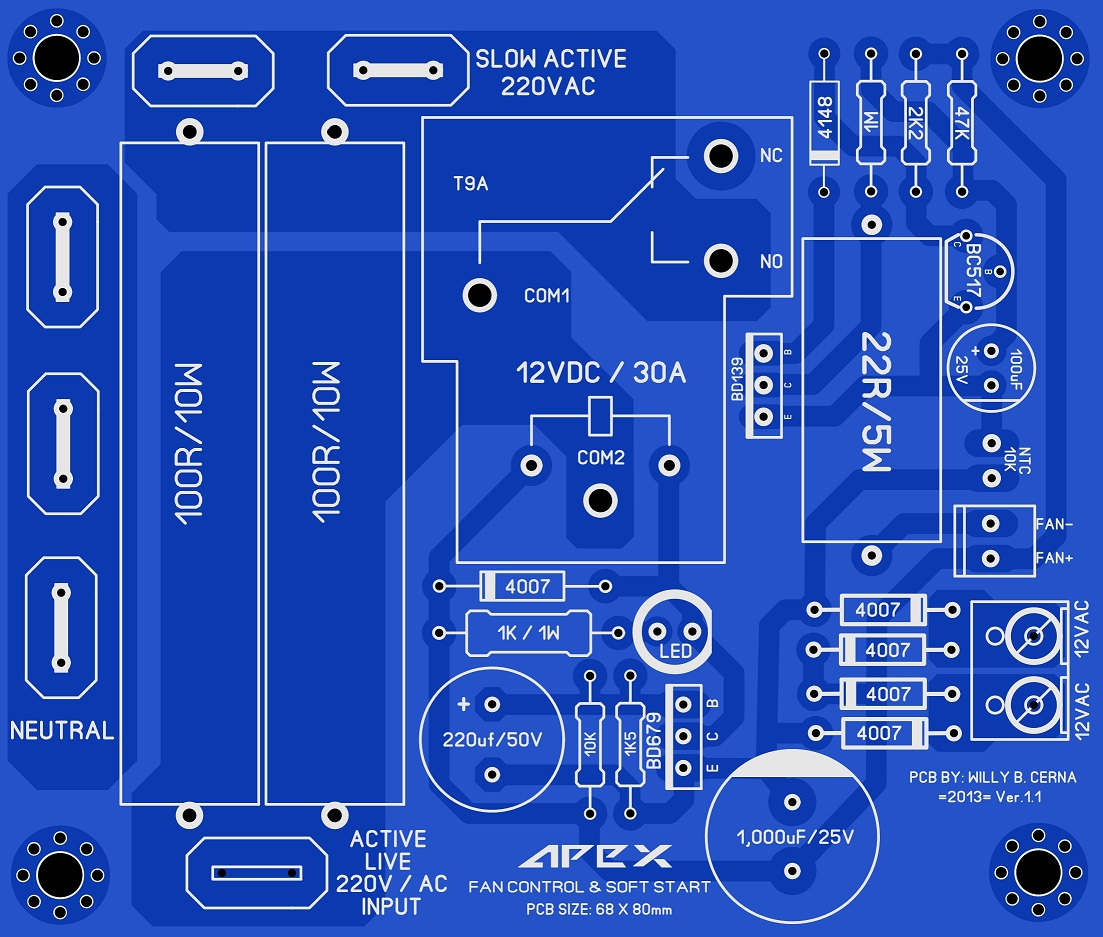

Soft Start w/ Fan Control.
PCBs very practical and useful, thanks mate, you are a great person, I am pleased to be in this forum with good and friendly people.
