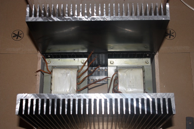

heatsinks on
still thinking I could make it a smaller 2-channel amp instead of a monster mono
nice.. i love your heatsink....😉

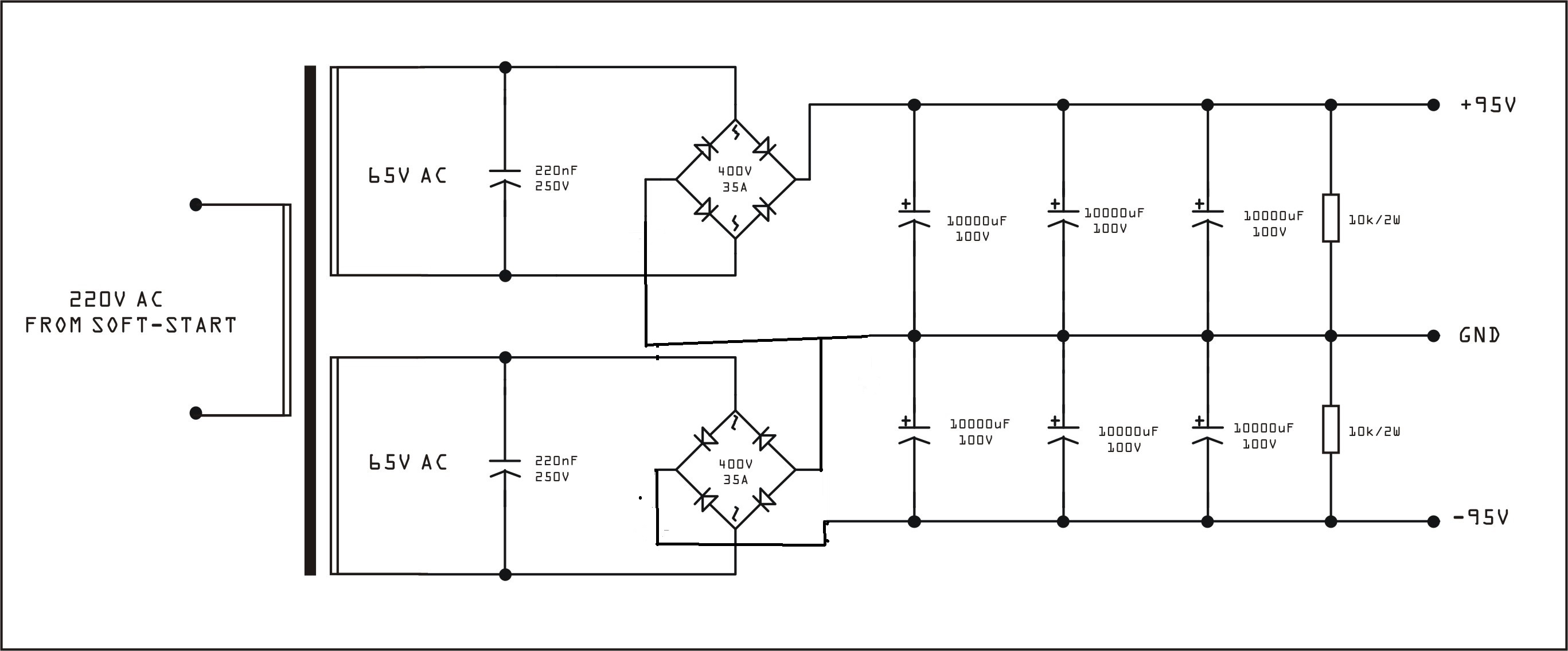

Mr. Mile which schema for PSU are good to go for this amp? i'm confused which one is preferable to all diy freinds? 😕
from my personal considerations I would suggest
50+50V trafo...with 80V caps
or
two trafos, 30+30V, 30+30V..... 60+60V(series connected)....with 100V caps

There is options
or

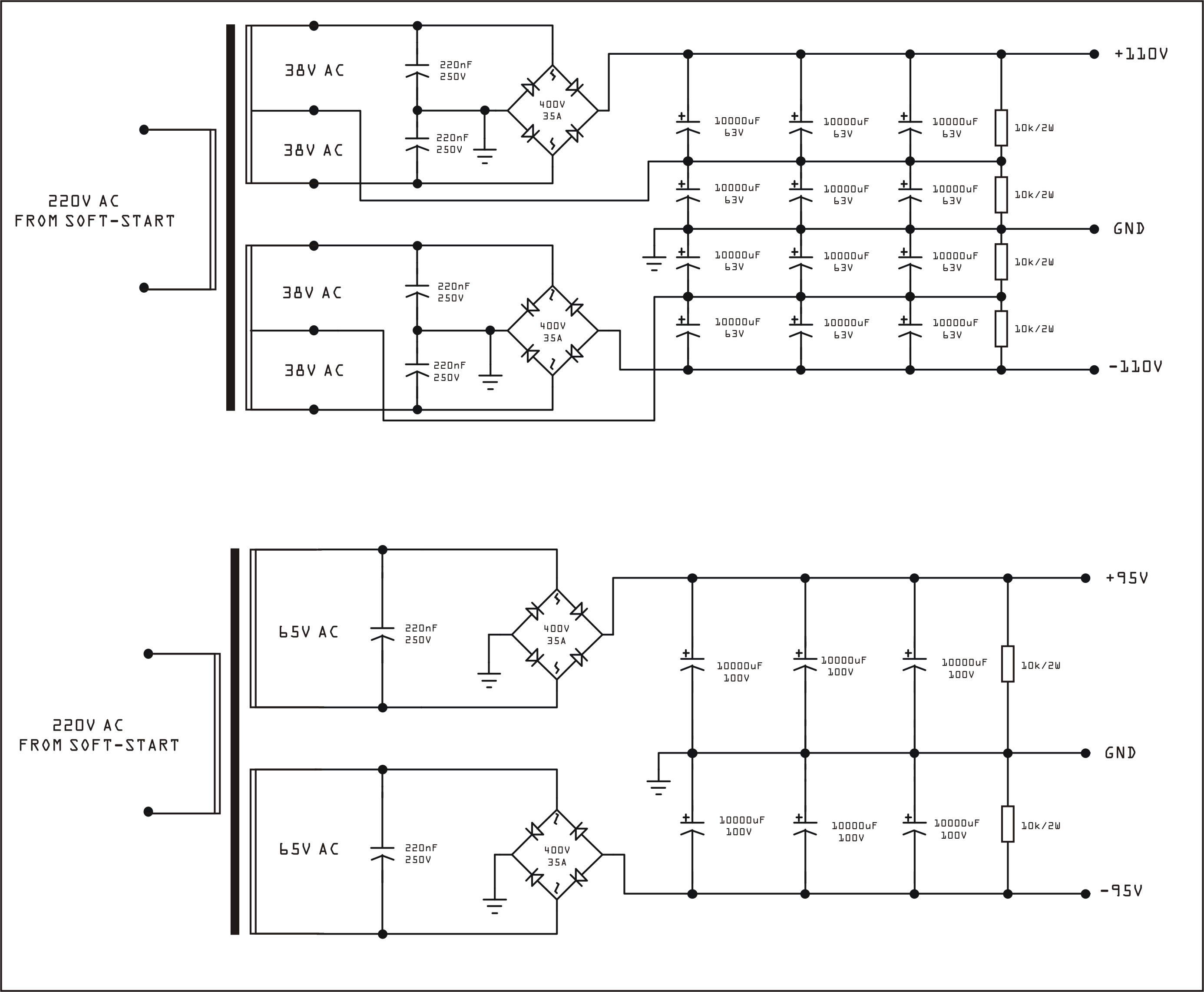

ehm. more like this.
and why do the +/-110 Version only have 15.000uF pr rail. and the +/-96V Version got 30.000uF pr rail?

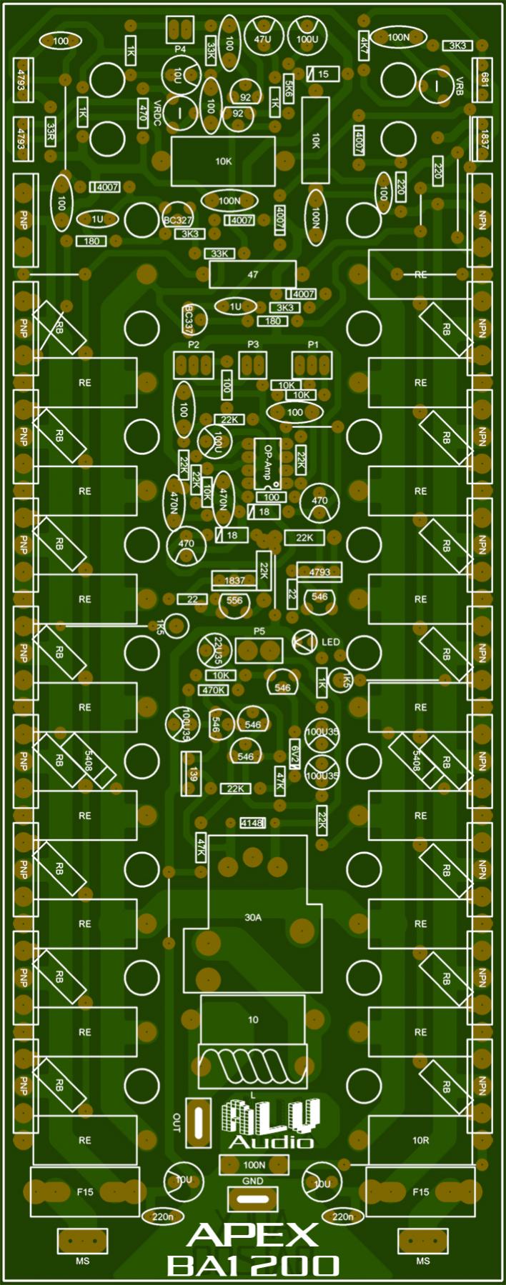

Pcb is this the end?
pcb finally reached the end. : D
Heres the file's....
schematics principal is what is important,but you can take that as a minimum ratings. you and anyone else will anyway put in the psu what you want or what you have. i can't believe that so many of you people wish to let all the others that you have discovered warm water by claiming that psu capacitors should have larger rated voltage and capacity,like no other knows more is better and that size matters? calculate output amplifier current and multiply by 3000,that should be more than enough even for hi-class power amplifiers working in ab class,so hope it wold be enough for any PA builder's concuisnes.

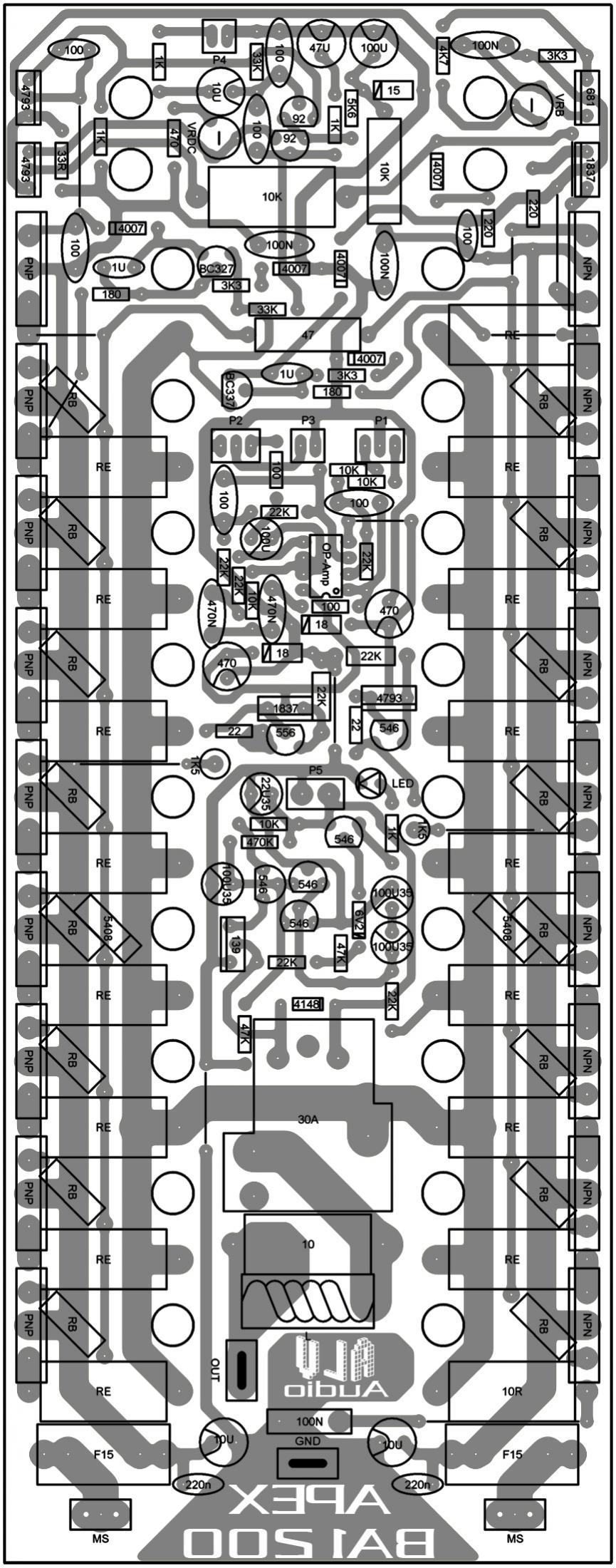

P1 = Inputsir Mile,this BA1200 PCB added Balance and DC Pro is correct?![]()
PCB 100x255
thanks Regards ... 🙂
P2 = Pot
P3 = to P4
P5 = 12vdc
please correct me if there is an error... thanks 🙂
PCB 100x255
Nice work, I must check.
Regards
+/-110V version is for mono, +/-96V version is for stereo 🙂
