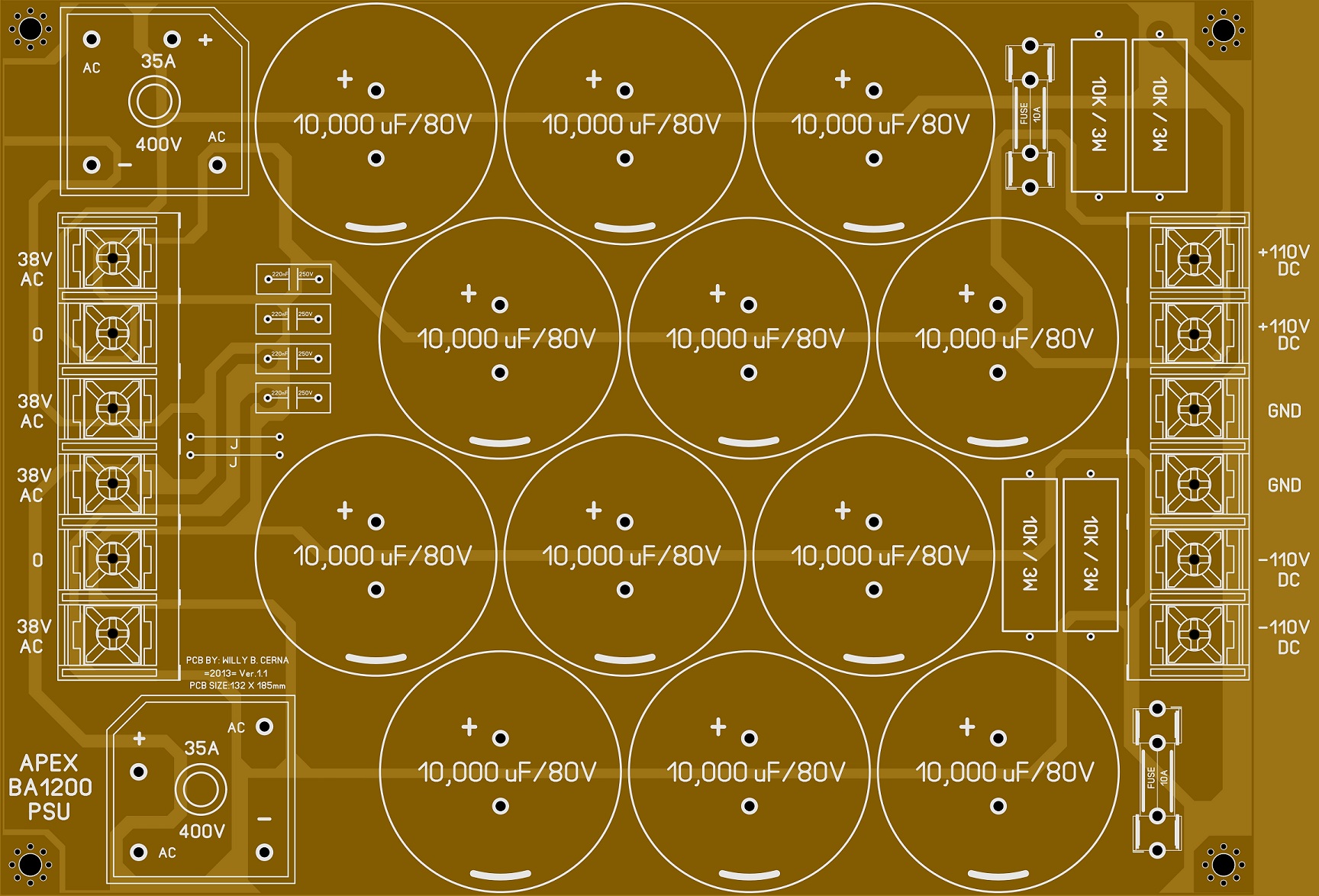

Photoview of APEX BA1200 PSU.
Nicely done, and almost fits in 3U of vertical position.
Regards
Regards
Thanks...what is the standard size of PSU board for 3U?
Try to fit it in 260x112mm, it's same dimension as amp pcb for 3U.
Regards

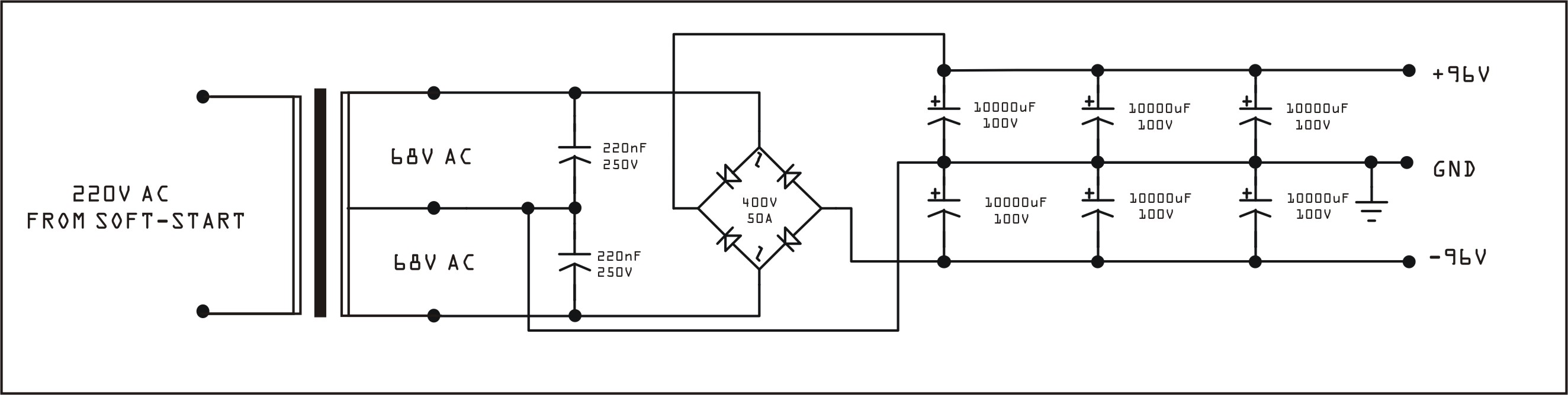

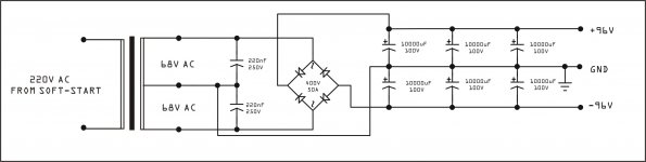

hey ,thats nice job....bt i have 75 0 75v 1500va transformer....can anyone make the pcb of power supply with diode nd capacitor for my transformer??
You can use this circuit but with 120V caps instead 100V.
Regards
