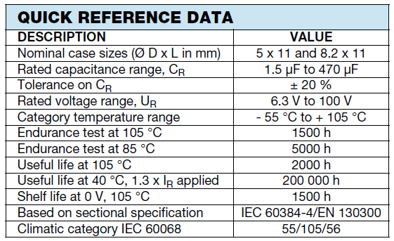

Sorry but no.
Lifetime specs are derived statistically by the Manufacturer after testing lots of samples, under "working conditions" as specified in the datasheet.
It's not "pampering" but proper design.
So if a manufacturer says (as an example)
If you abuse it, which would be using it beyond 50V or 85ºC .... you are on your own.
mans exactly that: if you use it at 50V or less and 85ºC or less it will 99.5 % probability of lasting 10000 hours . Period."this 50V, 85ºC rated capacitor is guaranteed to have less than 0.5% failure rate within 10000 hours"

You must read the full spec:
As an example:
There it's clearly stated:
So what?
What they are telling you is " it won't *explode* at 105ºC but it will have very poor life"
They also tell you that even if *stored* at 105ºC, it will also degrade (even if "unused")
But if you use it in a more sensible way, at, say, 85ºC (which is still very hot):
By the way, you made your calculations based on 24 H continuous use, at continuous max. temperature (105ºC or whatever is specified) , which is not a realistic use expectation.
For a real world example, let's consider a grueling but possible job, as, say, the power amps in a Disco which are used full power, in a very poorly ventilated rack, 8 hours per night, 3 nights a week.
In that case you would have 24 abuse hours a week, so 1500 hours would give you 1500/24=62.5 weeks, or a year and a few months, which is consistent with my experience installing and repairing Disco and Live PA equipment.
But if the installation was not *that* bad, meaning no fans but at least the rack enclosure has some ventilation holes (so no surpassing 85ºC) , that amp can count on its PSU caps for: 5000/24= 208 Weeks, over 3 years and a half.
Not bad.
And if you want to use those caps properly , as in Home Hi Fi or even , say, a Mall/Railway_station system providing background music/announcements , and you allow ventilation so they don't surpass 40ºC (which is a reasonable spec), they will last:
In this case I calculated with 24 hours continuous work 7 days a week, all year long.
Which is consistent with the datasheet, and everybody's experience.
So in a nutshell: if you want long life (who does not 😉 ? ), follow datasheet recommendations from a serious manufacturer.
Good luck.
As an example:
116 RLL Aluminum Capacitors Radial Long Life - Vishay
Yes, that's even less: 62.5 days. 😱Endurance test at 105 °C 1500 h
So what?
Still 62.5 days.Shelf life at 0 V, 105 °C 1500 h
Endurance test at 85 °C 5000 h
Not bad.
or [200000/24]/365= 23 years 😱Useful life at 40 °C, 1.3 x IR applied 200 000 h
Good luck.
