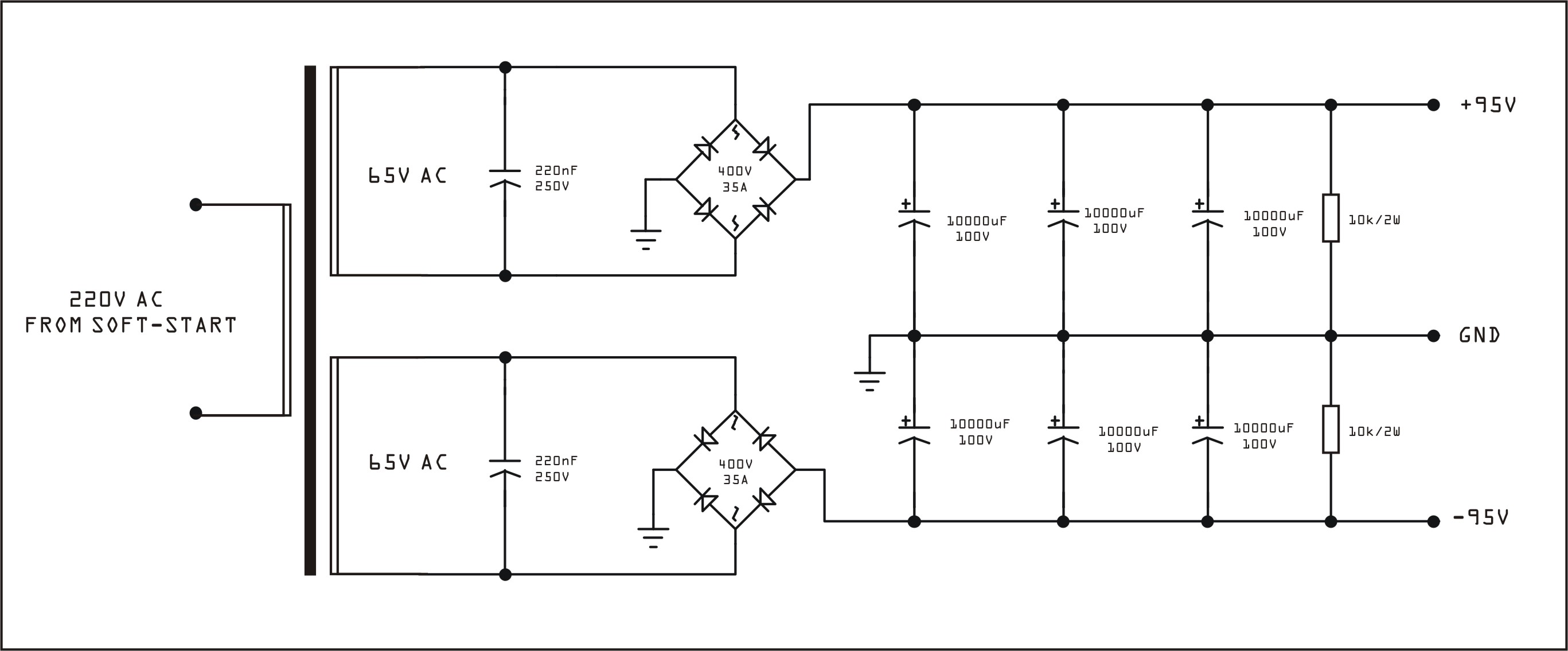

thank you sir tinitus...do your have any circuit recommended for me sir.. i have 38 0 38 VAC transformer rated at 10ampere..and 2 filter capasitor..
PSU for BA1000 stereo.
68V * 1.41 = 95.9 V
Not very much safety margin for the electrolytics. Don't forget we need to calculate with highest possible AC voltage which may be easily up to 10% higher as nominal voltage:
(68V +10%) * 1.41 = 105.5 V
IMHO using secondary 2x68V AC you need to take absolute minimum 120V electrolytics in this PSU to be safe.
BR, Toni

IMHO if you stack electrolytics you need to add power resistors in parallel to ensure the voltage is halfed. But better to avoid this topology strictly for safety reasons. 😱

Introduce additional resistors arround 0,22 Ohm between the first cap and the second - both in the pos. and the neg. rail to reduce charging current peaks. This step will provide better sound quality.
I would add bypass caps between 10uF and 25uF like this:
http://www.wima.de/DE/snubbermkp.htm
For the discharge resistor I would choise for each rail two 27 K-Ohm, 7W in serial mode to avoid hot spots.

100V is too little, also 160V is actually too little, because while a high ripple current flow it is not enough to only pay attention to the Voltage value of the cap (check out the ripple current flow by a speaker load at 1 ohms, 2 ohms and 4 ohms at this supply voltage so as the internal impedance of the caps - then you will get the power loss inside of the cap).

ASTX is correct.68V * 1.41 = 95.9 V
BR, Toni
Some of Apex's suggestions for voltage rating of the smoothing caps is irresponsible.
A 220:68+68Vac transformer feeding 100Vdc rated capacitors is potentially dangerous.
Even a 230:68+68Vac transformer for 100Vdc caps is risking a blow up.
A 240:68+68Vac 4% regulation when fed with 254Vac results in ~105Vdc on the smoothing caps, when the amplifier load is disconnected or turned down to low output bias operation.

I only give suggestions,companies with commercial products are irresponsible, they usually use 100V rated caps with 70V ac.

I also mean that, but some brand caps work over 20 years without obsolescence. Some brand caps can work with 20% higher voltage than rated.
A manufacturer of quality parts has it's own safety margin. So a 100V elko may withstand 120V but there is no guarantee.
You can not give suggestions on "hope that every device has this hidden safety margin".
BTW: correct voltage margin does not be the only criterion to select caps for a power supply as "tiefbassuebertr" correctly said. This amp and it's PSU are working at very high and letal power/voltage levels so there should always be extra safety margin.
BR, Toni
