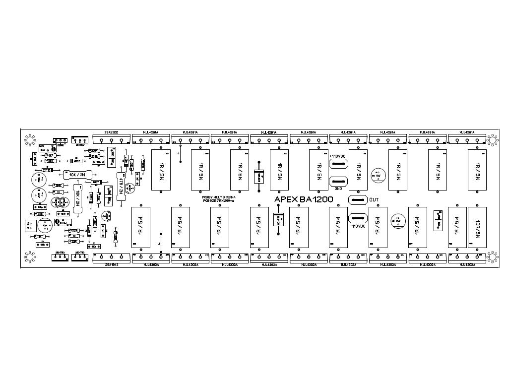

the BC560 can also used by nearly direct replace. To reduce the voltage (Vce Voltage) only two additional resistors must be introduce in the collector lines. As an additional wanted effect occurs a lower thermal value above ambient (less power loss) even by enhance the idle current through the input differencial amp (3-5mA is a better value for good sound than only 1,3mA - the currently value).
This I have often realized by several high voltage audio power amps like NAD to avoid burned PCB areas arround the input stage with TO92 small signal transistors.
I use 3-5mA only for J-FET input differencial amp, for BJT 500uA-1,5mA for different VAS topology.
Time will show but I think that BA1200 will be popular diy amp. Single side pcb size 75x260mm with 20 outputs, power can be scaled... if I made different circuit nobody want to build it 🙂

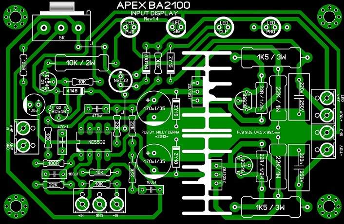

Balanced input, 30Hz 12dB/oct low cut filter, clip limiter, volume control, signal-power-clip-protect led display and +/-18V regulator all this circuit on single pcb thanks to Willy.

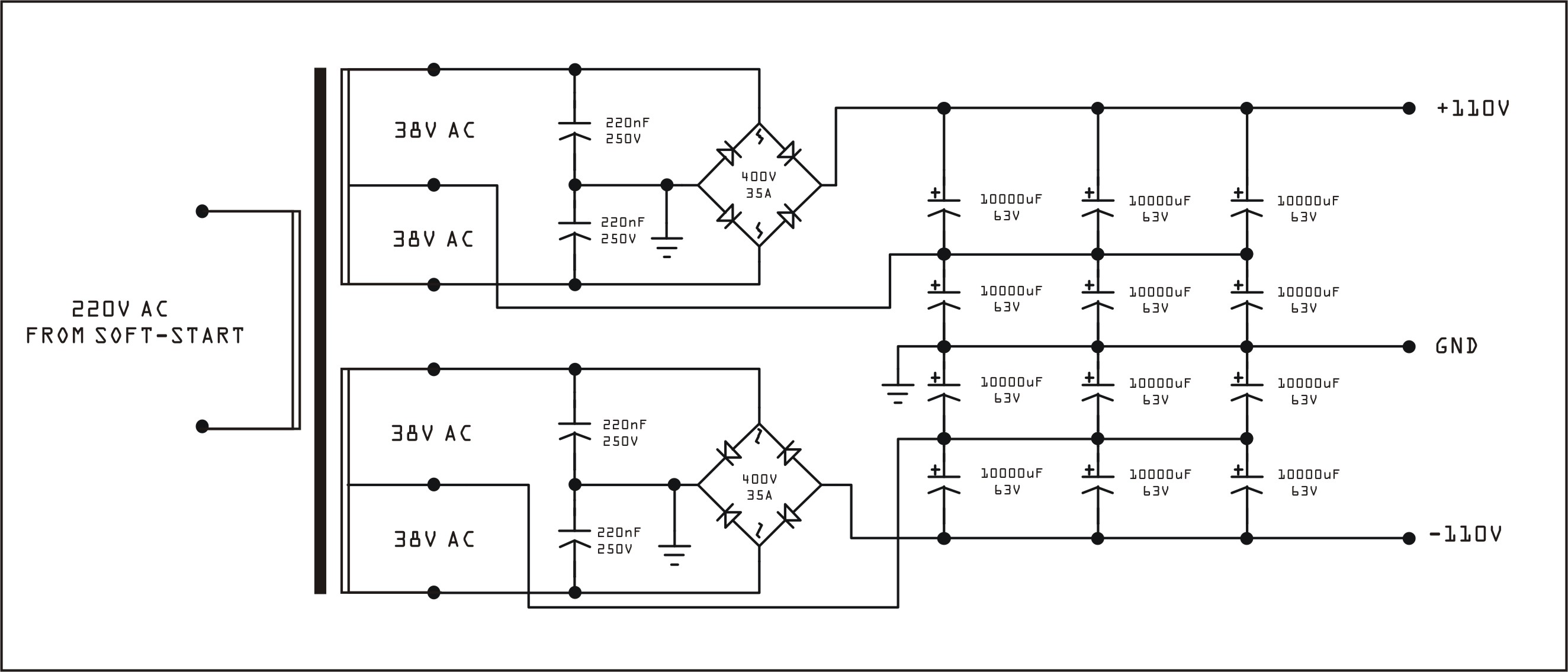

this supply will only see 15.000uF pr rail. that is a little on the low end. also the total ripple current will be low. and ESR high. one will need BIG caps to connect it like this. maybe 22.000uF and twice as many. so the price will be the same as if one use 160V caps🙂
Most of people can not find 120V or 160 V capacitors in their place, 10000uF/63V is easy to find anywhere for lower price than any other capacitor. Best solution is to reduce rail voltage to +/-95V and use standard PSU circuit with 6x10000uF/100V capacitors.
