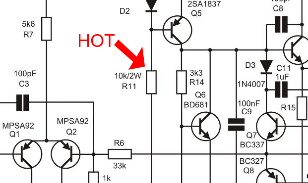

thanks for suggestions sir... 🙂10k must be hot (1.5W disipation), you can use 5W resistor.

Better to use a cascode medium power transistor instead of R11.
I want keep it simple.

By a lot of commercial amp devices this resistors are the main reason for burned PCBs, even by such brands like Krell and Mark Levinson.sir... R10k very hot to burn at the time played only a few minutes.
2volt bias b to b, and 90vdc supply.

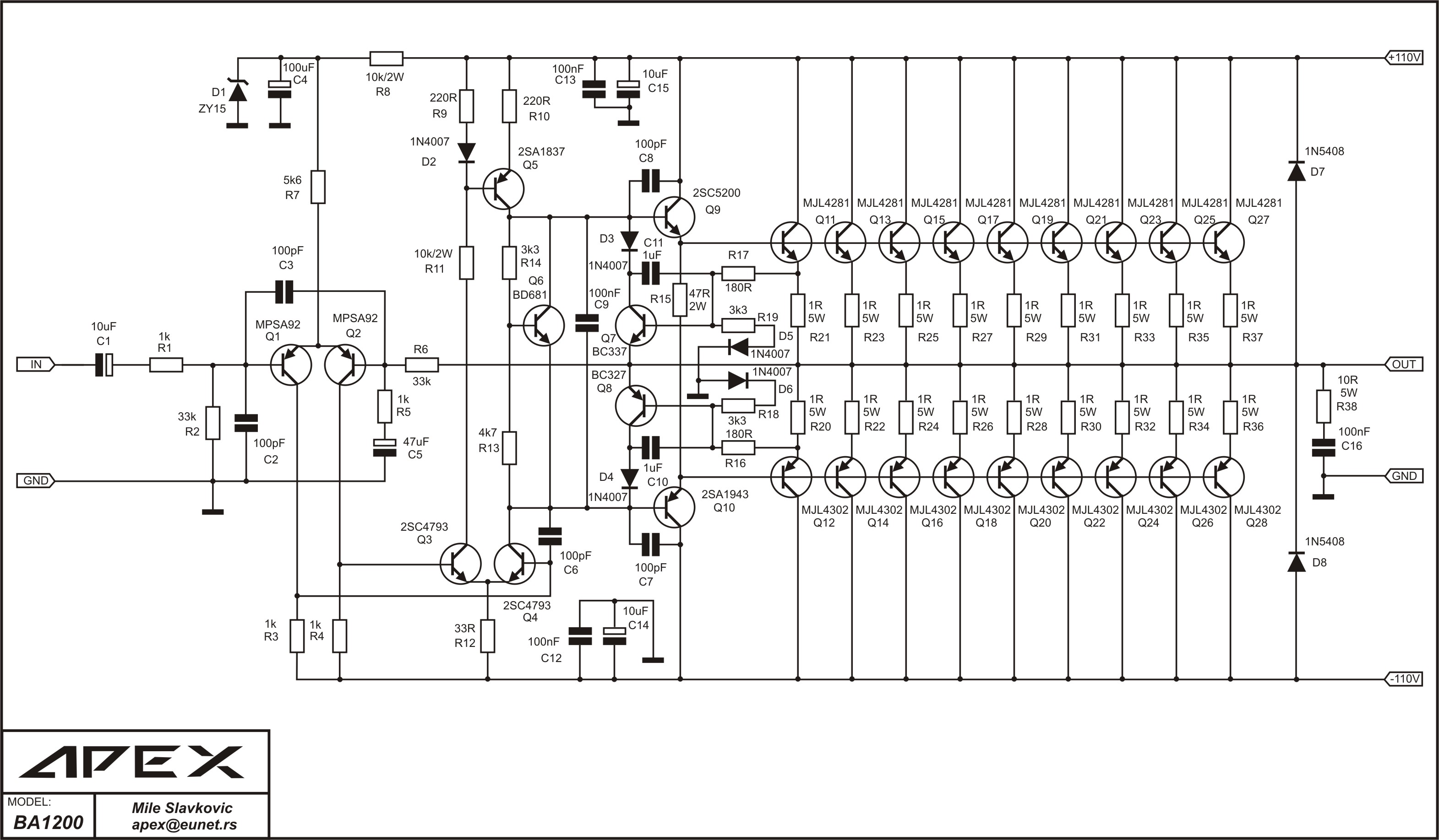

i need your suggestions ?View attachment 351294
By closed chassis cover the max temperatur at the resistor should be not more than 25 degrees (better 20 degrees) about ambient.
This means resistores like follow:
http://cfnewsads.thomasnet.com/images/large/015/15067.jpg (for heatsink mount) or
http://img.directindustry.de/images_di/photo-m2/max-250-k-x003a9-5-250-w-001-1-mal-13783-3434033.jpg
http://hifibau.de/product_info.php/info/p15_Leistungs-Widerstand-50-Watt.html
Another solution is the use of 8 or 10 smaller devices in serial mode.
By the use of a TO126 outlined Transistor there is the possibility of chassis mounting (base connected to GND). Nevertheless those approach is simple, too.I want keep it simple.

It's simple to add transistor instead resistor but this transistor need heatsink...
would upright mounted cement be better cooled ?
but maybe 5 series mounted 2k/3watt mounted upright in a circle ?
That's would be too large.
I think better is use a medium trans like MJE350 + small heatsink.
reminds me, I have 'some distance' I need covered, so I could just as well use a 40mm 10watt, horisontally 😉
but this is good info to have before final layout, thanks!
2 resistors 4k7/2W series in vertical position will be ok for 1,5W disipation.

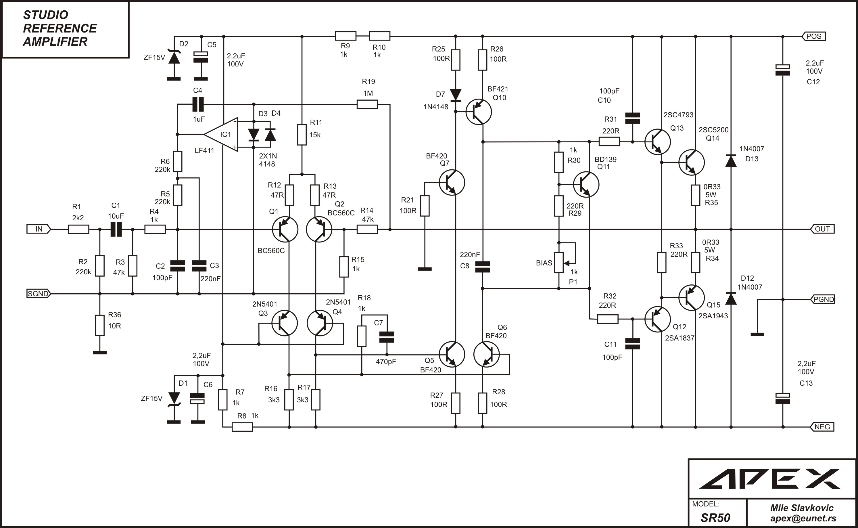

http://www.diyaudio.com/forums/solid-state/173462-studio-reference-amplifier-3.html
I use transistor in SR50 but there is no need for heatsink.
Why do you don't cascode LTP input?!
MPSA92 have low gain, low Ft. Cascoded them with small signal devices like BC560C to get more better result.
And add an active CCS.
"Keep it simple" seems to be your excuse for sub-standard design. This is very sad.🙁
Moreover, there is no way your choosen output transistors will safely operate from 110V rails without SOA violation with real loads. No way at all.

I can design high-standard amplifier and I already did, but nobody don't want to build that amplifier, and this amplifier already was made by several people.

I was considering cascode LTP with zeners but I want to keep it simple, and 2SA970 can be use for LTP or some better transistors. SR50 use cascode ... and this amp is not popular at all. I don't want to build this amplifier it's only for people who want to diy it for fun.
Moreover, there is no way your choosen output transistors will safely operate from 110V rails without SOA violation with real loads. No way at all.![]()
Simple VI limiter keep current at 0,6A per output in shorted amp out or 3A per output with 50V output voltage.

the BC560 can also used by nearly direct replace. To reduce the voltage (Vce Voltage) only two additional resistors must be introduce in the collector lines. As an additional wanted effect occurs a lower thermal value above ambient (less power loss) even by enhance the idle current through the input differencial amp (3-5mA is a better value for good sound than only 1,3mA - the currently value).Why do you don't cascode LTP input?!

This I have often realized by several high voltage audio power amps like NAD to avoid burned PCB areas arround the input stage with TO92 small signal transistors.
