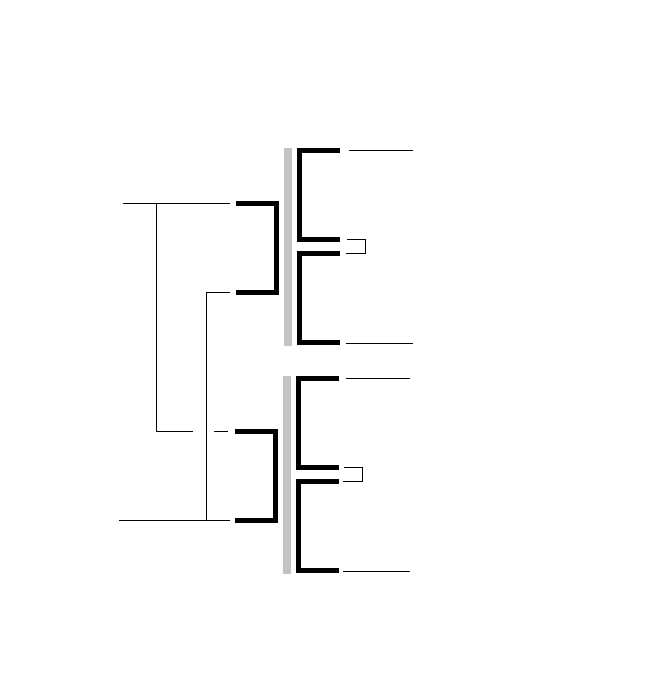

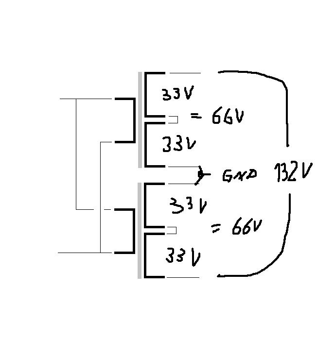

phasing...good to know, thanks

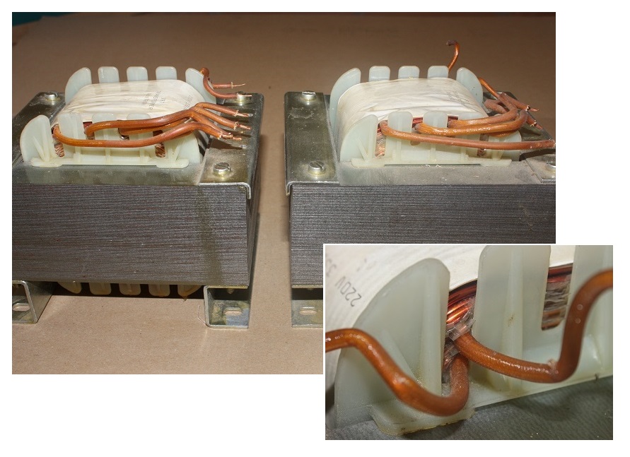

I thought they were 500VA, but clearly says 6A
but 800VA in series wil be ok 🙄
With 2x66Vac voltage 800VA is ok
so far it fits 🙂

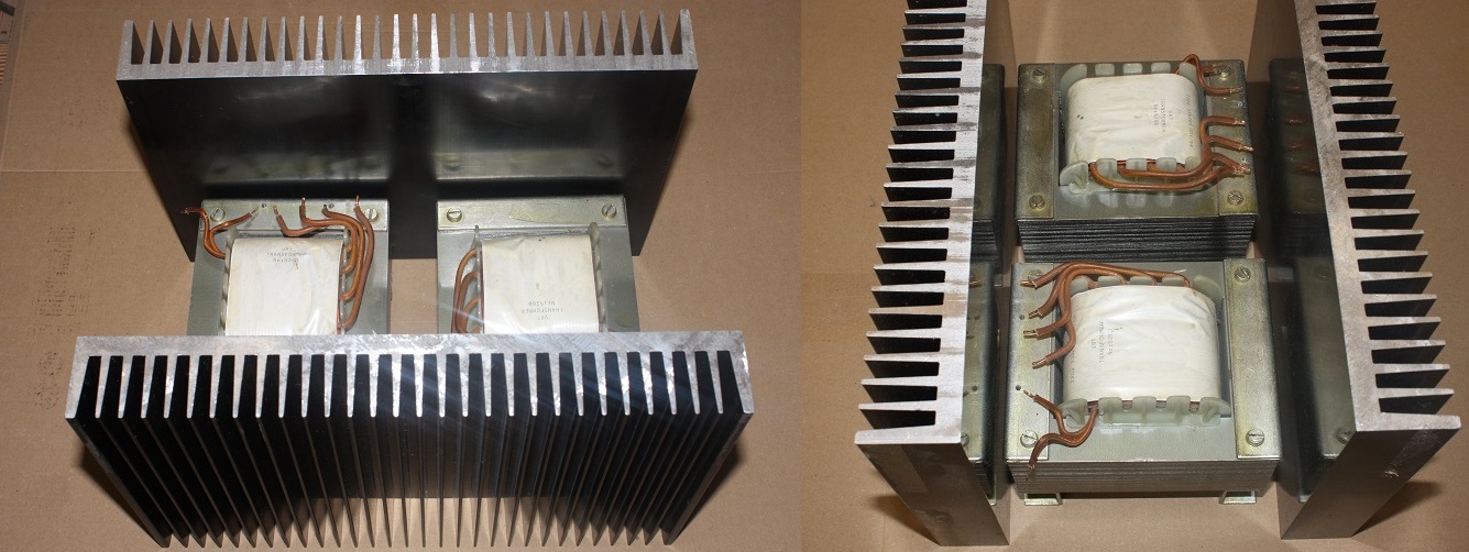

btw, trafos will be 'immersed' in a sub-chassis below the heatsinks
just hope it wont cause trafo induced hum
Nice heatsink😉
so far it fits 🙂
You can shield your transformer
Nice heatsink😉
classA heatsinks🙂
300 x 200mm

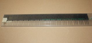

8x MJL21193, all 526-527mV
8x MJL21194, all 520-522mV

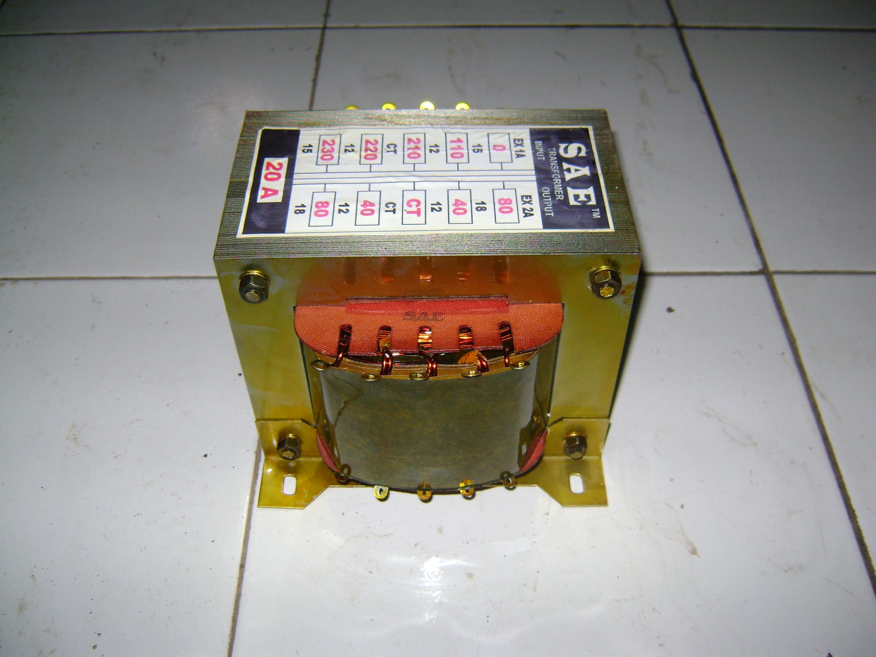

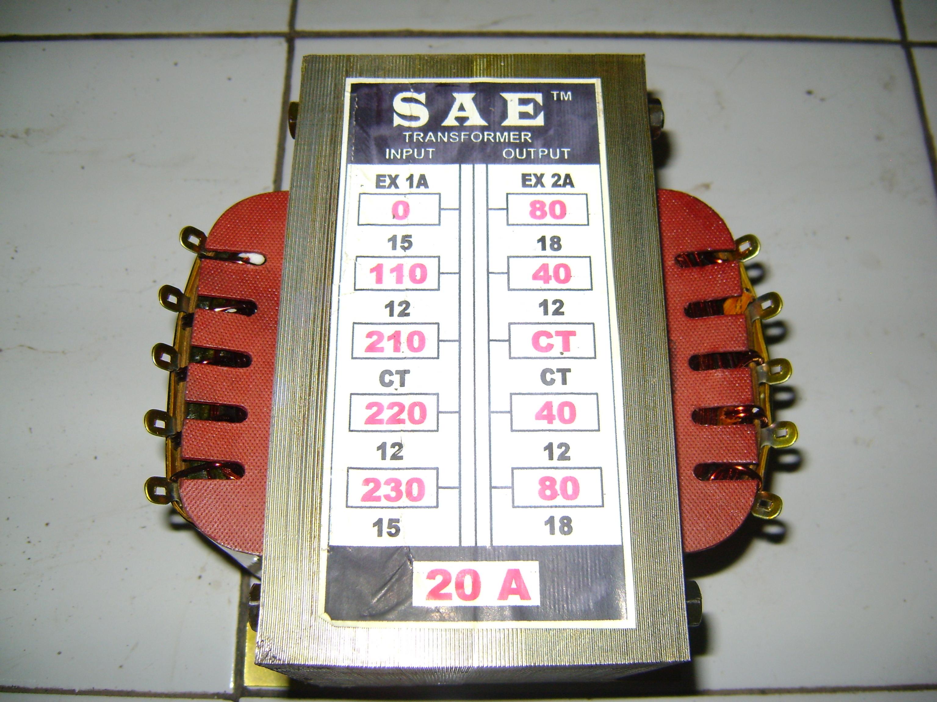

whether such a transformer can be used also for ba1000
80.40 ac ct 40 80
This transformer is very heavy +- 23kg.![]()
160Vx20A=3200VA?
trafo ac 80 ct 80
yes mister,,, can for stereo?,
160Vx20A=3200VA?

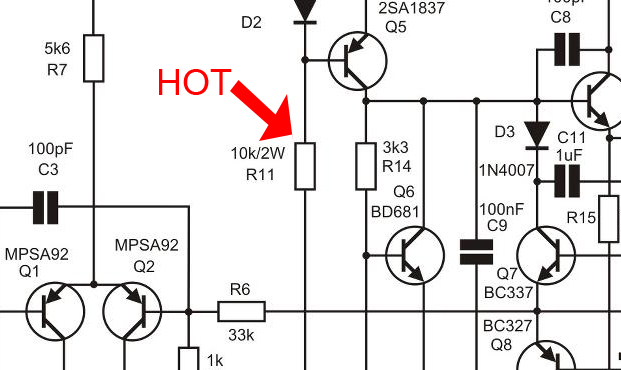

sir... R10k very hot to burn at the time played only a few minutes.
2volt bias b to b, and 90vdc supply.
i need your suggestions ?View attachment 351294
10k must be hot (1.5W disipation), you can use 5W resistor.
