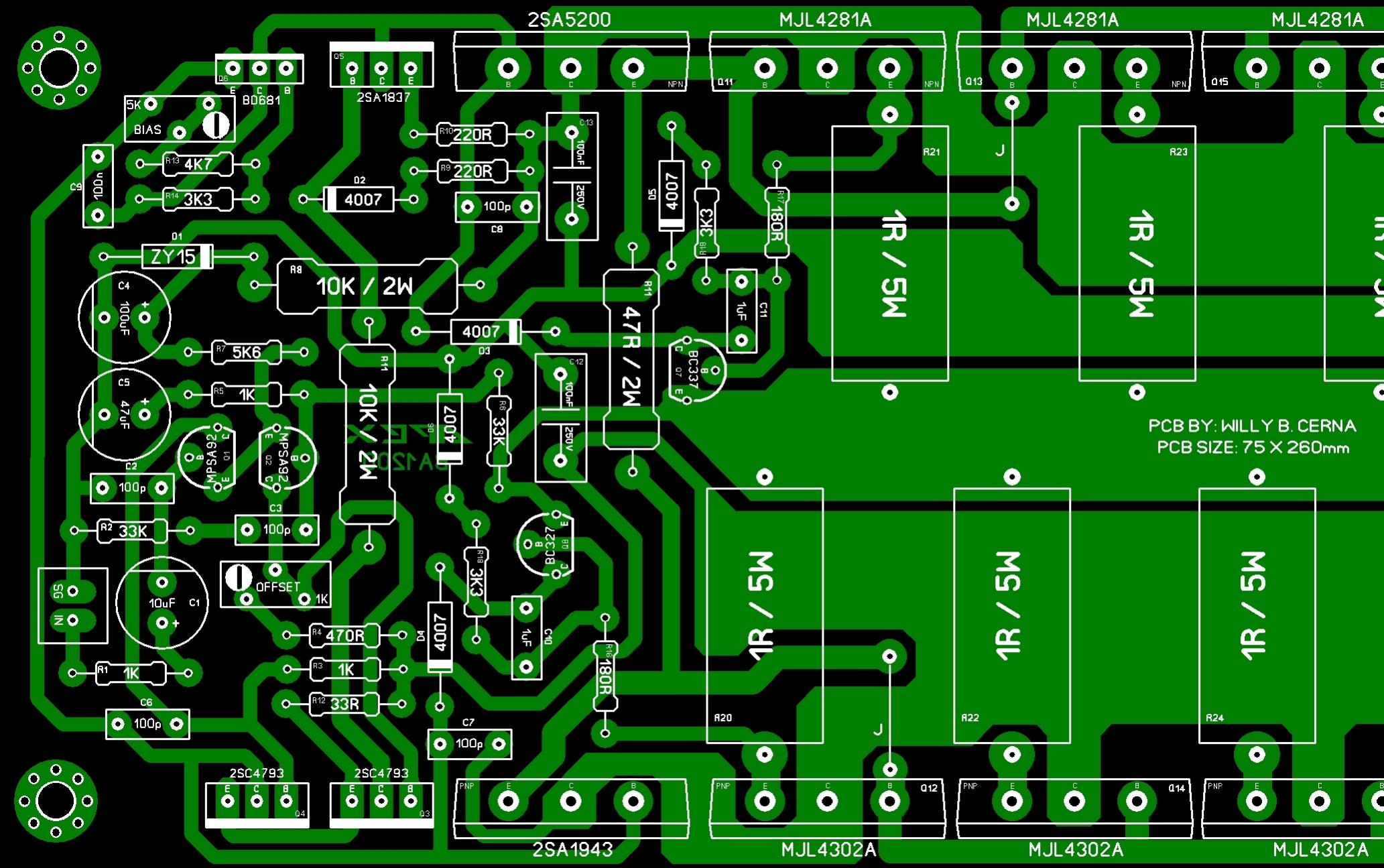

Pots for bias and dc offset can be add
What about this?
What about this?

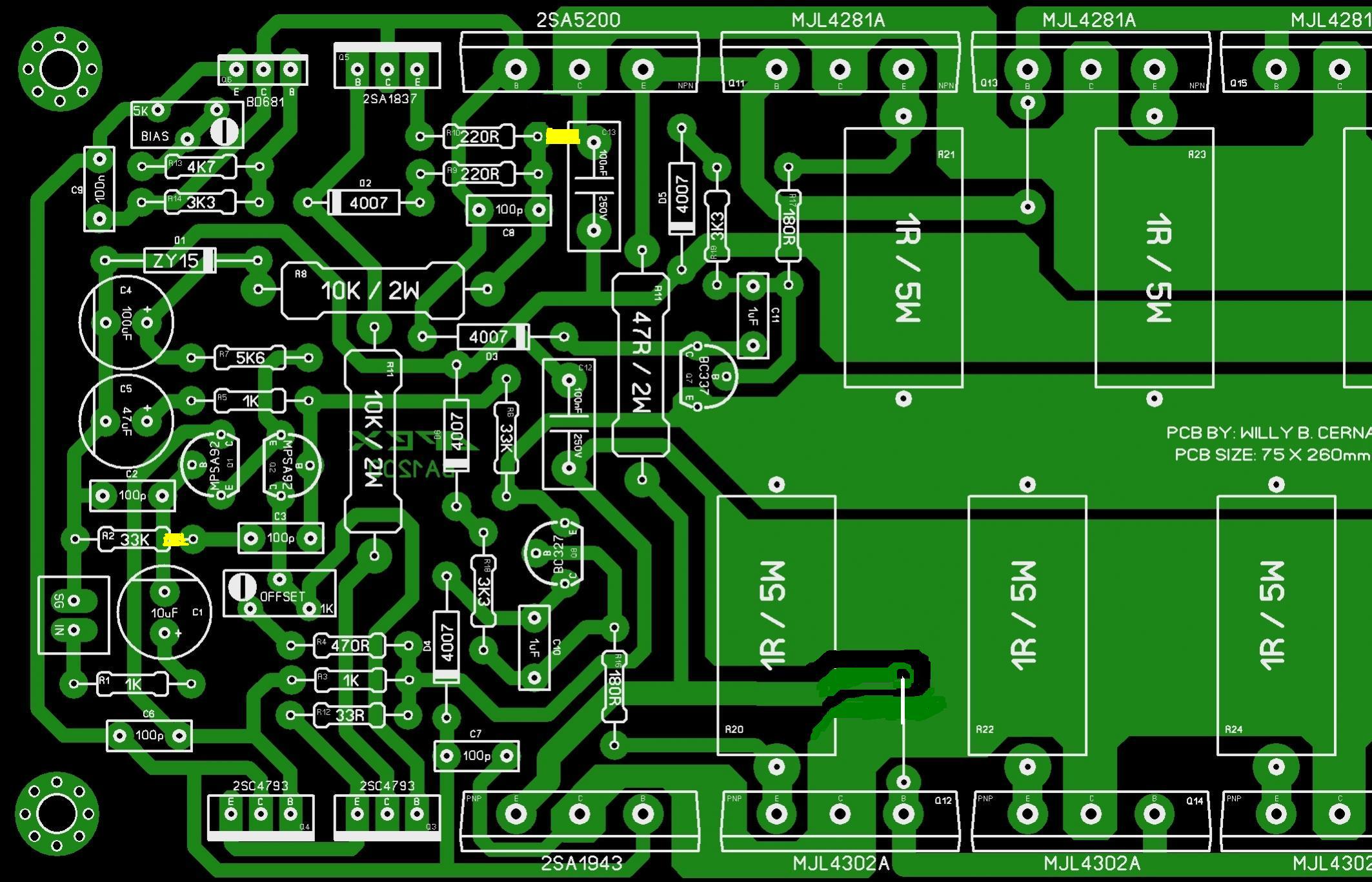

Only just two changes and MPSA92 can be closer for thermal connect.
Ohhh.... i missed that sorry...

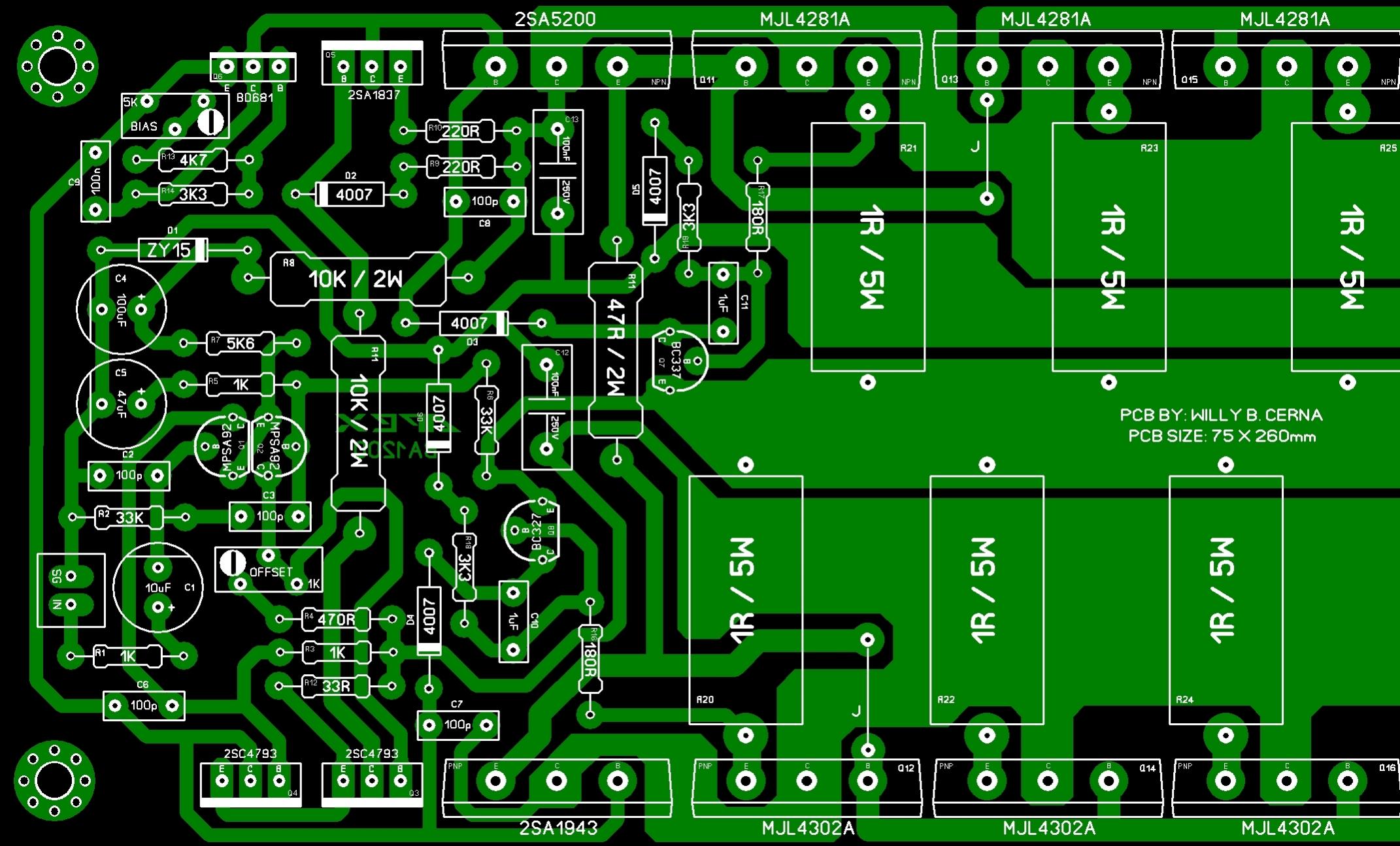

maybe this?
maybe this?
Track missing, and move MPSA92 case to case for thermal coupling.

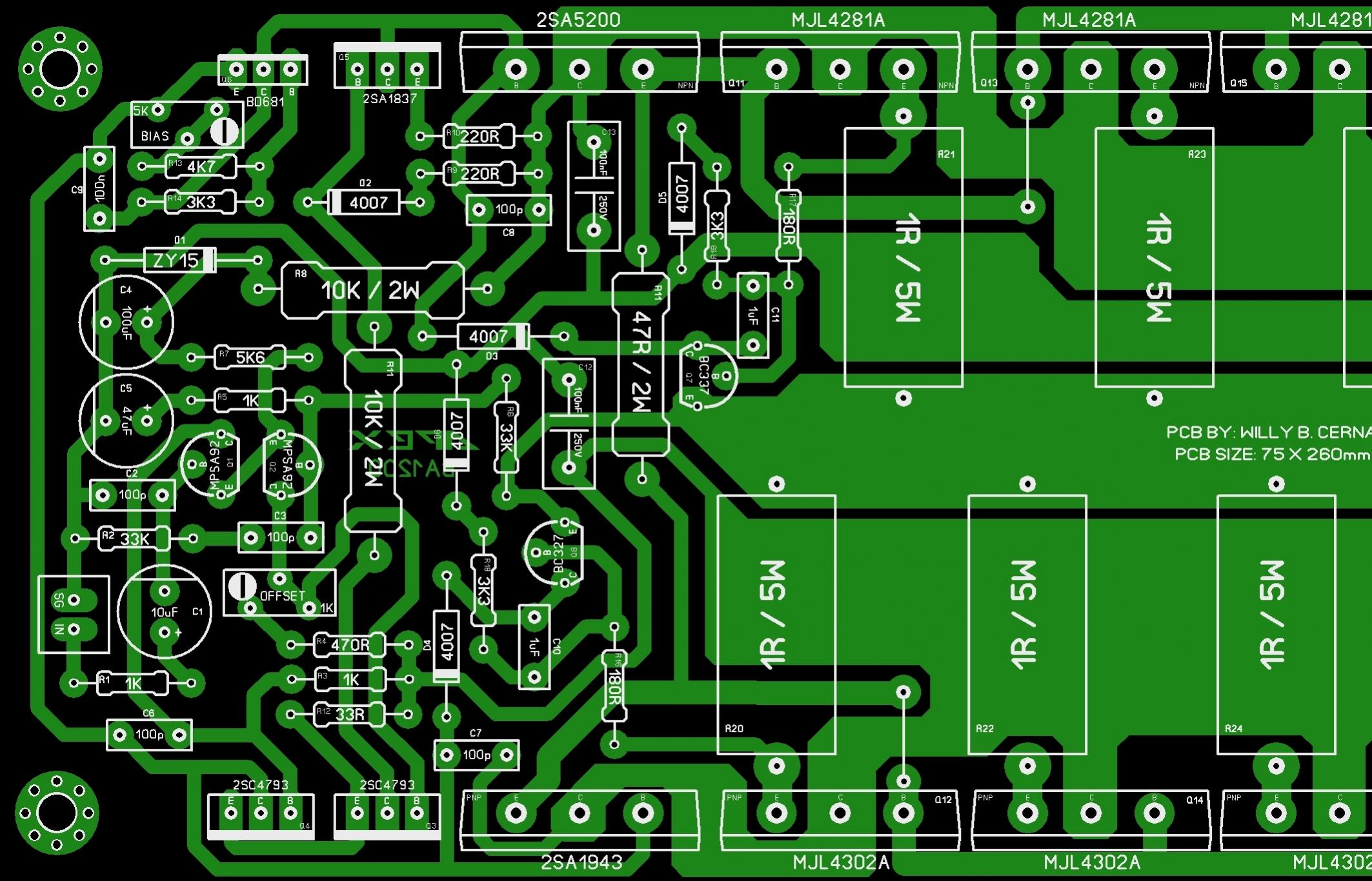

Ok...you mean like this?
Thank you....

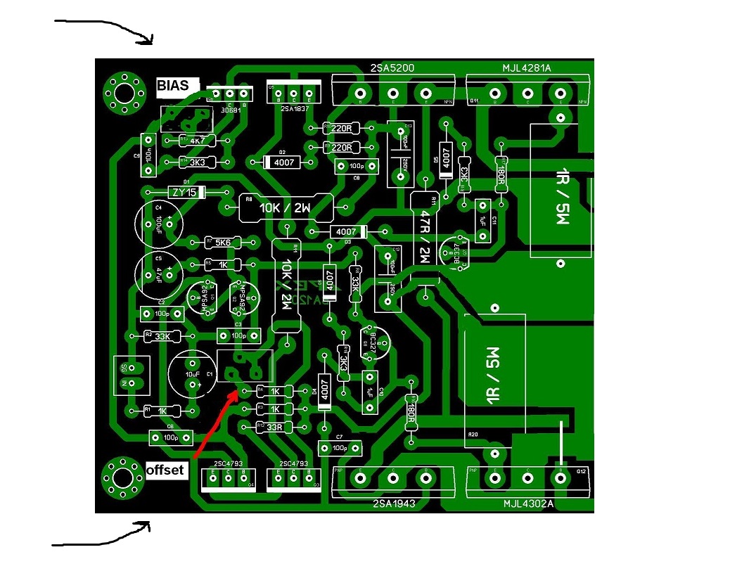

Look like distance between outputs not the same
Ok finalizing it now....
