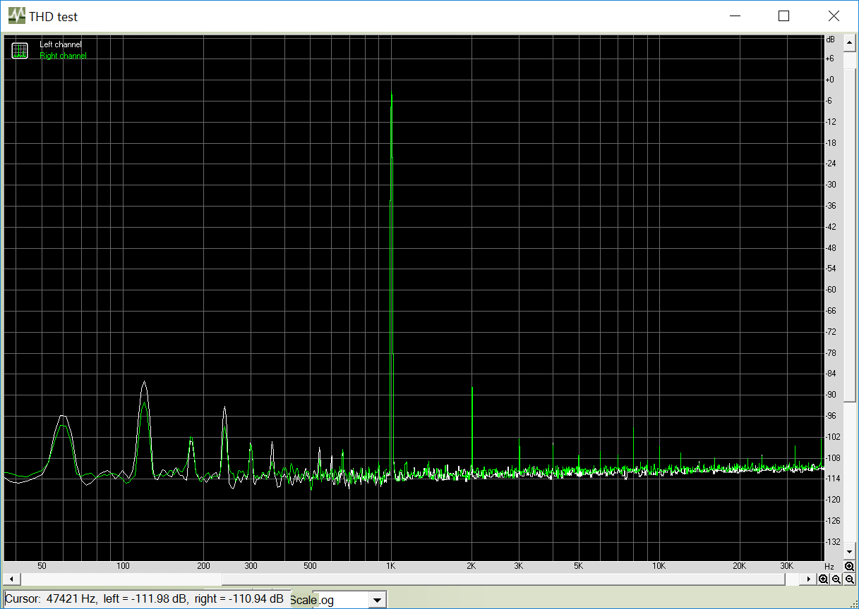

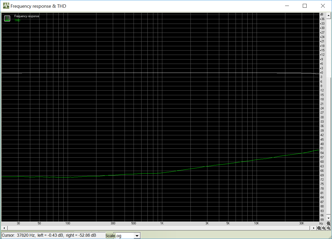

Measured Freq Response:
Measured FFT (24bit and 96kHz - but free version of RMAA only allows limited resolution with 51k points):

Focusrite Solo Loopback Test
Here is the loopback test to see what the limits of the self-noise is. This is fully battery powered as my laptop is not plugged in and the Focusrite is powered only via the USB cable. It is picking up 60Hz mains from the house wiring radiation? I have LED lights so no fluorescents to give off EMI. There is a similar harmonic profile as the DCG3 but at much lower level.
Nice to know that you also like it. Hint: There is yet more layering to discover when yours will be fully done too in a grounded metal box, Mogami coax, double mono Tx. Your FFts are far better now than in the start but your testing loop still appears having some lower level interference and residual THD issues even if alone. Some further investigation in software packages and settings, proper loopback inputs impedance, cabling, shielding, grounding, will sort those out eventually. Your DUT maybe is as good as in post#1 but can't fully see it yet through the loop or still bit unfinished at this phase. Could try the plastic cased monolithics also to have another reference. In any case well done up to now. Congrats :up:
