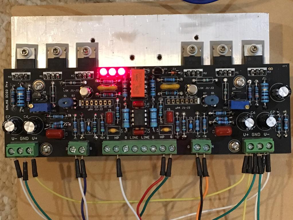

I just finished my DCG3 (Teabag board) tonight. The build was very smooth and it fired up the first time with 100mA bias. I had to adjust DC offset from 500mV down to 0mV. Then installed servo opamp. Listening to a few test tracks right now - very powerful headamp. I am using the shunt regulated PSU board from Prasi's HA project. Teabag's board is a pleasure to assemble - went together in less than 3 hrs and works the first time. I am using Idss matched DN2540's and Vgs matched IRF69610's, and Hfe matched BC560's. The LSK389's are from Linear Systems direct, and have been sitting in my bin of parts for 3 years and finally have a home here.

Hi X. Nice to see your build. Metal can Jfets utilized too. Cool. What headphone you use?
*That PSU has high output Z (as much as its noise cleaner section series resistor). Its a series chip regulated type with just a shunt noise cleaner. Otherwise it would have big sinks. Good for low noise but not to be sharing highly current swinging channels. I advise for either two of them or a low Z type, still better if two. Thick & short power rails cables use anyway also. There will be DC voltage loss too both on that PSU's series input and output resistors as well as on the long thin cabling. All those advised measures will be improving on slam, instruments differentiation, and resolution.

Now that I changed the R10s to 10 ohm my bias is running at 136/137 mA in L/R channels. The temperatures were after about 45 min with top cover on 46 C for DCG3 and 50 C for DCSTB middle sinks. I'm satisfied. Let's see when I find the time to complete wirings and get to finally listen to this beast.![]()
Good compromise solution for the metal hardware involved. That's not low bias, its plenty. No worries 🙂
