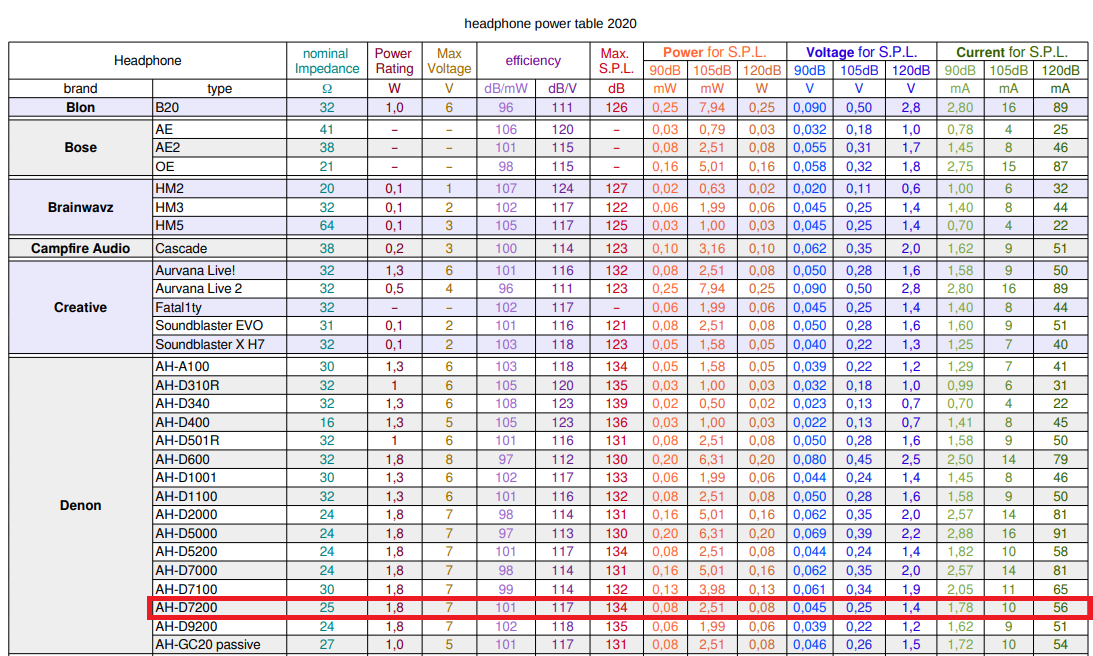

While searching online today for how much mW I actually need for normal listening and the maximum SPL through my Denon AH-D7200 headphones, I came across an interesting table.

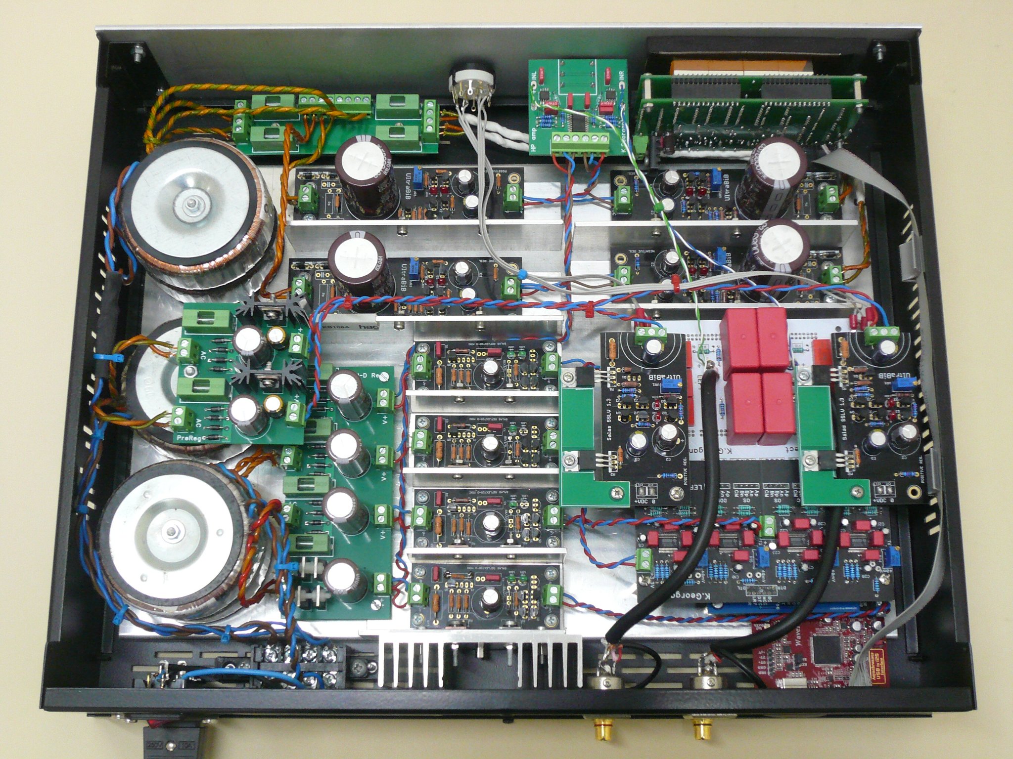

Based on this, I decided that setting the bias to about 110 mA would be sufficient, so I chose R10 (10R). I have omitted the large dimensional heat sink, and instead a 10mm thick plate with dimensions 160mm x 80mm will be used as the heatsink. This plate which will serve as the main heatsink will be screwed to the aluminum bottom of the Modushop SlimLine 2U case. I drew the board in a CAD program and sent it to the factory today, it will be made by the Slovak company QuickPanel. The plate comes already pre-drilled with M3 screws in black anodized finish.
When my UltraBiB PCBs arrive, I will add the same heat dissipation mechanism to them. 😀

For the DCG3 mosfets alone I think it will work and it has been done by others too but.... are you sure that this will suffice for UBIBs for normal weather conditions ?
I'm always skeptical about mounting big heat transmitting devices to the bottom of the chassis. I have a similar arrangement for my UBIBs and at the summertime is not optimal and I'm in the process of changing that, even relocating to a new custom chassis

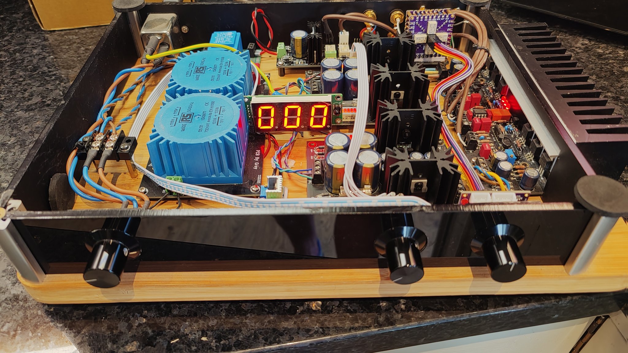

Can you post a detail photo of how you are currently cooling the UBiB, since it's so hot? For the UBiB, I plan to use a single 10 mm x 128 mm x 185 mm plate for both dual-mono PSU.
I have dismantled DCG3 but all my four UBIBs were standing (mosfets in horizontal position) on top of 160mm x 300mm plate/heatsink 15mm thick
I have two 19VAC EI core transformers which provide 23VDC so no extra energy needed to be dissipated via heatsink.
Yet the warm months it gets too hot.
In your application the bottom plate (3mm thick) is gonna act as additional heatsink for the preamp but also for the UBIBs. Remember it's a class A design and UBIBs will have to provide extra current.

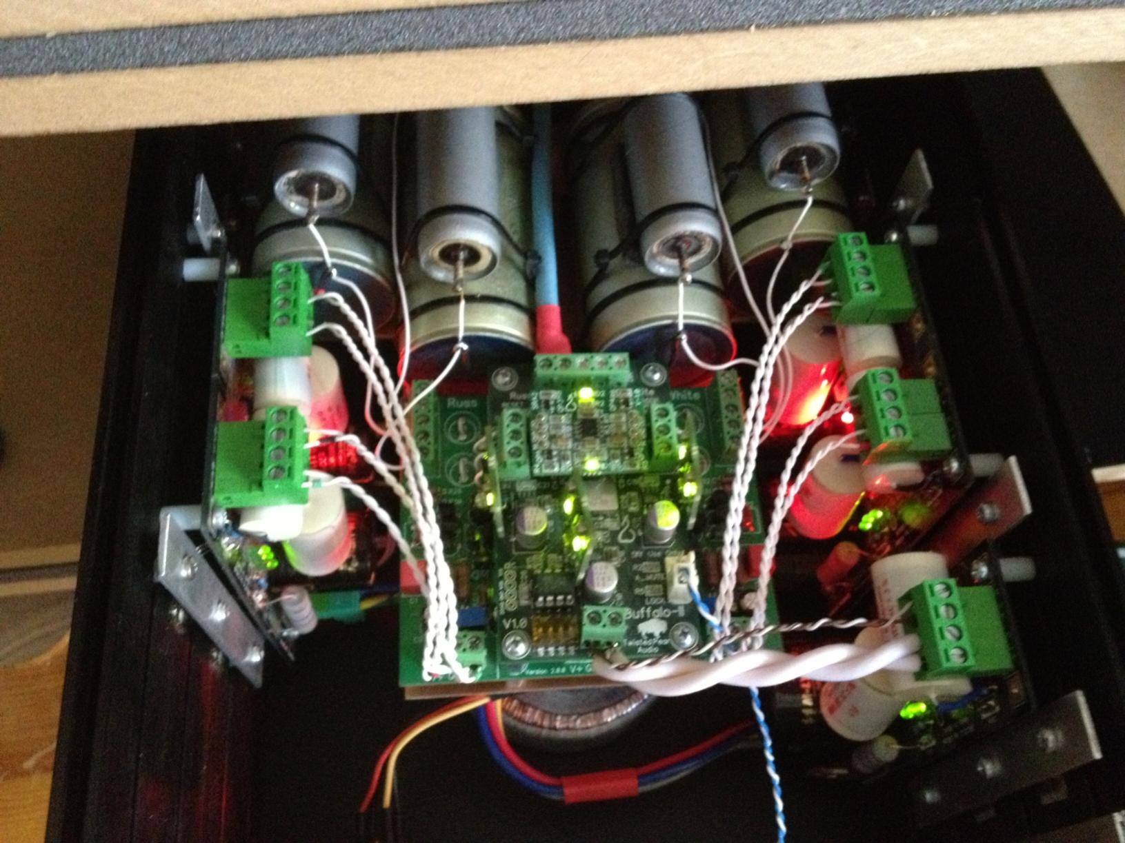

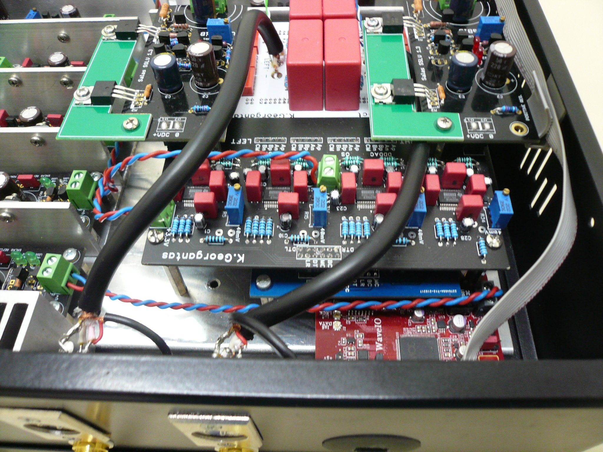

I've used UBIBs in my DAC. In a particular position, there was no room for big caps and heatsinks. You can see them with the mosfets mounted on small green PCB leftovers mostly for support. R1=3,9 ohm so CCA=150mA and Vout=8V. The chips roughly consume 50mA. I got it running cool using preregulators -linear LM7812. According to UBIB manual, even smaller Vin-Vout margin could work.
That reminds me of a DAC I've build for a friend of mine, 5 BIBs and 2 or 3 Reflektors. In the end my friend sold it and his biggest concern was the heat.

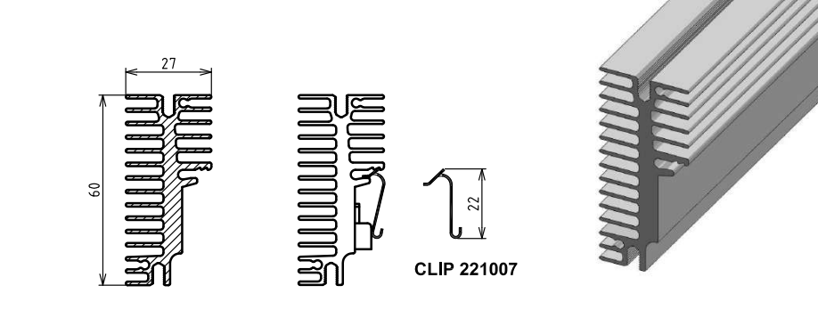

In-Out Vdif and CCS current level are central to heat management because M1 runs at full constant current while M2 shares some with the load.
Salas, in my case on M1 0,3A/ 25V DC, the transformer is 18V AC (7,5VA loss) and on M2 0,12A / 17V DC (2VA loss). I ordered a quotation for the ZH 7505 heatsink in black elox from a Slovak company. The heatsink will be 128 mm long. The heasink has Rth at 100mm 3,21°C/W, will it be enough?
4x ZH 7505 for dual mono UBib

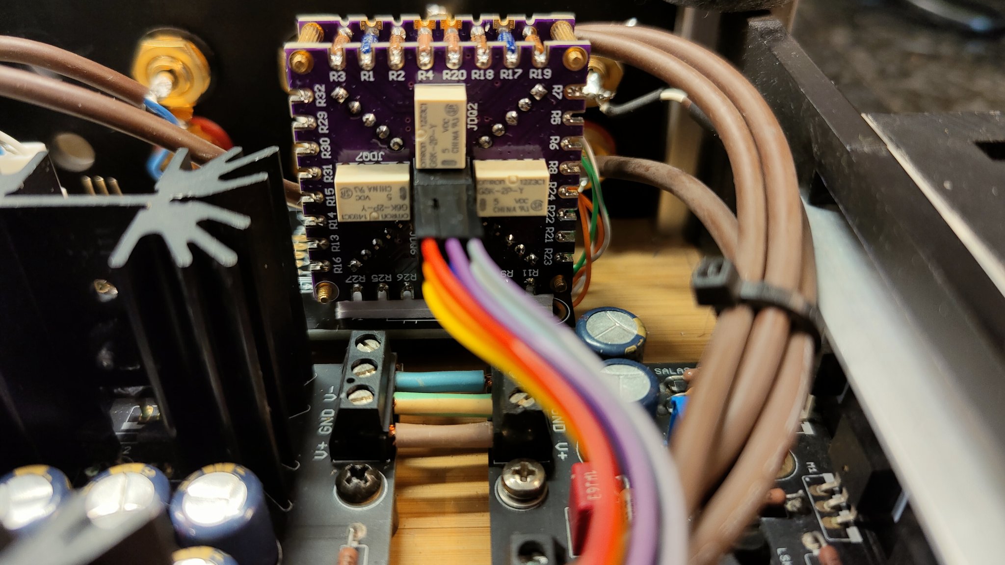

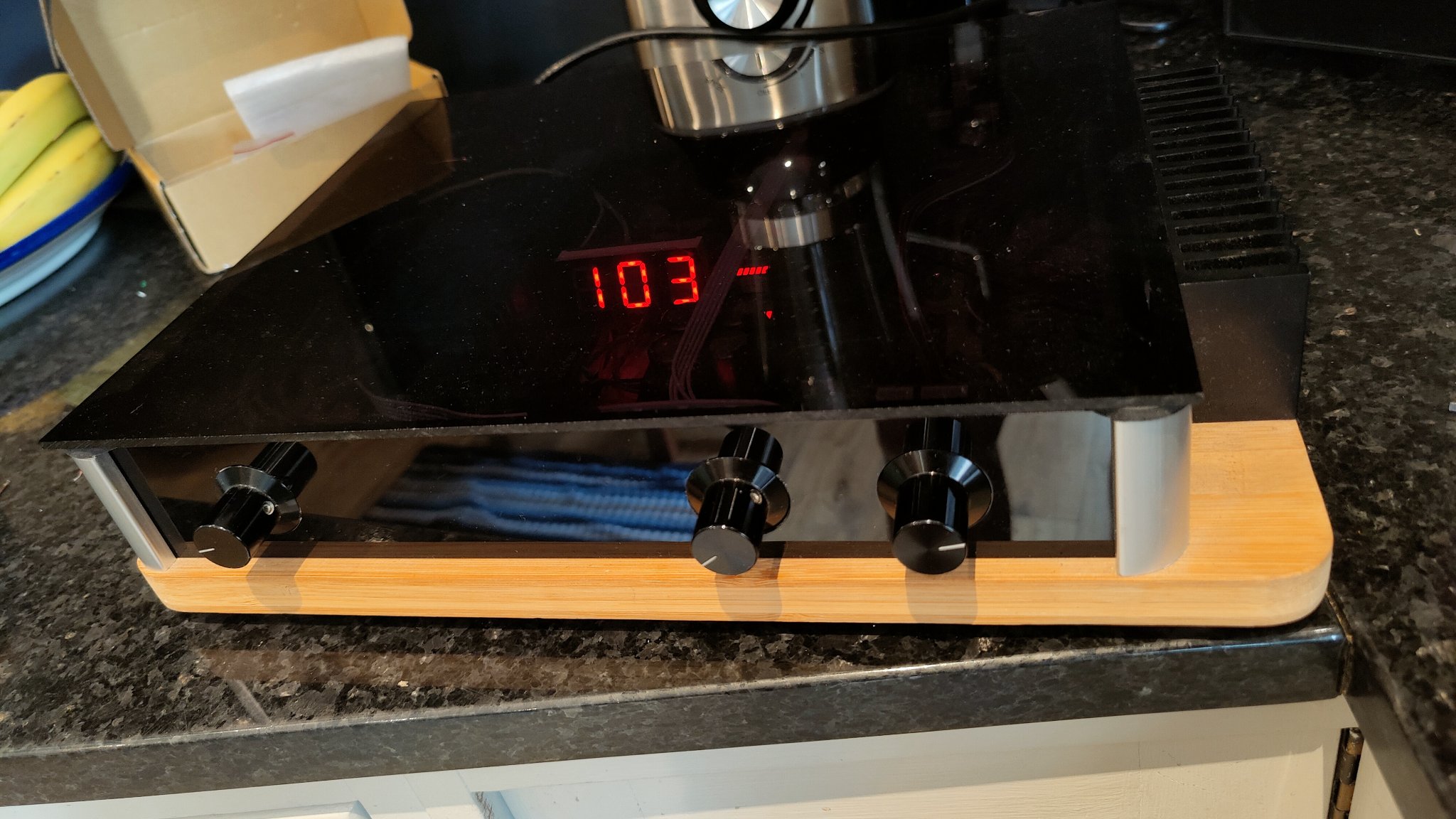

Little update after many years of happy DCG3 listening. It is in use every day as it does TV duties also and is pretty much left powered on 24/7.

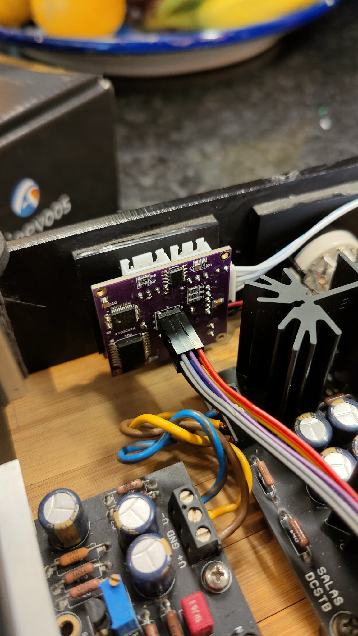

Due to the TV use I wanted to add a good remote control volume solution. Having read good things about the 'W-One' resistor ladder relay volume control, I thought I'd try to implement one in my DCG3.
I initially had a 20k DACT type pot mounted directly to the In-Select board. The W One is a constant 50k. The DACT would be at full volume all the time and I would use the digital volume control in the DAC/streamer, but I wanted to set this to fixed full output as it should sound better this way, and then use a remote volume in the DCG3
Here is the item
https://a.aliexpress.com/_ExE2DeK
Patrick (Euvl) has been using them on his F5 Preamp project, albeit tweaked to his requirements.
I had some initial problems with the remote not working but I seemed to fix it, the IR was in backwards it would seem. Link to my thread about that ..
Thread 'Help with W-One ladder relay attenuator remote control' https://www.diyaudio.com/community/...adder-relay-attenuator-remote-control.427834/
It took quite some work to get it in place and now that I have I have a worse sounding pre amp! I have a slight crackle on one channel at certain frequencies, hopefully just an installation issue, but I also have some weird phasey effects and also the whole thing seems much brighter. (Described in the above thread post #12)
Post in thread 'Help with W-One ladder relay attenuator remote control' https://www.diyaudio.com/community/...attenuator-remote-control.427834/post-8028518
So I have a little more work to do to bring back my DCG3 to health. Annoying but there you go!
