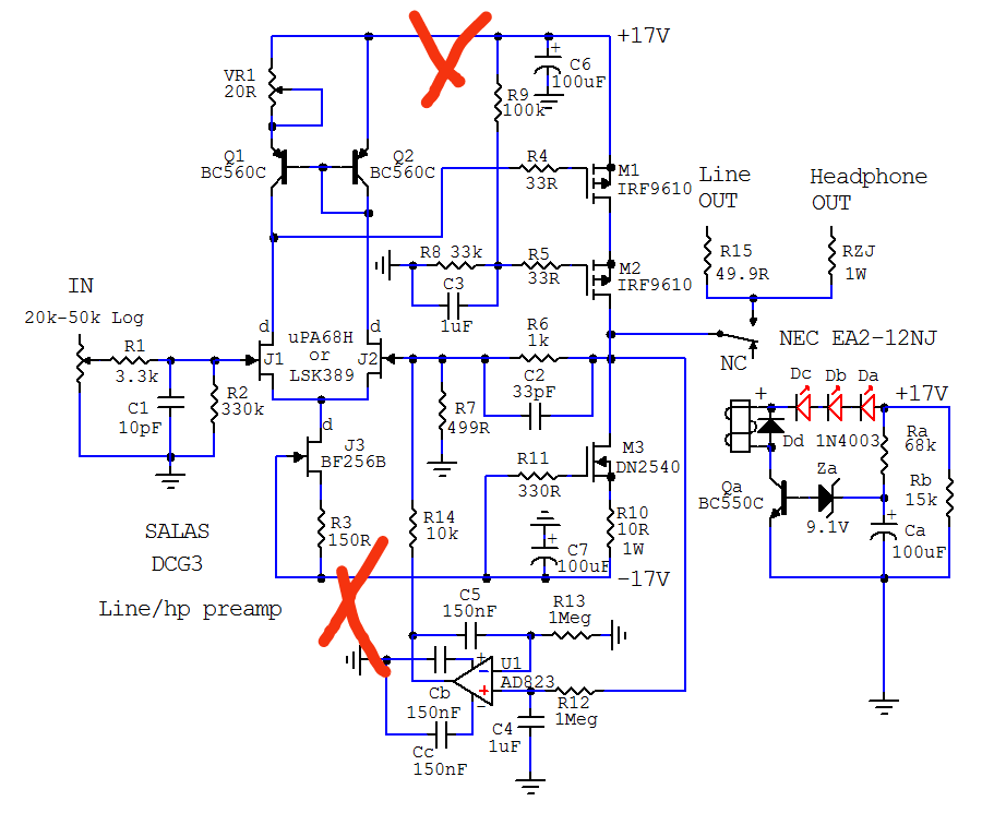

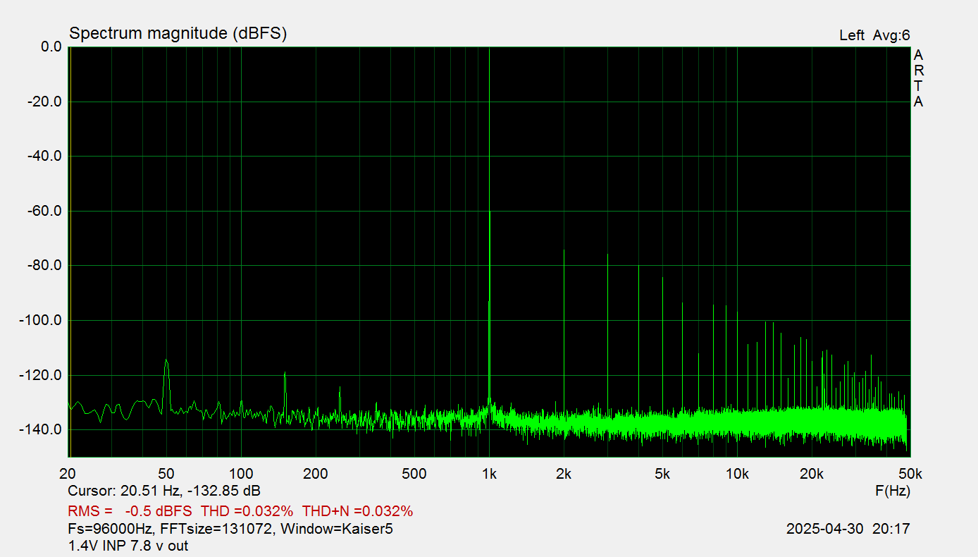

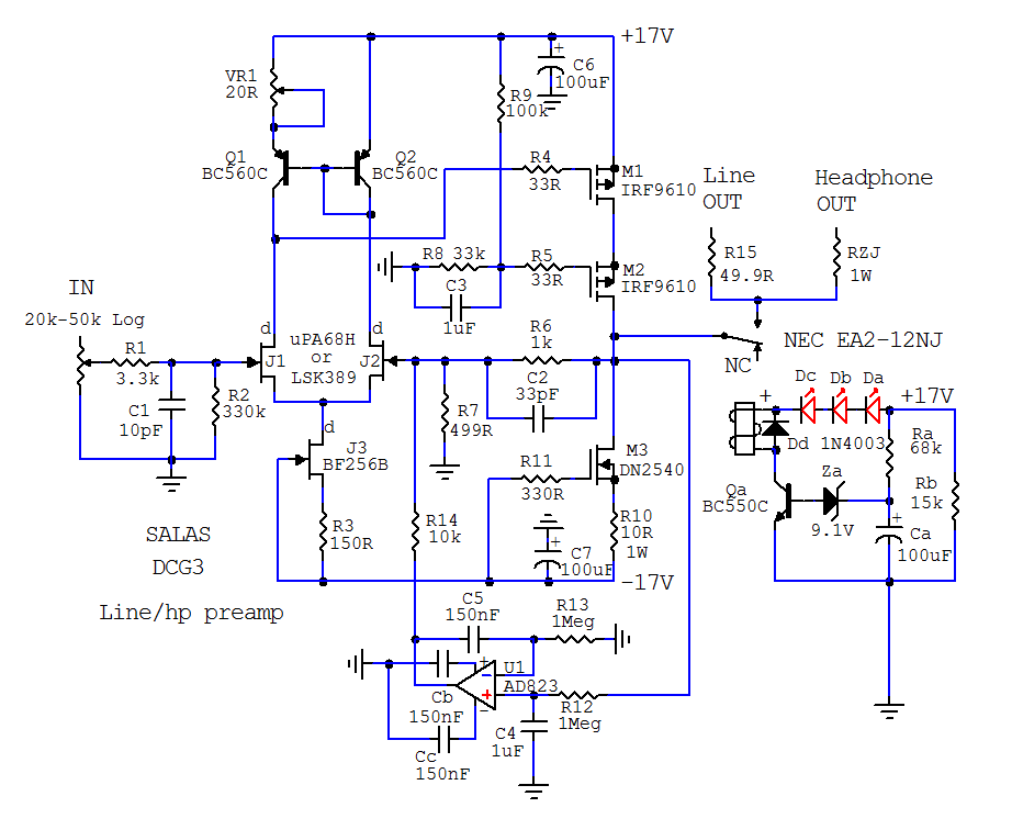

Peak Max & Peak Min look like they hit the rails. CD red book is 2V RMS max and X10 makes it 20V RMS i.e. 56.6Vpk-pk. Would need +/-30V rails to accommodate that.
How to split the circuit for 2 power supplies one +/-17v for input , servo and relay and another one +/-30v for output?
Don't do anything before I simulate it later on in the day to make sure there's enough drive from the input stage with split stage supplies of so much difference. The output stage adds gain in this circuit, its not a current follower, but lets see if it will hit high rails with acceptable distortion as a whole.
If promising, you will have to hack the PCB rail lanes just before feeding the Mosfets but including the R8 R9 cascode voltage divider. Changing R8 to about 20k keeping around the same M2 gate bias voltage as now. Also, the Mosfets dissipation is going to go way up by applying to them almost double the previous voltage. See to keep them cool, especially M3. And don't push the output stage bias current. You could possibly need extra local rail decoupling caps like C6 C7 or smaller value for the rest (input servo relay) if there will be instability.

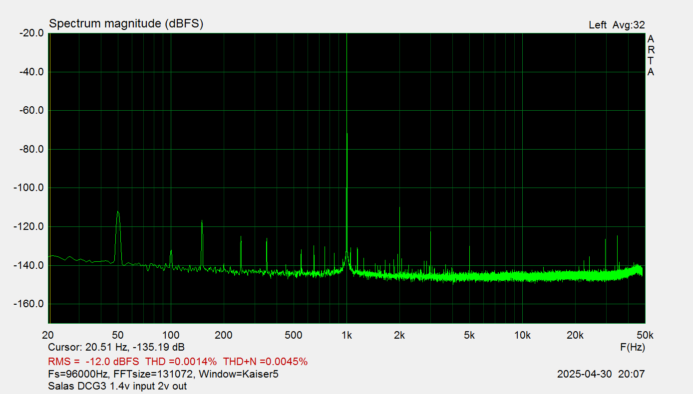

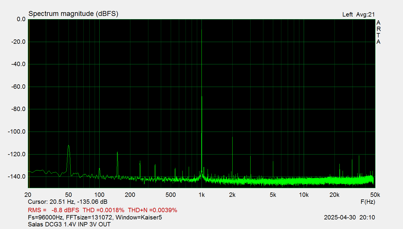

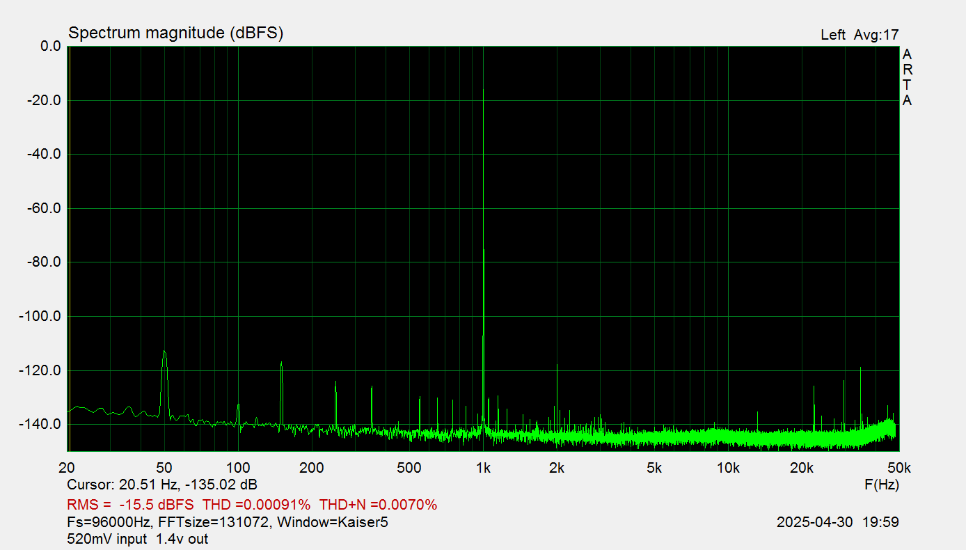

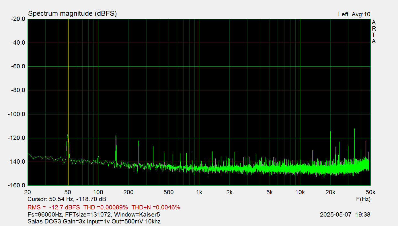

thimios, wonderful results! Can you shed some light on the test setup? Is there any resistance (like a potentiometer) between the generator and the DCG3? I ask this because Salas has indicated that different values of input pots affect the performance. Also, can you test at a higher fundamental, like 10K or 20K? Thanks!

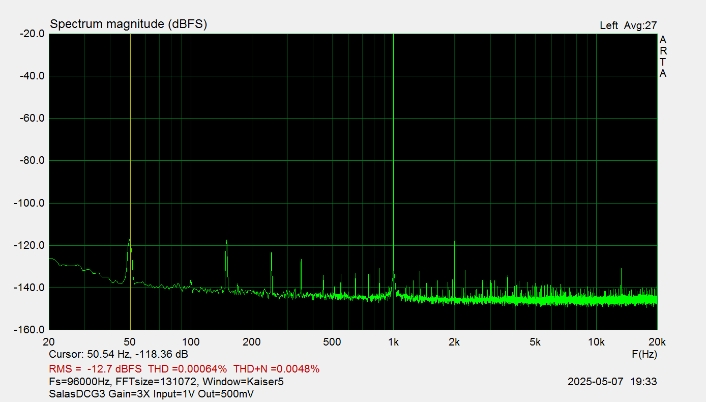

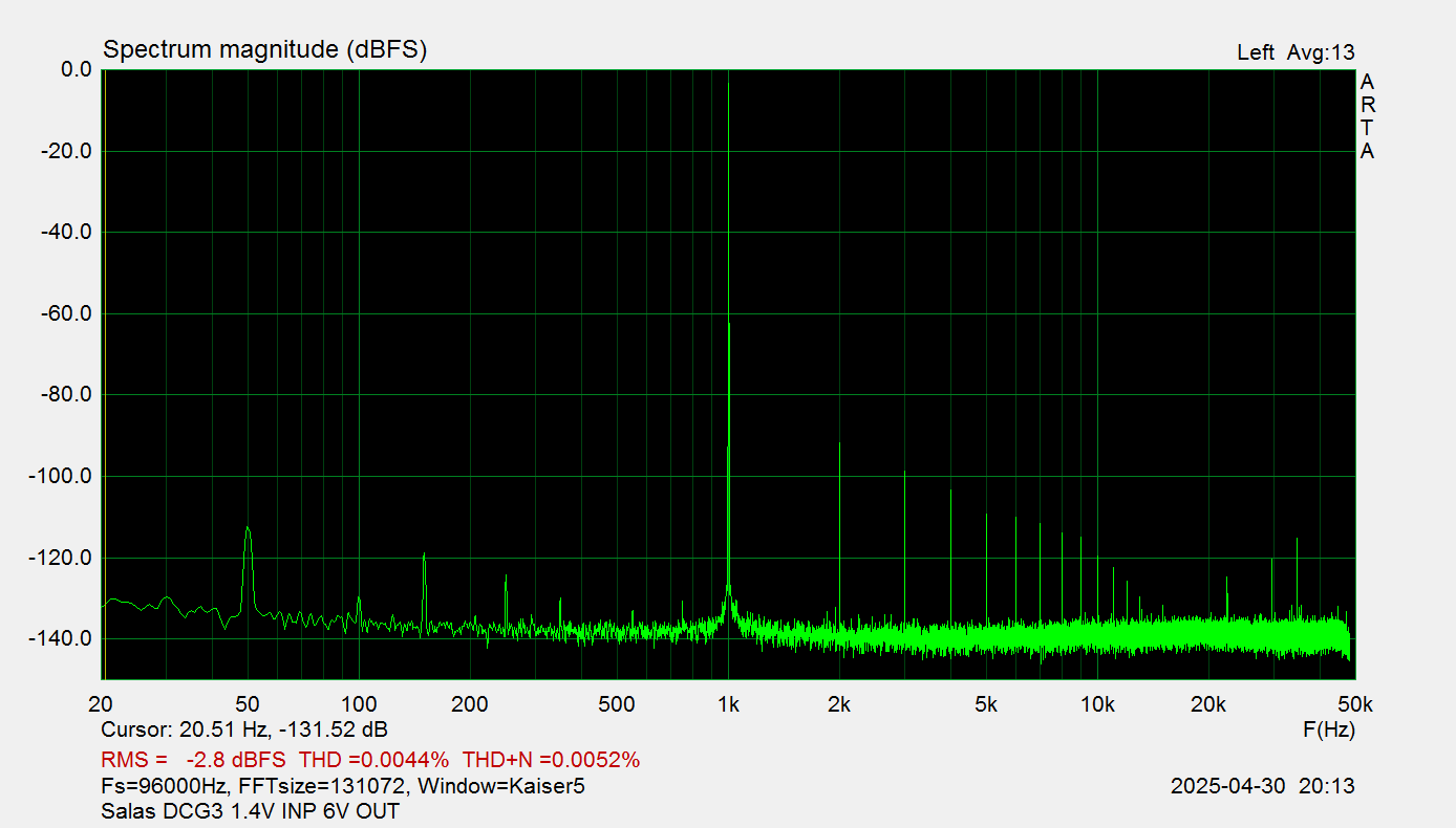

Yes,if you look text right bottom of plots(except the 1st one),input signal is 1.4 v RMS.
Output controlled with the volume potentiometer connected at the DCG3 input.
I can do a 10K and 20K fft , maybe tomorrow or today latter.
Thanks Salas,short answer,No DCG3 can't drive the F4 at full power.
I will go for a circuit called,"Yes it can drive the F4".
In the mide time I will restore the DCG3 for pevious gain.
It would take extensive modification to do that. Namely high rails for the stages plus regulation to lower for the servo and delay. Also not practical with dissipation on high rails because of SE Class A. Maybe a three stage circuit with a push pull follower output is better for your purpose.
IMHO just put DCG3 back to 3X and remeasure it to know its back in good order.
*By the way, for your future measurements to drive the F4: As signal voltage rises high it takes an attenuator to avoid audio interface input distortion contribution. Beyond a critical point different to each such interface.

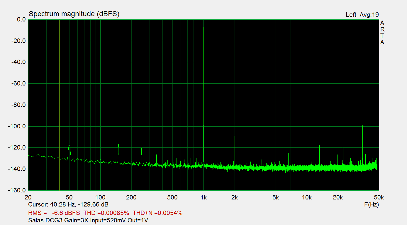

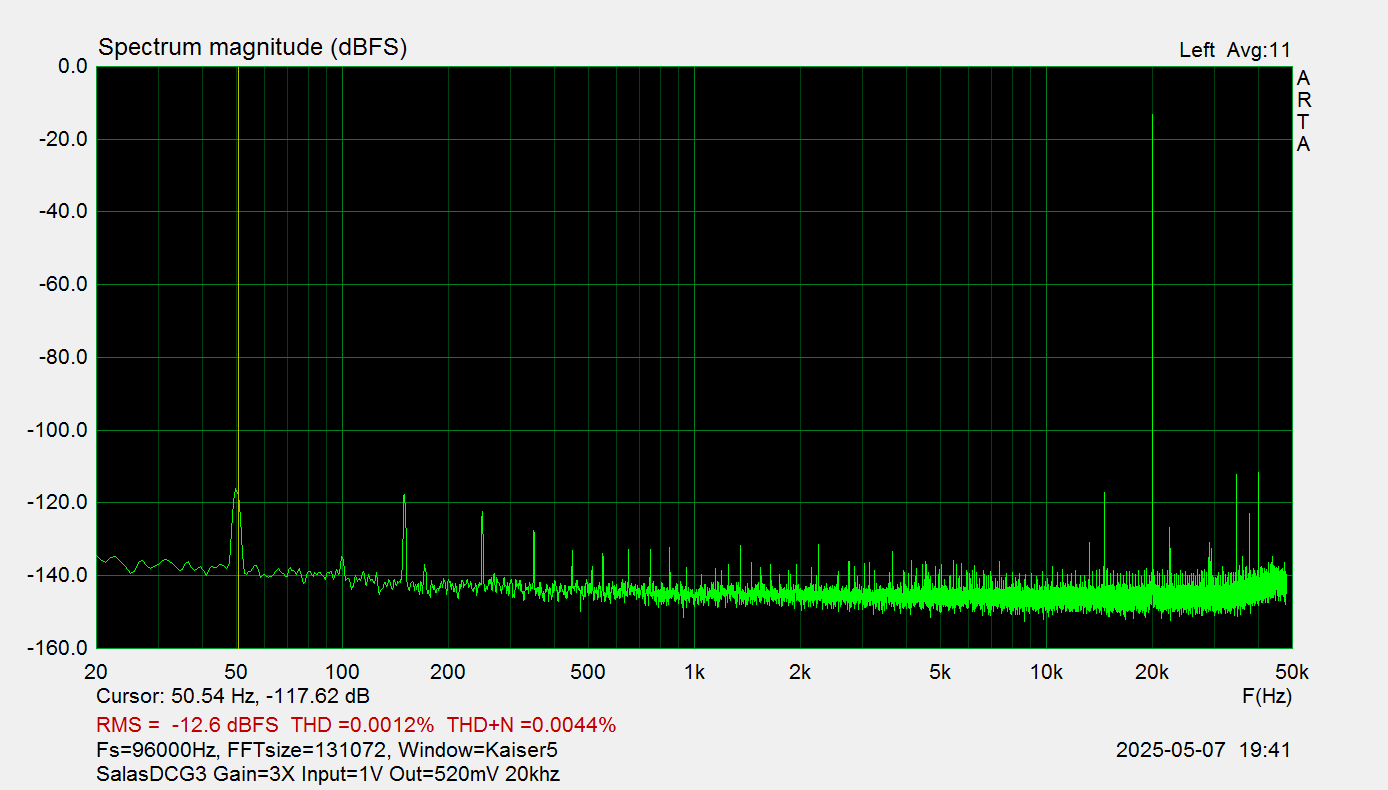

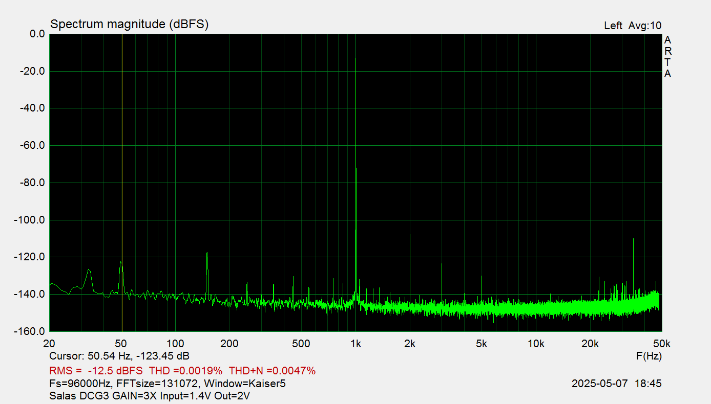

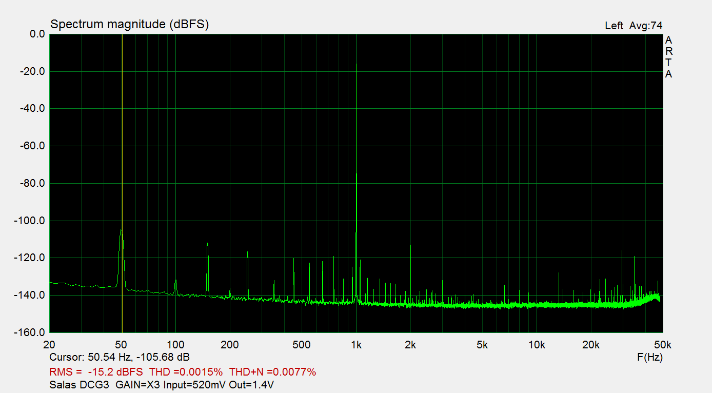

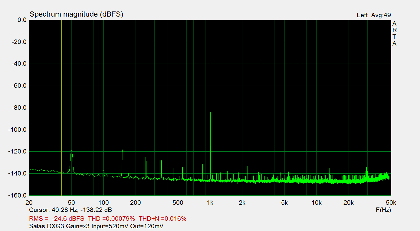

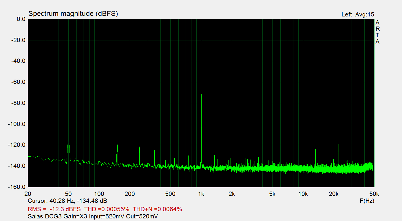

Back to X3 Gain. When measured the X10 Gain to be able to measure this high voltage,I used a divider.
I used the same divider now,but this time isn't needed,so I have to repeat same measurements without the usage of a divider.
If you look closer at the images you can see huge differences in the 50Hz range.
That is because I changed the no name desktop SMPS with a better one from a good supplier.
