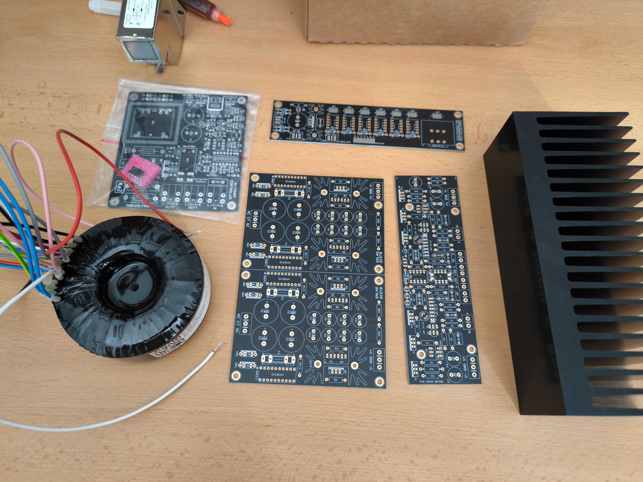

Friends, until my PCBs for the new Wolverine amp arrive, I'm going to start building the DCG3 preamp for the Wolverine. Again and better 🙂
This time I chose one 100W transformer, 4x18V + 1x12V, custom made. Mainly also to save space so I could use a 280mm deep modushop chassis 2U slim line.

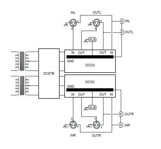

Hi salas Im trying to understand how to use Balanced input in and SE output with once channel as given in diagram. I saw in one of the post. Is there anything that is done in the following diagram on how to connect to get Balanced input and SE output? which pins to short

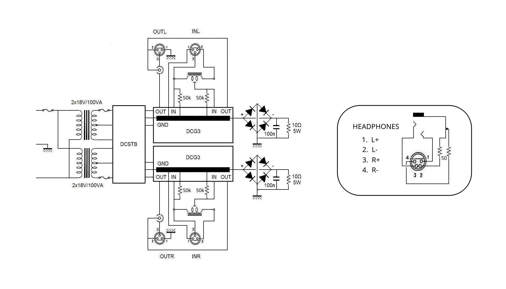

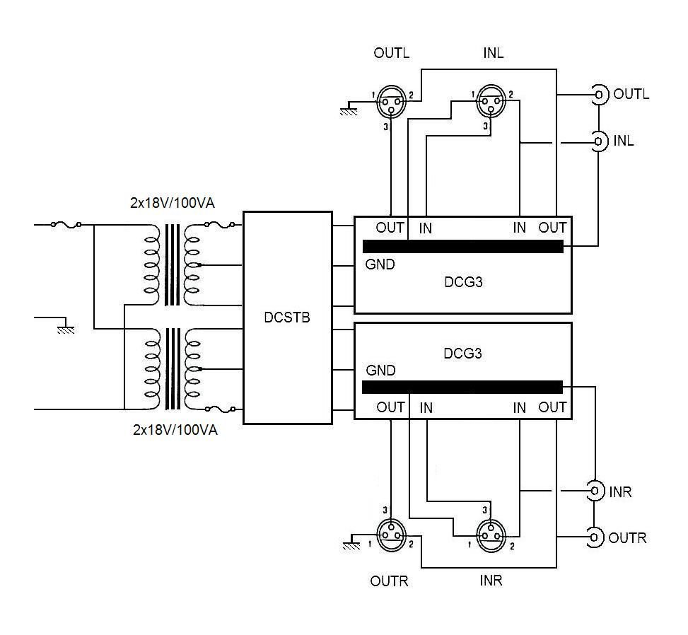

The trick with this schematic is to connect input XLR pin #1 to circuit ground. Then it still works like two SE channels and you can take what you will need to use at the output. The interesting point is that when you take XLR output, it doesn't need to connect pin #1 to ground. It simply works like this. Bellow is the updated scheme with a balanced volume control. Only XLR input works with that if we want to avoid "bal/unbal" switches. RCA input is connected with a RCA to XLR adapter which makes inputs easy to configure. Outputs have to get a bit different. XLR input to RCA output will leave the volume control out of the game. So The RCA "ground goes to XLR "cold" and it will be grounded at the load side. The 50 ohm inline resistors at the output save DCG3. And headphone bonus. It's all OK for balanced but for TRS a modified socket with two separate sleeves that get shorted when the jack is inserted and 50 ohm resistors is used as the best compromise.
#7,374 showing the correct pin #1 configuration was the tested final without volume control, since at the time I was using the digital VC. However, I had placed 50k resistors from input to ground of each channel, so I guess it works with a quad pot too. SLBs are optional depended on the rest of the system. I kept them on. Final-final -can this ever be? 🙂 - is #7,377 with AVC that shows the 50k resistors too.
