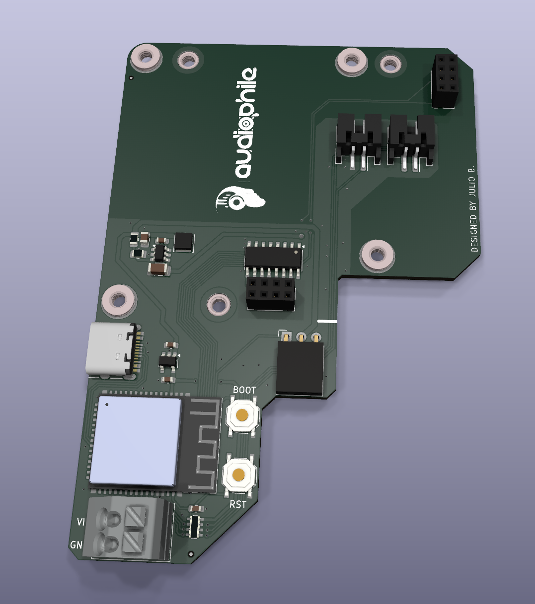

Thanks! It's relay control via rotary encoder. So, there is volume control and a preamp/headphone switch + connector for a programmable led strip to indicate volume level.Congratulations for final successYou are welcome.
What is the USB connected board? Logic and remote control receiver/bluetooth?
As I do not have speaker setup, remote control was not a priority. I have a desk headphone setup only. But there is a room to program it in the future.
Yes, exactlyESP32 microcontroller. Relay control, in/out etc?
Maybe in the future. Programming is not my stronger side, but I have a work colleague who is a software developer and can do it in no timeHe probably plans to network it for control from smartphone 😉
Yes, a 6 bit 64 step attenuator. 20k constant input resistance type.Looks like a rotary encoder even. Probably relay controlled stepped attenuation then as well
The relay board has also two pairs of RZJ integrated, selectable via jumers
ESPHome is a YAML scriptable very easy way of controlling I/O of an ESP32 for example. Input select would be like a couple of lines of code. Rotary encoder would be more lines but it’s effectively just more input choices, not more complex code
To the product, or did you manufacture the PCB yourself?You want a board project file?
Thanks! I might look into it in the near future.ESPHome is a YAML scriptable very easy way of controlling I/O of an ESP32 for example. Input select would be like a couple of lines of code. Rotary encoder would be more lines but it’s effectively just more input choices, not more complex code
I designed all of the PCBs myself. I work as an embedded hardware engineer so all tools are available for me. Here are the project files for MCU and relay boards.To the product, or did you manufacture the PCB yourself?

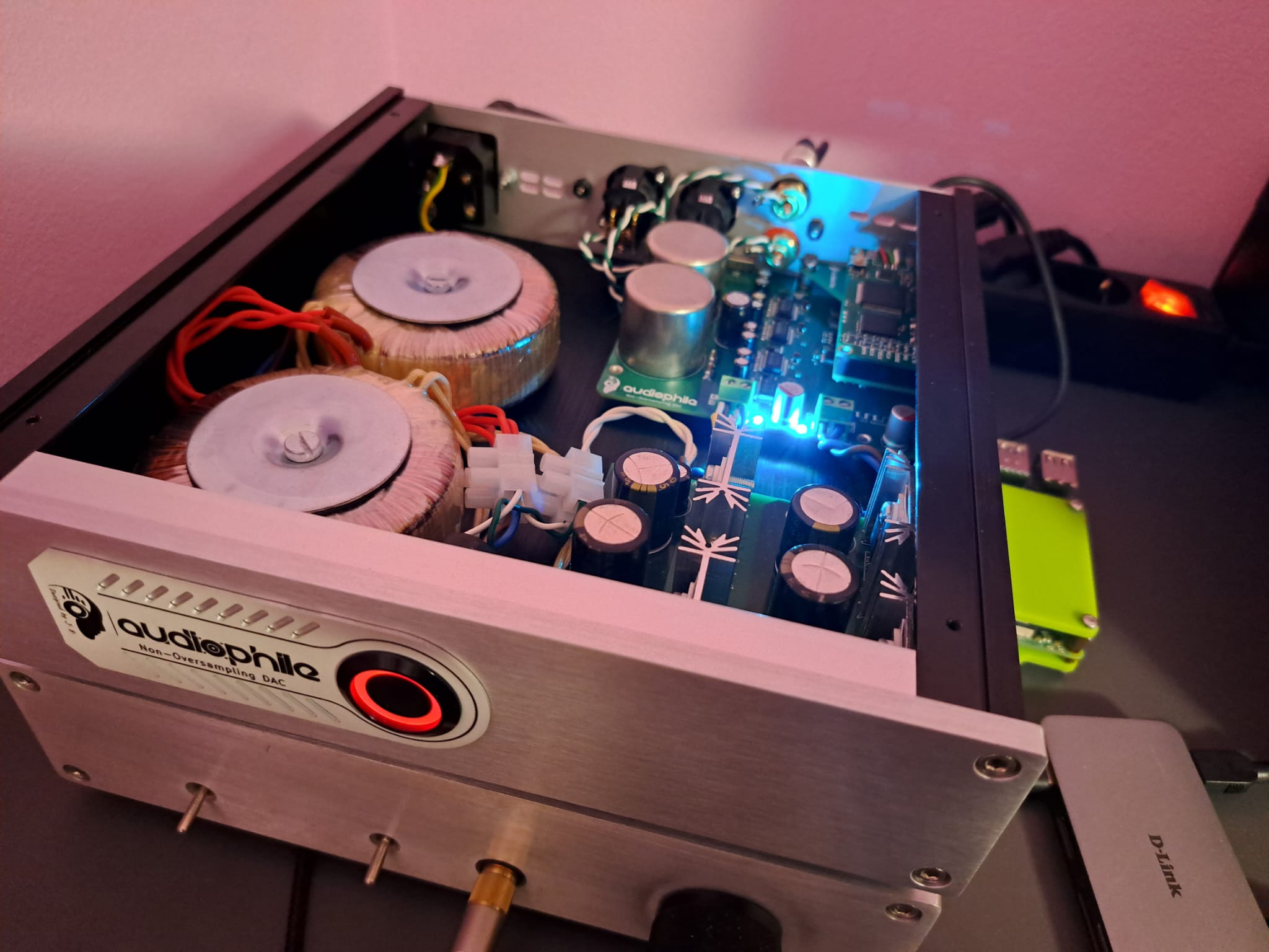

Are you using a dedicated streamer/dac unit as music source or a computer with audio software and a dac? What headphones you use?I have a desk headphone setup only.

I am using a computer with tidal and a dac.Are you using a dedicated streamer/dac unit as music source or a computer with audio software and a dac? What headphones you use?

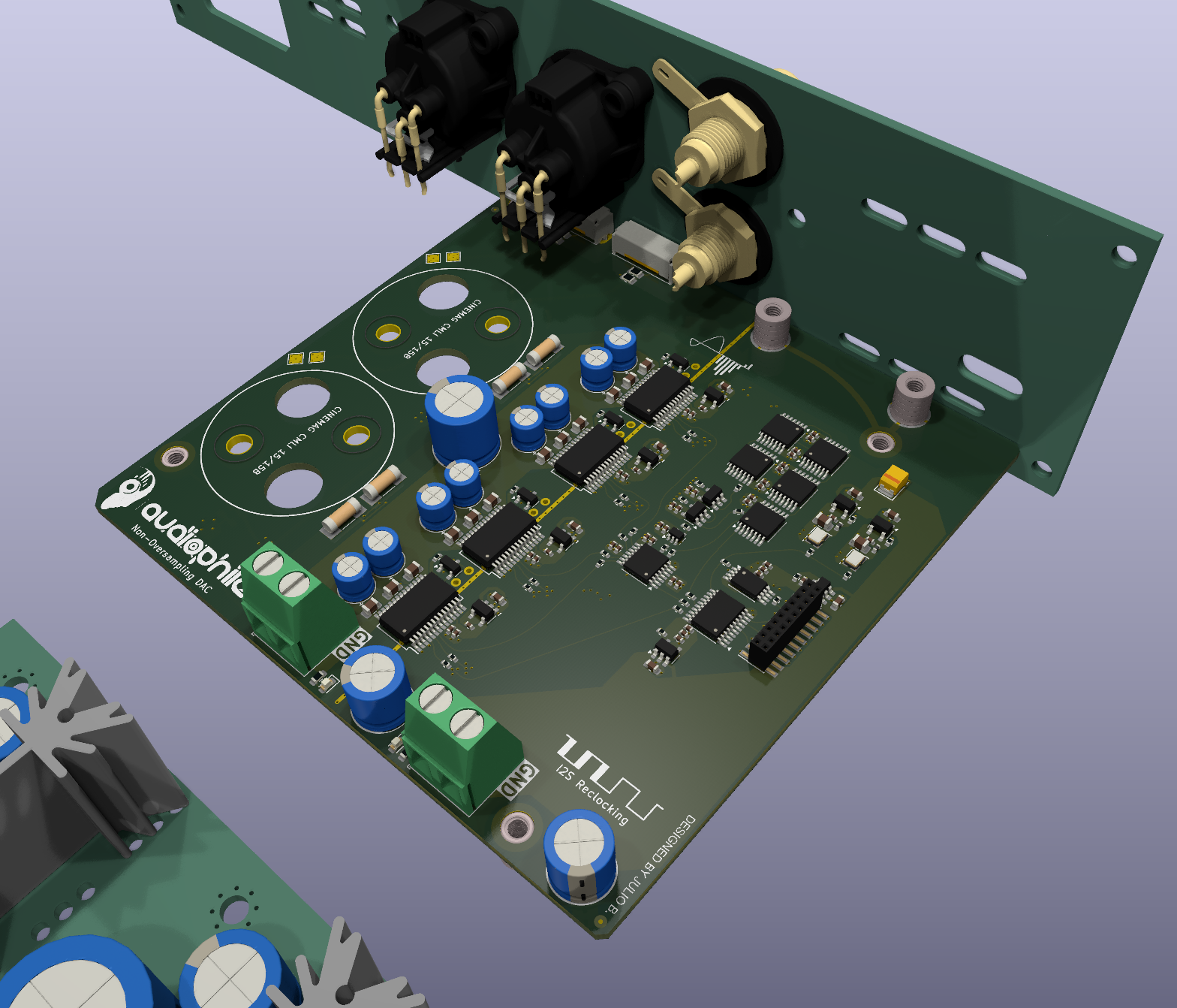

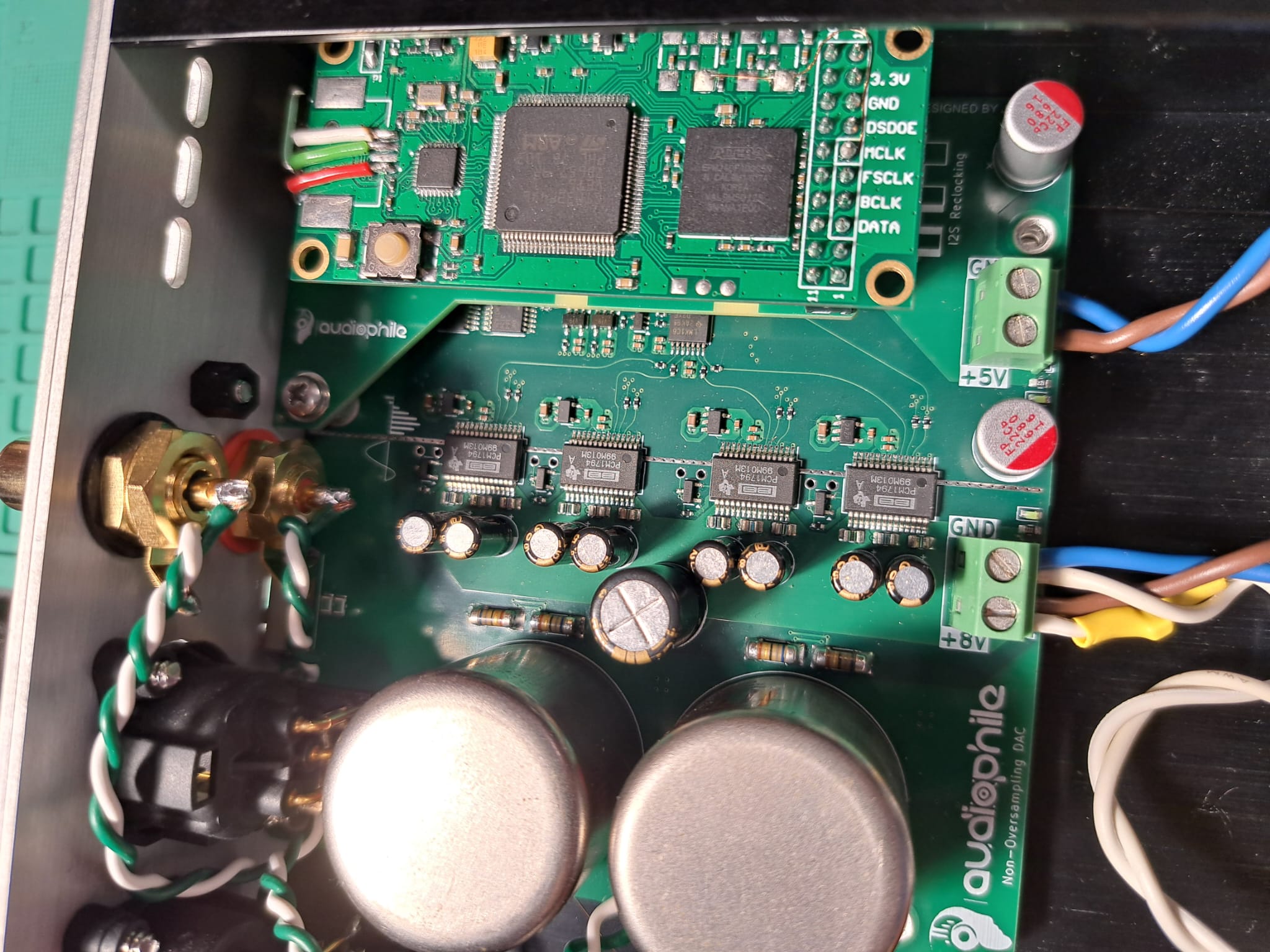

Dac is a NOS, galvanically isolated, with onboard reclocking, 4 paralleled dac outputs per channel, with output transformer, separated analog and digital supply.

Nice work. What circuit is your previous HP amp? Pictured under the NOS BB PCM1794X4 DAC?

Thanks! Above pictures are only of a dac. The previous amp was custom Kevin Gilmore's dynalo amp with better power supply and few minor tweaks. http://www.pavouk.org/hw/dynalo/en_index.html
