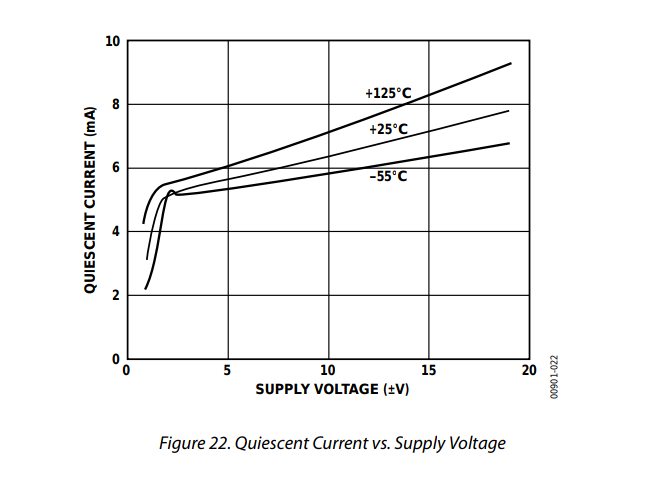

The datasheet states many examples per supply (for 15VDC it's 7 - 8.4mA) but the following graph (page 9) tells the whole story
So for 12.4VDC of my reg and Temp around 20 C, the 7.2mA is little bit high (I'm seeing something 6.5mA or thereabout)
That graph is for split supply (+/-). I don't know if there's a difference for single supply?
Strange behaviour: while I can setup both channels to below 1mV without opa, when I put the opa back, measuring after few minutes I get 0.1mV at one channel, the other channel slowly climbs up to and little above 5mV. I've changed the Jfet pairs between channels and the same figures come up.

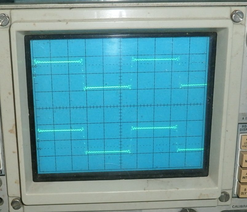

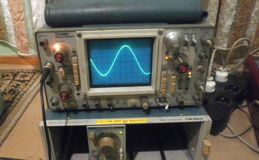

That's the ringing of the audiocard's squarewave synthesis. Some cards are even worse. Digital lab generators are way smoother. But no alteration is seen from the preamp.I've used the soundcard's output for this test and because of the distortion I also took a snapshot of the input of DCG3 in order to compare
CH1 (upper) is DCG3 output and CH2 (lower) is the input of DCG3 (generator)
I don't see any artifact generated by DCG3.
I don't think it's the scope or the rest of the circuit, which is configured for line out use (50R at the output) with UBIB serving as regs with 6800uf per rail, normal 100uf decoupling at DCG3. But still think something fishing is going on and I'm gonna blame it on the opa (BTW I dislike e opas in the signal way)Maybe it’s the scopes bw limits. Or maybe not. Strange current draw in opamps is generally oscillations. What decoupling to rails is used and what resistance do you use on the output?
I've tested today with my other multimeter (Voltdraft VC840) and provided 5VDC and the current was 5.13mA, almost very near to the 5.2mA indicated in the papers.That's the ringing of the audiocard's squarewave synthesis. Some cards are even worse. Digital lab generators are way smoother. But no alteration is seen from the preamp.
I think is safe enough to continue my Jfet testing but I'm gonna get my hands on a new AD823 just to sleep without worries.
My suspicion is that maybe when I took out the opa, I've bend the legs too much, even with using a special tool the one side came off first bending the other side's legs little bit. Continuity test shows everything is good and optically seemed no harm came to the legs but it's the only explanation I have.

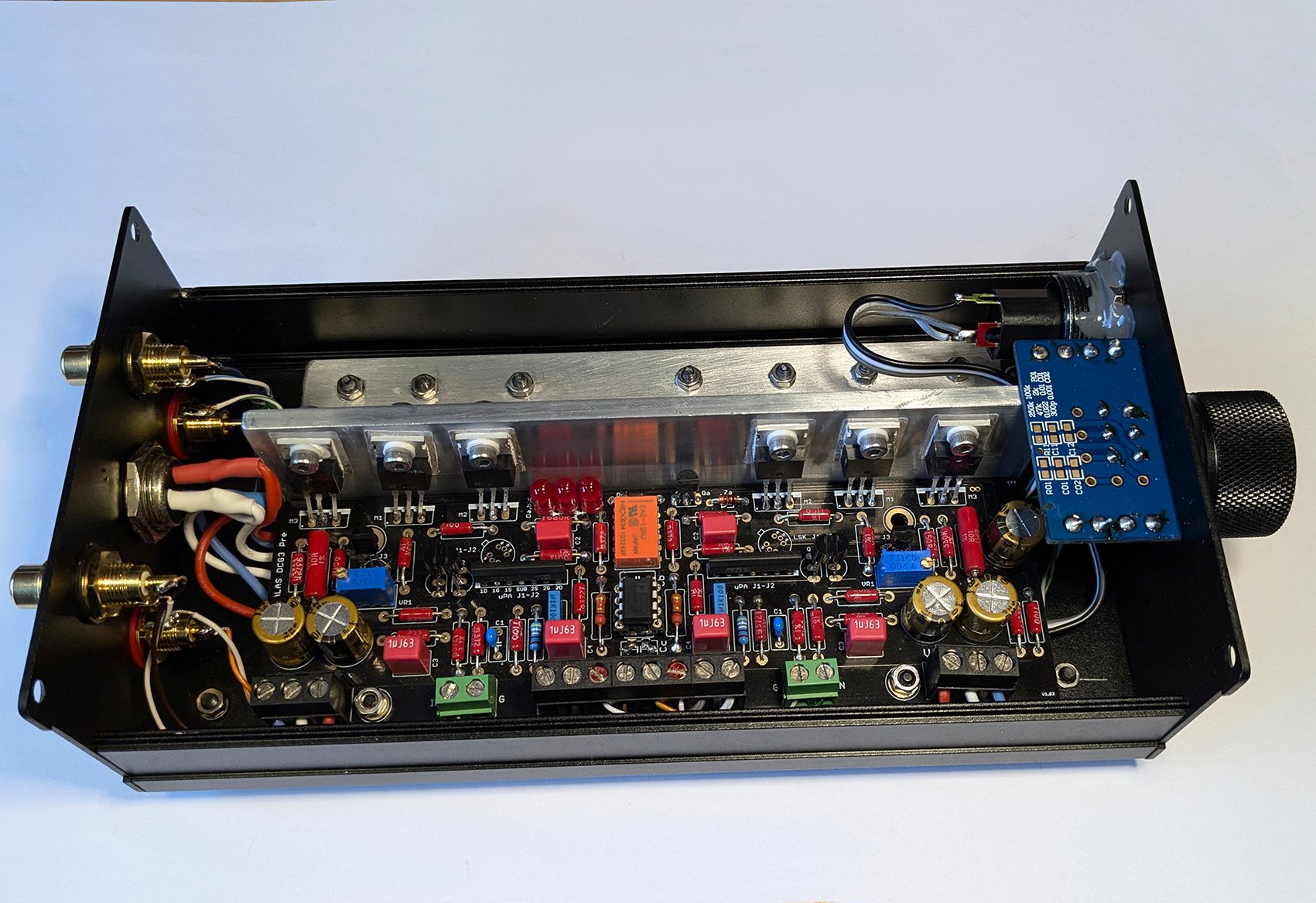

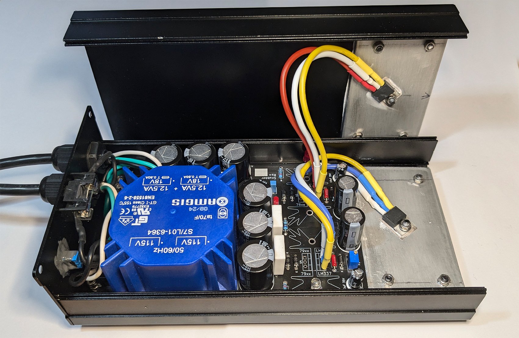

Congrats !The heatsinks on the PSU are over 50°C and the chunk of aluminum on the DCG3 is 31°C.
I'm surprised, that piece of aluminium don't seem adequate for DCG3, maybe for winter use. I had something similar and couldn't touch it. Keep that in mind if you gonna box it sometime.
I assume that later you gonna change the cable arrangement of the psu, one channel powered via another is not optimal.
You may solve your heat problem and maybe achieve better sound quality by adding another of these FlexReg psus for the other channel. Again, remember again that you gonna box it sometime and there starts the problem with heat.
And not only that: I assume that you decided on +/-15VDC because the rails sag too much for the regs to output +/- 17VDC, right ?
With another transformer on the play, you minimize the load so less sag which means more headroom in order to push the output voltage to the recommended +/- 17VDC.
Me too. Ha, this is not the final setup or wiring. My boxes are going to be part of the heat sinks, so I think I have it figured out. I'm waiting for some aluminum plates to arrive to test the final arrangements for heat dissipation. I did not decide on +/_ 15 VDC, that was where it was set previously, so I left it there for testing. I don't think the rails will sag and I should be able to deliver the specified 17-volt supplies but I'll find out soon. I need more heat sink first.I'm surprised...

The 1/4" aluminum I used works perfectly. I bolted the aluminum stock to the aluminum shells with 3mm hardware and heatsink compound. The room temperature is 22.5°C and the power supply shell is 37°C on top and 38°C on the bottom. The preamp shell measures 34°C on top and 41°C on the bottom. This is all buttoned up and running for many hours. I still have the rails at +_15 VDC and I will change that soon to +_17 as specified. I am exceptionally pleased with the thermal performance of the aluminum enclosures. This is a better result than I was banking on.

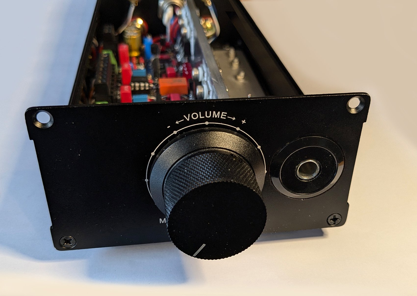

With the volume pot in the 3 o'clock position, I can barely stand the SPL on a pair of AKG240's, lots of power and tons of gain for me! The current source is FLAC from a Windows PC. This is the only source for headphones I have used so far today. More sources soon. I had a wonderful time rocking out to Magdalena Bay - Imaginal Disk. Loads of fun to listen to on headphones. An interesting recording to say the least.
I am starting to wonder about this clever circuit being used as a front end to an audio power amplifier. It's just so wonderful to listen to.
