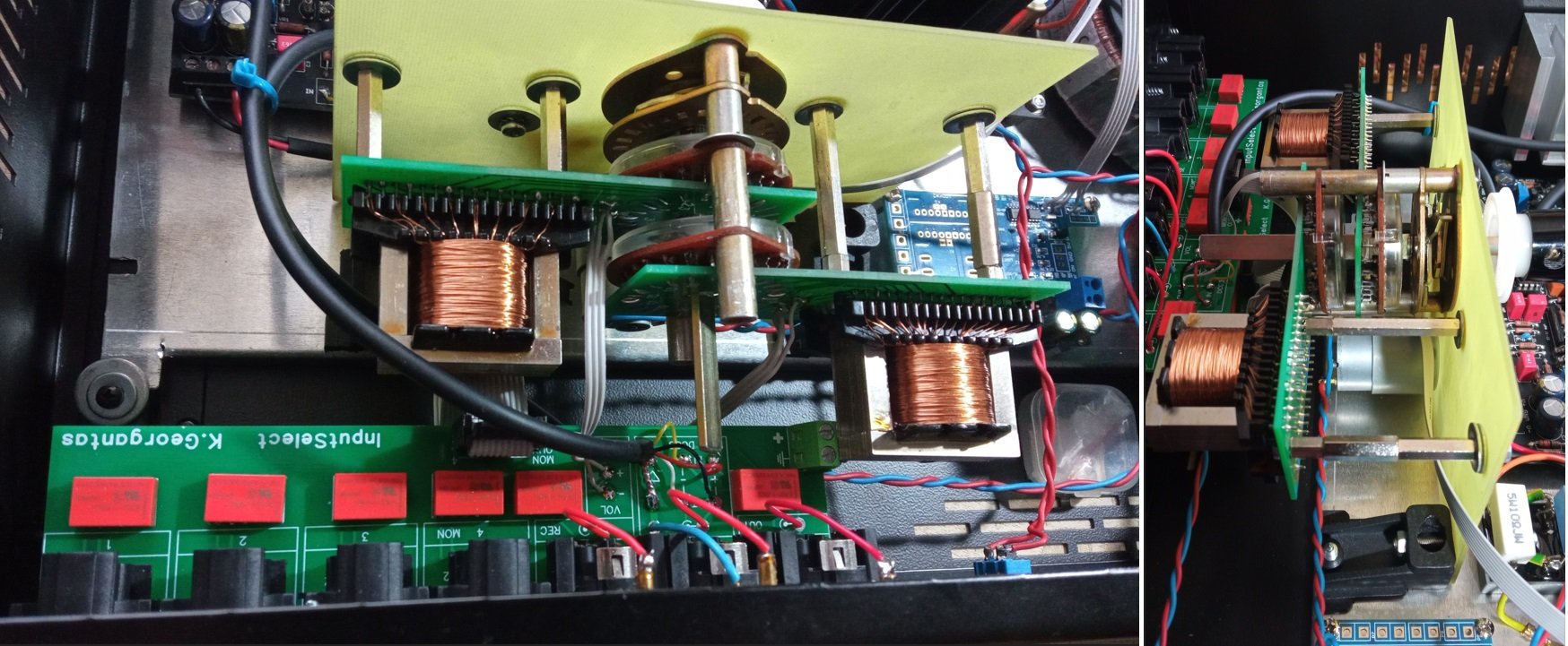

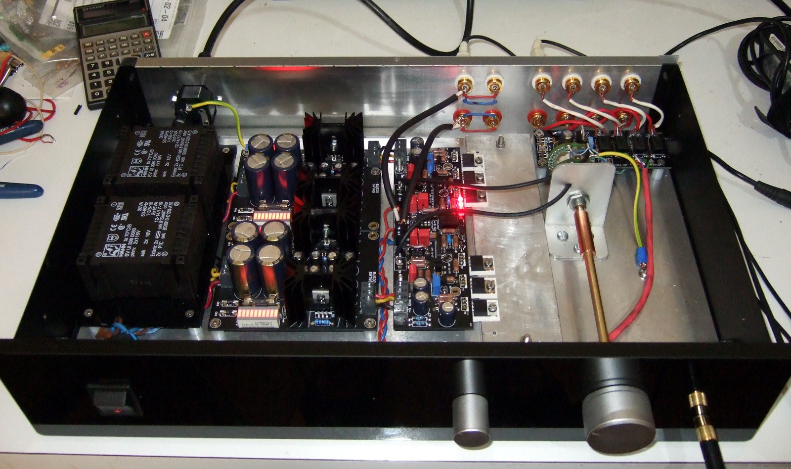

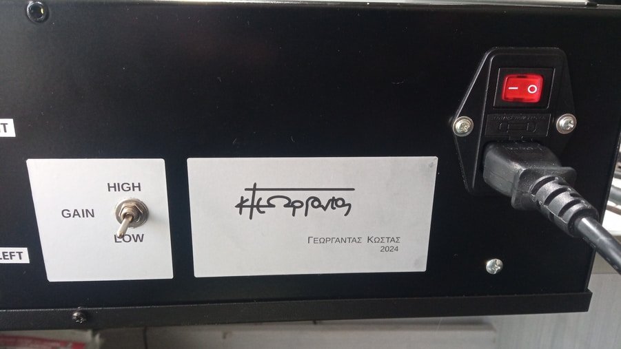

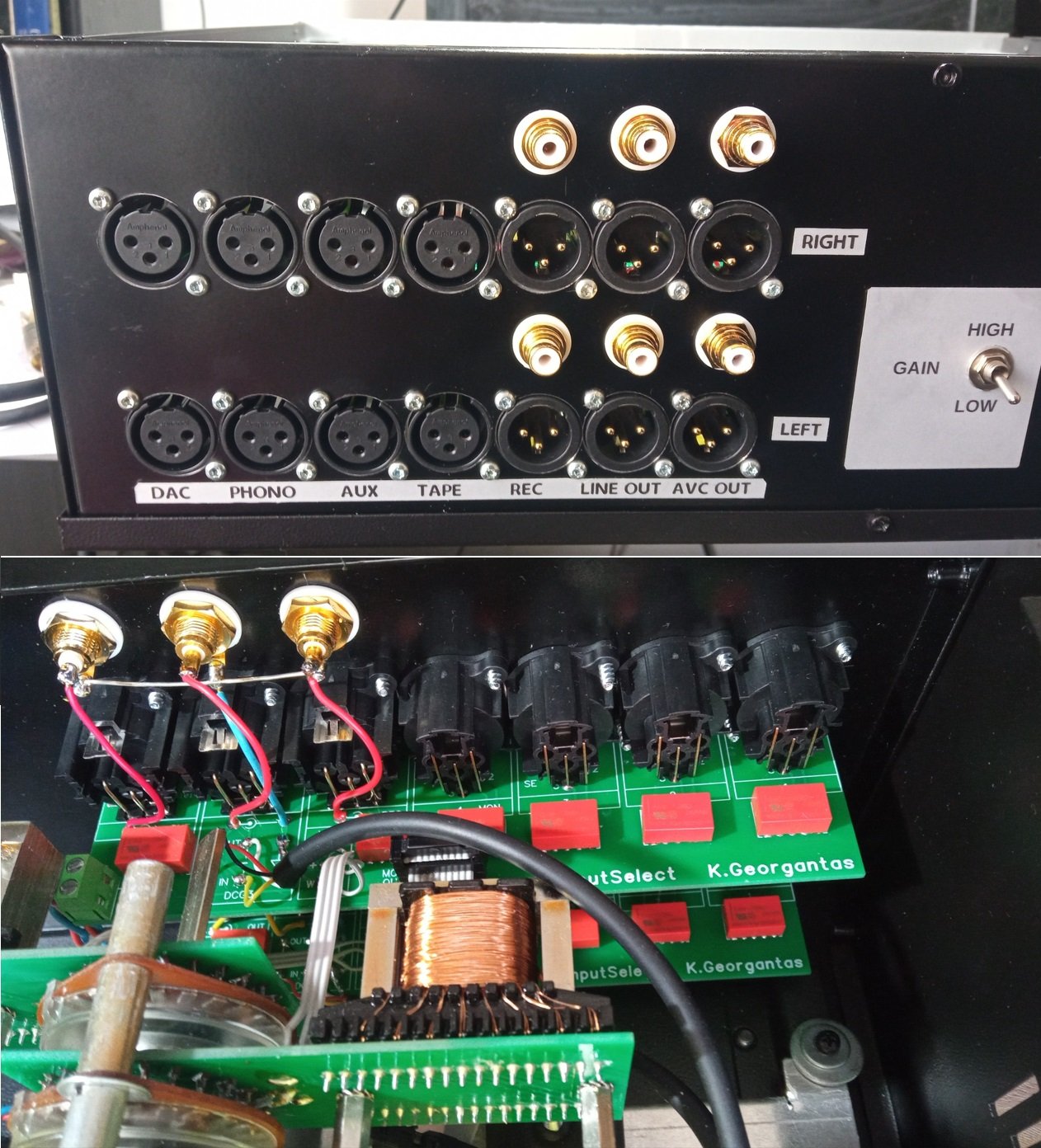

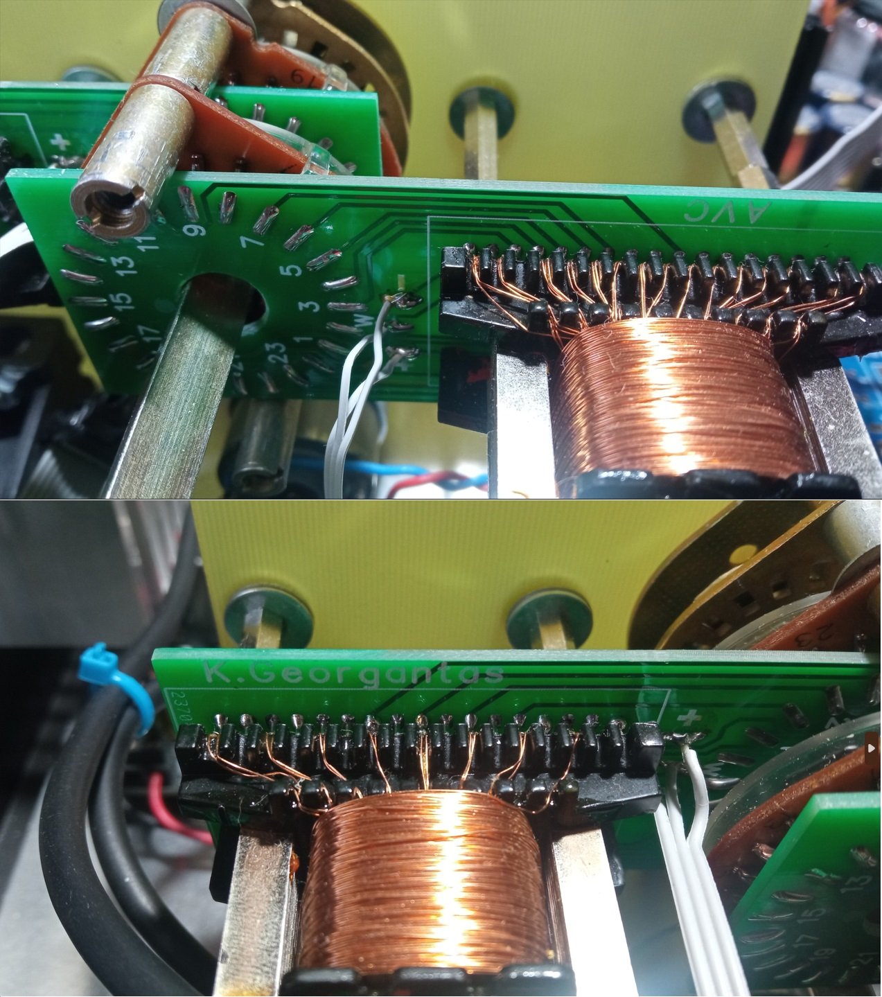

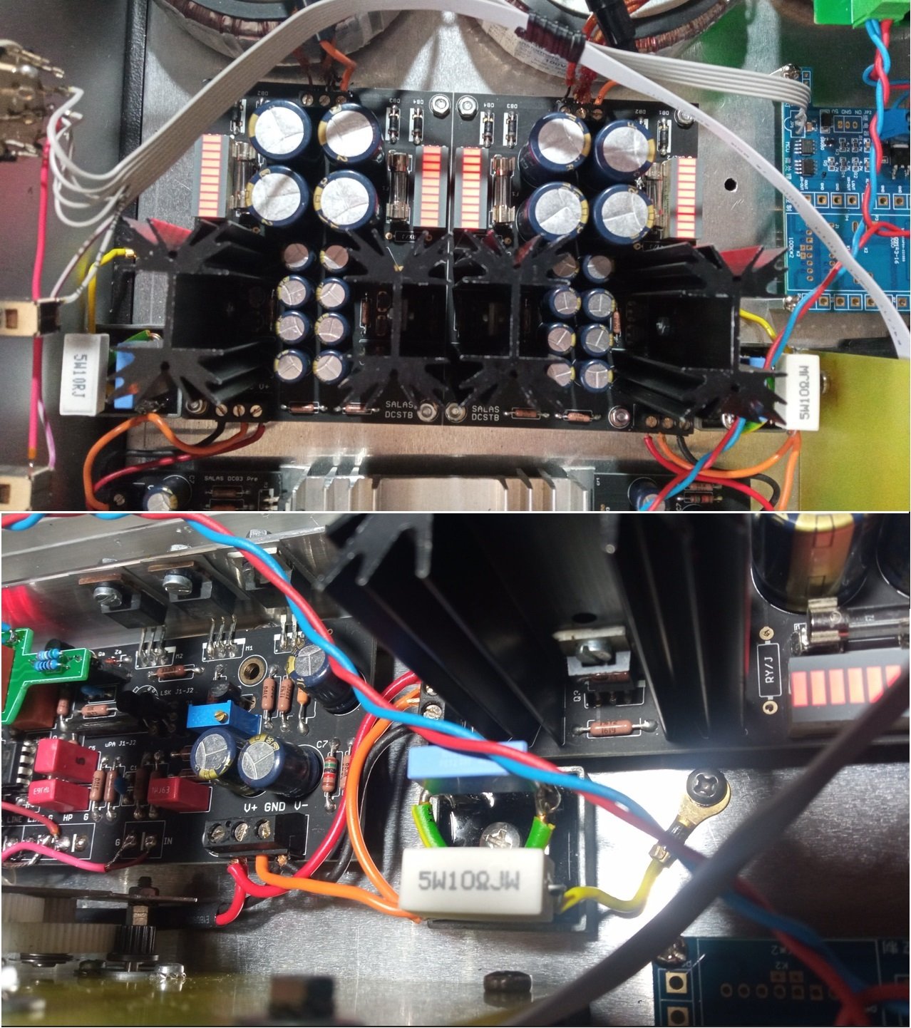

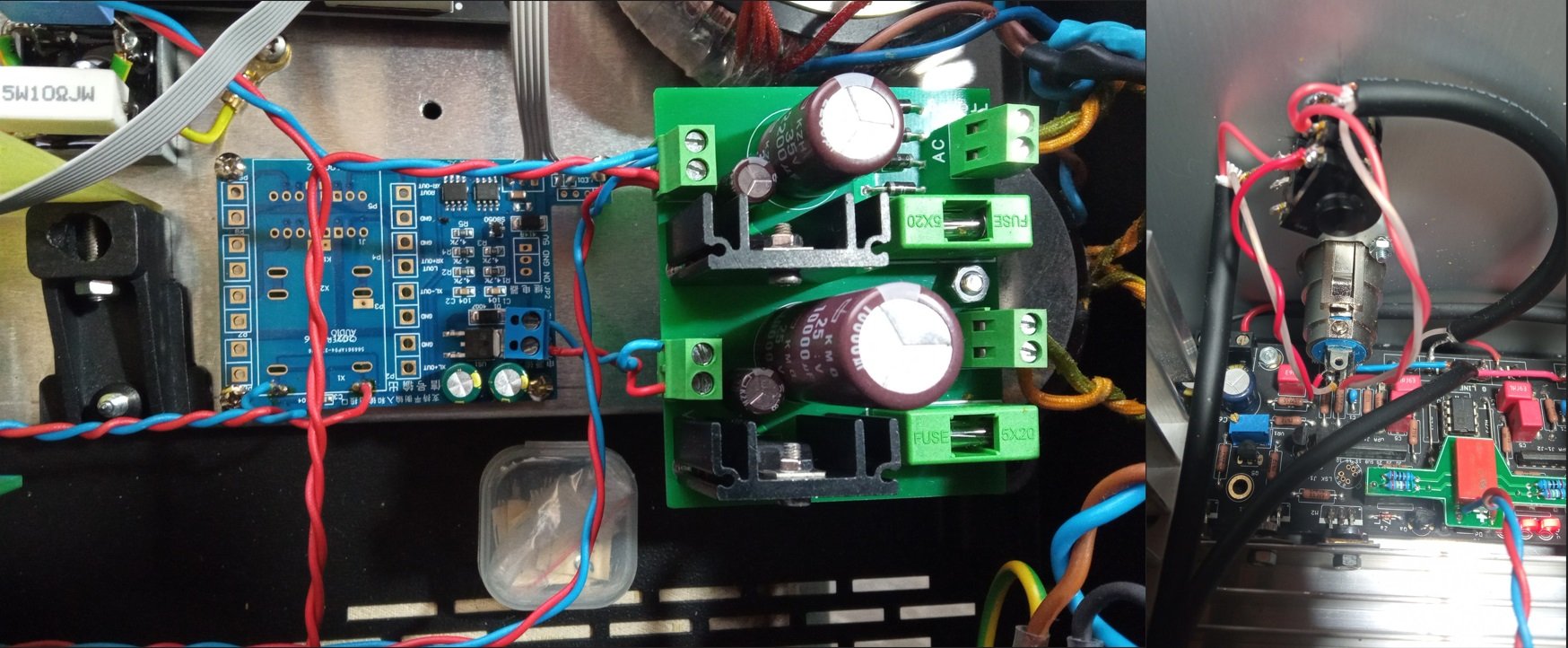

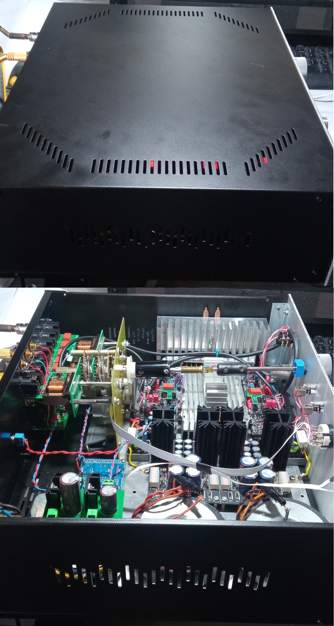

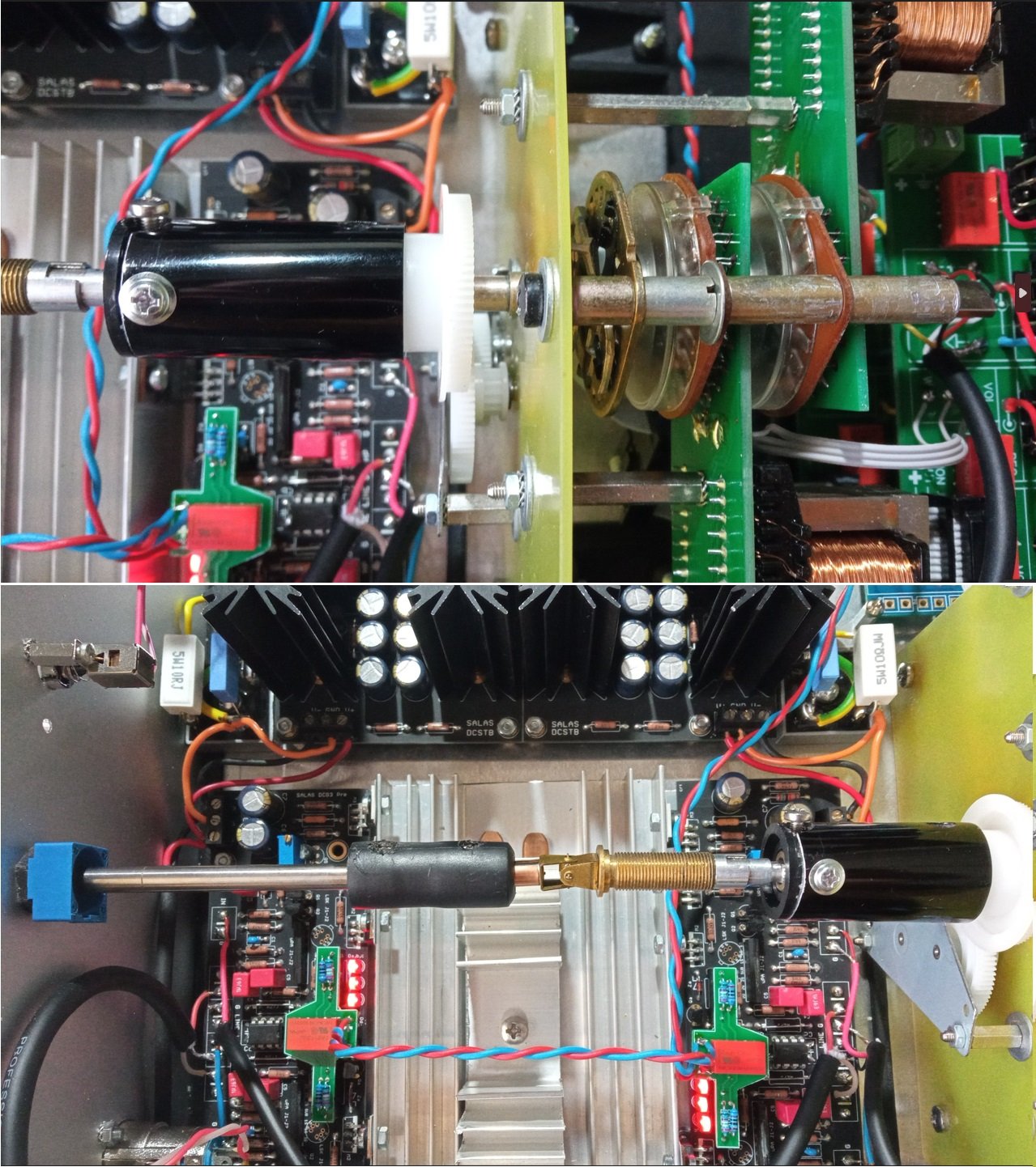

Indeed. Kostas deserves your congratulations Salas.Awesome. So unique. Congratulations & happy new year!
He is low profile, therefore I took the liberty to show the details of his wonderful design and assembly.
Healthy and Happy 2025 to all.
George
Wow! Apparently, photography is another of George's many talents! Looking at this now, it makes me feel I could never build it myself... 🙂

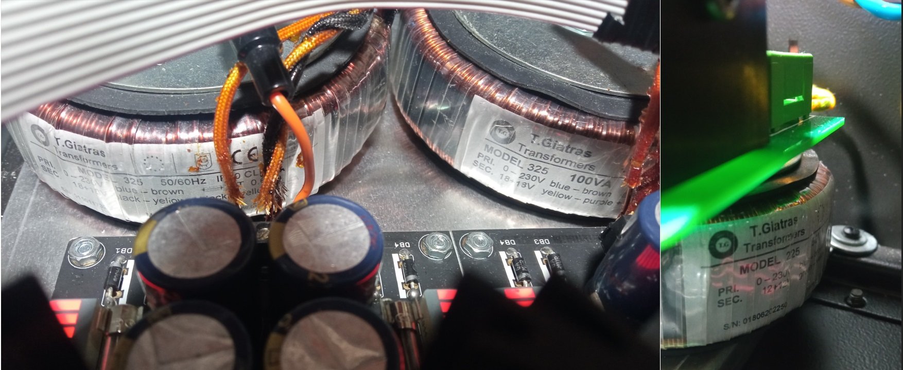

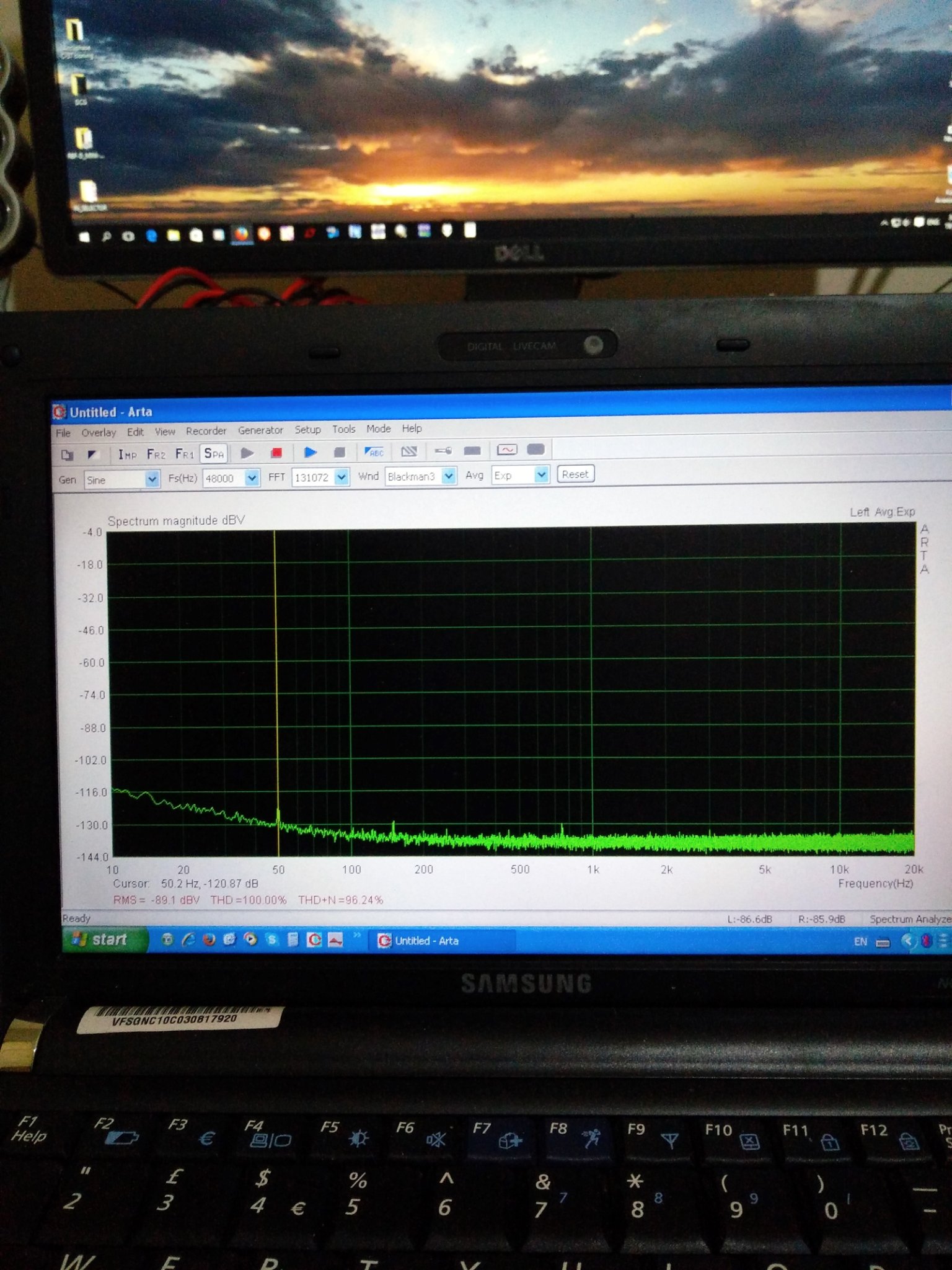

Quick question. For those of you that moved the transformers to a separate chassis, did you find this to make a difference? In other words, how sensitive is the DCG to EMI and whatever else is isolated by doing this?
I use a outboard trans, with big caps in separate housing about 4 ft away .. no issues at all .. just a simple metal box, nothing fancy.
@Sorenm ... I have 2x Anteks both in the original heavy weight steel cans Antek sells (they have new lightweight steel cans too) in the chassis with the PSU, amp, and muses and other trafos and PSUs...... Amp is dead quiet, headphones as stethoscope ... nothing to hear. Also have trafo tuned quasimodo rigs on the secondaries...fwiw... I can't personally make a case for a separate PSU for this amp...
My 2016 prototype showed mains frequency interference 50Hz level at -120dBV. 3rd harmonic 150Hz at -130dBV. Its a single box with two 30VA frame type plastic potted budget quality mains transformers. So DCG3 is not too sensitive for hum and its relatively easy to make quiet especially if with even better quality transformers.
Thank you Salas and Pfarrell. I think this settles it: keep it simple and in one chassis.
Soren
