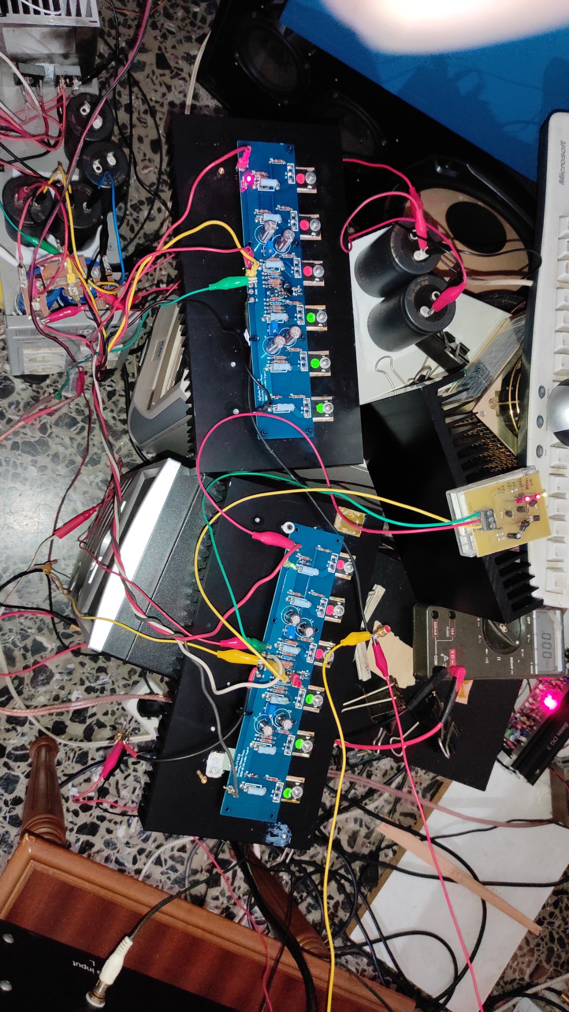

Hi guys.
Is it someone here who have used the DCG3 as driver for Nelson Pass F4 ?
If it's,what gain you choose?
What's the values for R6/R7?
Thanks in advance 😃

Try a gain of 10x (20dB). It should be logical with a digital source and F4. G=1+(R6/R7). Thus R6 4.7k & R7 499Ω divide to 9.418+1=10.418x or 20.35dB.

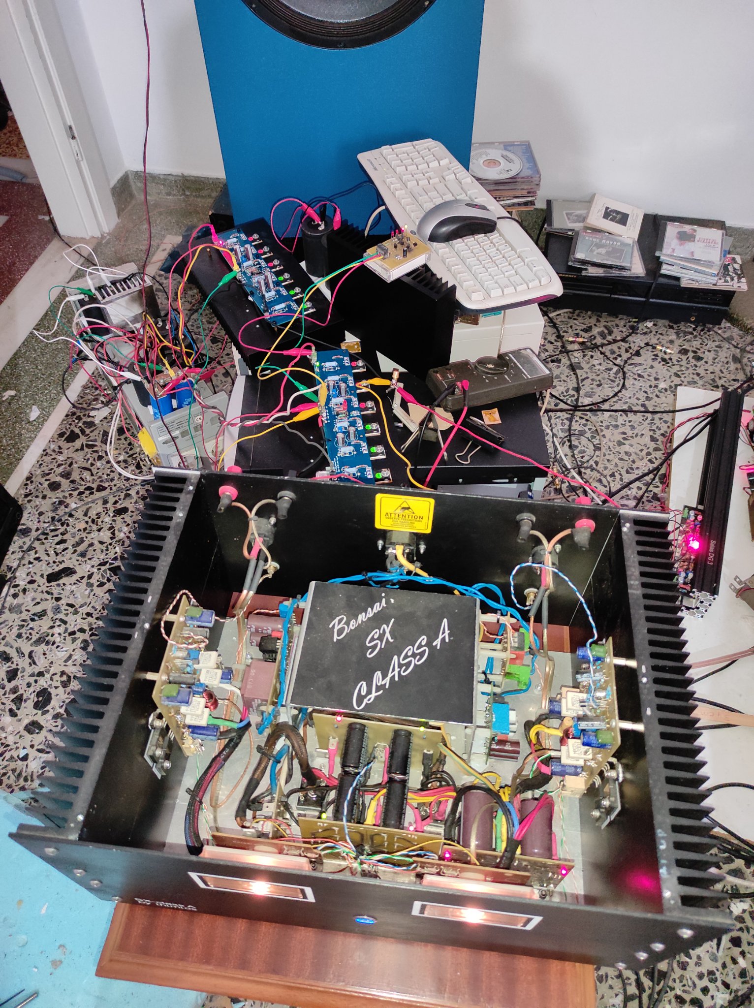

No,in this case(+/-19V test conditions).
Now I use another power amplifier to drive the F4.
Laptop line out-Salas DCG3-Bonsai SX ClassA- Pass F4.
Long trace!
PS.standard DCG3? Do you mean standard gain?
Long trace!
Its near enough a +/17V preamp for driving a +/-19V buffer power amp. If to max out a higher rails buffer power amp, the preamp must have same rails to fully push it with a strong peak to peak.
Short question 🤔
DCG3 modification for F4 driving.
+/-17V
10X gain?
Or I need to modify the gain for 10X and adjust DCG3 power supply for higher output voltage simultaneously?

You can't simply adjust it higher. DCG3's output stage takes more, but for the DC servo chip and the relay circuit its safe to use up to +/- 17V. So its about modifying the board, modifying the supplies.
Start with 10x gain to see about sound, stability. Max F4 power isn't a priority now.
