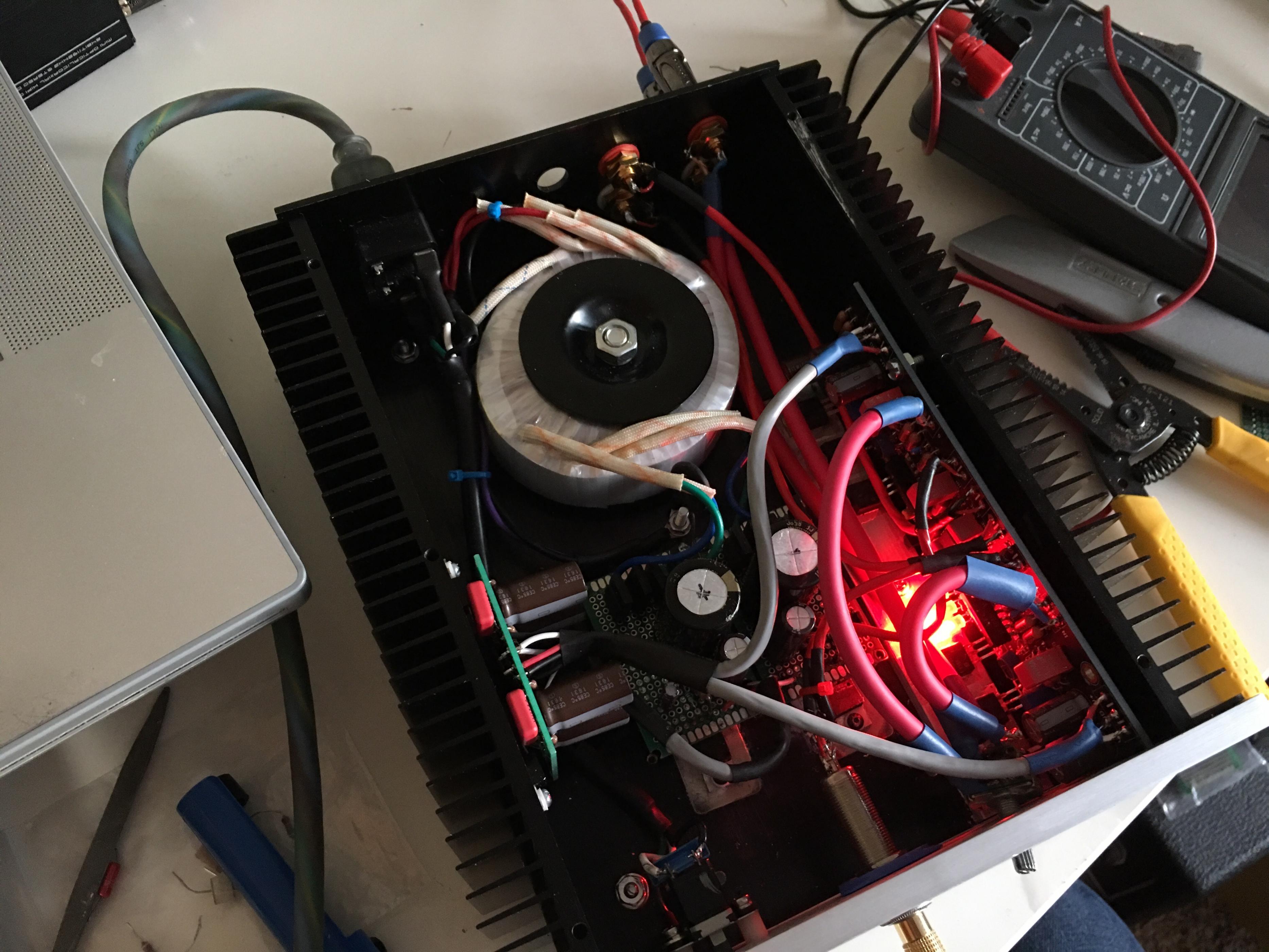

Pcb access is not so good on my build. Changing thebgain resistor means tearing apart the whole chassis. Actually, the math seems to work, I think the f5 clips with 3x gain and I usually use just about every one of the f5'S watts when listening loud (89 db speakers, big room). So it would make sense that the volume control is pretty much maxed out. This is primarily a headphone amp for me, but if it beats my ba-3 I will build another for speaker use.
Iam happy with the heat or lack of heat. I was worried this small chassis wouldn't be enough. I have the amp mosfets and lm regs all bolted to the chassis floor and Iam still able to hold the bottom of the amp in my hands indefinitely. Bottom of chassis is probably 40c or so. The heatsinks probably help although the amp mosfets are not directly bolted to them.

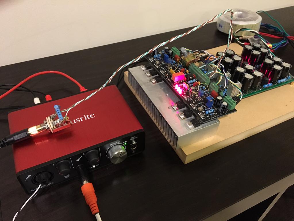

Technical Details: HP x2 Elite with SSDD Win10, Focusrite Solo, tracks are combination of FLAC, AAC, MP3 and FLAC wherever possible, PSU is Antek AS 0515 (50VA 15v) and my own CRLCRC followed by 7815/7915 regulators for each rail, monoblocks.
592673d1484635134-salas-dcg3-preamp-line-headphone-dcg3-setup-new-psu-focusrite-listening-test.jpg

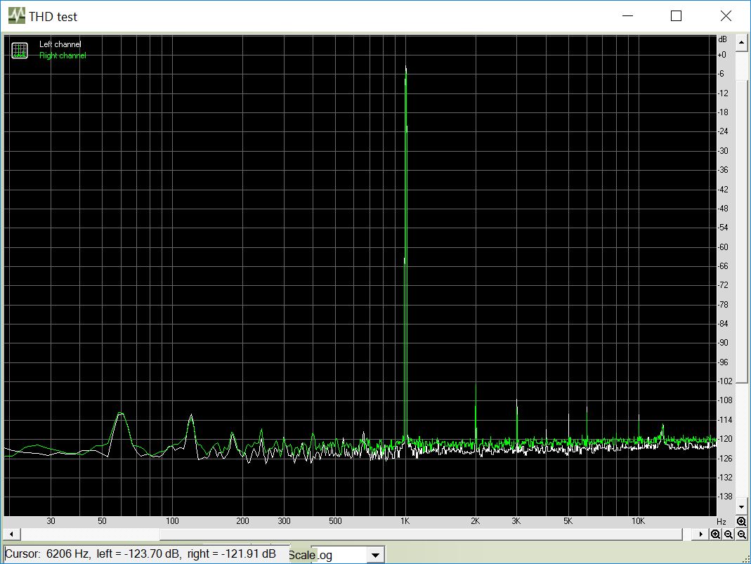

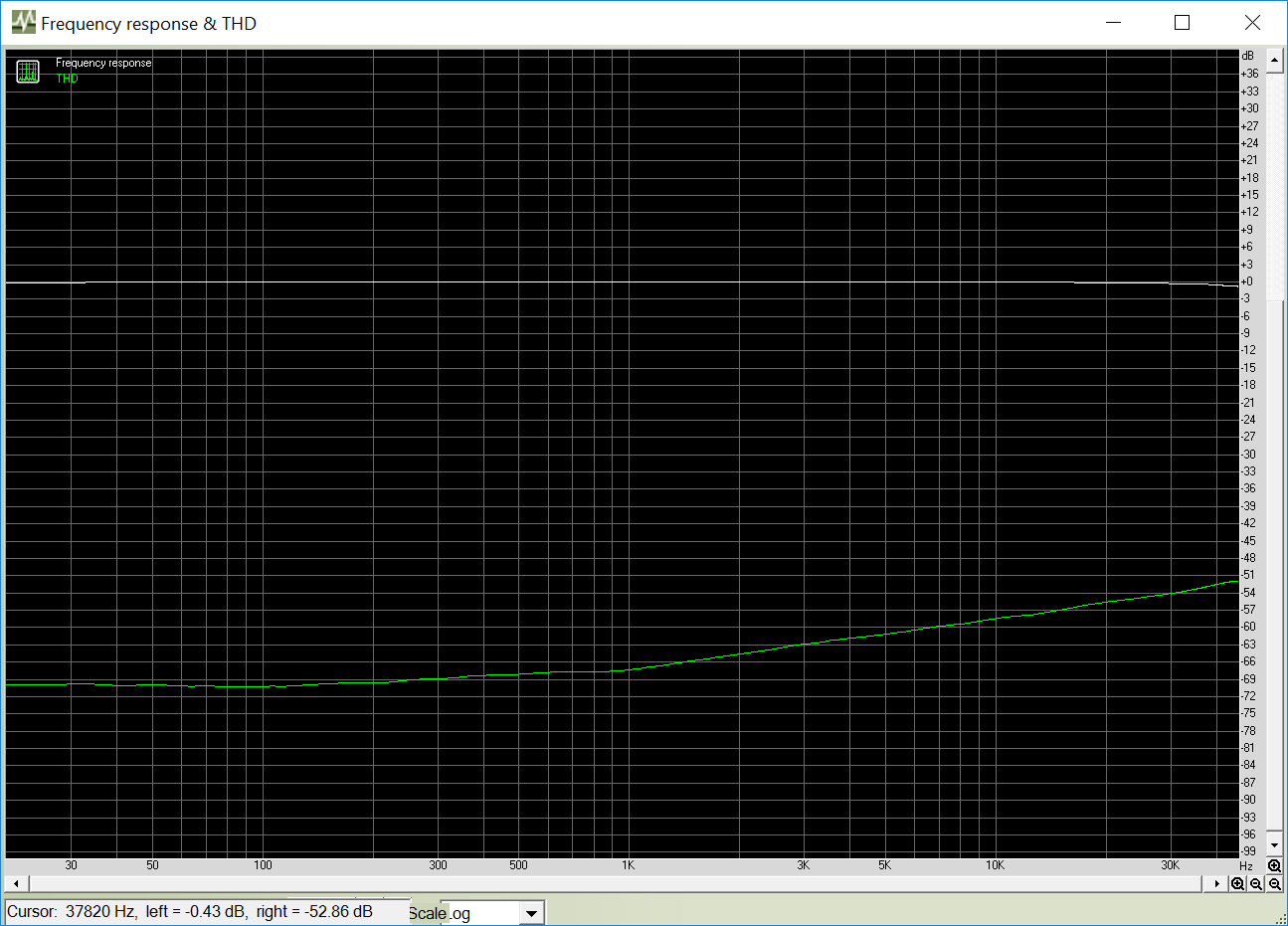

Measured Freq Response:
Measured FFT (24bit and 96kHz - but free version of RMAA only allows limited resolution with 51k points):

Here is the loopback test to see what the limits of the self-noise is. This is fully battery powered as my laptop is not plugged in and the Focusrite is powered only via the USB cable. It is picking up 60Hz mains from the house wiring radiation? I have LED lights so no fluorescents to give off EMI. There is a similar harmonic profile as the DCG3 but at much lower level.

Nice to know that you also like it. Hint: There is yet more layering to discover when yours will be fully done too in a grounded metal box, Mogami coax, double mono Tx. Your FFts are far better now than in the start but your testing loop still appears having some lower level interference and residual THD issues even if alone. Some further investigation in software packages and settings, proper loopback inputs impedance, cabling, shielding, grounding, will sort those out eventually. Your DUT maybe is as good as in post#1 but can't fully see it yet through the loop or still bit unfinished at this phase. Could try the plastic cased monolithics also to have another reference. In any case well done up to now. Congrats :up:
