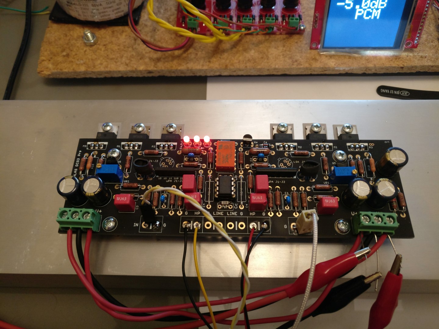

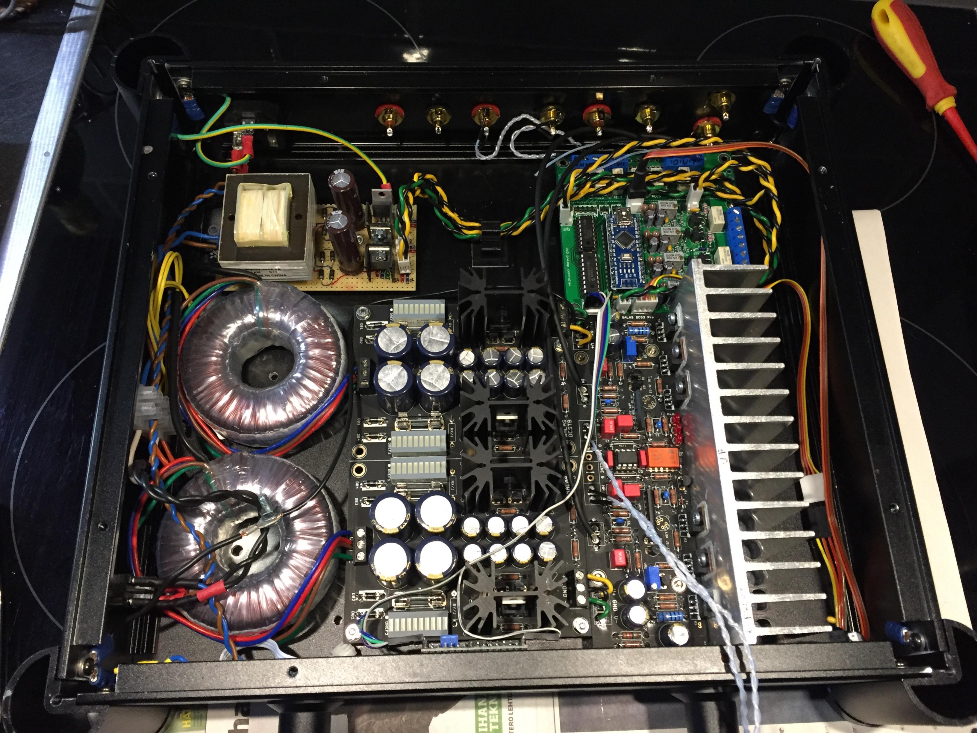

It's alive!
For the moment it's powered by my LM317/337 "test" power supply.
I've set bias at 150mA since I'm testing it with power-hungry Fostex T50RP MK3 headphones.
All 4 of my Ebay-sourced uPA parts measured exactly the same, so no matching was necessary.
I measured ~20 x BC560C to find 4 of exactly the same Hfe.
The BF256Bs that I got from Mouser were pretty strong. I used 220R for the two R3s, getting 4.3mA and 4.5mA Id respectively.
I bought 4 x DN2540 from Mouser, and used the 2 of them that measured the closest. The end result was about 10mA of difference in bias between the 2 channels.
My total current consumption is ~330mA for the positive rail and ~320mA for the negative one.
DC offset drift after warmup and adjustments was +/- 3mV without the op-amp installed. Went to 1mV with the op-amp. It might be even less, my meter won't go lower.
It had gotten pretty late so I didn't do any serious listening, but first impressions are very very postive. I'll do more listening and with a better source and power supply in the days to come.

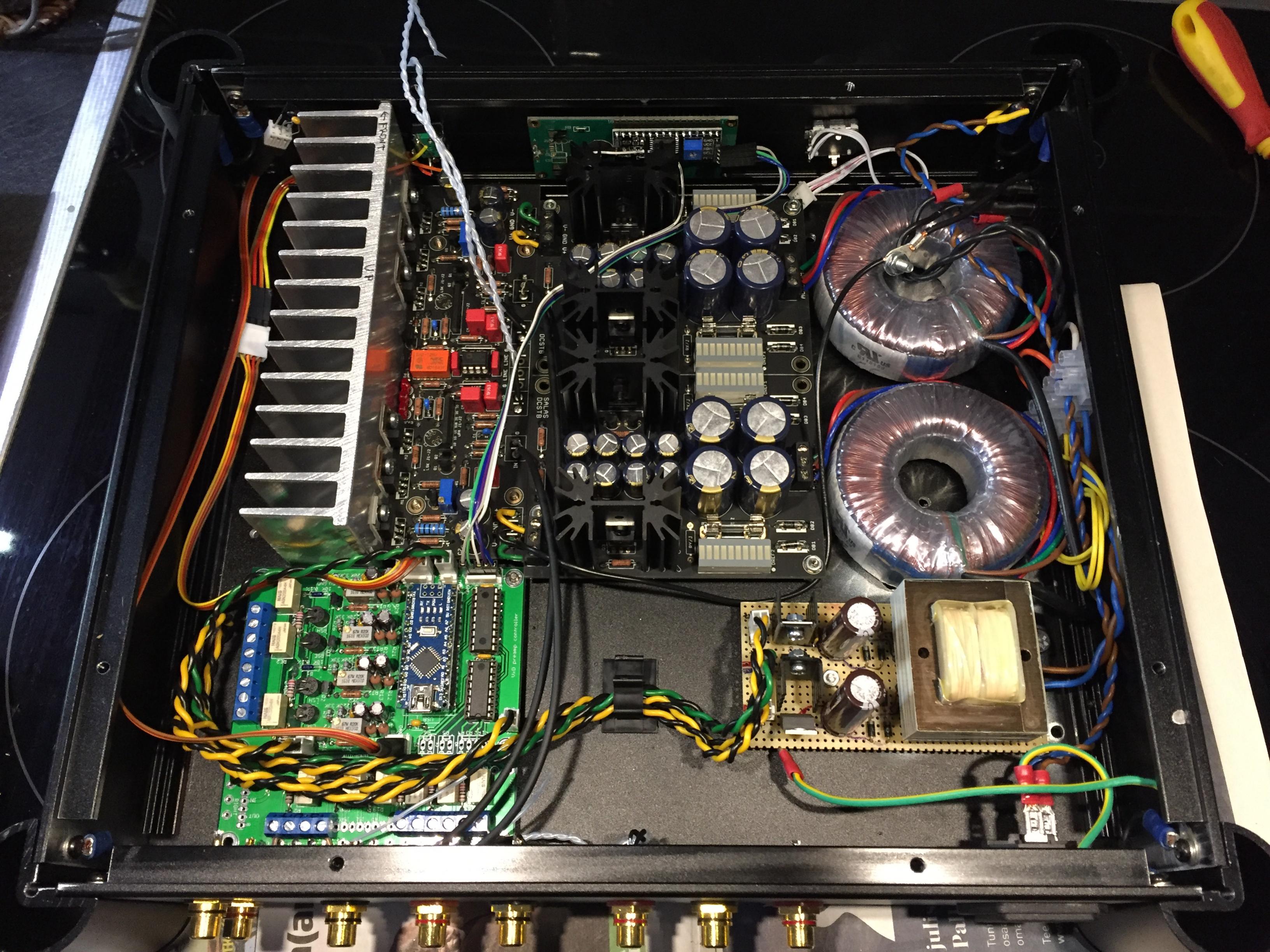

I got my project playing music for the first time today. Just an iPhone and Spotify as a source for quick test, but everything seemed to be working ok. Infected Mushroom seemed to pound the bass as it should with my LCD-2's. Still need to finish and tidy up the wirings and make a hole in the front plate for 6,3 mm headphone connector. I think I might have to lower the gain, since even with iPhone I had volume only on level 25/50. I have LDR vol. control and it's set to 20 kohms impedance. My current gain is 3x, but I still need to test the DCG3 with my Genelec G3 active speakers before tweaking.

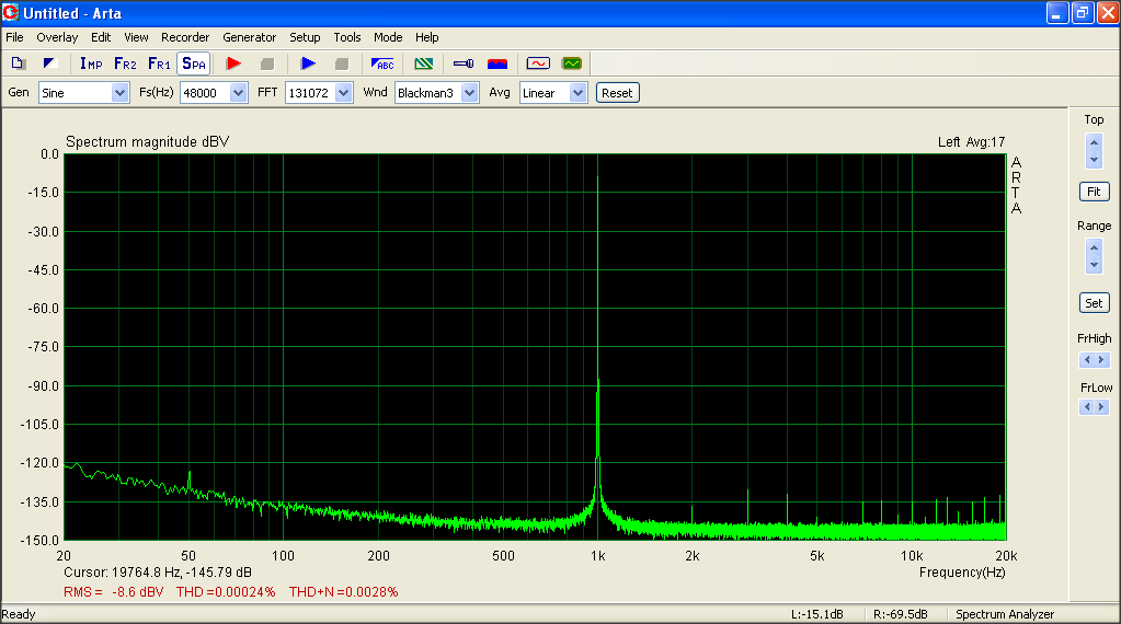

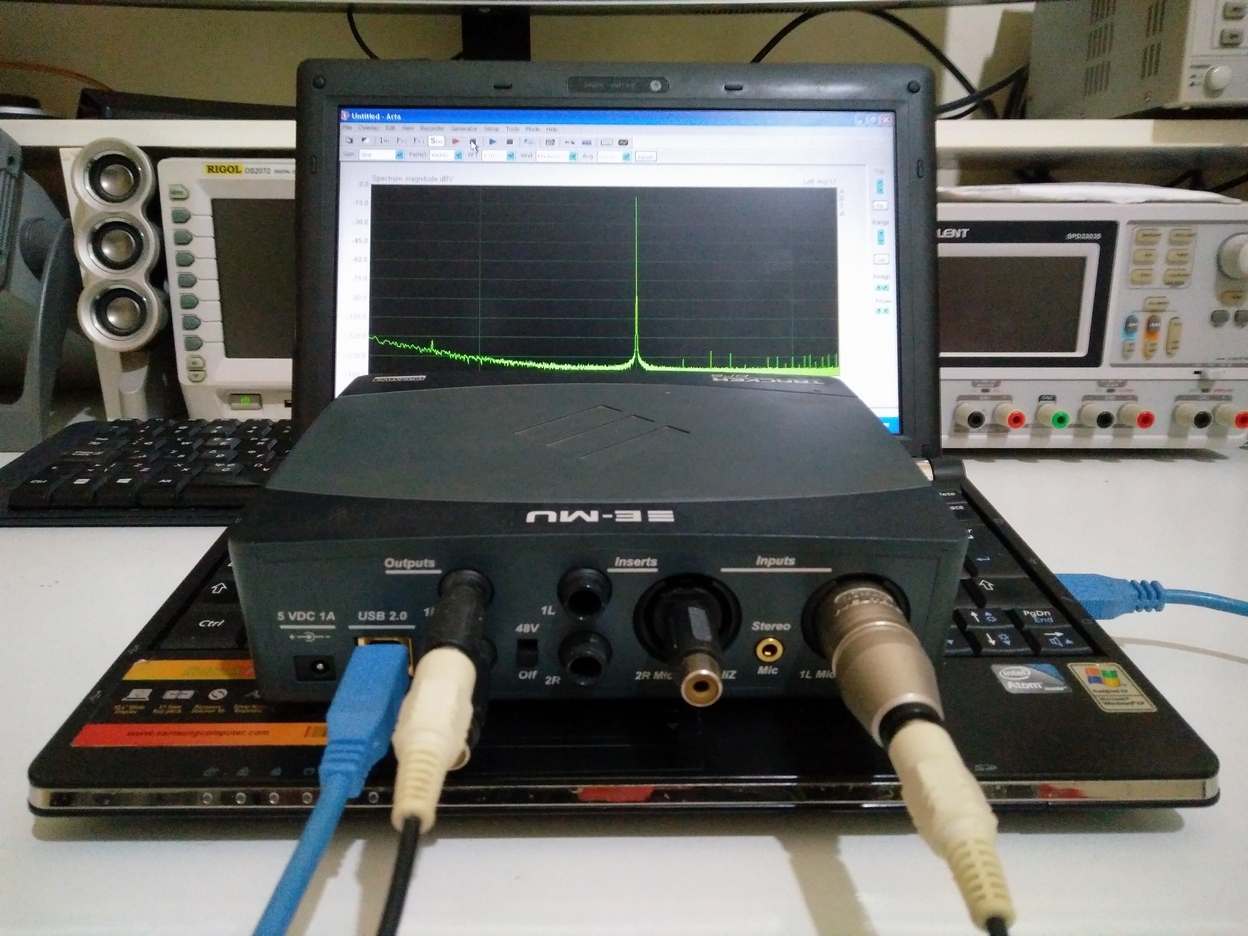

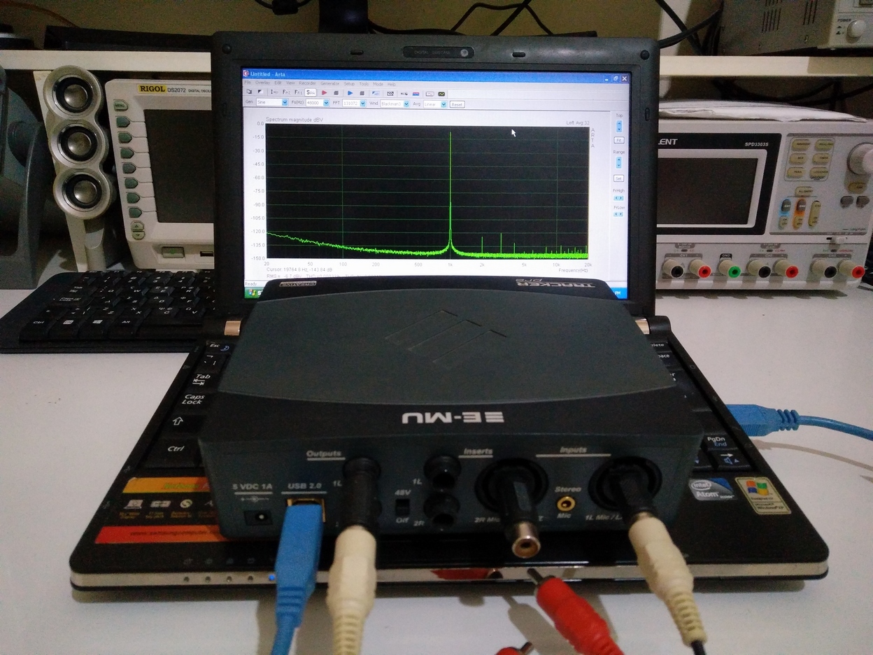

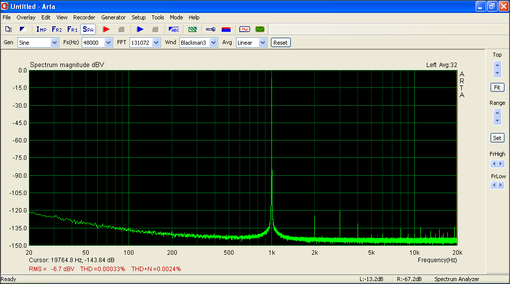

BTW I took some loopback shots of my "ancient" interface that runs properly on Win XP only. Two are with a meter long cheapo cable on HiZ and LowZ input config (1MegΩ with jack, 1.5kΩ with RCA to XLR adapter) last one is with short cable sans adapters. You should be able to achieve better than your now base line of interference and residual THD with the modern Focusrite I would suppose and its worth investigating as the DUT included loopback result looks suspiciously like the interface loopback alone times gain and the more exposed area to interference same type of pick up. Its not a measurements thread I know, and we better don't expand in general lab issues talk, but I include them since that thing came along and they might give you a lead.
I wonder if all this low freq junk I am seeing osndie to the USB powered line. The laptop is unplugged and on battery so not sure where 60Hz is coming from. Yours looks exceptionally clean. It may be that the Solo is baseline model and not as clean? I am using a nice quality RCA cable (1m) with RCA to TRS adapter in one channel and RCA to wire to unbalanced TRS input. Is it because I am using TRS in unbalanced mode? Some more debugging needed.
All those pics I posted are in unbalanced mode to be relevant. RCA to TRS adapters everywhere there also.
Here's the Focusrite 2i2 on a clean self loop. http://www.diyaudio.com/forums/equipment-tools/266853-behringer-focusrite.html
The REW sweeps seem to curiously peak towards the HF there too, yet another quirky thing you spotted before.

Last evening I hooked up my DCG3 with my DDDAC and as I suspected earlier, I have too much gain. Now I have 3x with 1k resistors, but I wonder if 470ohms would be ok choise? I don't have any 500 ohm ones with me, which would give 2x gain.
