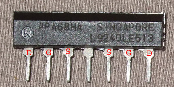

Unsure how the upa68HA should be turned..is it text side on upa68 towards text on pcb?
Refer to my post #908
nash
Slim uPA has the N logo indicating pin1 which goes to the white stripe side on PCB
Fat uPA has its upper left corner slant. Again indicating pin1
The board has pin identification printed on every uPA pad also
Ultimately as you watch from the connectors PCB edge towards correctly installed uPAs the left one shows its face the right one shows its rear
