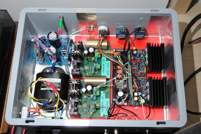

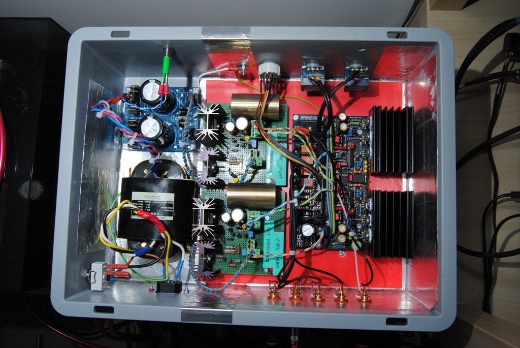

It uses a double winding rcore (2 x 18VAC) followed by separated rectifiers and smoothers that feed two positive V12R (modified).
The V12R are connected in tandem so I can get +-17Vdc out.
So this is not double mono but it works very well indeed. (IMO using two positive shunts with separated TX windings sounds better than the normal way using one positive and one negative shunt).
It was built with 3x gain and uses 50k log alps.

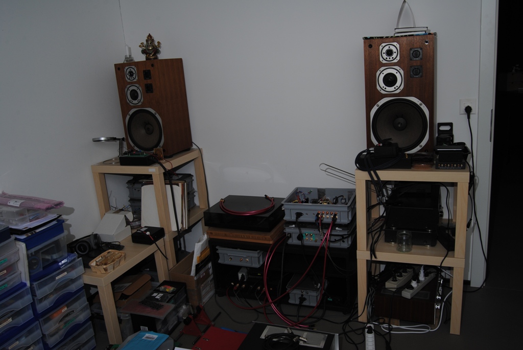

Quite nice & unusual execution Ricardo, congrats :up: Raw DC twin positive rails board from FSP, a Mezmerize type In-Selector, matrix built twin positive V1.2R shunts on virtual ground midpoint, twin pots (?), i.e. an imaginative building mix from you. Yes the phase shift remains linear in the audio spectrum. You caught it in the lab although I haven't referred to that detail 😉 Yamaha NS1000's I also see there, cool stuff.
Yes, I should mention that Iam using an f5 with 15db gain and 89db 3 ways. My current BA-3 preamp has 20ish do of gain. Others with more sensitive speakers and more power amp gain will be happy at 3x. My situation is not typical.
Twin pots I always prefer so I can adjust level individually (like a balance without cross talk)

Found a strange noise coming from the shunts (like the noise that sometimes comes out of an incandescent filament light bulb)... will measure currents to see if I am not starving anything.
PS: this noise does not appear on the output so it is mechanical... maybe the heatsinks of the shunts singing ?
I don't know, never had that in such type handmade PSU. In general I have listened to capacitors and coils ringing with ripple, especially in SMPS, along test frequencies singing from metal can transistors in SS power amps, as well as from OPTs in tube amps.
Now I thought of something else... in a double bridges situation as you use, if the two secondary sections aren't well wound very symmetrical, or there is a phasing mistake in wiring, there could be overload of one section and mechanical hum from the transformer parts. Even so from bridge diodes themselves.
