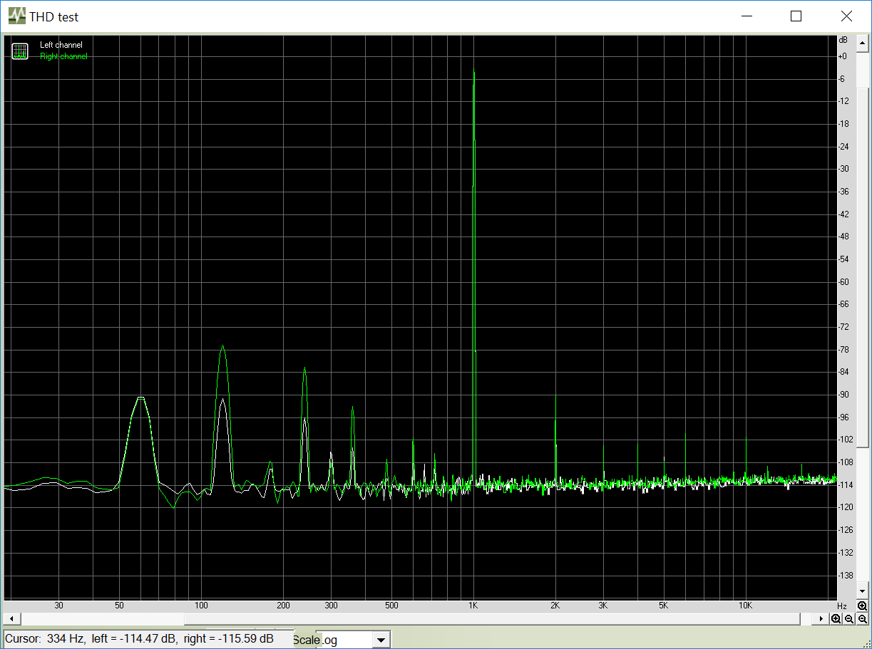

I got the Focusrite Scarlett Solo audio interface and it does appear to let me turn the volume pot to max level and not have a crazy exploding FFT. I still have the 15k R1 in place so maybe the harmonic profile is not perfect but THD is now 0.0055% much lower. However, I see all sorts of lower frequency peaks appearing now. The amp appears to be behaving though and the clean FFT confirms why my ears were not hearing anything when the UCA202 was showing high levels. The measured frequency response is now ruler flat.
The left channel is going through a microphone amp on the Solo and the right channel is going through a line amp, with gains adjusted to match but it looks like they have different low frequency pickup of noise artifacts.
That's very encouraging. Seems that most of your troubles were experimentally related. You may have a ground loop in your new rig now though. Is there a ground lift switch in the Focusrite? Set your FFT at 24 Bit 48K in Arta and 65536 long the least because you still get the same -114dB floor limit like before and the new one must be more capable. Run an interface own loop test to establish what is inherent and what is added so to debug DUT grounding / cabling better.
