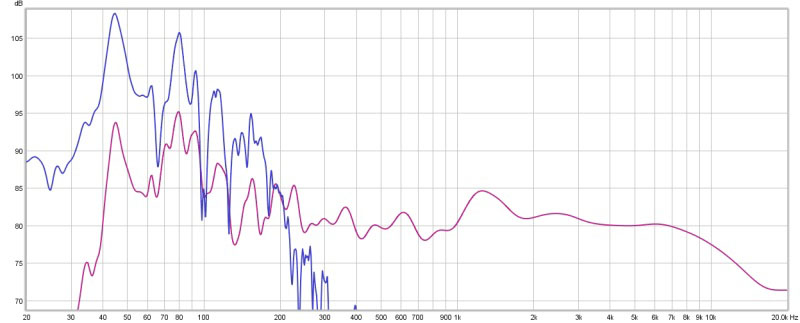

Sub Integration (with Measurements) What would you do?
What would be your recommendations for how to integrate subs and mains in this scenario.
  • Recommended crossover points.
  • What to do about nodes etc? The peaks in the LF appear to be at 45, 80, 112, and 155 Hz.
  • Do I knock those down with PEQ first, before applying the crossovers?
I have a miniDSP 2X4 HD
I have two REL Strata III subs, and a pair of Reference 3A Dulcet speakers:
6moons audio reviews: Reference 3A Dulcet
Subs are located 30 inches away, and 45 degrees behind and towards the center of each main. (See sketch)
Attached are a few measurements. I took three measurements and averaged them for the sake of this post. I used VAR smoothing, which seems to keep the LF pretty detailed, while smoothing the higher frequencies. Subs and mains measurements are taken raw, with no crossover or filters on the subs or in dsp. Obviously the blue is the sub and the purple are the mains. Subs are cranked up way too high obviously, but I can turn those down in software or with the dial. The question is about approach. Nothing is dialed in at all right now.

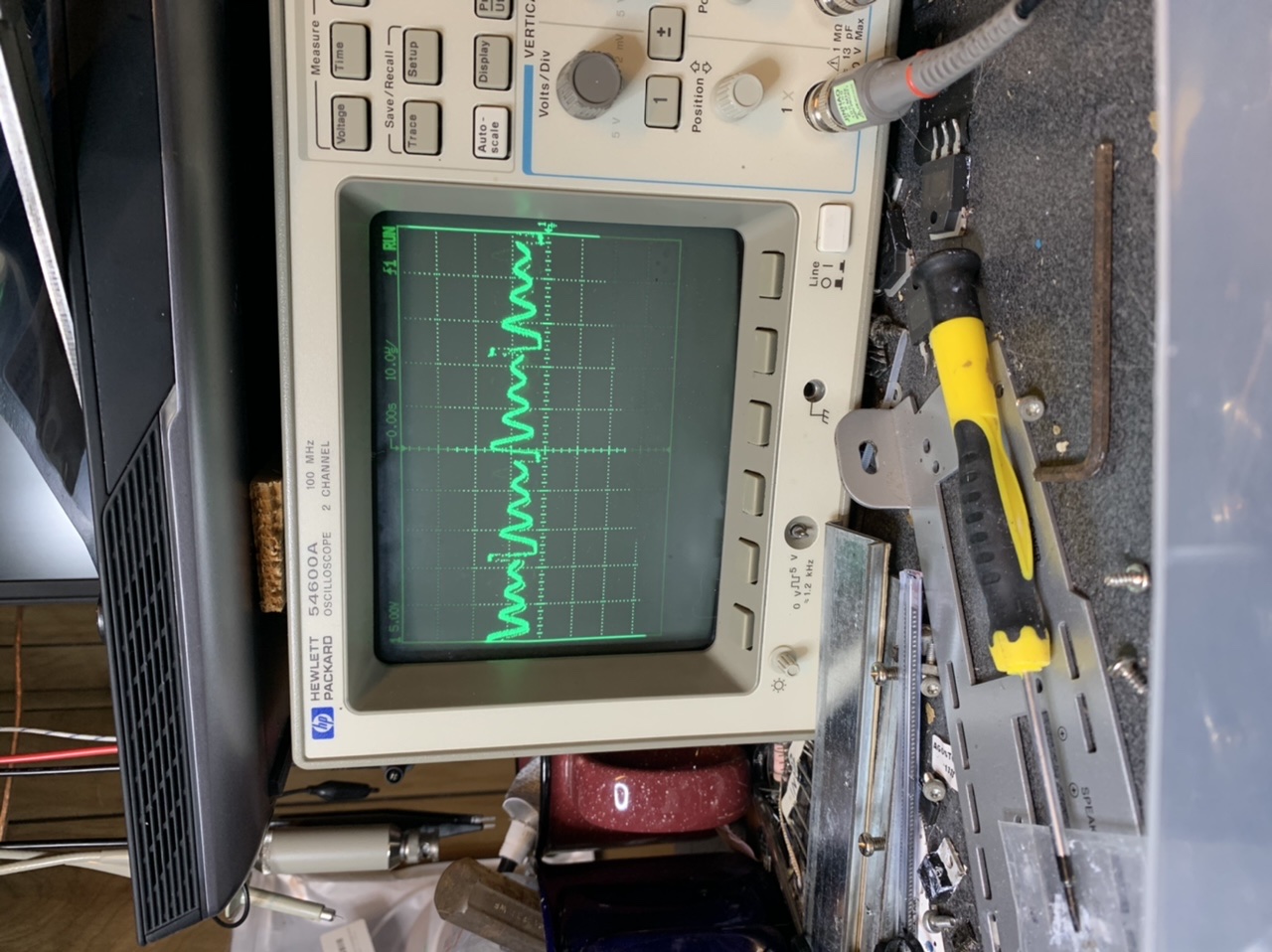

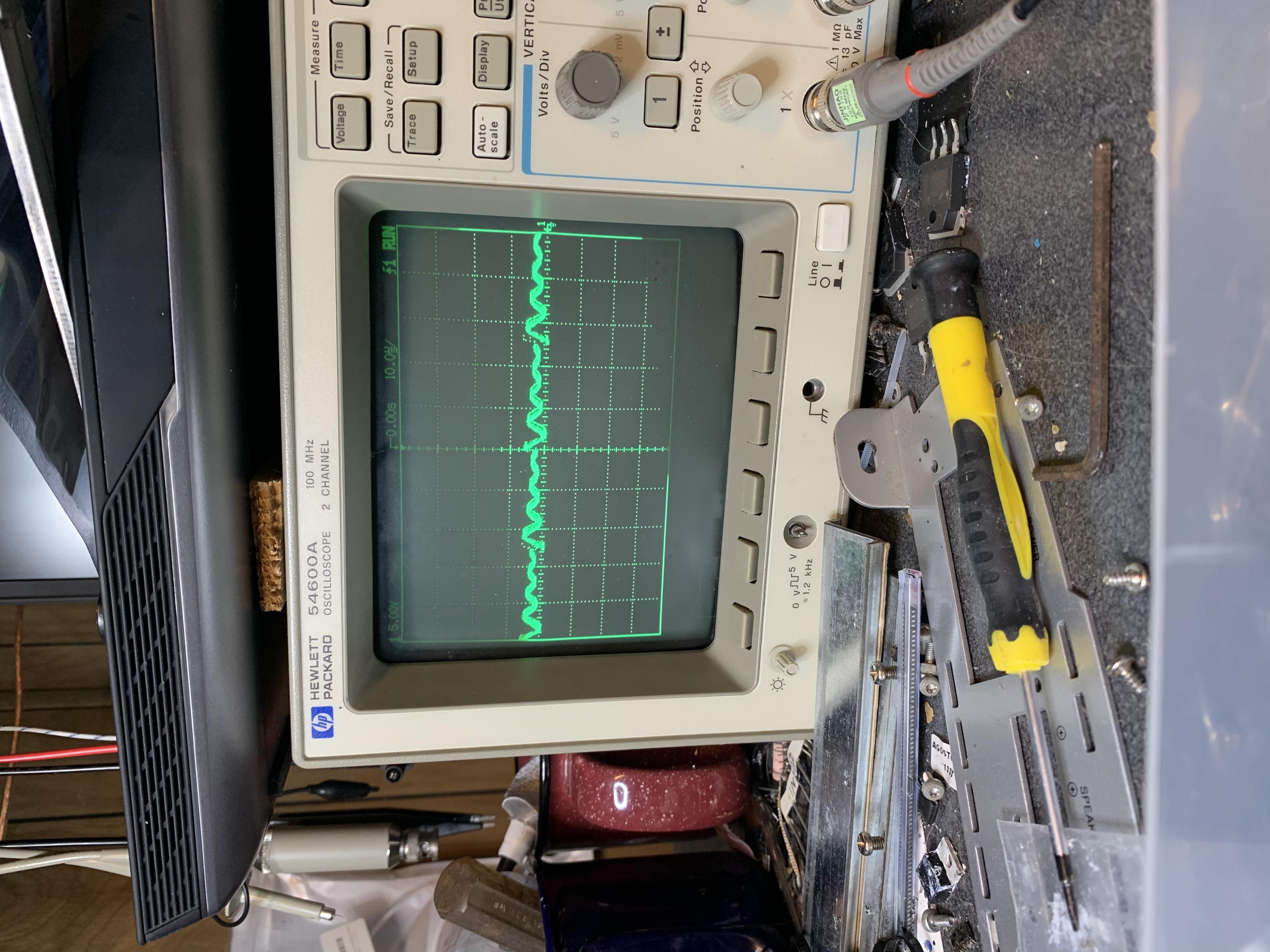

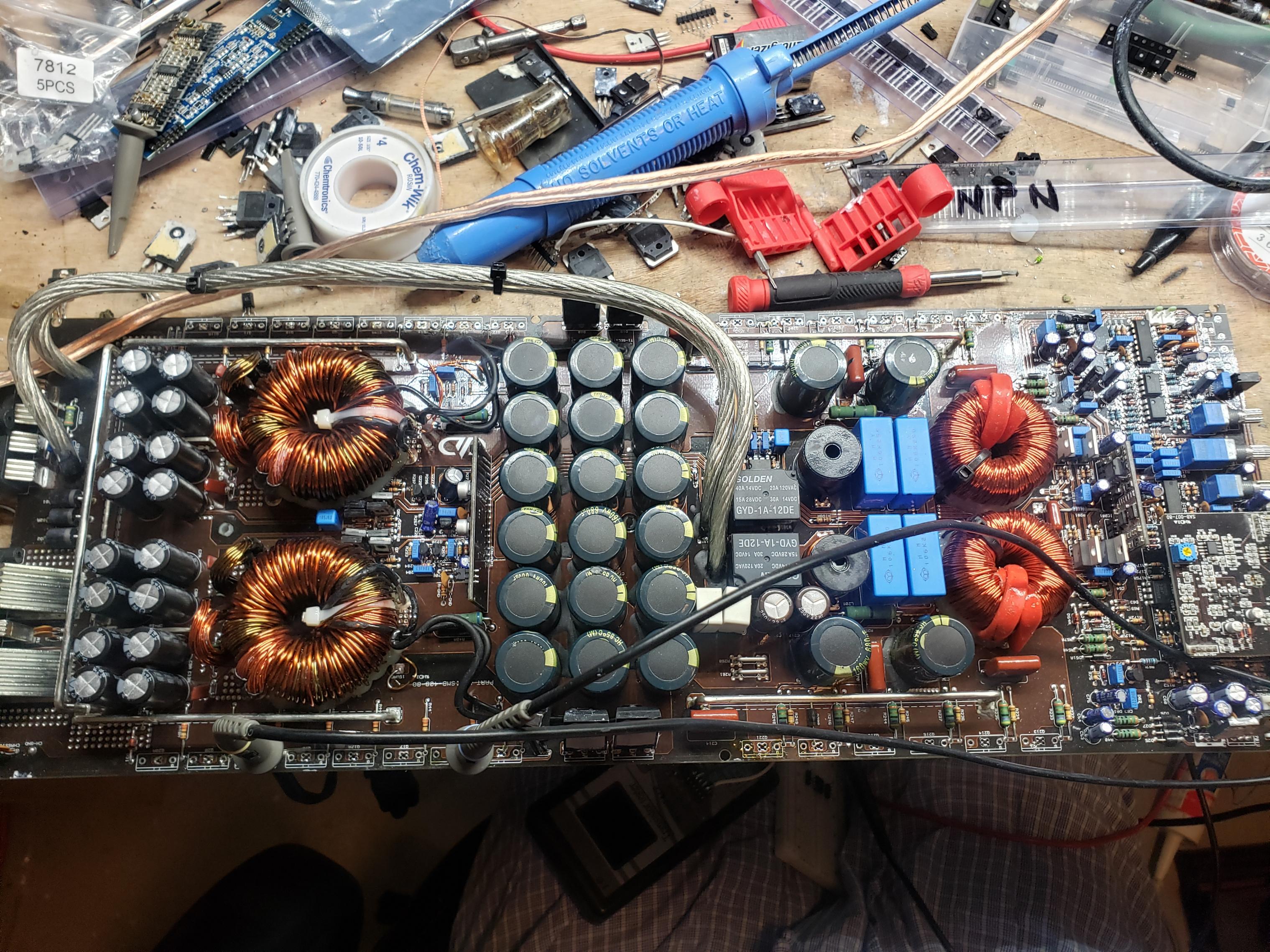

Soundigital SD1600.1D power supply drive
This amp came in with blown rectifier (U1620G). I installed a new one and the amp powers up and produces 70 volts rail and send clean DC to the output section but this power supply drive looks horrible.
Is this normal for these amps? It doesn’t look good to me. It looks like this all the way into the rectifiers but the rectifiers clean it up to straight DC. I’m wondering if this dirty looking power is putting undue stress on the rectifiers. If so, what could be causing this?
David

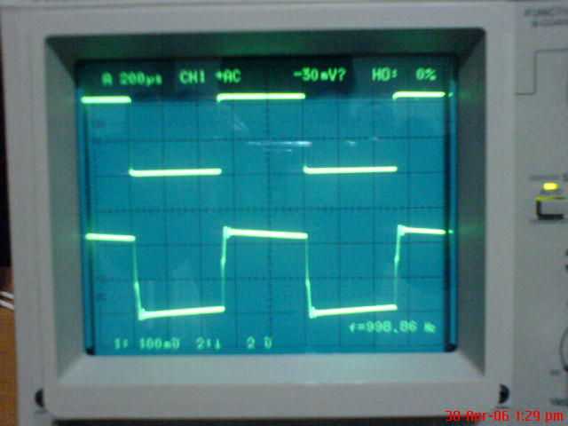

Measuring Vpp Sony PS-X9 with Rigol DS1054Z
I am having some difficulties measuring Vpp with my Rigol DS1054Z. According to the Sony service manual I have to adjust two pots so that it measures 6Vpp for H1 and H2 (after removing a bridge and feeding the circuit 1VDC).
Somehow I can't get a stable sine wave and the Vpp fluctuates. I am sure it's down to me not understanding all the features of the scope. Attached you will find the service manual instructions for the Sony.
Could anyone give me some tips to get a clearer steady wave form? Perhaps I need to reduce resolution or average the signal? Your help is much appreciated.
First time fireing up amp - only popping noises
about 10 years I bought a VTA kit (tubes4hifi) for the Dynaco ST70. Using the schematic I tried to build up an amp around this board.
Now, I finally had time to 'finish' it - however when engaging the high voltage I only get popping noises from the attached speakers which repeat about very second.
Also the bias voltage which should be adjusted to 0.4V is constantly alternating at around 1.5 to 2 V.
The problem is on both channels
I did not dare to let it run longer than a few seconds to half a minute... In the latter case i go smoke from in side the amp, or an EL34.
Is there a high risk to break anything? (I guess so.) And does anyone have a good idea where I should start looking for mistakes?
Thanks a lot!

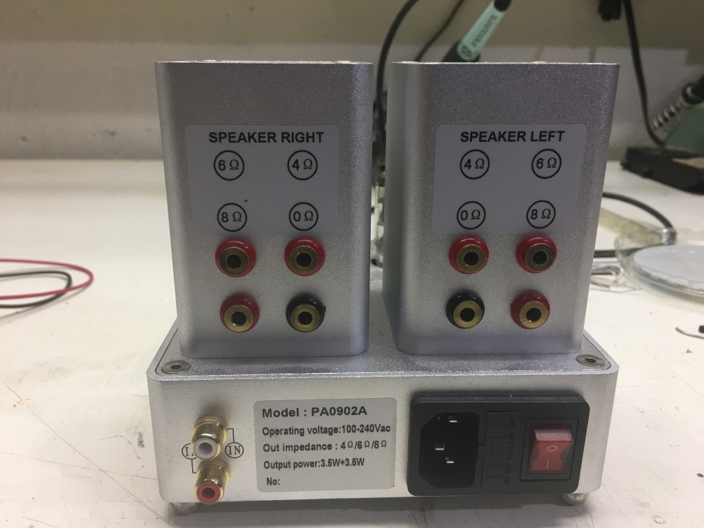

Dead mini tube amp APPJ PA0902A
Hi all.
First post after lurking for years... My office PC mini tube just died. It had been on almost continuously for a few years, but recently, due to these uncertain times, I turned it off and on a few times when leaving my office as I did not know when I could come back. When I came back to the office yesterday, I turned it on but only the power switch light came on, the tube remained cold and nothing of course came out of it.
It is a fairly rare version (APPJ PA0902A) with two 6J1 input tubes and two 6P1 power tubes. It always ran hot, including the transformers, but sound was alright--except for a strange intermittent 'crumpling paper' noise in one channel.
The fact that the tube heaters don't come on points to a failure of the switch-mode power supply (unless I am missing something).
So here are my questions:
1. Does anybody have a schematic for this amp? If it's just the power supply, It would be a waste to throw away the amplifier part with its transformers etc.
2. Is it a well-known failure mode and the power supply can be fixed? It is not-potted, so MOSFETs etc. are accessible.
3. If it is unrepairable, does anybody need these parts?
If anybody has suggestions, they would be welcome! Cheers.
--Christian

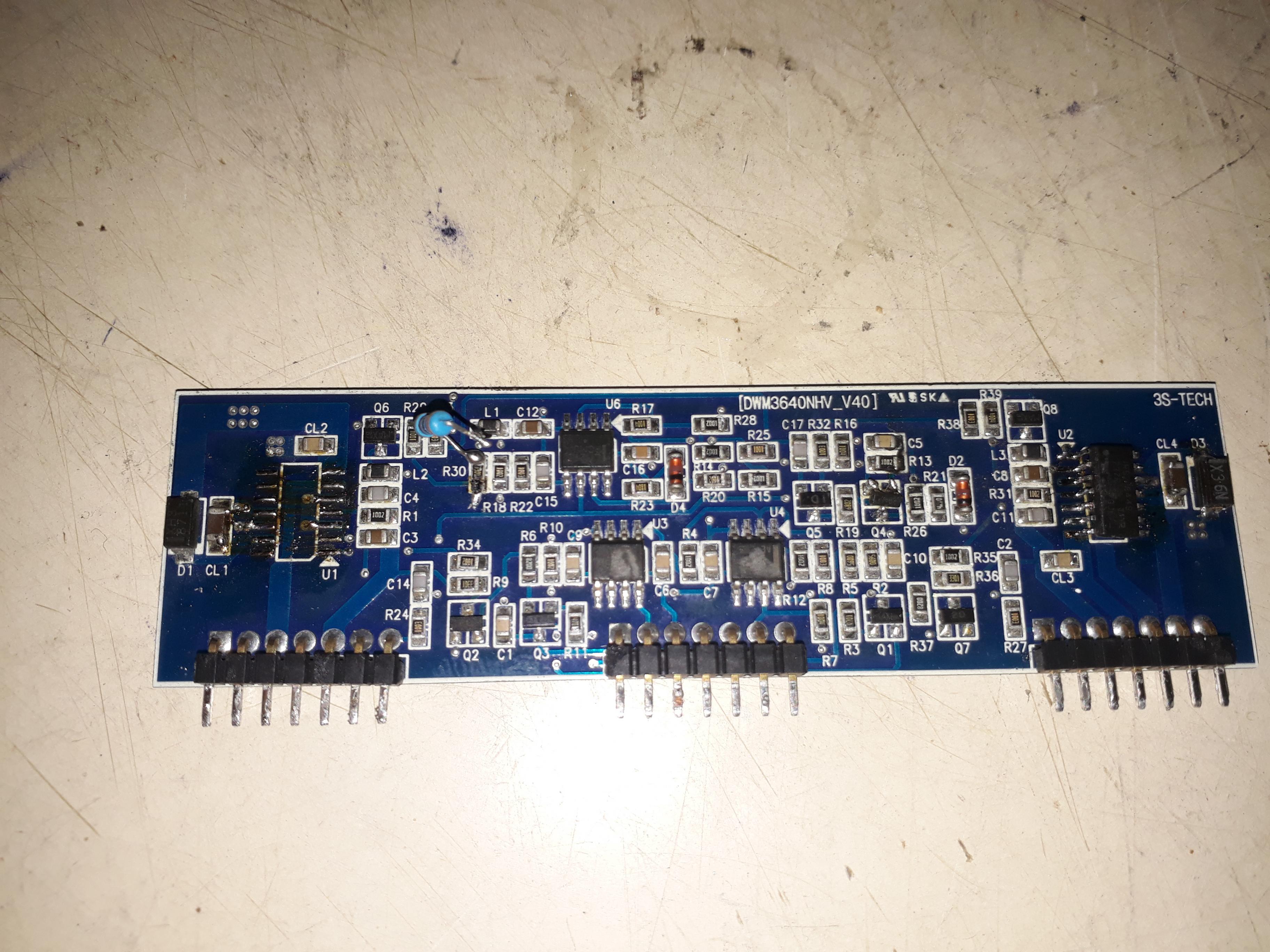

IR2113 blowing ! help needed...
hi everyone,
I've been reading this forum for a long time but this is my first request...
I have made a half bridge class d amp not self oscillating, based on a 16MHz crystal and 4060.
the triangle wave is 700mV pp @ 250 Khz
the input opamp is TL072 (supply +-10V)
LM 319 comparator feeding a level shifter common base transistor
the next stage is 4070 and IR2113 to the N cannel Fet IRFP4227...
54uH and 470nF LC filter
post filter feedback
Power supply is +-80V 1kVA
IR2113 4070 are biased 12V over -80V
First power on no problem sound was great deep bass high frequencies clear but when i pushed it to clipping (symmetric at least !)
1 min after the 2 fet and IR2113 blow up
cooling was sufficient.
I don't know what happened please help...
Fets are not cheap and IR2113 blow every time fet do...

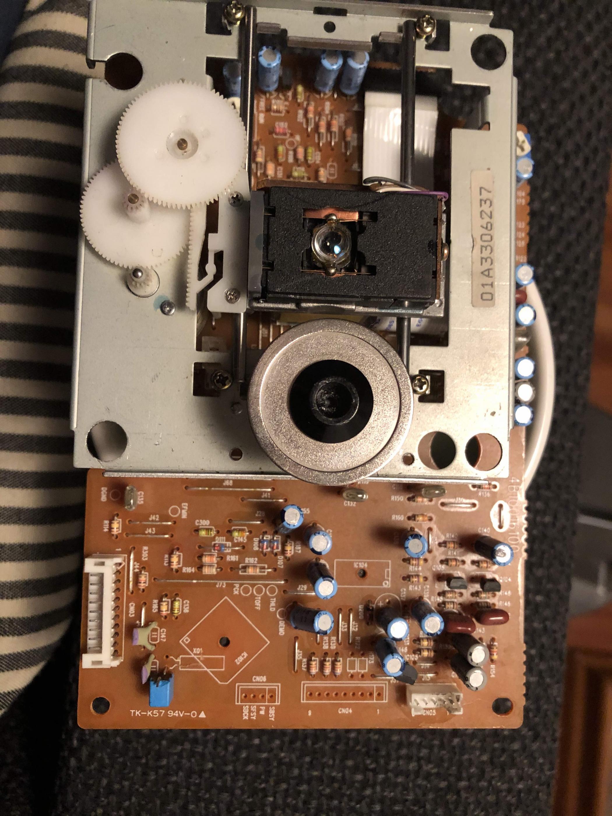

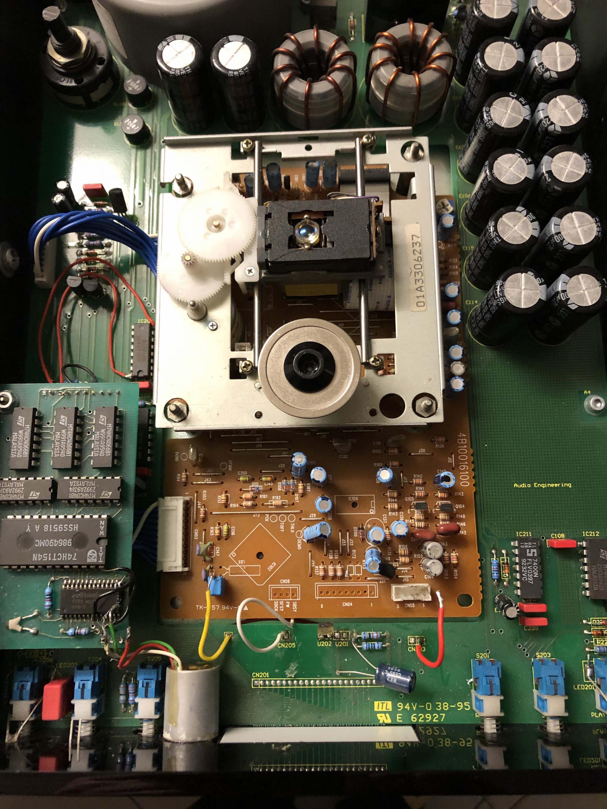

Sanyo CD Transport from Candeias Modelo
Hi all,
I am desperately looking for a replacement board for a Candeias Modelo CD transport. It is from Sanyo and must have been part of their own CD players. The pickup is an SF-90.
Furthermore, it would be great if someone knows where to find more information on the Candeias CD transport. Unfortunately, one of the previous owners tinkered with it. A picture of the inside would help, at least.
Cheers
Marc

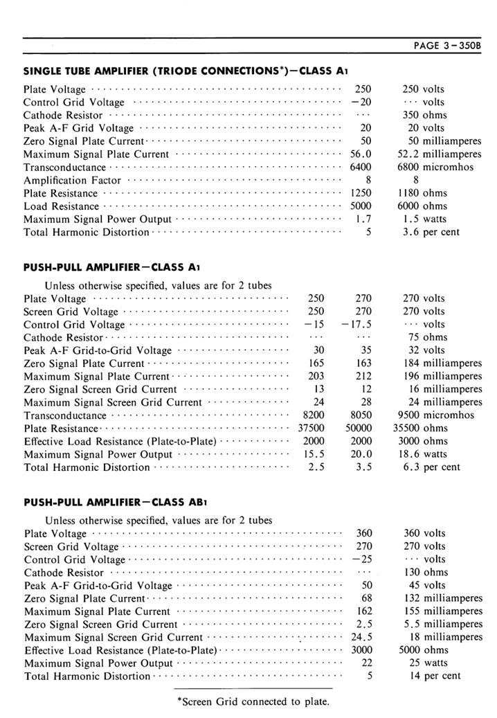

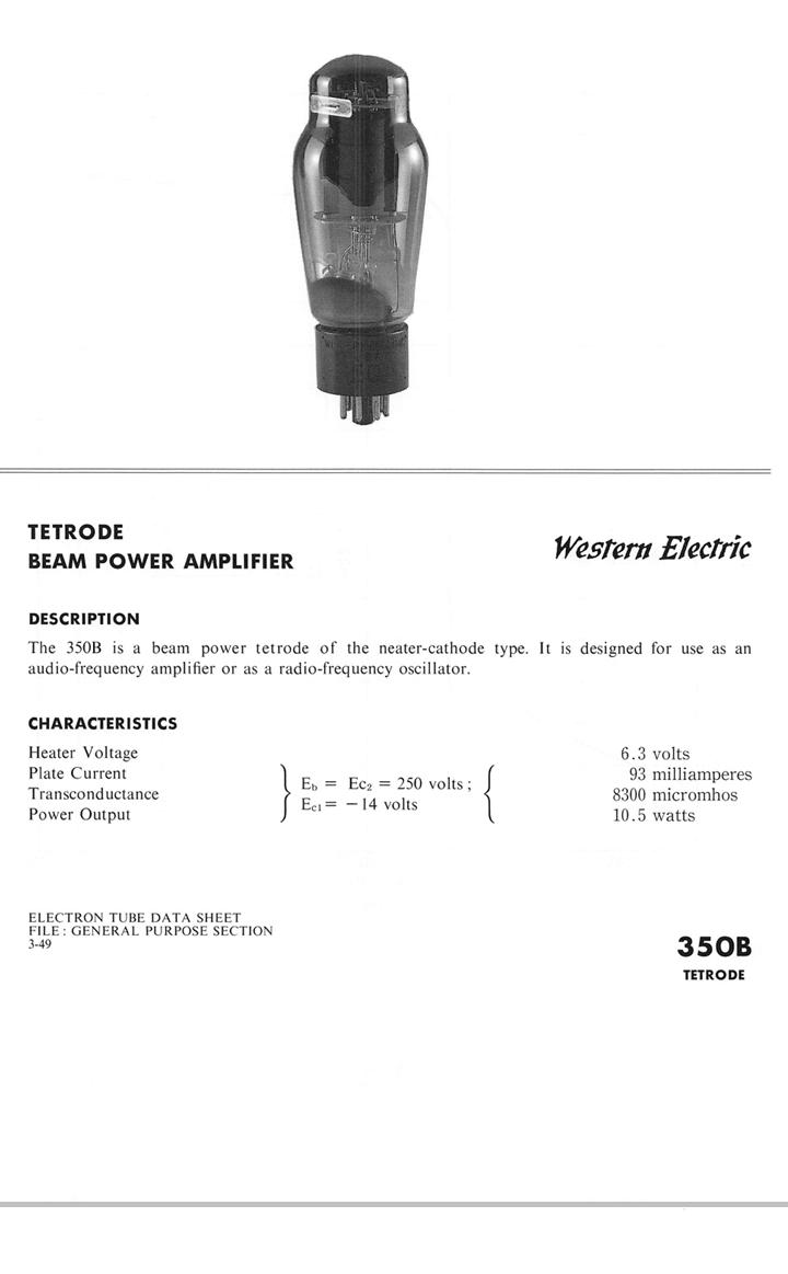

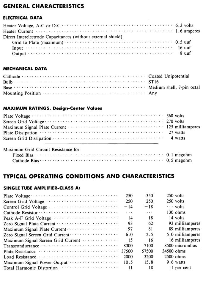

Western Electric 350B Beam Tetrode, or UL
Hi.
I am building an amplifier with WE 350 Beam Tetrode.
I have a dude.
In the datasheet , i can see , 16W output power with 18% of distortion , and 11 W output power with 10% of distortion. I think tetrode mode.
Can anyone imagine how many watts of that 16W or 11W could be used for audio.
In ultralinear mode could you lower the distortion ?
Santiago
