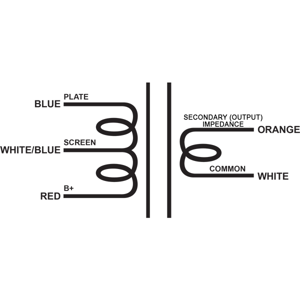

I have a question with the Edcor GSXE10-8-3.5K output transformer. It has a white/blue wire labeled as “screen”. You can see the printed label is visible in one of the above photos. I do not have any idea where this would be utilized. From some of the reading/research that I did I THINK what I understood is that it is not used in a SE Triode setup like the clarion design. Can anyone confirm this or explain its purpose/use.

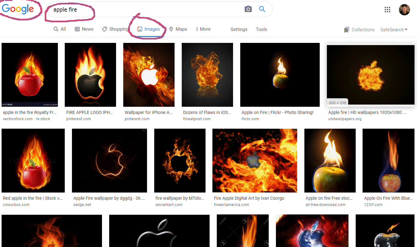

> Anyone know where to have custom emblems made up? 🙂
Google "Sign Shop near me".
Nobody really advertises custom emblems. But the machines don't care what you call it; they put ink on plastic or metal, or cut vinyl shapes. Here we use Kustom Visual Kreations: "We are an automotive customizing shop. We ..do ...Vehicle Graphics, Business Cards, Magnetic Signs, Boat Lettering, ...and more...."
Also Google "Apple fire images".

Does anyone have any input on that “screen” leg of the output transformer? I think what I am understanding is that it is not used in SE triode setups. The link above is the schematic provided by Edcore with the transformer. On Haggermans schematic it shows a middle leg that goes nowhere but to a greyed square box with no tag or ID.

The screen leg is to work pentodes in ultralinear. If working as triode, just tape-off that lead so it doesn't short-out and release smoke.

Thanks for confirming my suspicion!!
