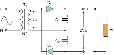

If a switching PSU has failed, there's nothing stopping you from building a linear replacement in a secondary chassis. That can be economically done by "full wave" voltage doubling the O/P of a Triad N-68X isolation transformer.

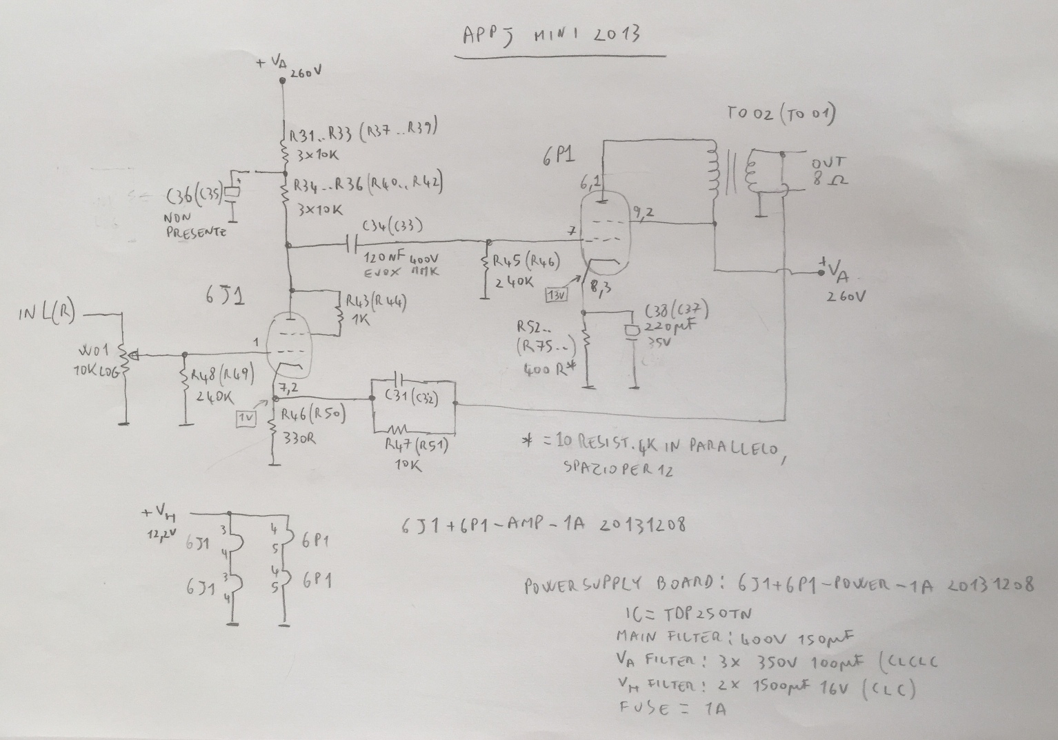

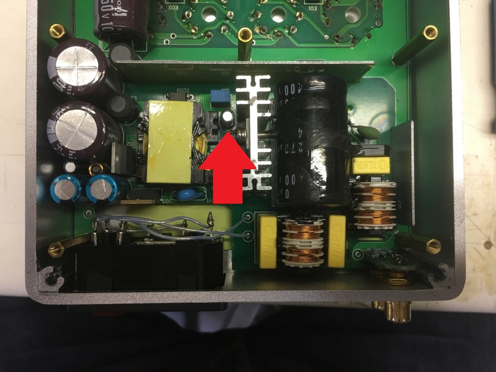

I have both the Appj 2003mini amplifier (6J1 6P1) and the PA0901A amplifier. Your PA0902A should have a 2003mini amplifier board mounted inside the PA0901A chassis. The power supply board is the same. The TOP250YN switch mode regulator has probably failed. This is a fairly inexpensive part you may source from major distributors such as Mouser. I suggest to order a spare one, because the circuit does have minimal mains surges protection and the regulator is forced at design limits edges. On my amplifier I have done a few modifications, you may check them on the thread listed above.
I realize that on my previous post I've taken for granted the first troubleshooting step. I apologize in advance for this very basic hint, but I don't know your skills on tube technology. Have you already checked that tubes have no internal shorts? Remove all the tubes from their sockets and carefully measure the 260V DC anode voltage at output tube pins (between 6 and 3). Both filament and anode supply voltages come from the same switch mode power supply; a short in either of them will trip the output short circuit protection.

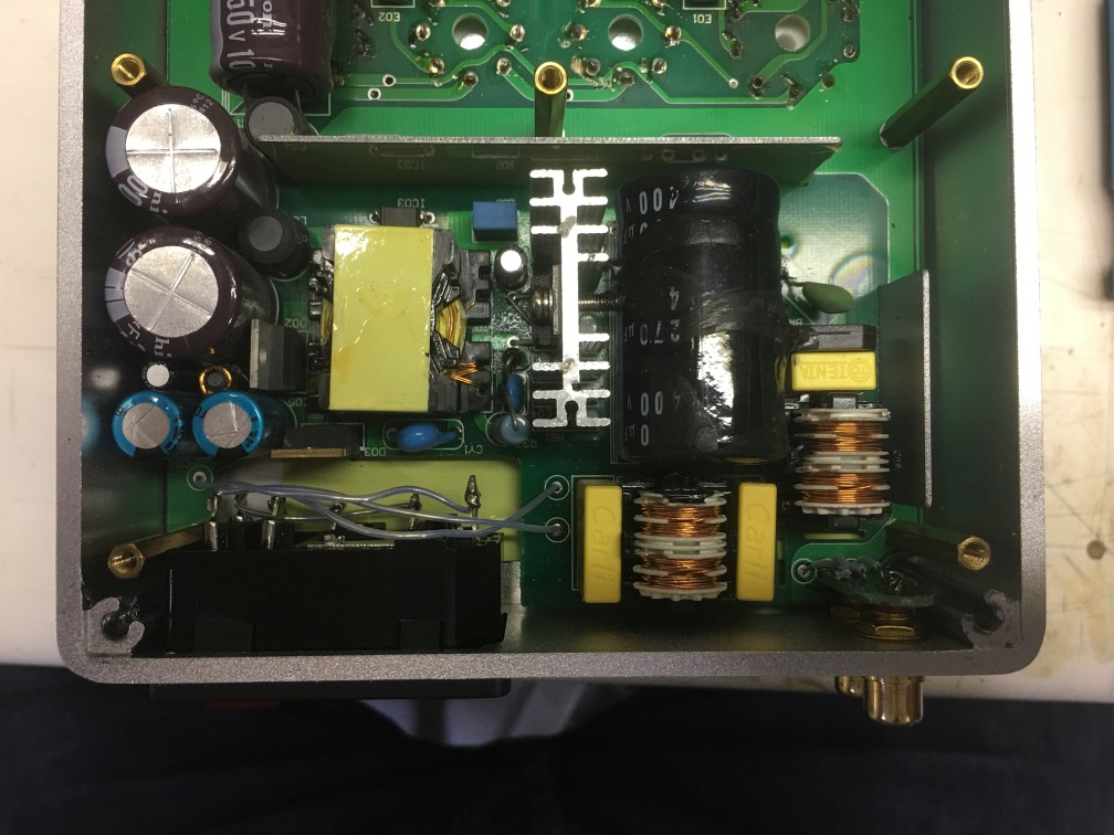

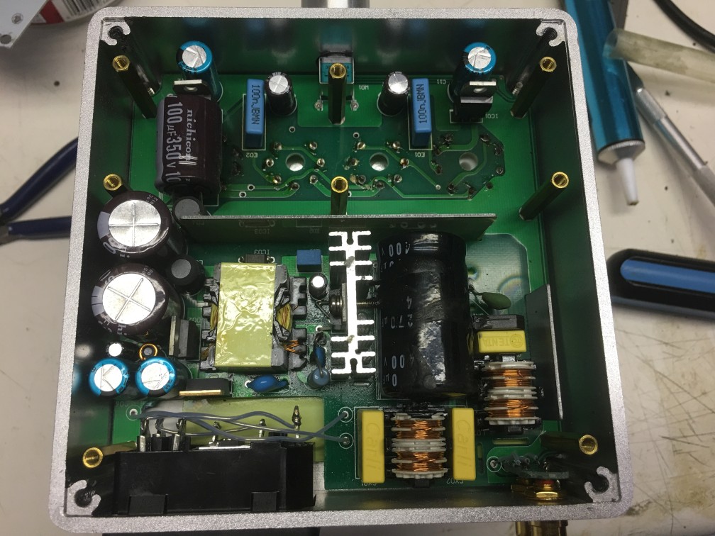

Hi all.
Thanks for the replies. Indeed, I have not tested the tubes themselves for a short. I will do that for sure. Heater power supply failure still seems a possibility. In the photos below one sees the inside. No evidence of catastrophic failure. There are voltages present on tube pins, so power supply is not completely dead. Now that I have schematics to work with, I will troubleshoot some more! Thanks again.

Your APPJ 6 jpg picture it looks like you have a small cap right side or middle to right top that looks to have a bulge in the top of the cap. Could be a bad cap?
You mean the one next to the blue film cap? I think it's ok, just a photo artifact! Thanks though.

The regulator may be there to set the output tube bias; this circuit would be similar to the early appj 0901 (see attached picture). It appears that the circuit has been reverted to a cathode resistor on late 0901 amplifier production. The power supply heatsink is at mains potential. A insulation transformer is useful while servicing.
Looked like the top of the cap was starting to dome up.

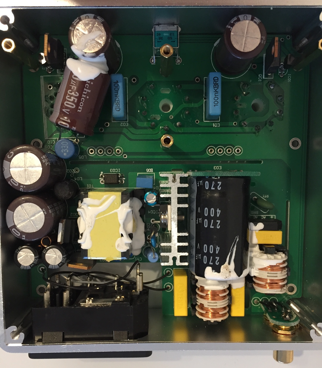

Good eye! Thanks. I looked closely and it is indeed bulging. Cheap parts? Result of something else failing? The whole thing ceased to work instantaneously. As in, I turned it off one day after using it and it didn't turn back on 3 days later...
I wonder if it's worth replacing anything...
--C.
The bulging capacitor should be C35 or C36. It has been omitted on my amplifier. It probably failed due to excess temperature. While you are replacing it, I suggest to also replace the small electrolytic capacitor next to the power supply controller chip (see picture). This is a routine replacement I do while servicing SMPS boards. That kind of capacitor on the primary side of the SMPS transformer may be on the control loop circuit or on the chip power supply; both are critical functions. The capacitor is almost always "roasted" by the power semiconductor heat. A failed or degraded capacitor results in hiccup mode operation (the SMPS turns on for a fraction of a second, then off, then on again, and so forth) or it will disable the startup completely. A high temperature, low ESR part is required. With any luck this replacement will solve the issue. If it does not, you will need to do further tests. By the way, the output tubes on your amplifier looks tired (discoloured getter).
