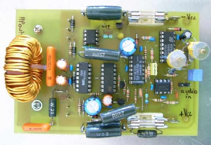

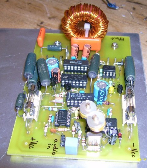

I have made a half bridge class d amp not self oscillating, based on a 16MHz crystal and 4060.
the triangle wave is 700mV pp @ 250 Khz
the input opamp is TL072 (supply +-10V)
LM 319 comparator feeding a level shifter common base transistor
the next stage is 4070 and IR2113 to the N cannel Fet IRFP4227...
54uH and 470nF LC filter
post filter feedback
Power supply is +-80V 1kVA
IR2113 4070 are biased 12V over -80V
First power on no problem sound was great deep bass high frequencies clear but when i pushed it to clipping (symmetric at least !)
1 min after the 2 fet and IR2113 blow up
cooling was sufficient.
I don't know what happened please help...

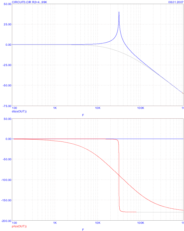

Hallo Alex,
the Problem seems to be the feedback. Feedback including the Outputfilter is not an easy Task, you have to deal with a 180 Deg Phase Shift.
I assume that your Amp oscillates with the Freq. of the Filter, which is approx. 30kHz using your Parts.
Pickup Feedback at the Mosfets, and don't forget to use a Zobel-Glied. Q-Factors of typical Outputfilters reach 200 and more. (Look at the GIF)

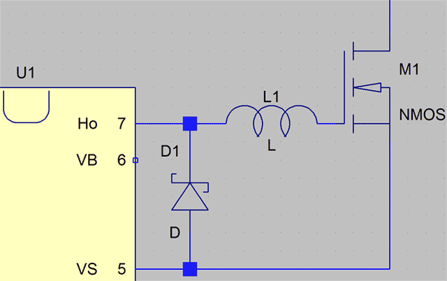

could you draw the schematic please....A photo would say 1000 words....Tim__x said:They're almost never shown, but schottky protection diodes (from the IR2113's gate output to mosfet source) are often needed. Especially with very low, or zero, gate resistors.
regards,
K a n w a r
Quite true.
Here's what I mean, D1 protects U1 from the undershoot created by the parasitic inductance L1. Without it undershoot can forward bias the substrate, in some cases causing latchup.
