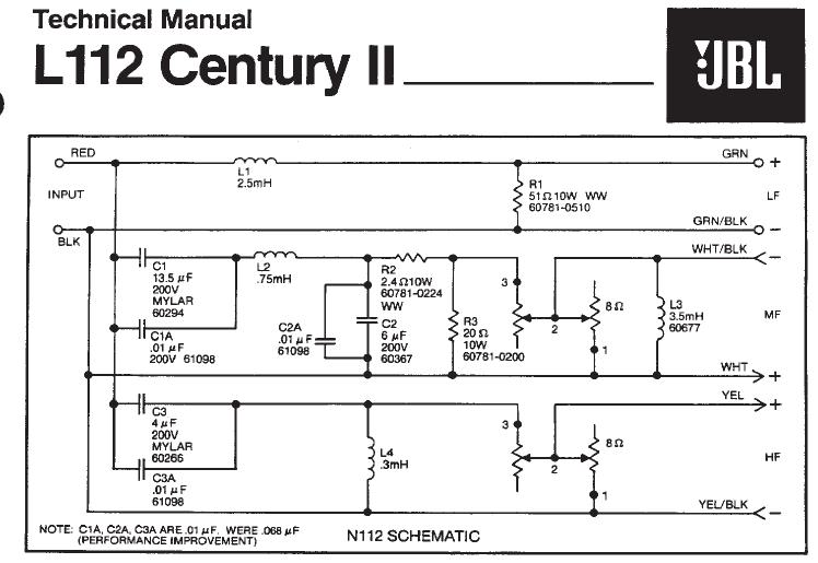

I am attaching some documents for the enclosure, crossovers, etc.

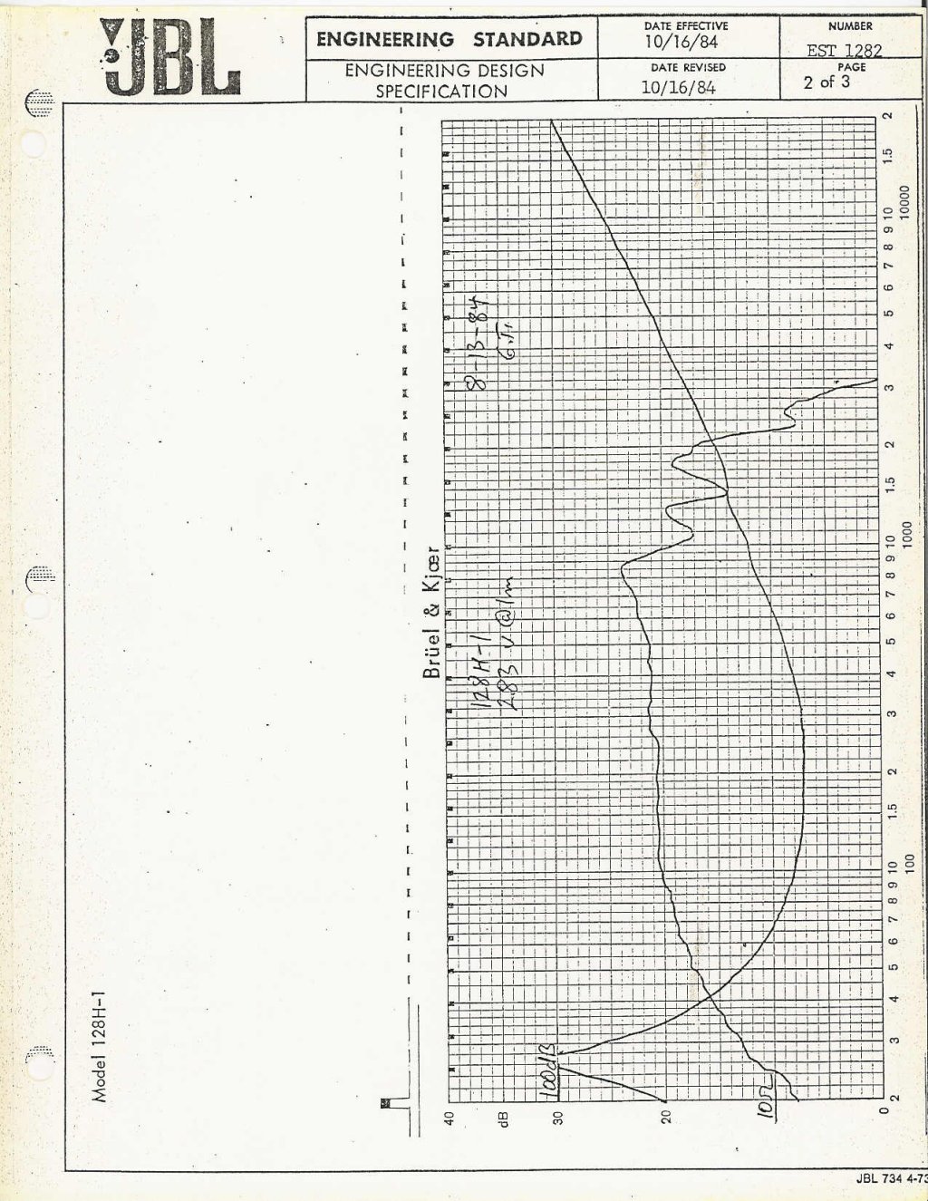

Agreed, looks pretty similar in T/S specs to the original JBL 128H driver:
http://www.diyaudio.rs/JBL/JBL Technical Note - Vol.1, No.3.pdf
