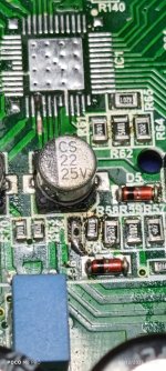

DIODE ZENER 16V 550MW SOD323F in a bigger Package / Case?
I can't find a bigger case.
I'm working on a Rockford Fosgate R600-4D Prime and need to replace 2 Zener Diodes on the underside of the board D14 & D15 (picture)
While I’m here, I tested everything I could but maybe someone that had this problem where all 4 resistors and the 2 diodes blew. Resistors R59, R60, R61, R62.
With those blown the amp gets really hot to touch. Is there anything I should test?
