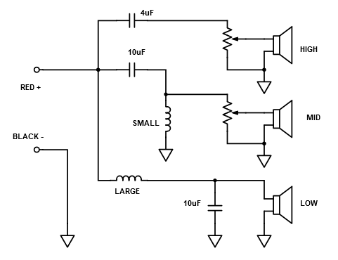

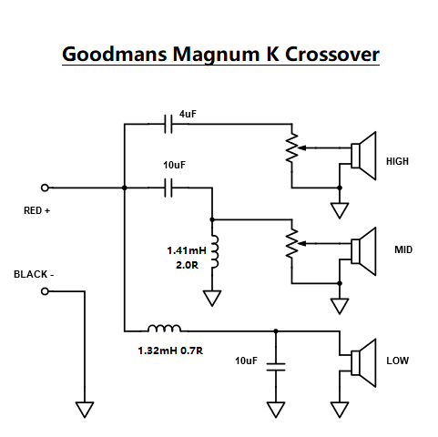

Here they are, both K and K2 diagrams, may the interwebs never be void of them again!
For those who want to remove the Lpads on the Ks, here is an altered diagram:
Thanks to all who have contributed to this thread and a special thanks to @chrisng for his tracing and diagram skills! 🙂

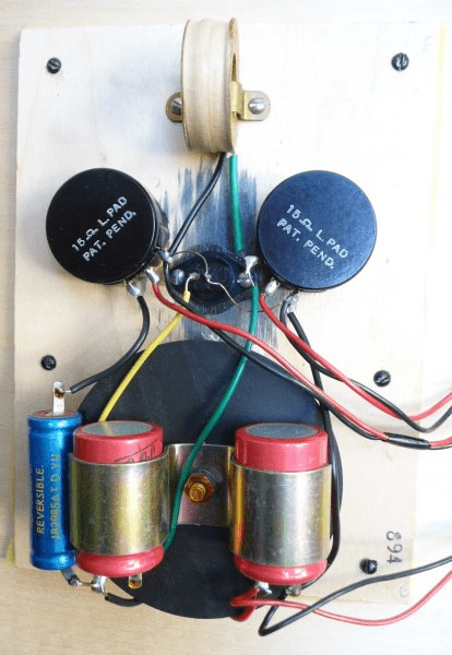

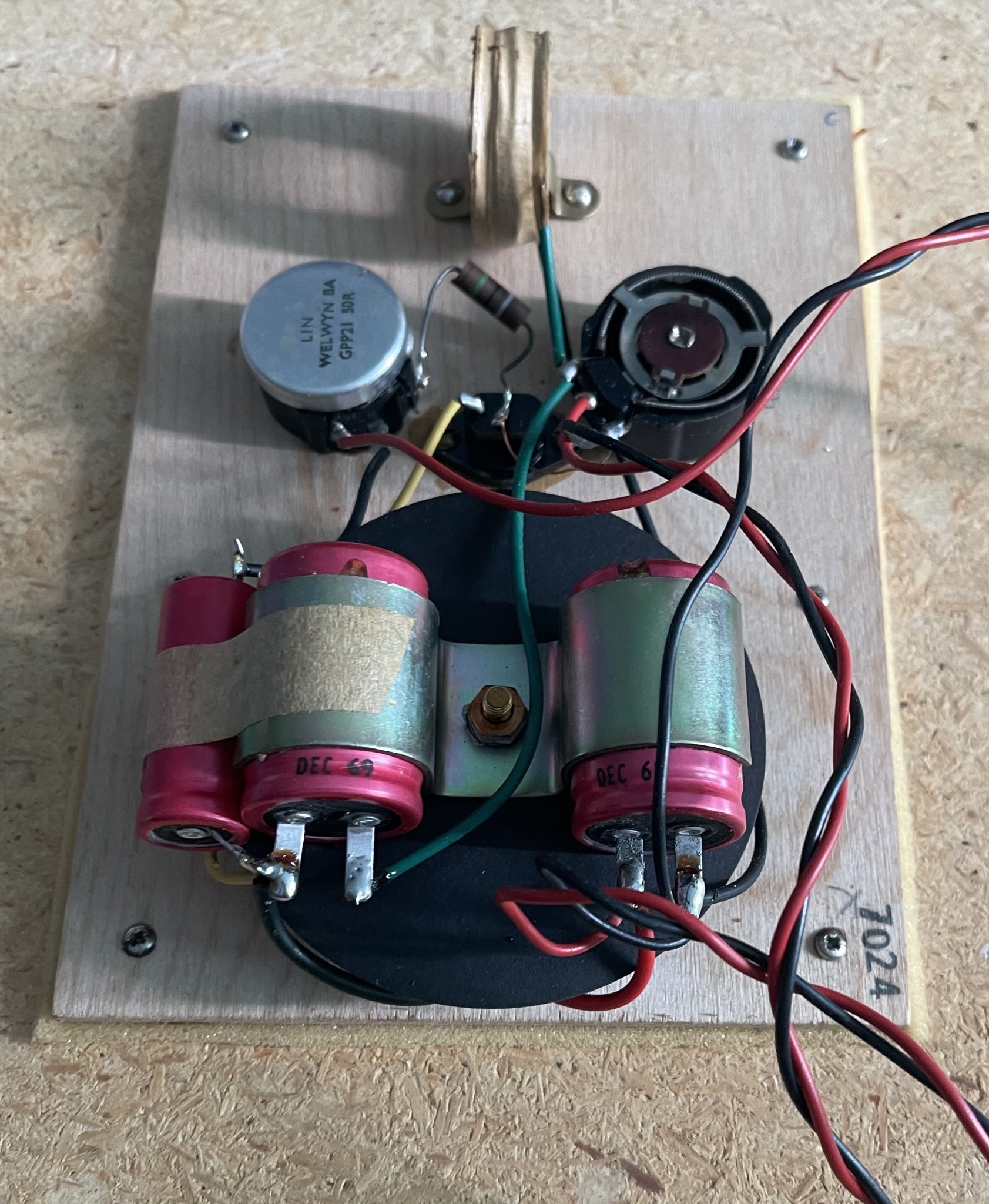

I am after the crossover diagram for the Goodmans Magnum Ks.
In this post here: https://www.diyaudio.com/community/...sovers-and-potentiometers.112926/post-1971834 user alspe had previously uploaded the crossover diagram to google drive. It was some time ago though and the link is now dead. It’s not listed in the way back machine either.
I was hoping to contact alspe, but it looks like they are no longer a member here and I can’t tag them.
I have attempted to trace it, but these old xovers are a mess and I’m finding it difficult.
I thought it would be similar to the K2 but it’s not. Not only because of the Lpads, but the filters are different too.
Anyone got it or able to help?

Hi 🙂 my intention is to rebuild the crossover on a prototype board - exactly the same as it was but replacing all wiring too. I understand the inductors are fine, although I may swap out that smaller one with a thicker gauge. This is for a comparison experiment as I have 2 pairs of these. The Lpads are shot so I will remove. I have the values for the caps, they 10uF and 4uF. The resistor you can see is part of the replacement Lpad on the left.

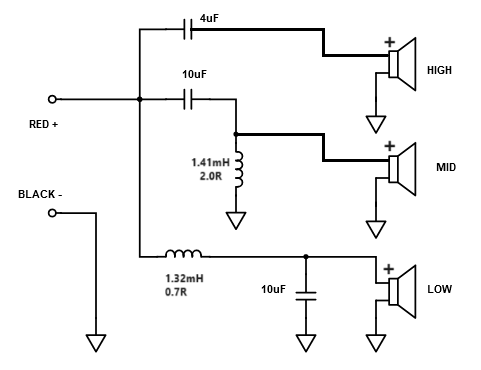

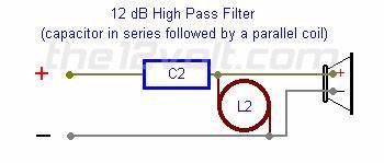

It looks to be a simple crossover arrangement as shown in the first two attachments.
The 10 uF capacitor and larger coil will low pass filter the woofer and the 4uF capacitor and smaller coil will high pass filter the tweeter.

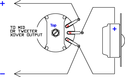

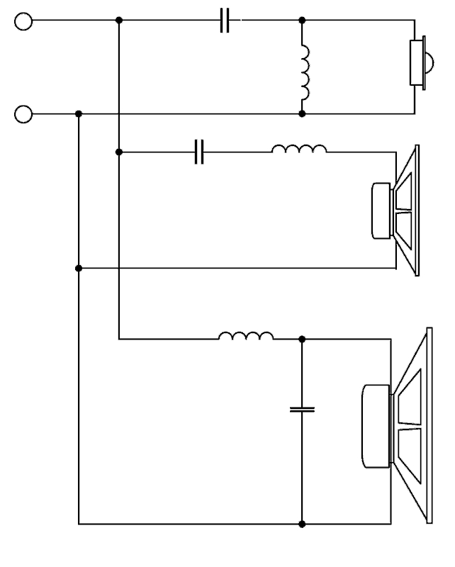

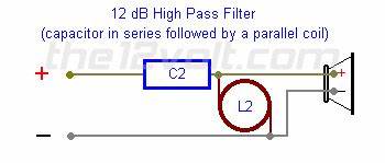

I believe the nominal impedance of the Magnum K2 is 5 ohm (according to Radio Museum) so I would ditch those 30 ohm level controls and, if required, incorporate 8 ohm L pads as shown in the third attachment. You can buy these from Willys Hifi: https://willys-hifi.com/collections/l-pad-attenuators
Wait a minute, I see three capacitors, but you only gave two values.
Are the two on the left connected in series?
OOPS! 😳 Total brain fart! These are 3-way speakers! I blame the heat wave. We're not used to the Sun in Scotland!
Looks like we will need more detailed photographs to reconstruct the crossover.
Crossover frequencies are 1,500 Hz and 6,000 Hz: https://worldradiohistory.com/hd2/I...ecording-IDX/IDX/ATR-1966-4-OCR-Page-0025.pdf
There are three pairs of red and black wires.
Please identify to which driver each pair goes (from top to bottom of above picture).

Here is a link to a lot of photos of the crossover. I have labelled each wire: https://ibb.co/album/rKBFgz
In your pics:
1. bottom right: low
2. Left Lpad: high
3. Right Lpad: mid
In your pics:
2. Left Lpad: high
3. Right Lpad: mid

If you find yourself able to untangle it, I would thoroughly appreciate it. It might sound daft, but the thing that’s frying my brain is the way they’ve tacked certain wires to the legs of the Lpads and caps. I tried tracing it and produced something I thought looked reasonable, then looked again and realised I was wrong. This lead me to just search the interwebs for it but was really surprised that it’s not on all the usual audio sites. It will be after this.. I’ll post it everywhere 😛
I started to untie the knot before going to bed, but quickly realised that success would necessitate referring to more than one photograph at the same time.
I'd really need to have the physical object in my hands!
Surely there must be a knowledgeable Magnum K owner out there!

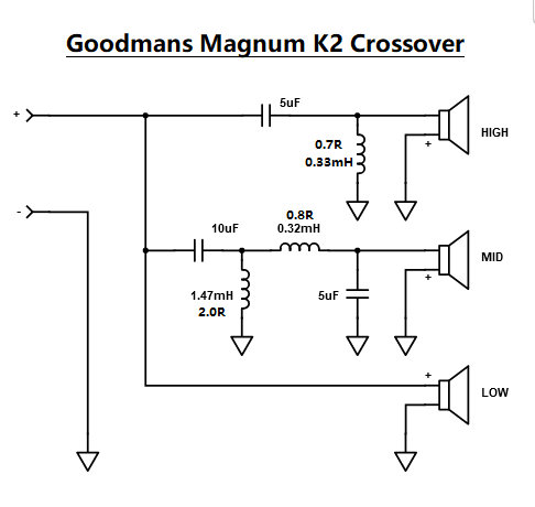

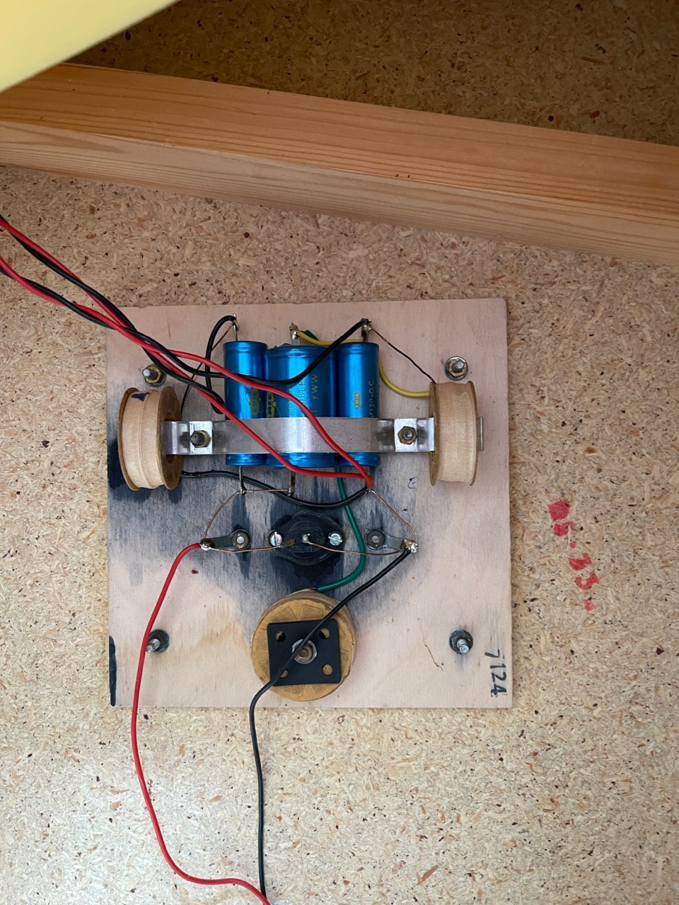

I have 3 pairs of K2s and I could trace the K2 crossover no problem.
The K2 board has three inductors whereas the K only appears to have 2.
I think tracing the K2 crossover would be helpful, as the only difference might be the addition of a third inductor.
The K2 crossover may be structured as shown in the attachment and, possibly, the K simply lacks the tweeter inductor - let's see!

This is a schematic based on above picture:
@Galu from memory, I think what you’ve attached is correct. I am out with the family at the moment so can’t check.
@chrisng you sir are a diamond 👍
If I were to attach a pic of the K2 crossover which I happen to have on my phone, could I persuade you to run your eye over that too?
Also, made a note of the inductors for this one: bottom inductor was 1.47mH, top right was 0.32mH, hadn’t got round to disconnecting and measuring top left. Cap values are 5uF and 10uF.
