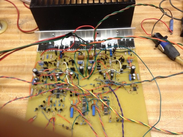

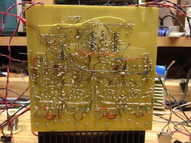

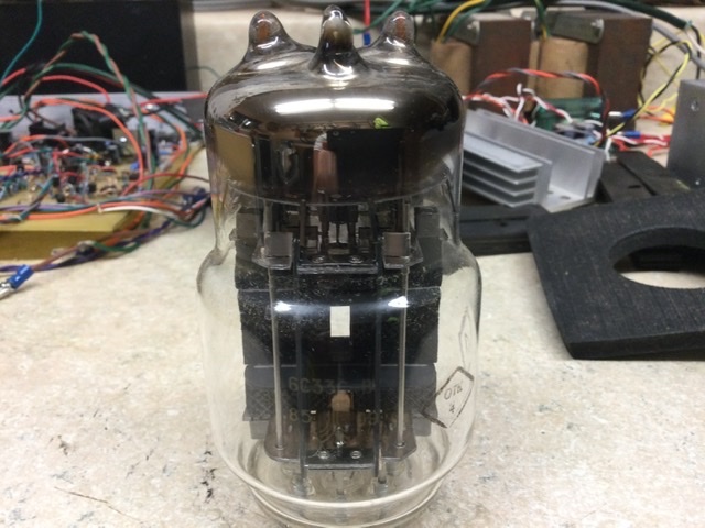

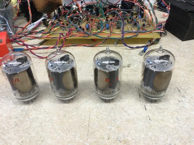

This was the test bed for the protection circuit array to be used on the next iteration of The Big One. The 2 channel amplifier itself is pretty much the same as the one in the Big One with only 2 pair of outputs and just a regular +/-52V rail. It is easily recognizable if you know what to look for and use a minuscule amount of the space. And this photo doesn’t even show the fan/relay power supply driver board which is separate. Like I say, these circuits must be fully vetted before you begin. You can see more complete versions behind the tubes. It as done on a perfboard so I could jack with it till things were working the way I wanted them to. I jacked with it on and off over a YEAR before I ever started the new PCB layouts for the big ones.

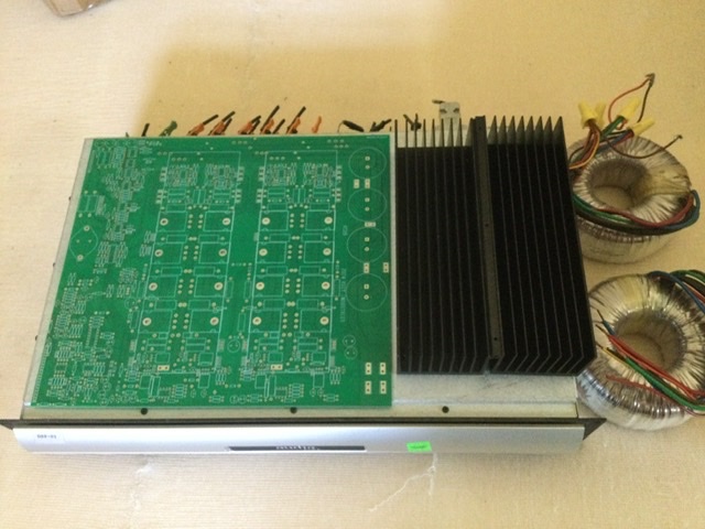

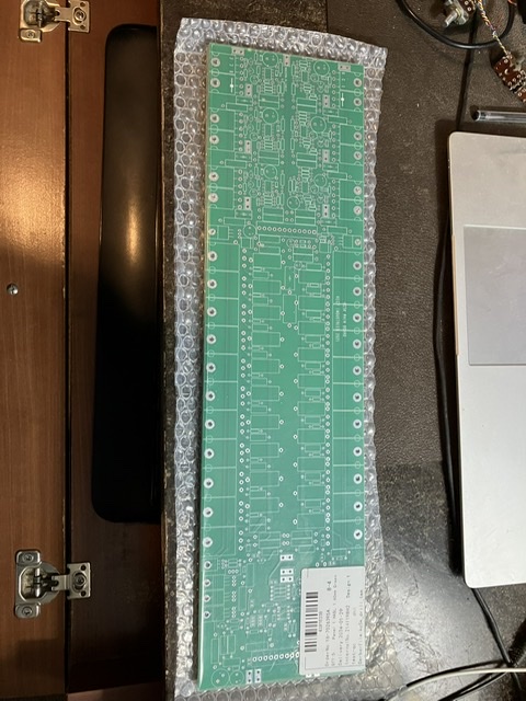

The PCB proof for the big one. It’s just a proof with 1 ounce copper, to be reordered in 2 ounce after any corrections. I already used it to drill the heat sinks for 7 units (! Using the mounting holes, which will be truncated on the reorder so I can get to the screws). The two 12 pin connectors go to the daughterboard which contains all the supervisor circuitry. You can clearly make out the supply commutators, transistor banks, and the rest of the audio - which is tiny.
The other is a single board 600 W/ch class H similar in principle to the Apex H900 with my front end and the QSC rail switches. That entire section to the left is protection circuitry. All of it based on what I did on that perfboard above. These are for the TWEETERS and monitor wedges. I’ve got transformers and cases, as well as drilled heat sinks for a half dozen).

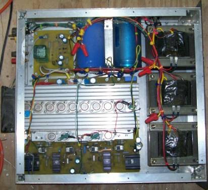

I didn't prefer CE output stages, even it has many advantages. I always built emitter follower output, but not as high power. Here is biggest class AB amp i ever made (20 years ago), 600W/4ohms.
Reactions: hyperaudio_121
This was MORE than 20 years ago - I have two 1200W/2 ohm monoblocks and one 600x 2 stereo version. All that same front end using the LF412 op amp. These has to use cascode output stages since they were class AB. The current consumption at war volume was between the ridiculous and the sublime.

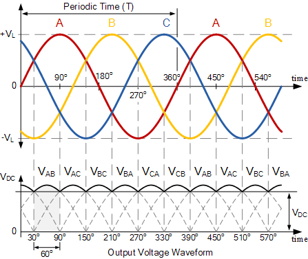

If a three-phase supply is available, the bus capacitance (for the same ripple) could be significantly reduced while keeping the PF intact. I am writing this only because the desired power is in the thousands of watts.
The ripple for a 3-phase FW rectifier without any capacitor is only around 4%.
