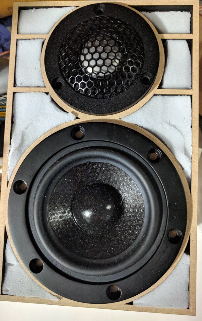

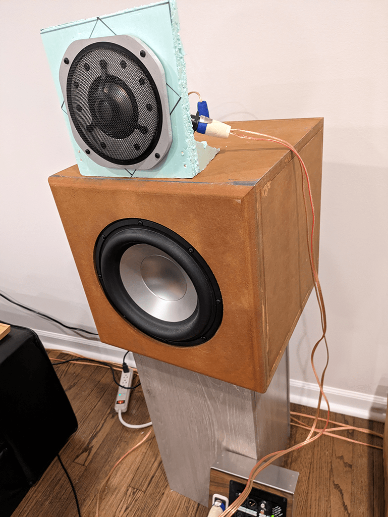

project: Emperor L26ROY (tweeter + Yamaha JA-0801 + Seas L26ROY)
This is a new thread started from a rando post here: https://www.diyaudio.com/community/threads/headshakes-far-field-3way.382393/post-7434715
I've made a 3" ETON + t25b box before and this will be a reworking of the same setup. I like the idea of being able to swap out the HF/MF boxes.
The Seas L26ROY is in a PartsExpress box. It is by chance that it fits without any adjustment.
I will measure the drivers next and make an ideal sim to reference along the way.
The JA-0801 is in a foam baffle for now. I used some Loctite power grab and some wood skewers to hold the stand together. Metal screws are holding the driver down.
The hypex FA123 can be seen at the bottom of the image.
The tweeter will be picked later.

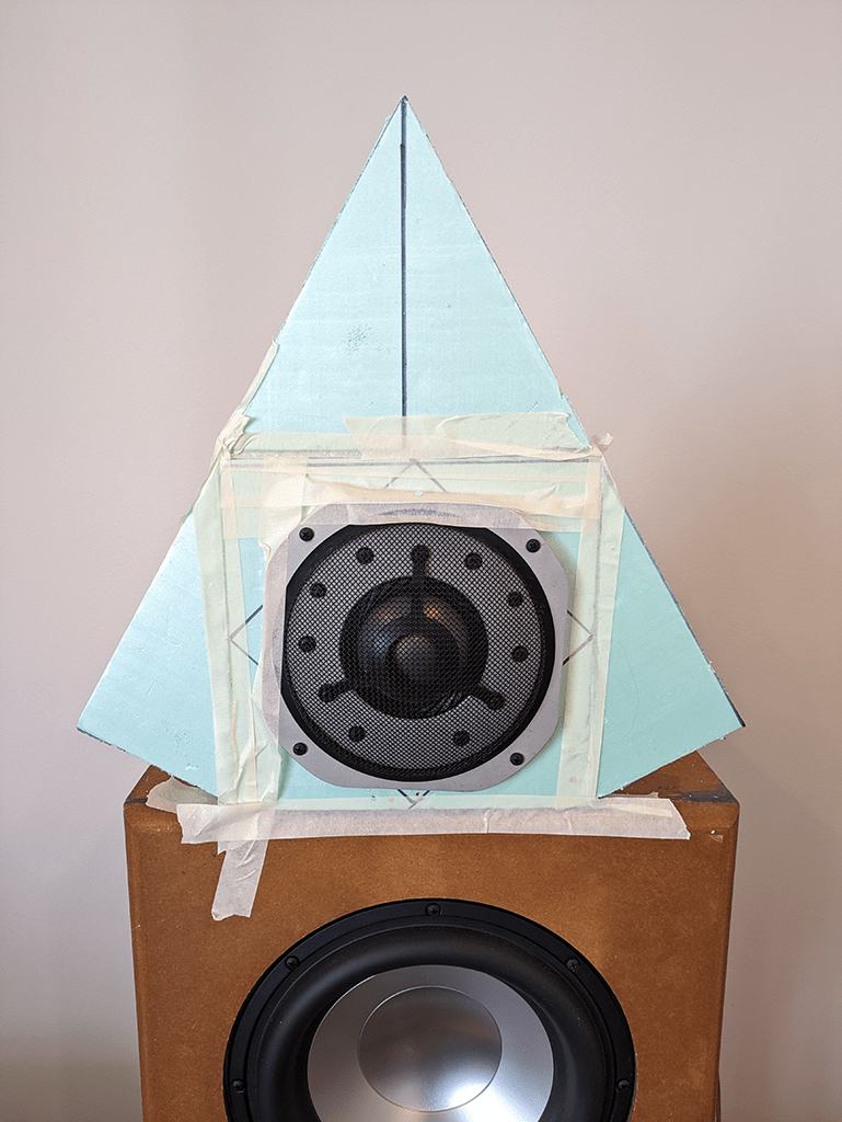

I was curious about the baffle size and messing with the decay. VCAD predicted some mess around 2k.
The tri baffle is just some shapes stuck onto the square baffle. The goal was to see if the GD and decay would change.
Square vs Triangular

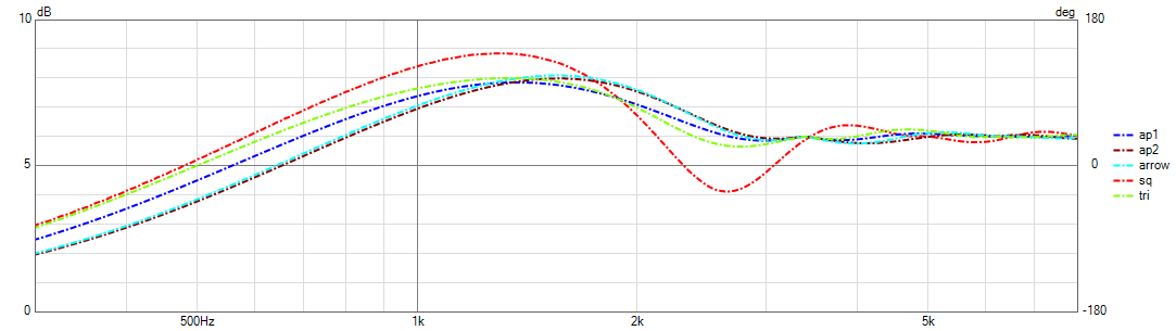

My very rough estimate of the sd and baffle sim. The tri baffle is the orange line:

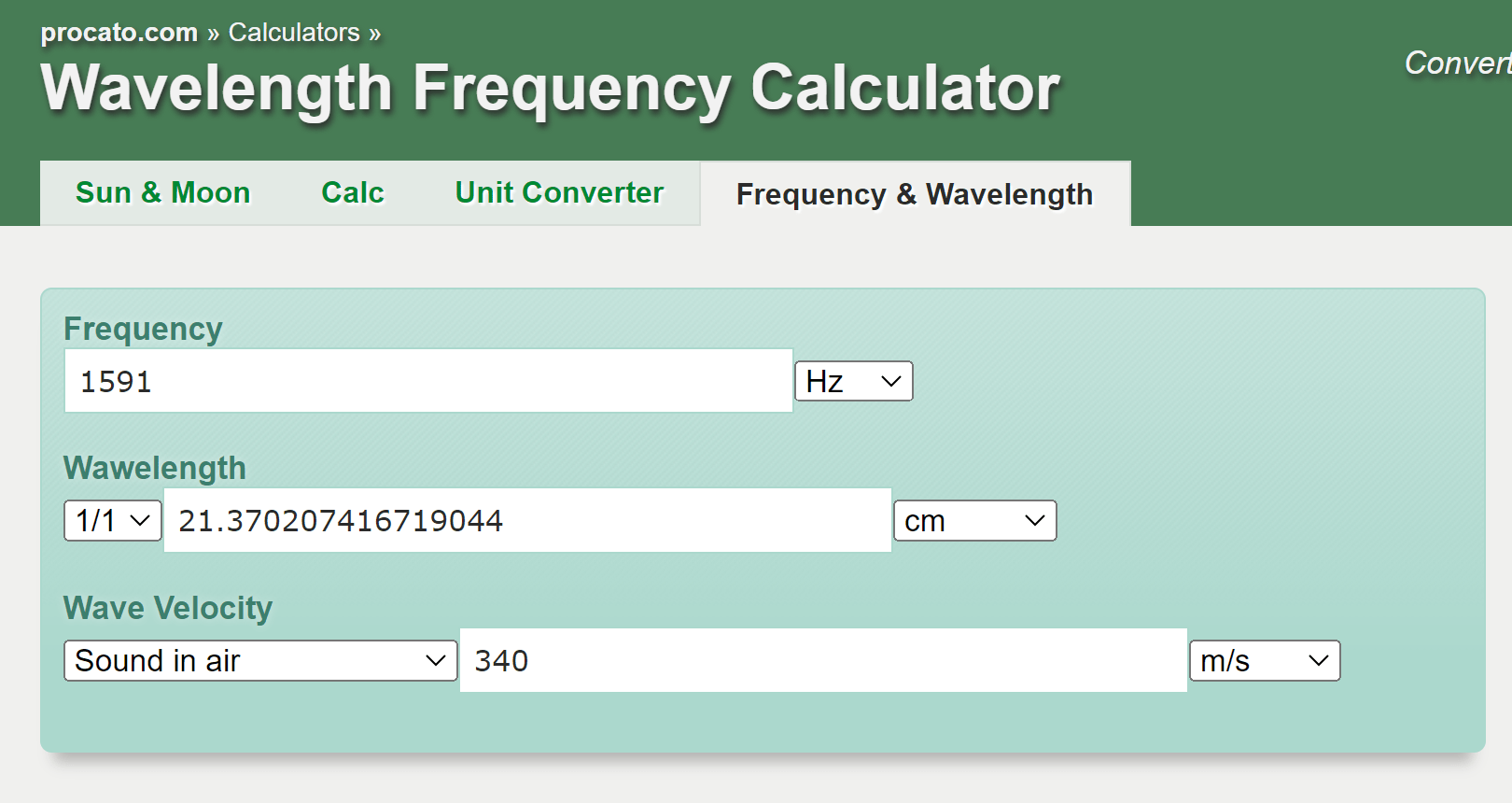

My aim is for a very random decay and smooth GD. If the baffle is mostly square 21cm shape then that shows up in the decay:
This is just a repeat of the square baffle with a curser to show the WL of the baffle.

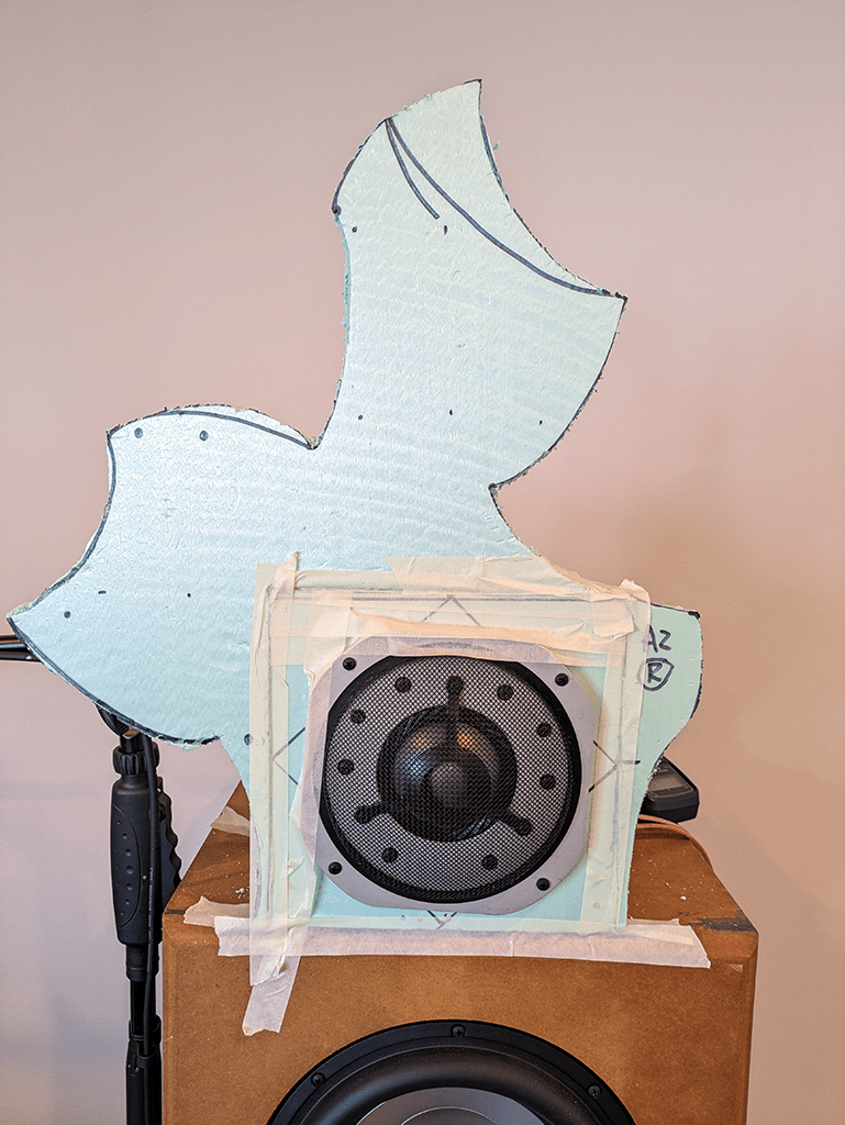

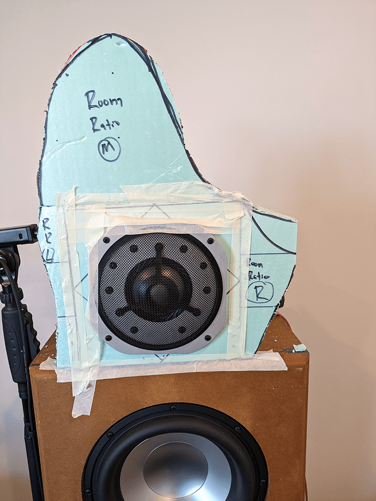

Did some cutting and will compare a square, triangular, room ratio, and chiral aperiodic shapes. It might just work out that the smallest baffle is best but this will be neat to see.

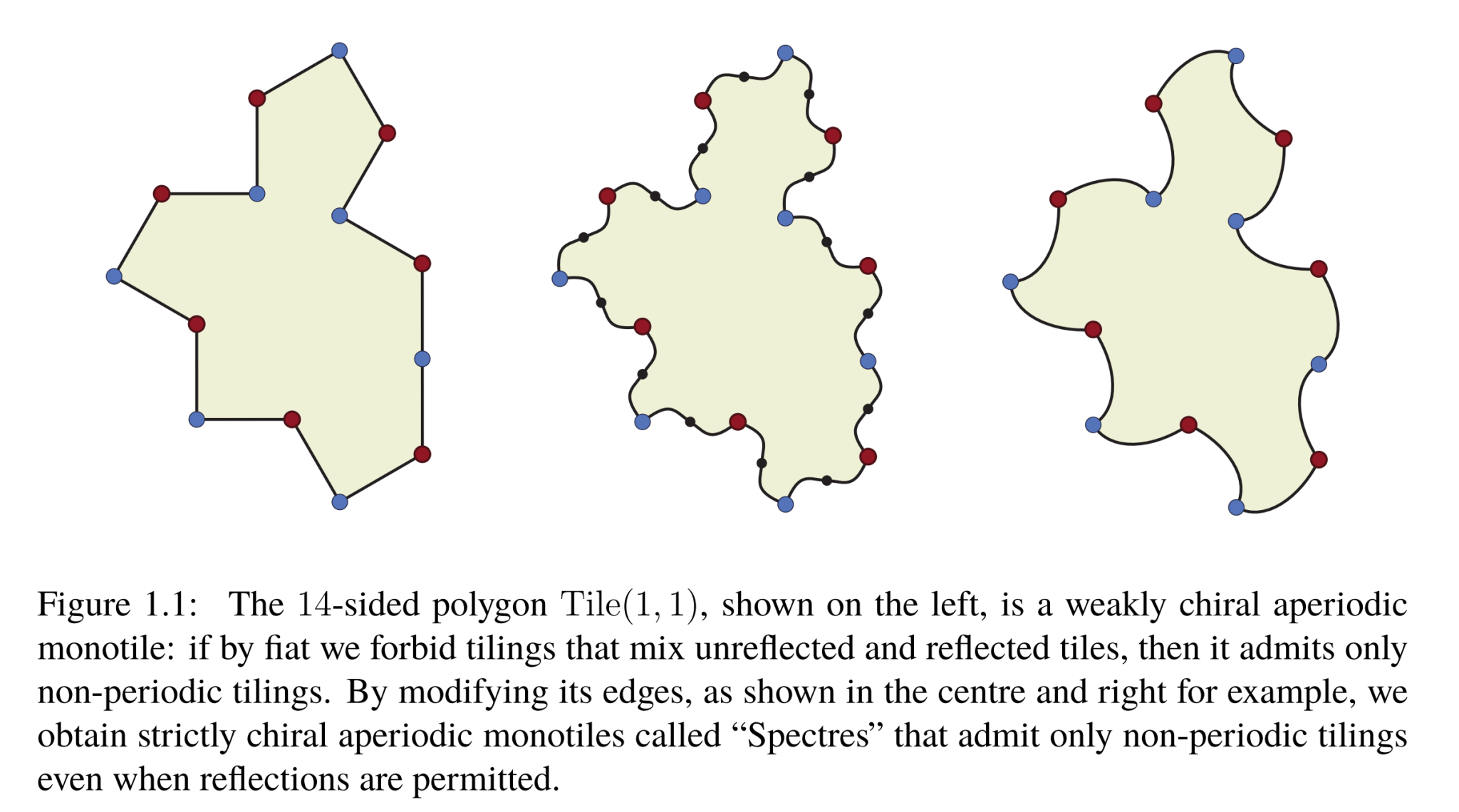

Paper on aperiodic:
https://arxiv.org/abs/2305.17743
Nothing is perfect so I thought I'd just cram 3 sides into the room ratio and chiral aperiodic shapes.
I did an ok job trying to freehand it with some gridlines.
Measurements are next up. The baffle is not mounted flush so that mess will be in all of the measurements.

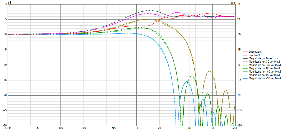

Baffle sim of the shapes.
Reactions: 1 user

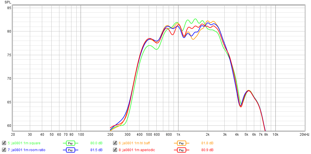

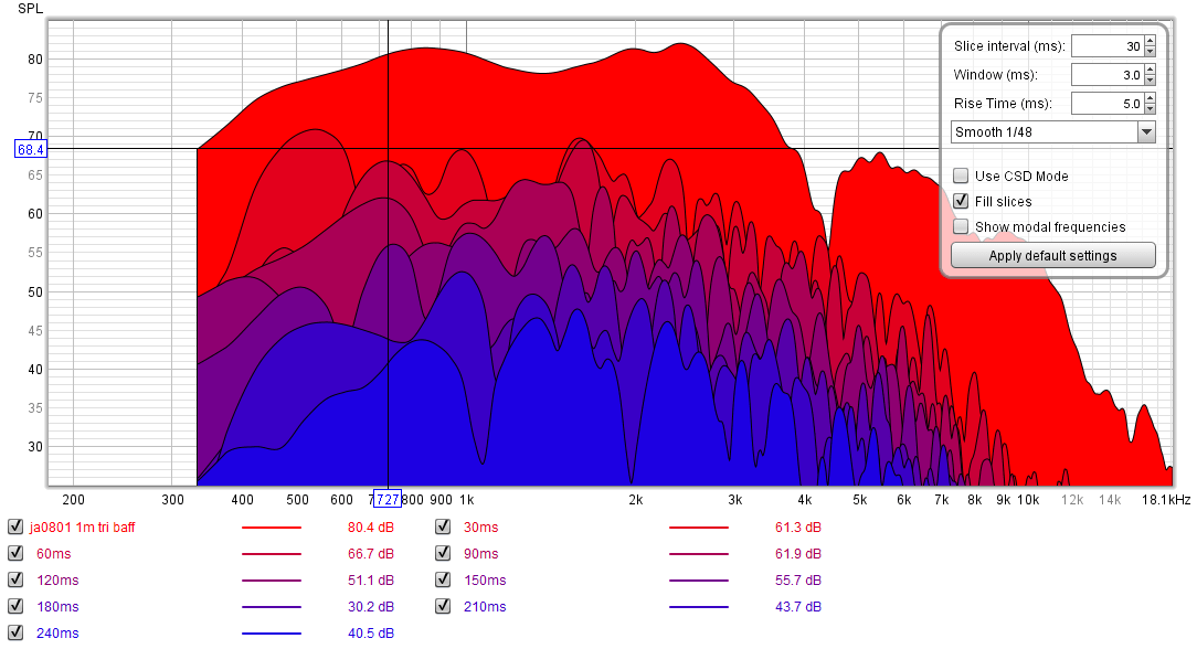

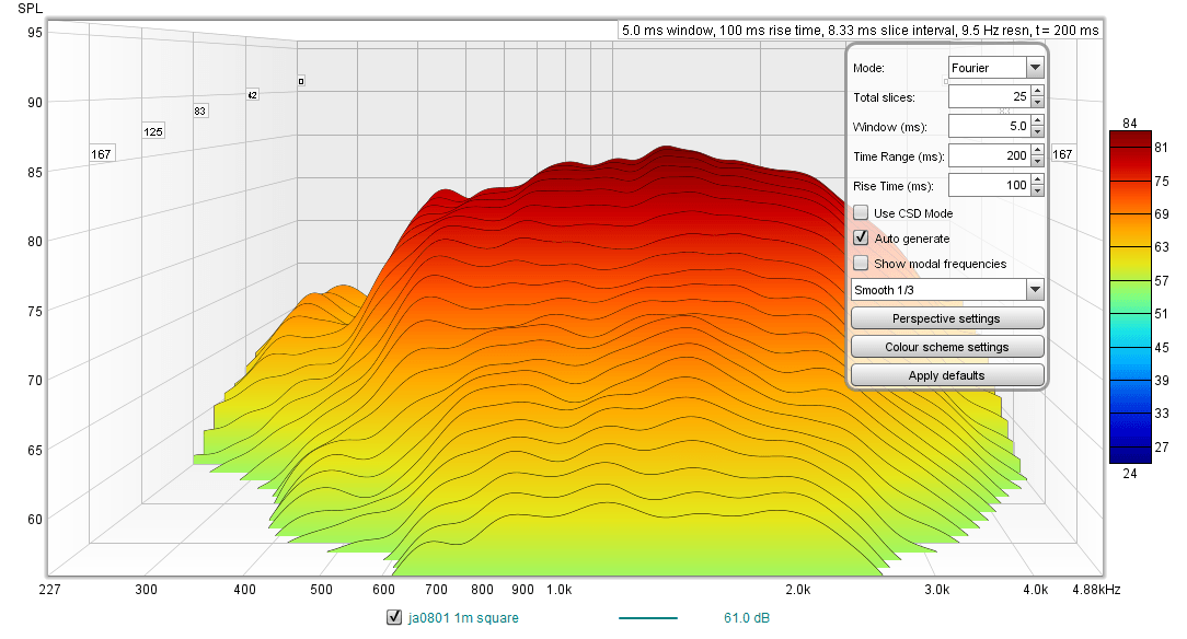

Did some measurements of the baffle shapes. It is a small square vs triangular vs room ratio vs aperiodic baffle shapes.
I used some tape on the ja-0801 and measured 1m with a laser distance meter. There were some differences in SPLs so the decay should be taken with a grain of salt.

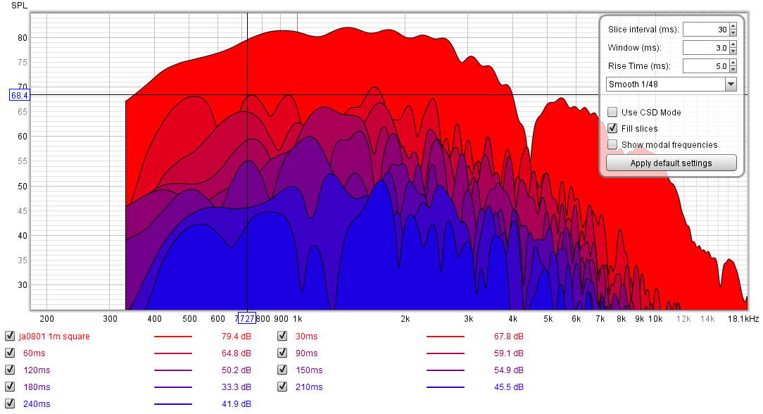

ja0801 1m_square_decay.png ja0801 1m_tri_decay.png ja0801 1m_roomRatio_decay.png ja0801 1m_aperiodic_decay.png
The decay is a fast gate to show what is right off the baffle. The goal is a random 30ms and 300ms.
I was hoping for a clear runaway winner. The tri baffle does a better 2khz-3khz. The aperiodic does a nice 600hz-1khz. The room ratio has a generally nice even decay across the board.

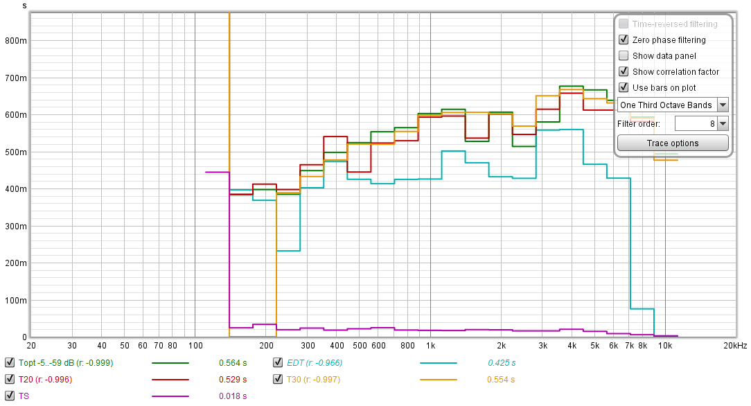

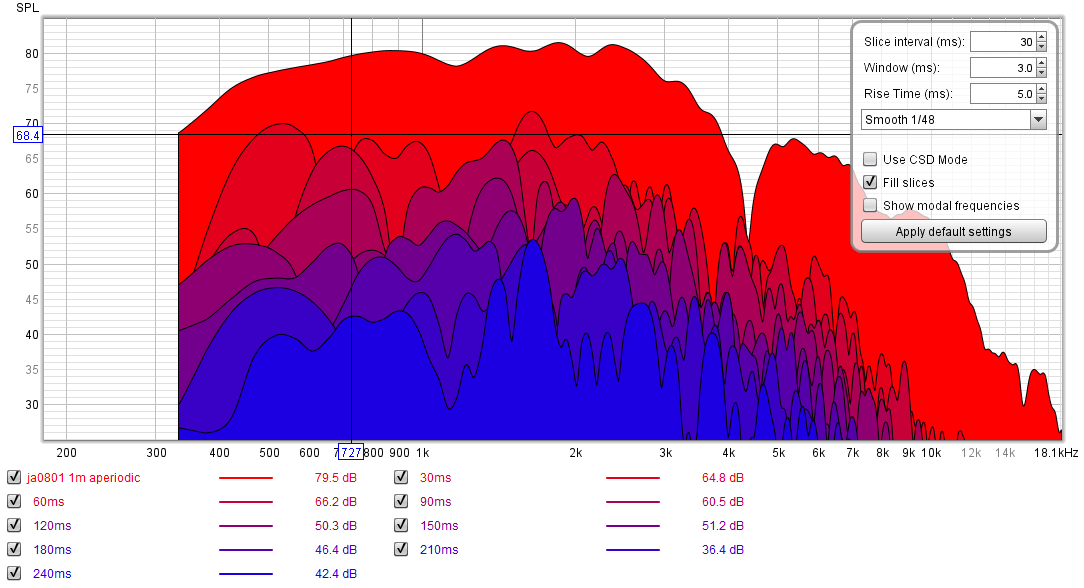

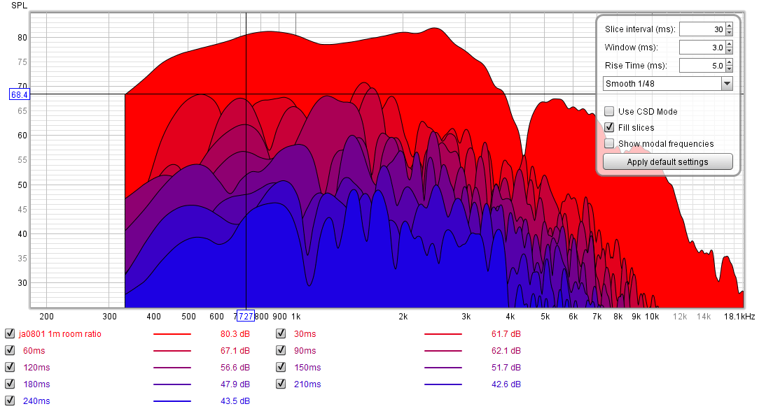

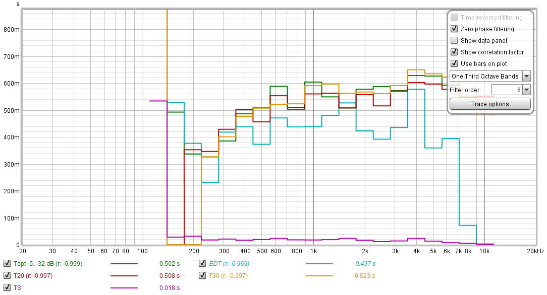

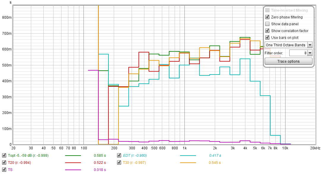

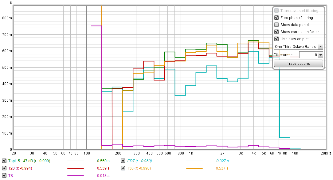

ja0801 1m_square_rt60.png ja0801 1m_tri_rt60.png ja0801 1m_roomRatio_rt60.png ja0801 1m_aperiodic_rt60.png
I think what I am looking for can be seen in the RT60: a nice random change between the EDT (-10db down) and what happens at the other decay times. I was surprised the aperiodic has a faster EDT that most at 700hz-1khz.
more info:https://www.roomeqwizard.com/help/help_en-GB/html/graph_rt60.html

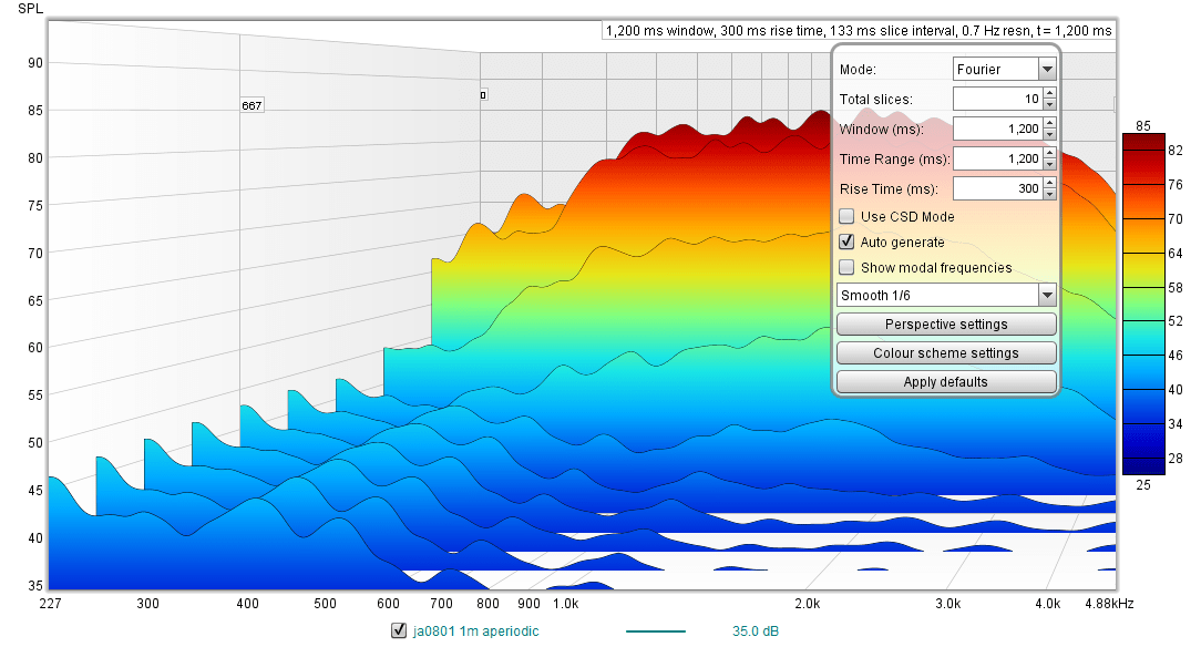

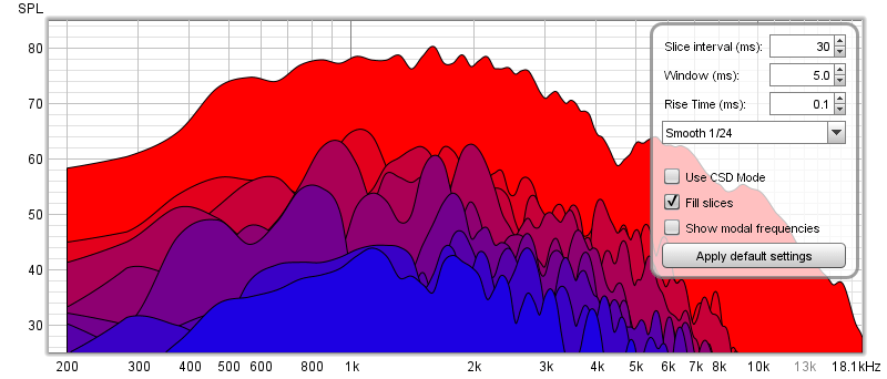

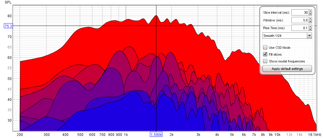

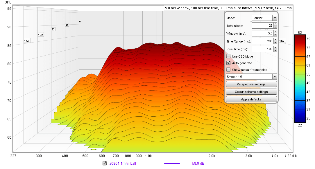

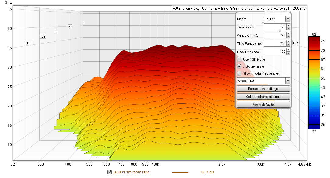

ja0801 1m_square_water.png ja0801 1m_tri_water.png ja0801 1m_roomRatio_water.png ja0801 1m_aperiodic_water.png
subjective listening observations: I have been listening to music with each baffle with just the ja-0801 playing. With the square baffle, it sounds small and easy to locate. The aperiodic is hard to place the location in the room and sound bigger. This could all be in my head but my decay measurements show the room ratio and aperiodic do have different decays than the square.
Reactions: 1 user

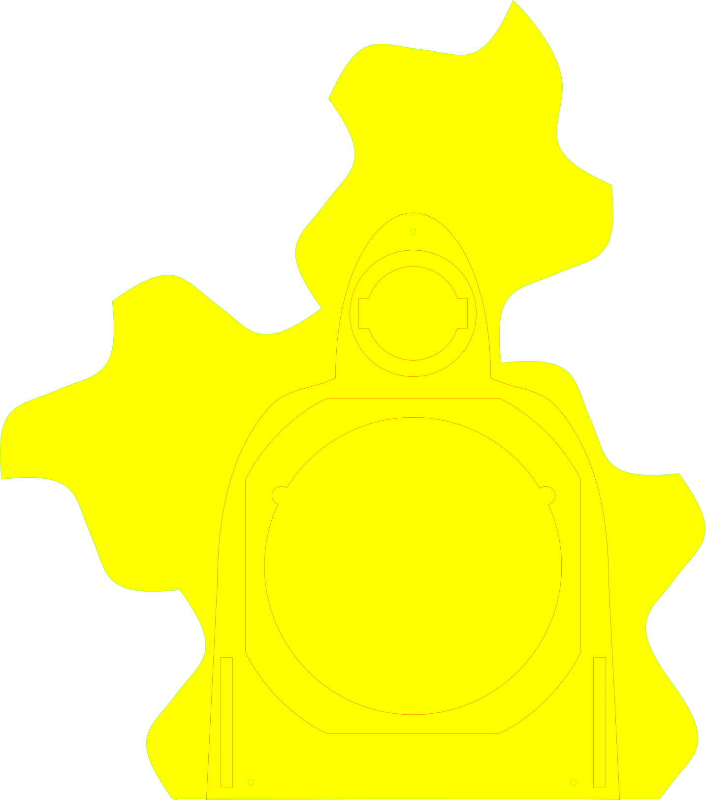

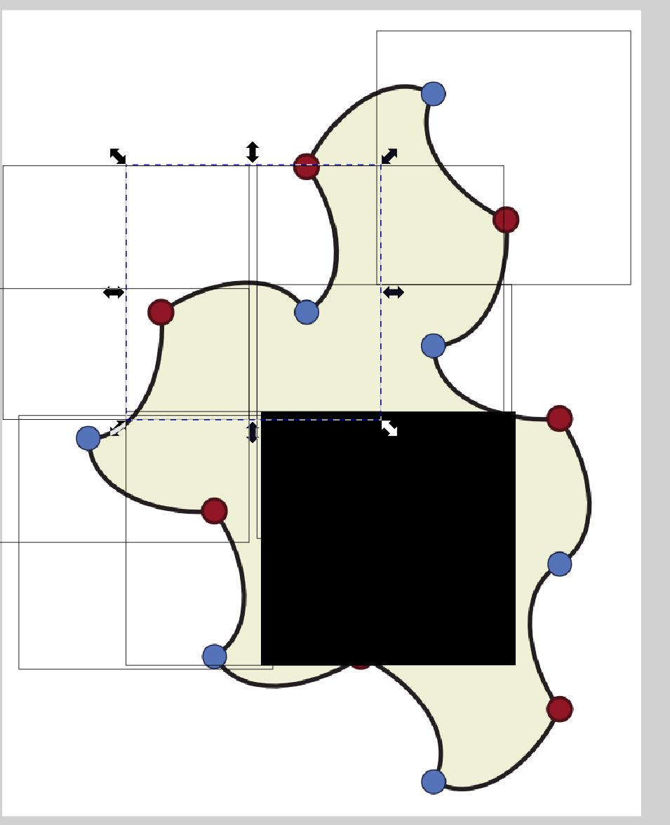

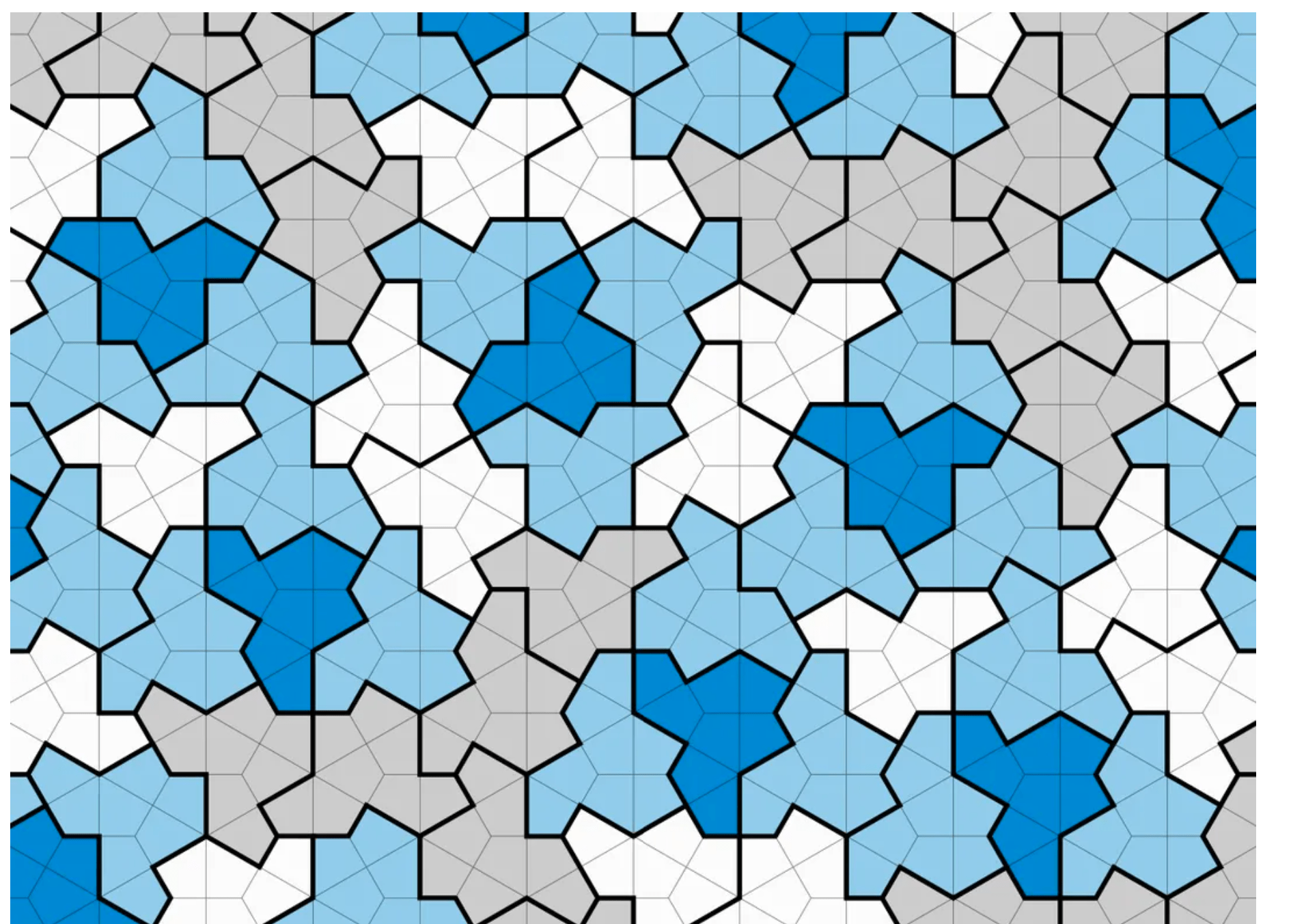

There is a more complex "Spectre" tile that I am interested in trying out. I made a quick mockup but will need to measure the ja-0801 with some cardboard before going forward with a part. The quick mockup was used to determine if I could even make a laser cut part this large- i can but it won't be cheap.
I just put the tweeter in a random spot. I would like to confirm in vcad the spacing.
more aperiodic tile links:
https://github.com/christianp/aperiodic-monotile
https://cs.uwaterloo.ca/~csk/spectre/

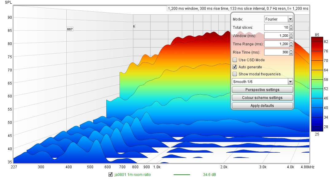

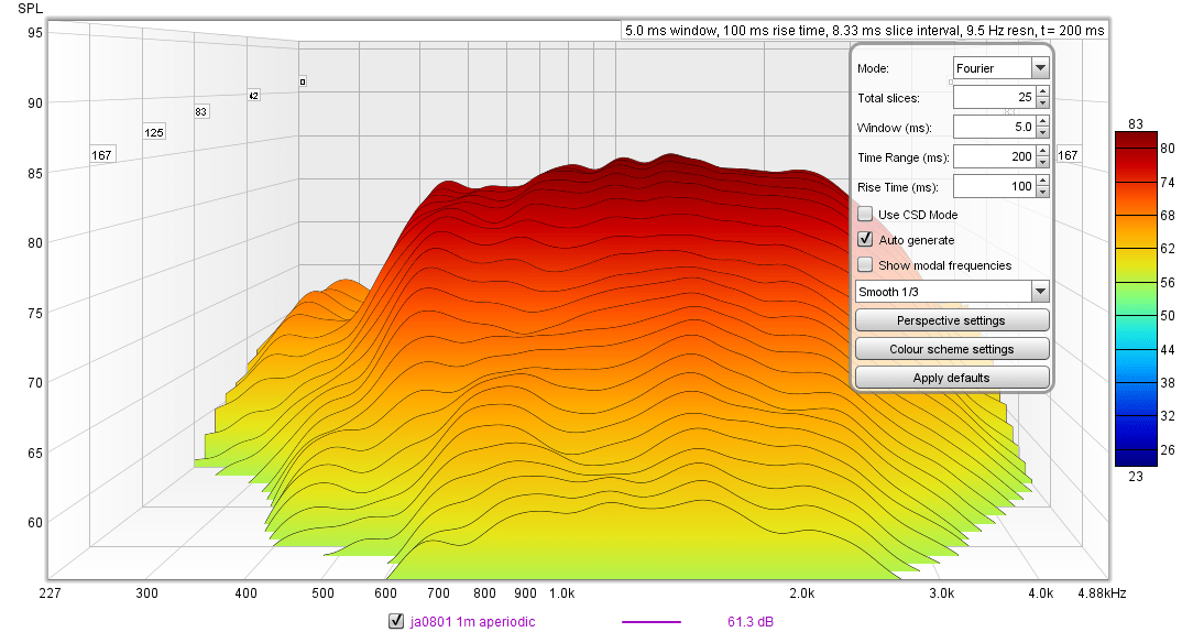

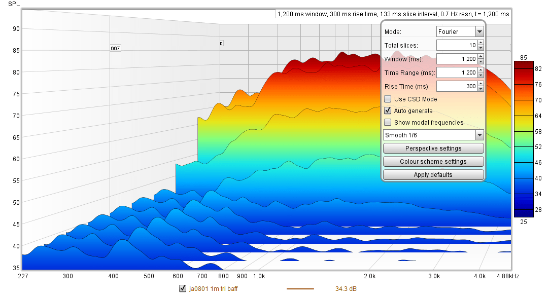

I took another look at the measurements on-axis at 1m:
ja0801_sqBaff_1m_wat2.png ja0801_triBaff_1m_wat2.png ja0801 1m_roomRatio_wat2.png ja0801 1m_aperiodic_wat2.png
It seems like a very long decay shows the differences. The decay times are much longer than I thought would matter. I might do another round of measuring just to confirm.

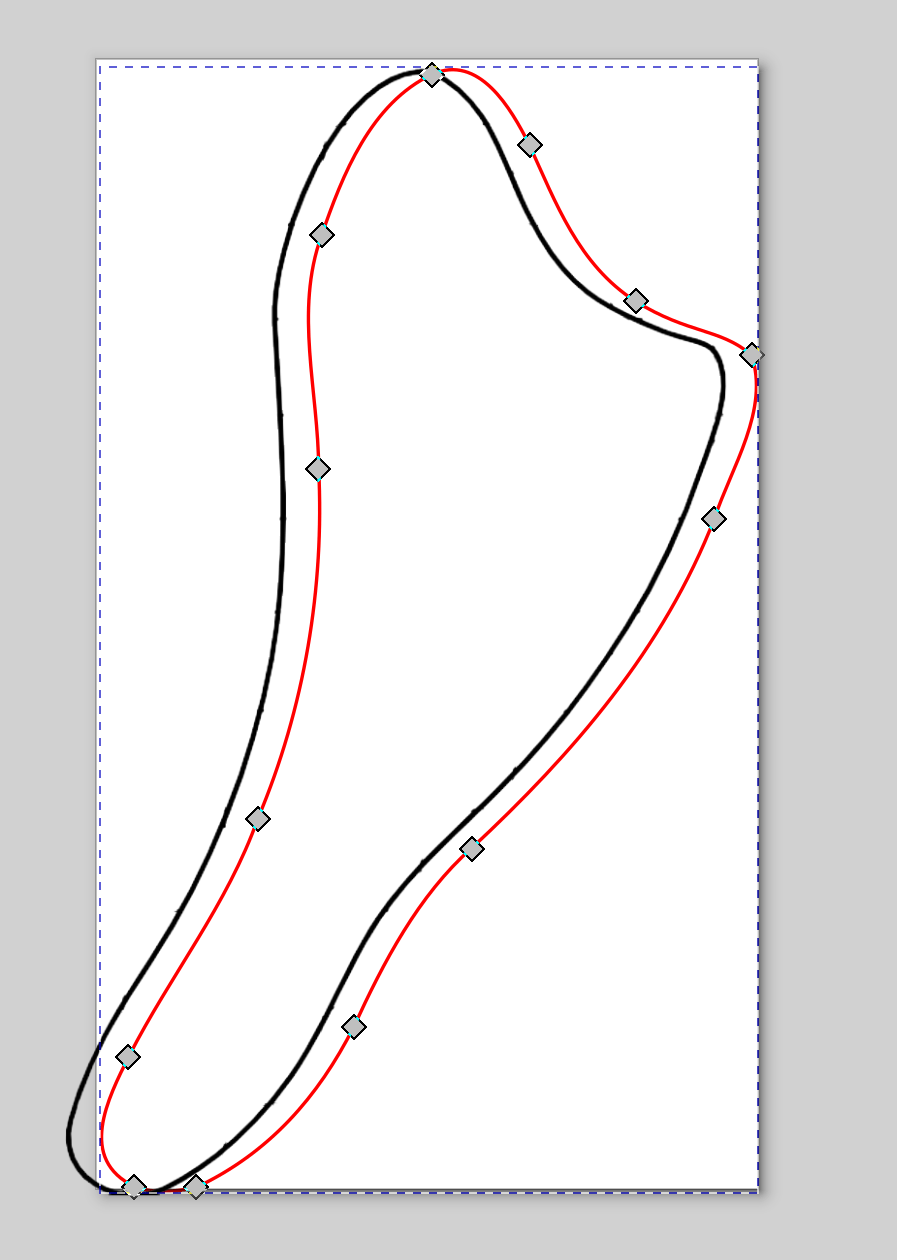

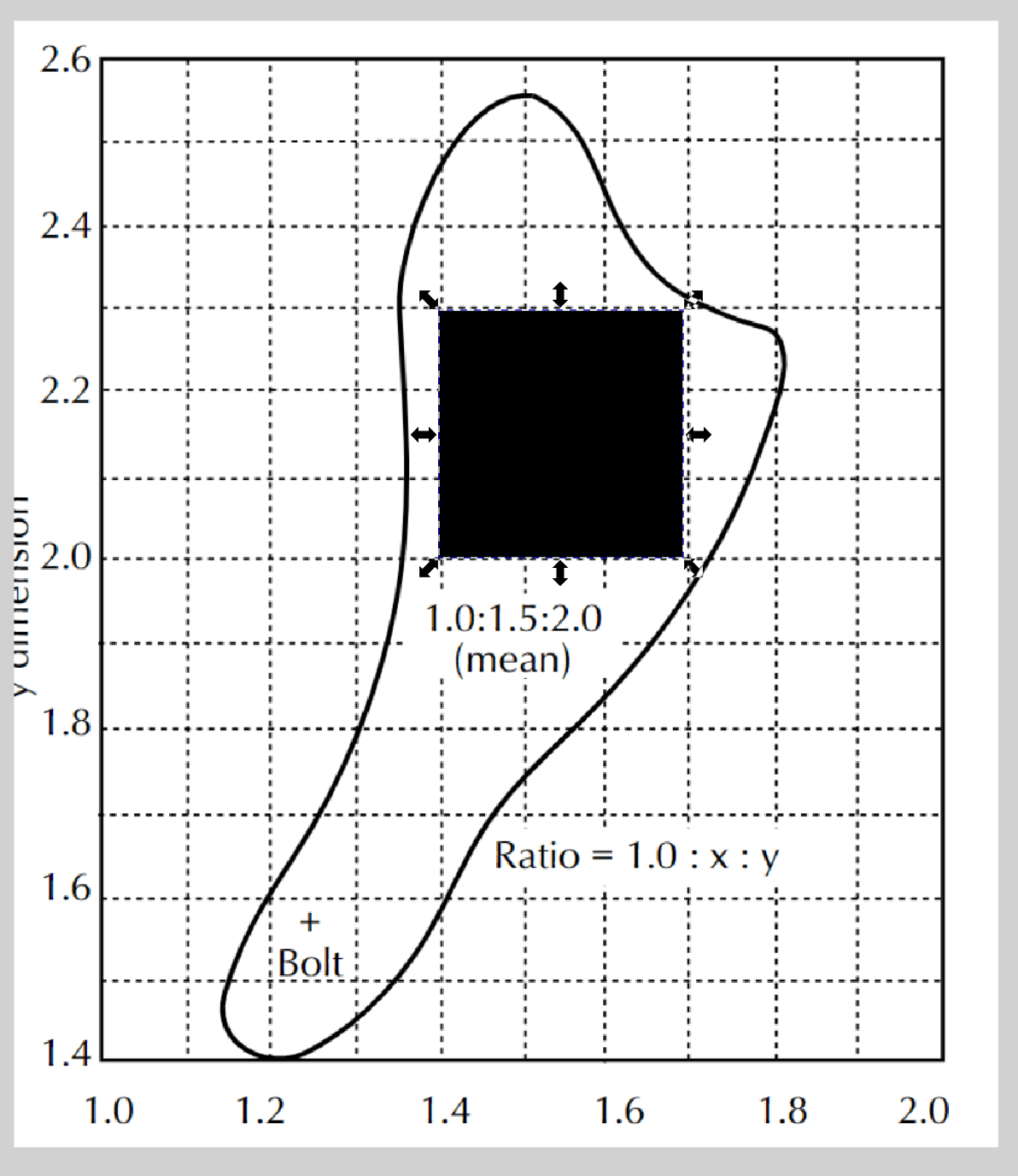

The room ratio curve is also something I am still tracing. The aperiodic shape was ready to go thanks to the github files. I am curious how both perform with a flush mounted driver.
  • outlines_spectre.svg
Reactions: 1 user

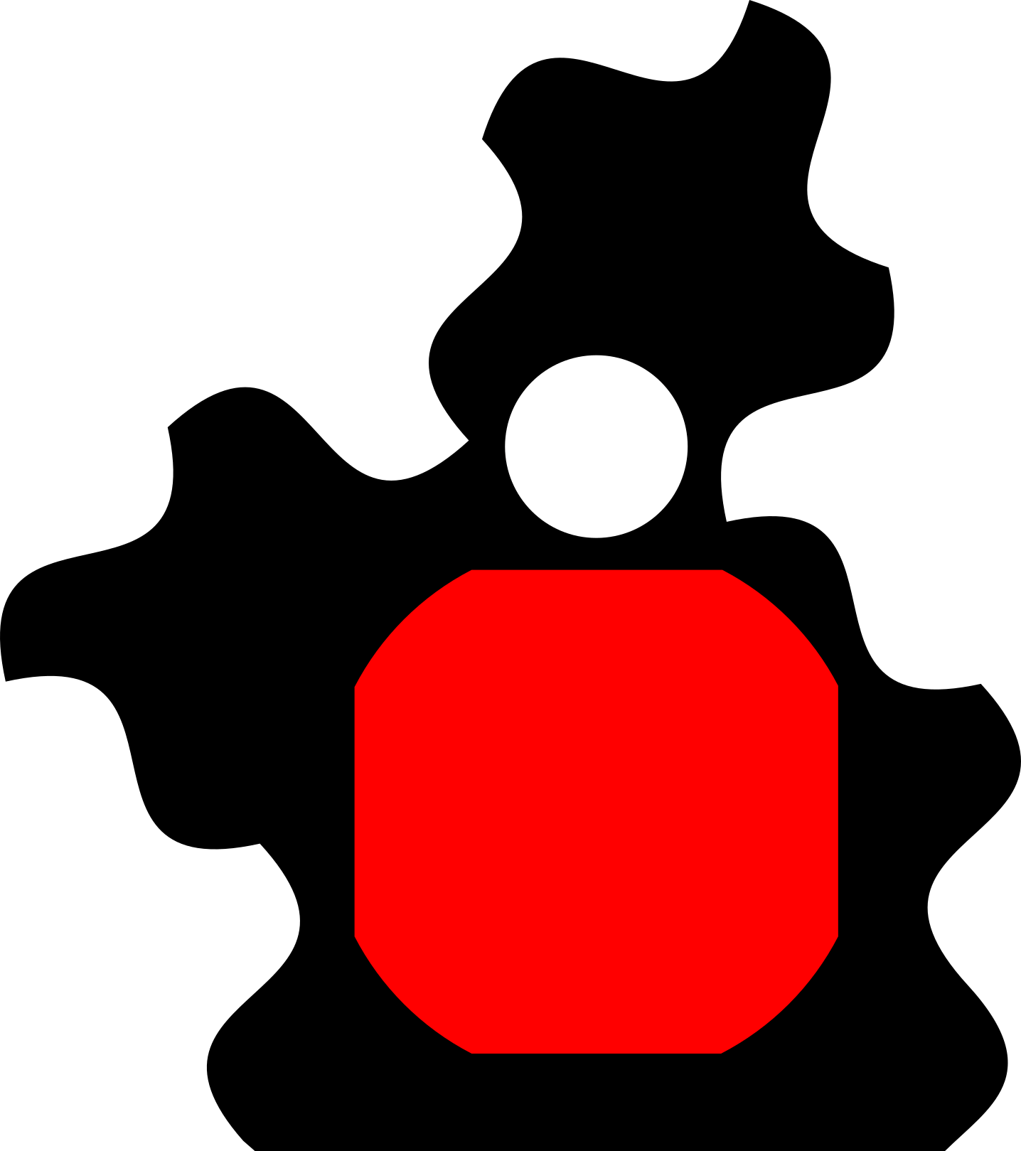

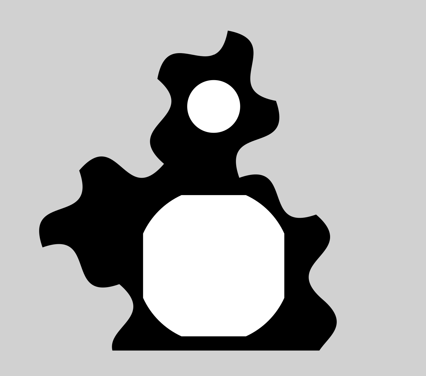

I used inkscape to convert the image to a vector. This worked better than me trying to trace the curves myself. It is pretty darn close. (black lines = raster and the red = vector)
The svg is attached.
more: https://inkscape.org/

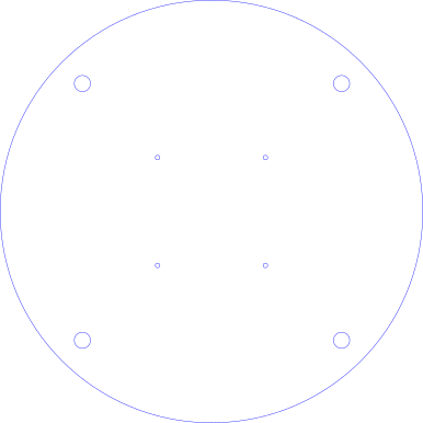

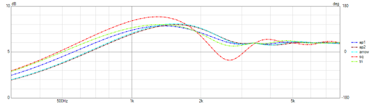

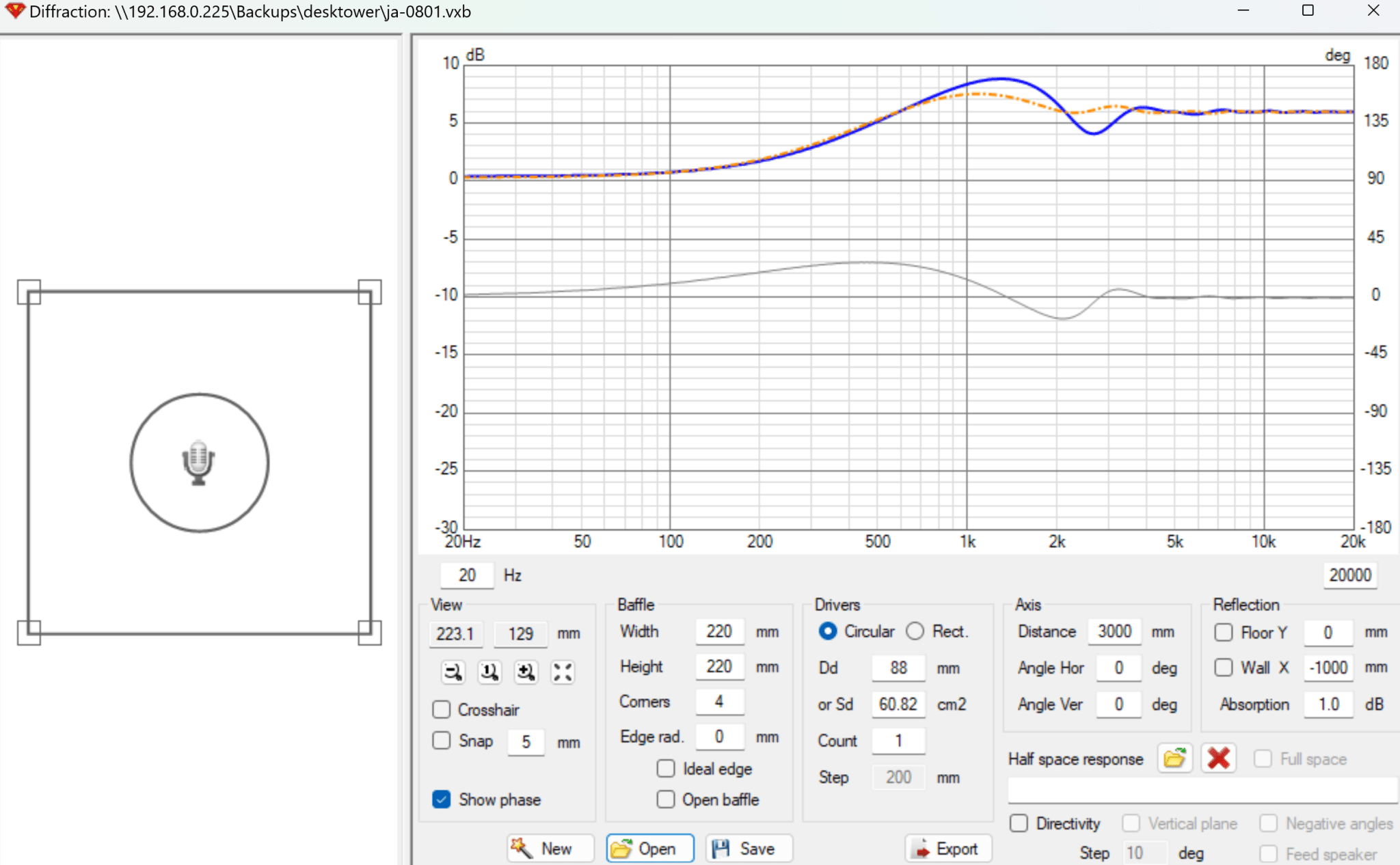

This past weeked I measured the dimension of the ja-0801 and have that in a newer baffle design. The spacing is for the XO. I still need to do more in vcad to compare the sims. My gut/experience still likes the idea of a tweeter on a stick so this is going against that.
A vcad diffraction sim: This is a comparison of the tweeter being at the top (orange line) vs bottom section (magenta) of the baffle. I was also interested in how the mid would sim at opposite horizontal positionsnso those are tossed in too.

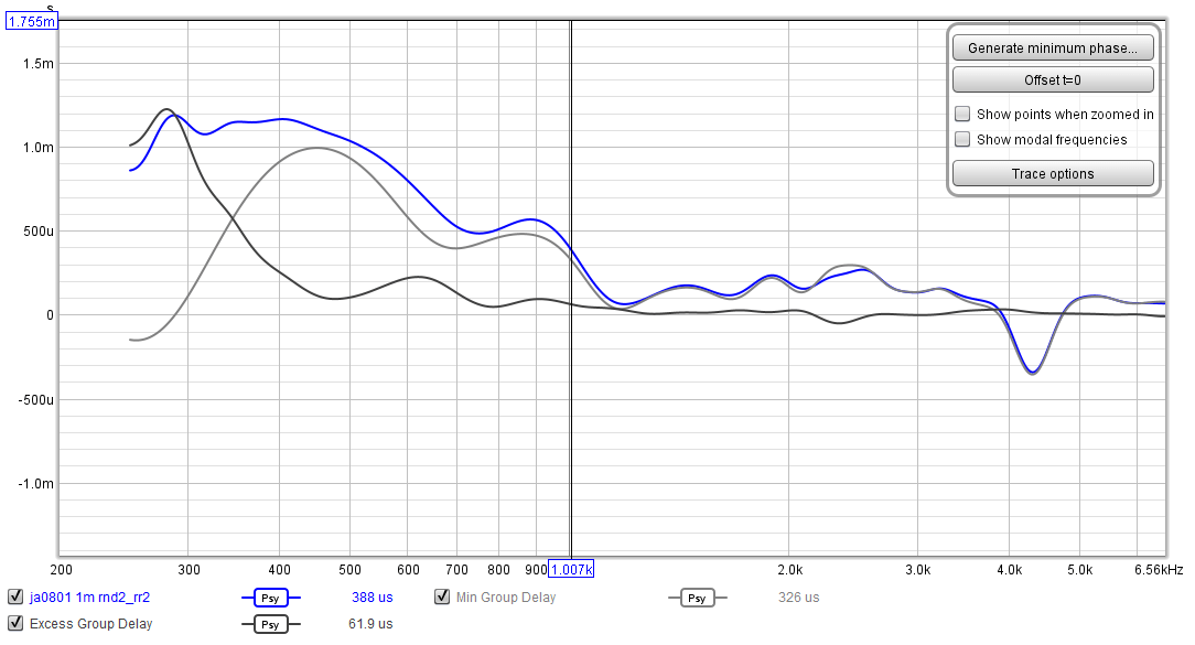

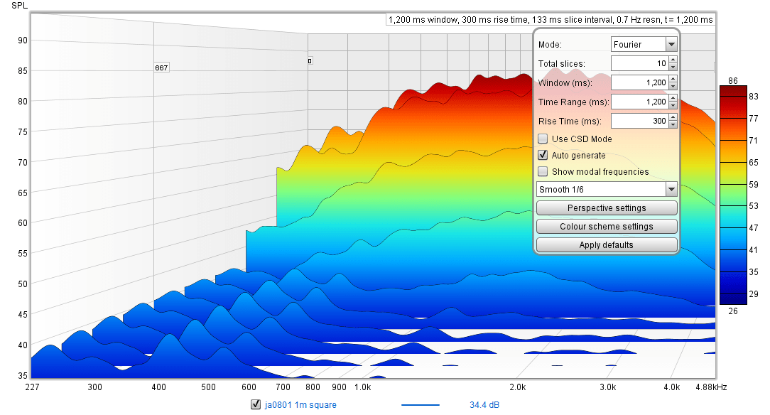

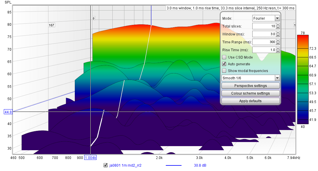

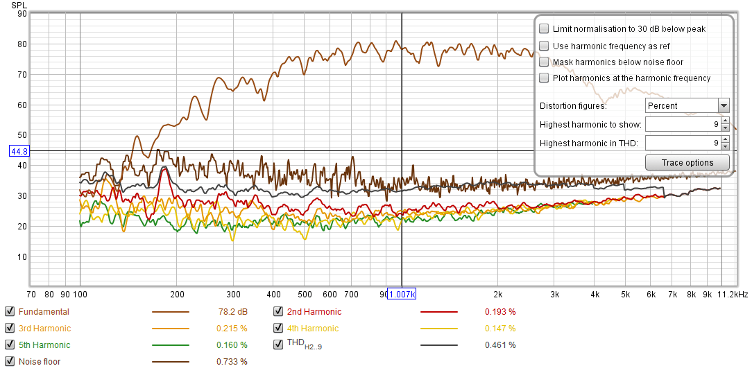

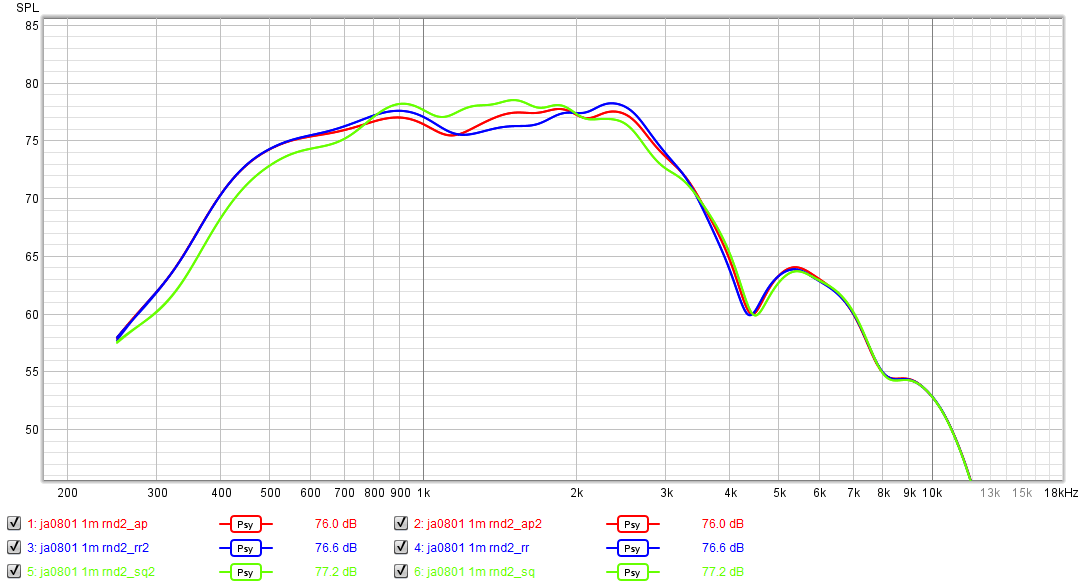

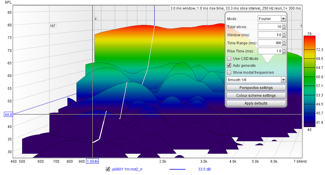

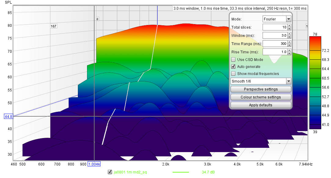

I did a second round of comparing baffles. I wanted to be sure I was not just looking at the noise floor and did not make a choice from one measurement. So this time I did a second measurement of each baffle to compare and and shaded out everything below -40db in the waterfall.
Only 3 baffles were compared, the Aperiodic (AP), Room ratio (RR), and square (SQ).
SPL's show the measurements are darn close and the different baffles have different spl's on-axis. I really think much of the difference comes from the size and the interaction with the seas woofer's surround - somewhere around 1.8khz it is bouncing back depending on the baffle.

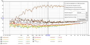

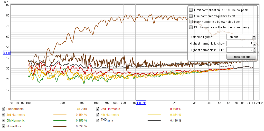

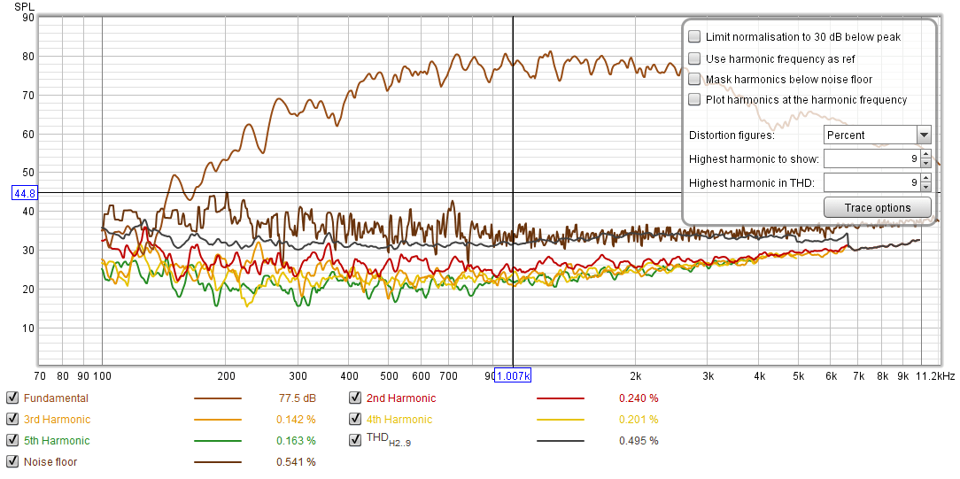

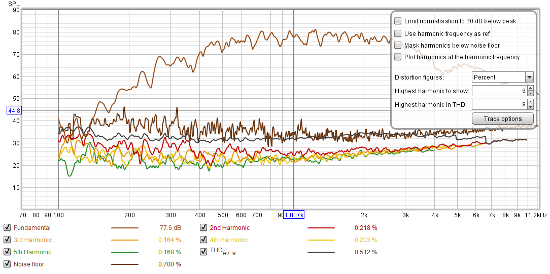

ja0801_baffleVS_rnd2_AP_dist.png ja0801_baffleVS_rnd2_AP2_dist.png ja0801_baffleVS_rnd2_RR_dist.png ja0801_baffleVS_rnd2_RR2_dist.png

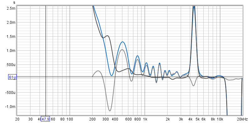

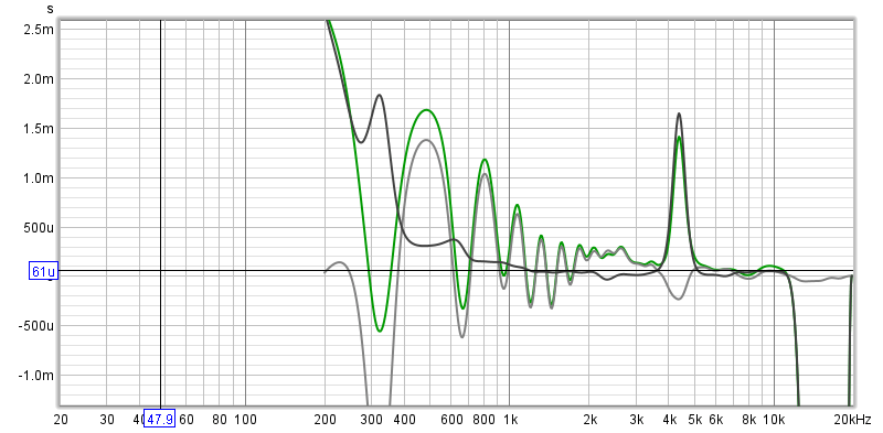

Aperiodic 1&2 vs room ration 1&2 distortion. The noise floor does change a bit between the measurements.

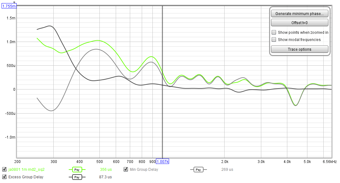

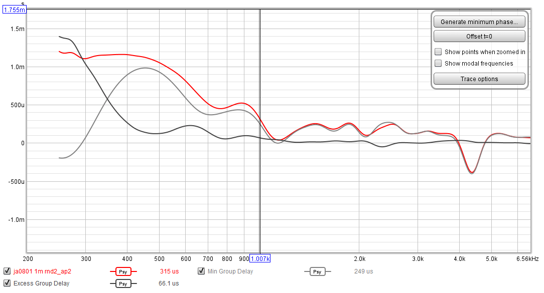

ja0801_baffleVS_rnd2_AP2_GD.png ja0801_baffleVS_rnd2_RR2_GD.png ja0801_baffleVS_rnd2_SQ2_GD.png

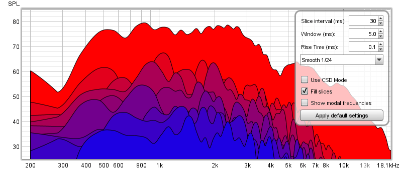

4ms gate GD of the aperiodic vs room ratio vs square

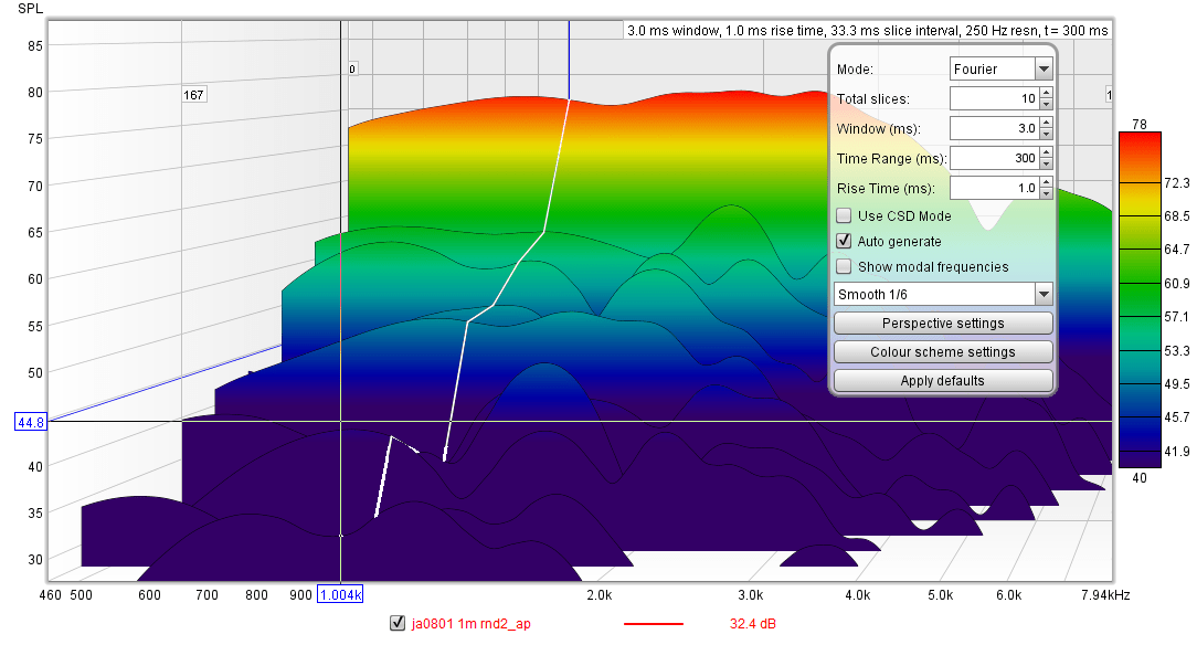

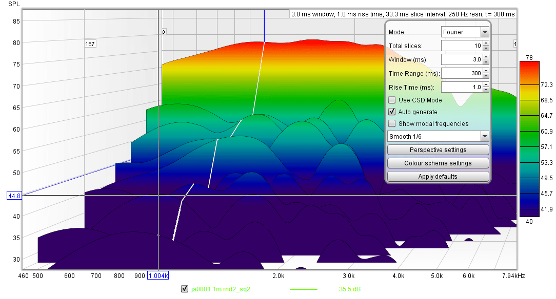

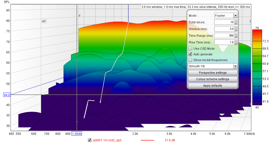

ja0801_baffleVS_rnd2_AP_wat.png ja0801_baffleVS_rnd2_AP2_wat.png ja0801_baffleVS_rnd2_RR_wat.png ja0801_baffleVS_rnd2_RR2_wat.png ja0801_baffleVS_rnd2_SQ_wat.png ja0801_baffleVS_rnd2_SQ2_wat.png
waterfall: Aperiodic 1&2 vs room ratio 1&2 vs square 1&2
The duplicate measurements are very close. It seems like the AP baffle does a nice job with longer frequencies and decays but this could just be because of the size- it is physically taller than the RR. I am now wondering what happens when the AP and RR are roughly the same size. I was hoping for clarity but don't think I have it yet.

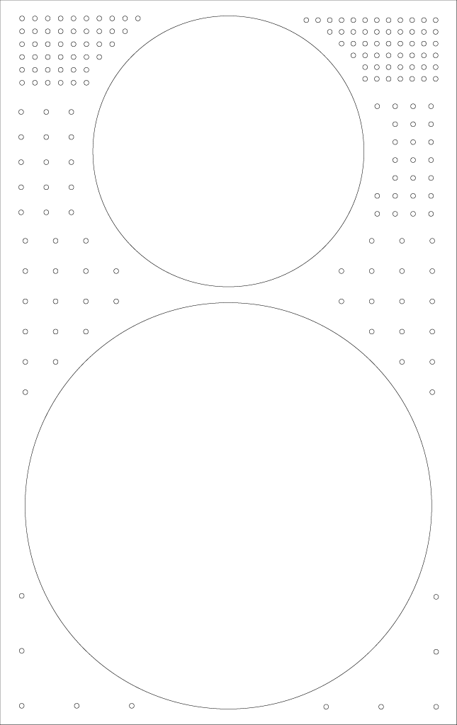

I'm using a laser cutting service and building up from layers. I use 0.5mm layers to pad it up so things are sorta flush. Some skewers will hold things together (green holes).
I use dsp so the tweeter does not have to be very close. The tricky part for me is where to place it on the monotile. My early sims showed where to place it on the tile.
To save on the cost, the monotile will be a very thin part (maybe metal). The ja0801 cutout needs a little more work since the lead placement is not quite right. The design is made to act like a facade with a stand in back.
I would like to fuse my perforated baffle project with this one but think the monotile does most of the work for a nice room response. (i still need to test this a bit further).
I'm trying to make 4 different projects at once with one order so it will be a little more time before it shows up.

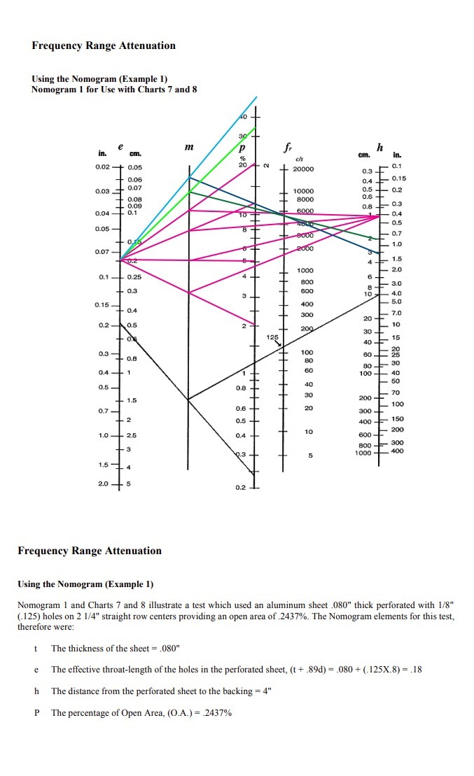

This is what is used to calc. a perf. metal plate:
This is from my other thread and I used this on the baffle. I was able to change the decay of a baffle with just a 1cm chamber. There are some modern mids that use something like this behind. the SBA mid and the tang band seem too.
I used the above to help make a stainless steel plate for this baffle. The melamine and chambers are in this pic.

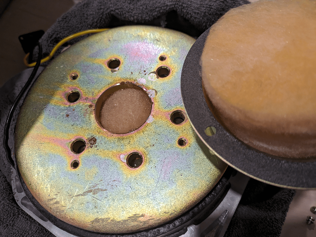

I took a quick look at the back plate.
It could just be because it is so old, but it looks like the fiberglass is less dense right at the bottom of the cup.
The fastest thing would be just to make a plate that sits near the bottom of the cup. I might try a FS plate and a 3khz plate just to see what happens.

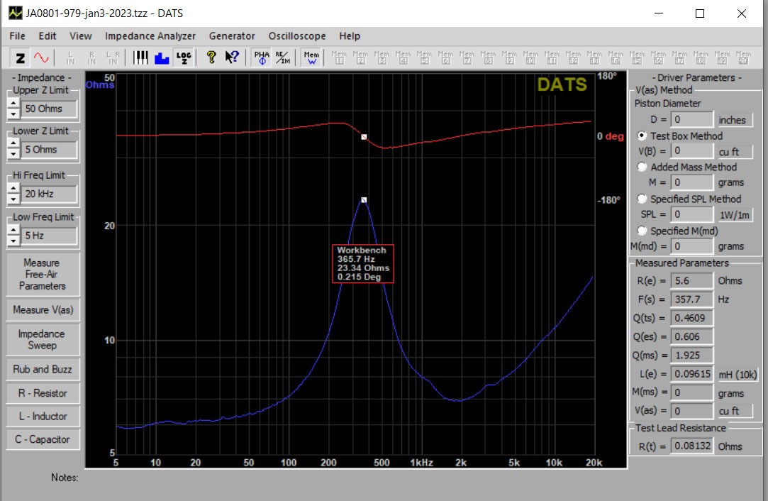

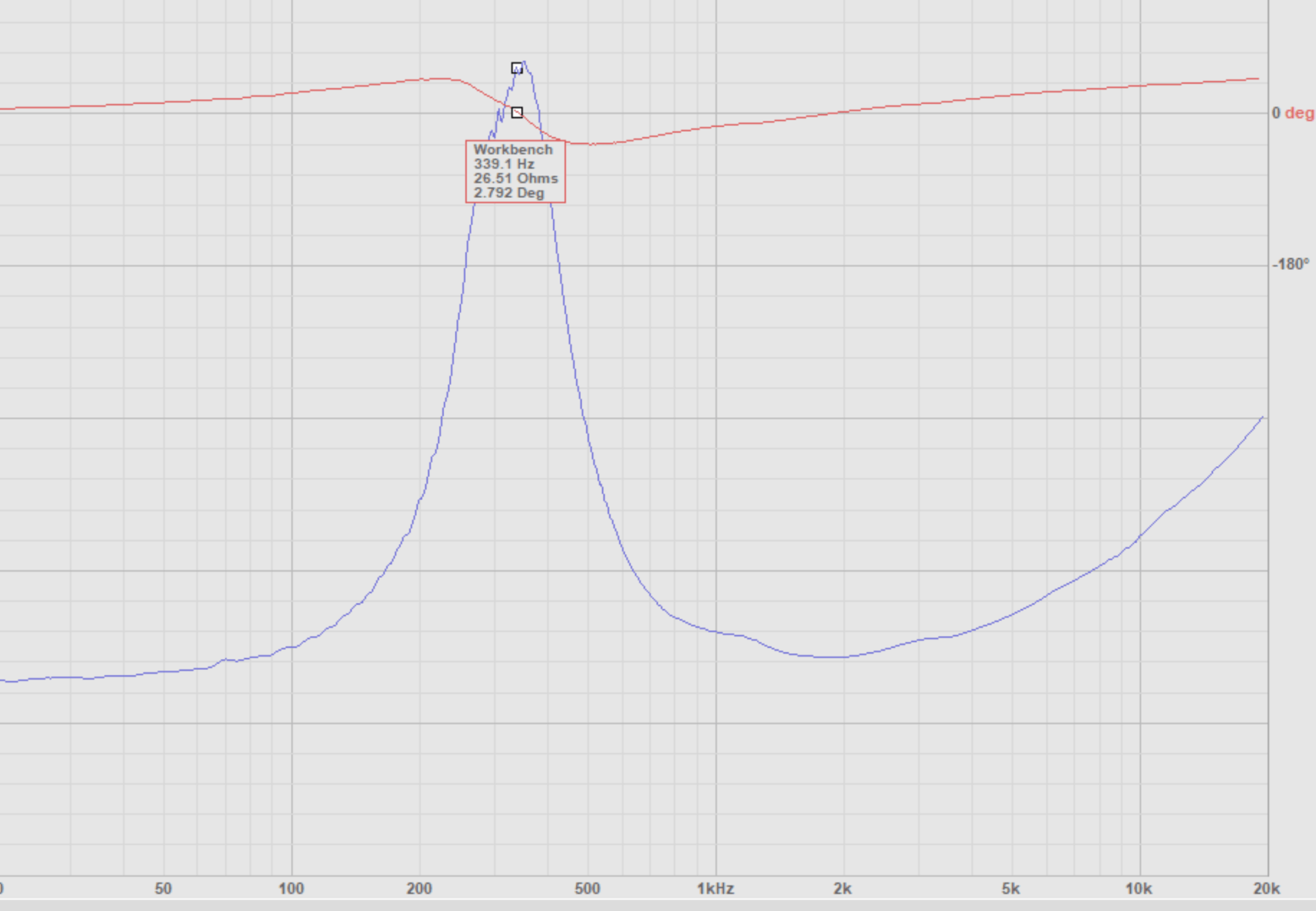

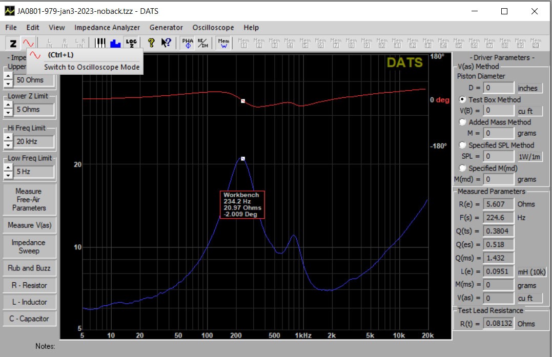

Found original Dayton DATS files but they seemed corrupted, so ran a fresh set. In stock form, 355 Hz, 23.5 ohms. Slightly different from yours, @HeadShake
1) stock
2) with back open
3) 12" traffic cone against open back
4) traffic cone with poly loosely filled
5) traffic cone with similar amount of long hair wool
Quick observations:
1. The stock 365 Hz Fs is pretty low, but impedance is higher than I'd expect. Perhaps it's because all current tweeters I've measured have ferrofluid.
2. Open back Fs is lowest at 235 Hz. This would seem the lowest Fs we can hope for when the back is closed.
3. With the 12" traffic cone over the open back, Fs rises, as expected, but only to 265Hz, which is less than I expected. Multiple aux peaks above & below look bad.
4. The poly fill helps tame the multiple peaks, brings Fs down to 250 Hz, but peak amplitude is only down a dB.
5. Long teased wool has similar effect to poly, but I did not weigh either, so it might not have been exactly the same amount.
The "seal" between the backside of the driver & the cone was far from perfect -- just placed with a bit of pressure.
Admittedly, a 12" cone on the back of a driver is impractical. I would probably reduce this down to maybe 8" if I decided to use an expanded cavity back.

The nomogram image shows the relationship between a throat (plate thickness + hole size), depth of a chamber, and the percent of the open area. The goal is sorta trap a particular frequency by defining the open area of the plate. Energy is lost as heat in the throat. I used this site to find the spacing: https://www.perforated-sheet.com/calculation/how-to-calculate-open-area.html
To really zap 300-400hz the chamber will have to be much larger. Just to try it out I did make a mockup plate that uses the depth of the standard cup. This plate would sit on top and is for around 330hz. I don't expect it to do much since it is a mostly closed plate (only 0.26% open area) but who knows...
Your open back measurement makes me wonder if a 800hz plate would be just as good.
A plate 13mm from the bottom of the standard cup to target around 3000hz is also something I want to try out.
(edit: i really need to double check the placement vs the hole at the back of the driver)

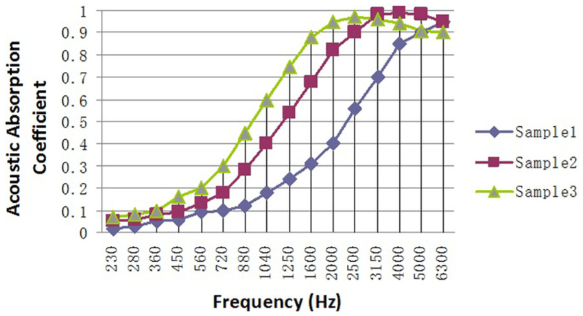

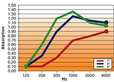

Keep in mind different materials will have their own curves... some don't absorb low frequencies at all:
Acoustic-absorption-curve-of-PET-PP-fiber-materials-with-different-areal-density.png mel_sw04.gif
PET fiber vs malamine.
