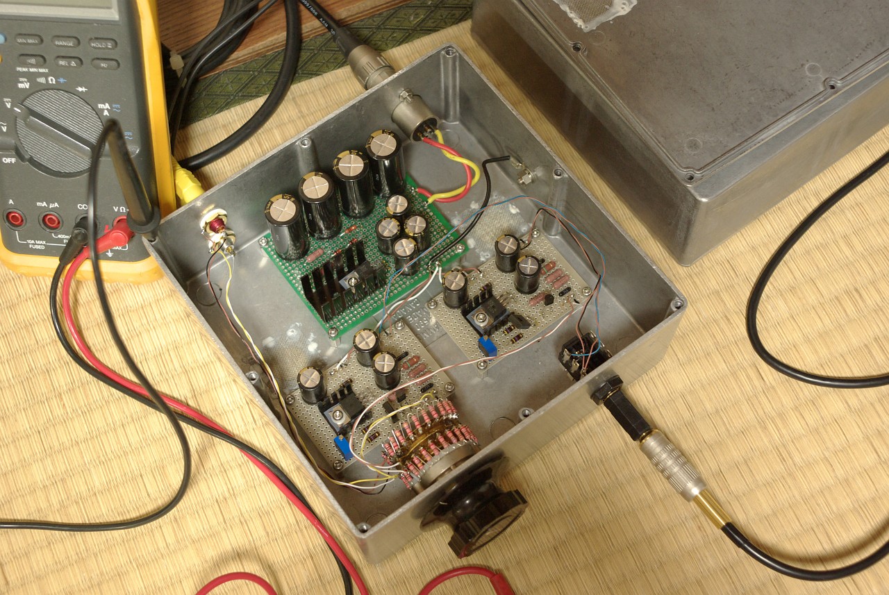

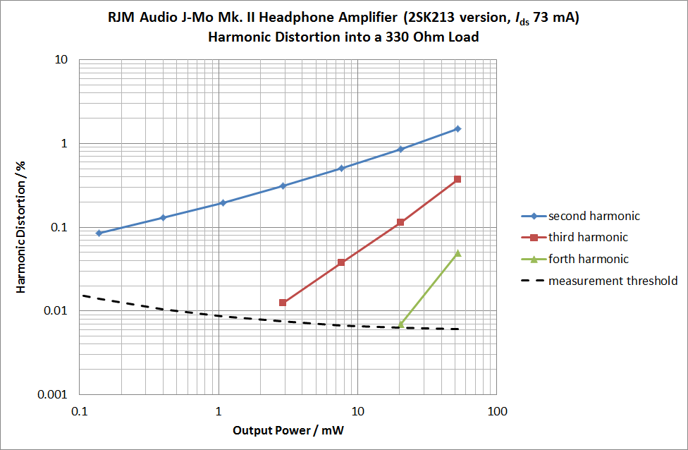

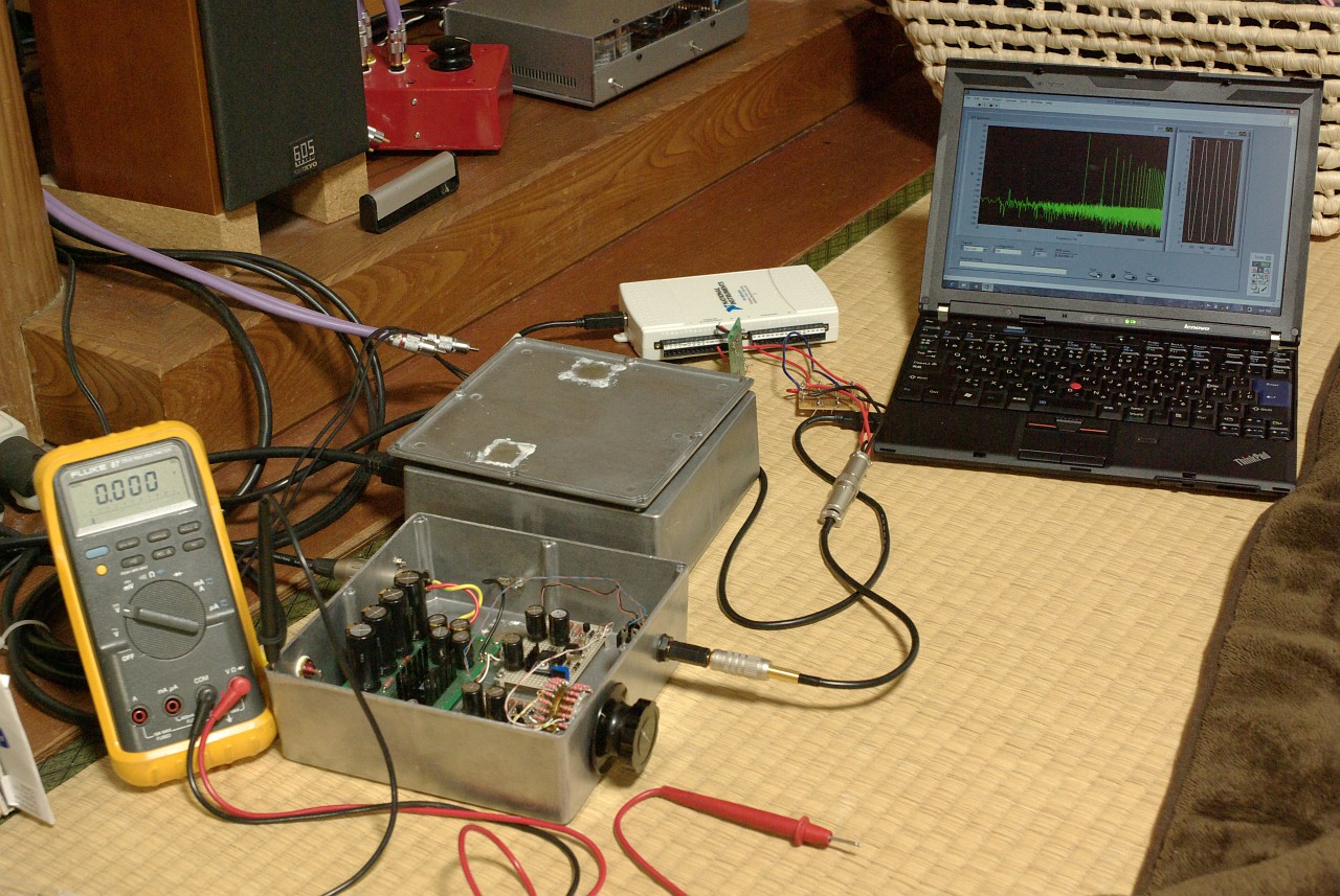

J-Mo Mk. II vs. Szekeres, distortion comparison
Posted 3rd May 2013 at 08:24 AM by rjm (RJM Audio Blog)
Updated 5th May 2013 at 11:52 PM by rjm
Two headphone amplifiers sharing the same basic MOSFET source follower output stage.
When the source current and source resistance are optimized for the given headphone load and similar maximum output power (~50 mW at 1% THD), the distortion pattern vs. output power is remarkably similar.
One plot below is simulation, the other measurements. The J-Mo 2 simulation closely matched the actual measurements, it wasn't worth my while to generate a full simulated data set when I already had the measurements on hand. No reason to suspect that the Szekeres sim is inaccurate, either.
The take home message is the distortion characteristic of a MOSFET follower is what it is, and unavoidable. Take it or leave it, as it were. However - and this is key - if you don't optimize the stage for the headphone impedance, the distortion for a given output power will increase significantly.

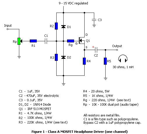

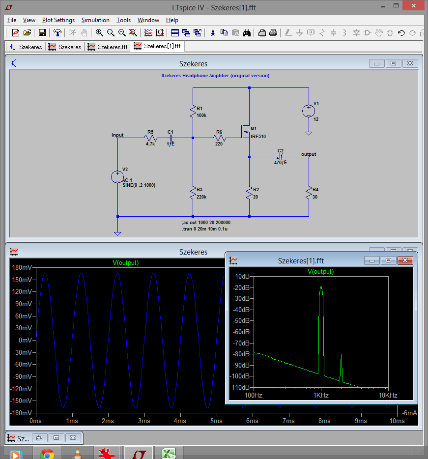

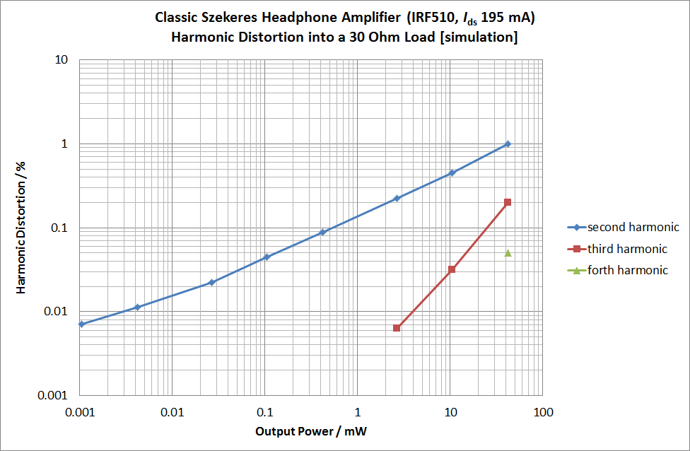

Szekeres Headphone Driver, distortion simulation
Posted 3rd May 2013 at 08:11 AM by rjm (RJM Audio Blog)
Updated 3rd May 2013 at 08:15 AM by rjm
I've always enjoyed the sound of the Greg Szekeres' Headphone Driver (buffer) and derivatives sharing the MOSFET source follower output stage.
I've often wondered however, whether it's distinctive sound is because it is unusually free from noise and artifacts, or because its unusually prone to heavy second harmonic distortion.
It's not hard to set this up in LTSpice, but I haven't seen it done before. So, for your education and enlightenment, I present the harmonic distortion vs. output power data for the original "classic" circuit as uploaded to Headwize all those years ago. The LTSpice asc file is also included I you want to play along. The harmonic data is generated by hand, reading the FFT peaks for 10 or so different input voltages.

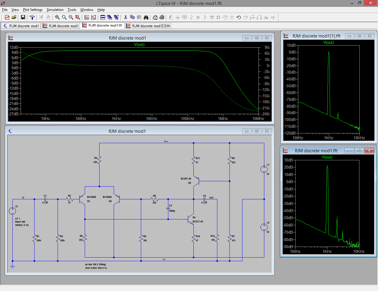

Discrete transistor line amplifier stage mod 1
Posted 19th April 2013 at 10:24 PM by rjm (RJM Audio Blog)
Updated 20th April 2013 at 05:04 AM by rjm
Changed the collector load on the voltage amplifier stage to a current source (Q3), as per the Marantz SR2285B circuit.
Also increased the resistance of the feedback connection, R6+R8, there seemed to be no obvious advantage in making it much smaller than the typical load (>10k). The compensation capacitor C2 is increased to match, to flatten the HF response.
The circuit can drive light loads to +20 dB. Of course that's not much of a challenge for this general class of circuit.
I'm a bit stumped as to what the next logical step is from here. Seems to me to depend on what you actually want the circuit to do.

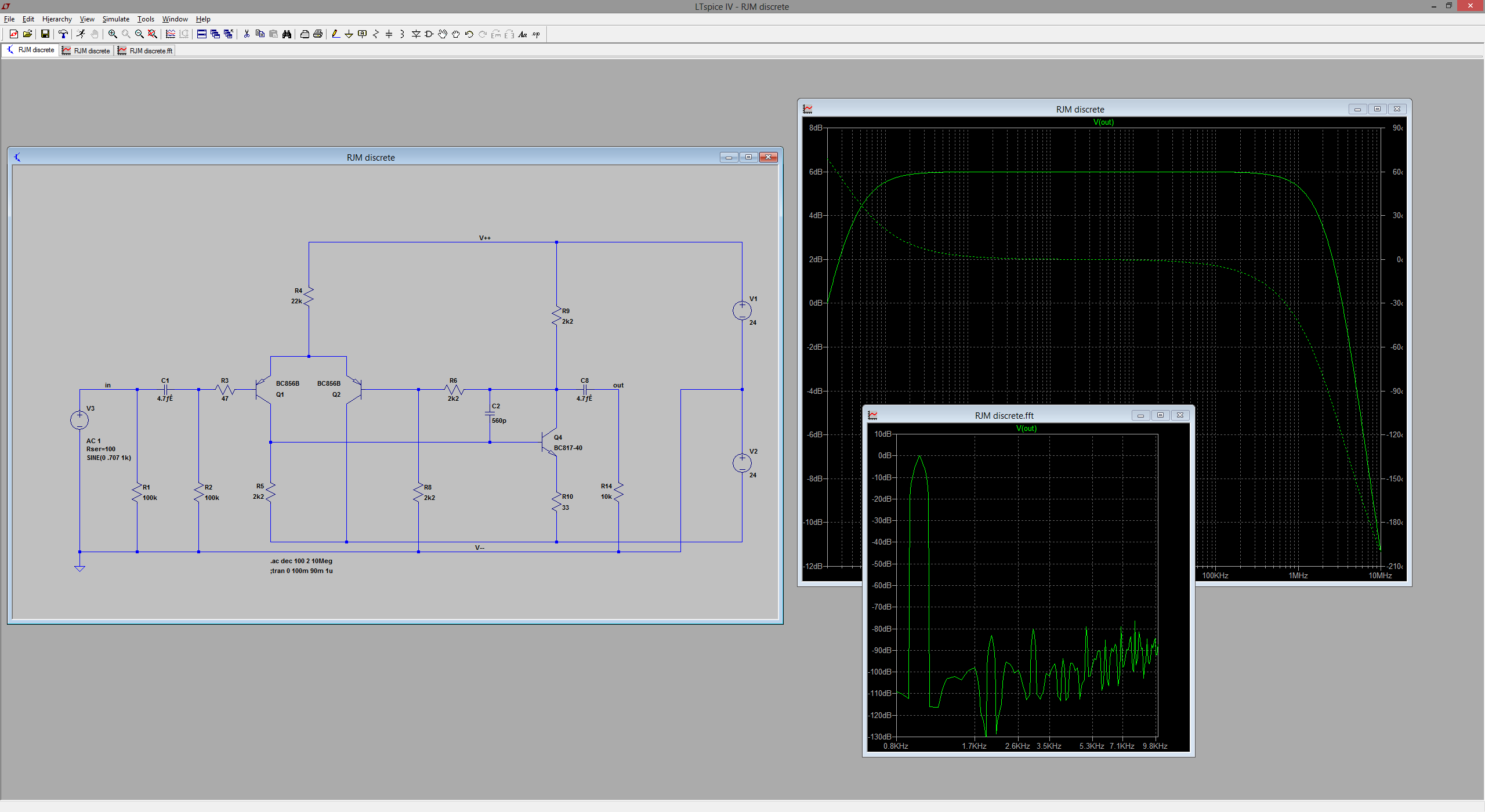

Posted 16th April 2013 at 01:18 AM by rjm (RJM Audio Blog)
Updated 16th April 2013 at 12:23 PM by rjm
Over the last couple of years most of my interest in audio has been with transistors. I've been slowly teaching myself to read and understand the circuits.
Circuits like this one for example. Not hard, but still a bit too complicated for me to understand without the helpful wikipedia markup attached.
Instead I've looked at primarily at the schematics I have for discrete audio preamplfiers, 1970's vintage typically. Based on what I've learnt so far, I've done up a "test mule" in LTSPICE, shown below.
It's not a circuit you should build. It's for pedagogical purposes, though it does actually work reasonably well - in simulation anyway. Its just a simple starting point to observe how the different parts interact under simulation.
