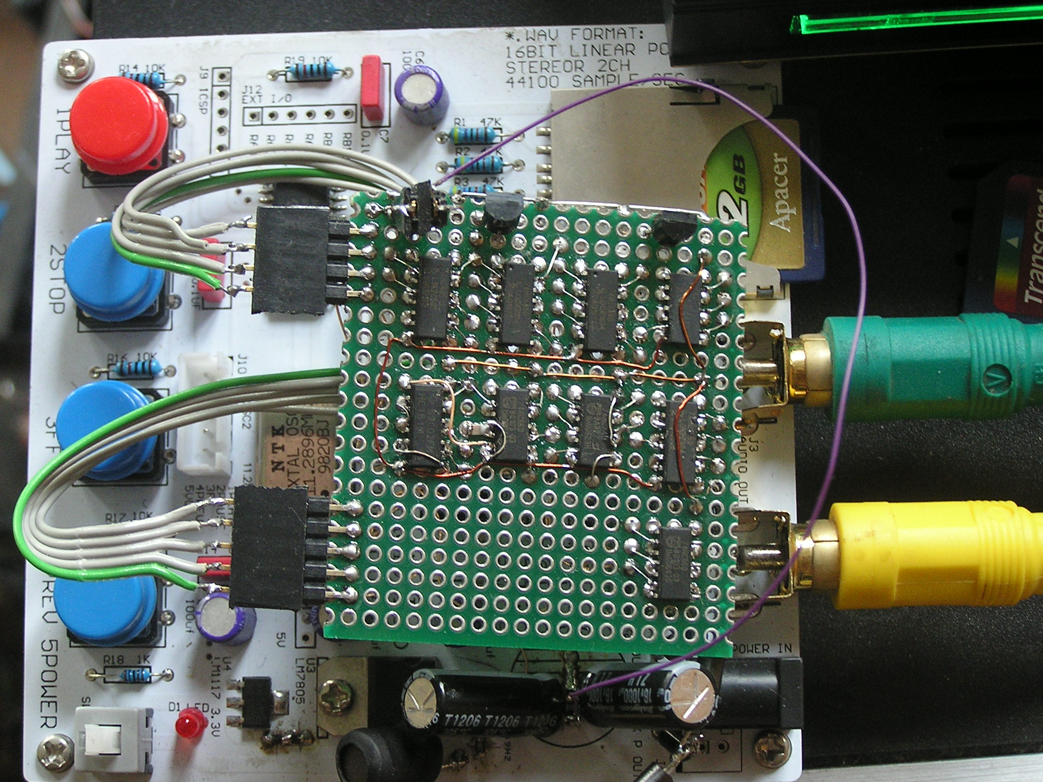

Here's a circuit that's been a long time in gestation - some logic that converts I2S from 64fs (32bits per sample) down to 32fs (16bits).
Almost all the S/PDIF receiver chips nowadays output a bit clock at 64fs (2.8MHz for RBCD) because the format has the potential to support up to 24bits. When being driven from a CD player though, there's no chance of any useful information occupying those spare bits. As my interest is to run all signals as slow as possible to keep noise to the absolute minimum, 64fs to me is profligate generation of RF when 32fs will do the job. But only the WM8805 supports this format and then only when software programmed.
The other reason for wanting the slower bit clock is that my LAID design relies on shift registers and the 32fs clock gives me twice as good utilization of the serial storage - no bits are being wasted on zero padding.

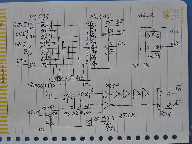

This circuit is designed to do the job with the fewest standard logic chips I could manage it with - 8, at a total cost around $1. The 'traditional' way to implement such a design would be via serial-parallel and then parallel-serial conversion at half the original clock speed but the number of chips needed to go this route would be higher, mainly because latency is being introduced in the conversion to parallel, latency means storage and storage means chips. Here I present a way of doing this 'on-the-fly' with reduced complexity owing to the omission of any conversion to parallel. If for any reason you're concerned about latency (I'm not), then I reckon this is the lowest latency solution
The central core is 16 bits of shift register (two HC595s) with outputs tapped off into an 8-way mux (HC4051). 5bits of counter (HC161 plus a f/f) keep the mux and other logic sync'd to the incoming audio and increase the operative delay on a clock-by-clock basis. The result is a 'time stretching' function on the incoming datastream
Initial listening tests into a TDA1387 DAC give a more involving sound than when fed with 64fs but I'm blowed if I can put my finger on what the differences are. Needless to say I'm not going to feed any 16bit DACs in future with 64fs

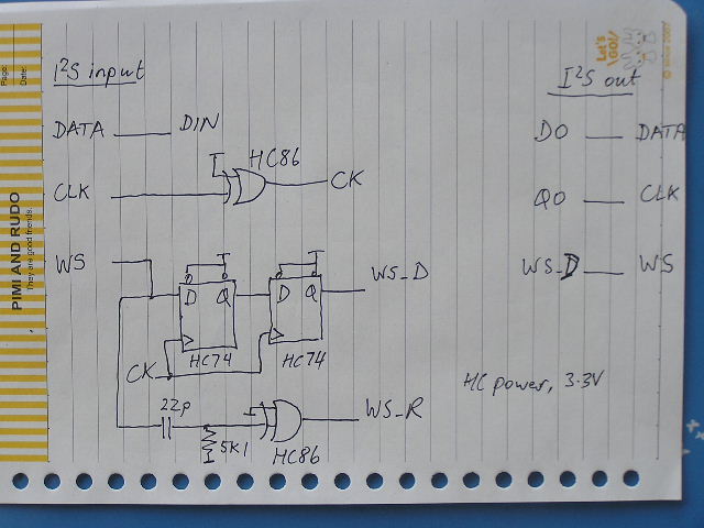

Schematic notes......
IC list 74HC595 * 2; 74HC161; 74HC4051; 74HC86; 74HC04; 74HC74 * 2
For clarity, not all pins are shown. HC74 set/reset (1,4,10 & 13) to logic 1 when not shown. Preset pins on HC161 (3-6) are don't care, enables (7,9 & 10) to logic 1. HC595 MRs (10) to logic1. Unused inputs on logic gates should be tied to 0 or 1.
Update - I've added a photo of the 2nd build - here I've modified the design very slightly to accomodate the EIAJ serial format used by the TDA1545A. One HC74 has been replaced by an HC175 giving the extra cycle of delay to WS. I've also added an HC86 as a buffer stage, so the total's now 9 chips.
Incidentally I just used the SDcard player as a test bed for verifying its operation - I haven't noticed any SQ changes in driving the TDA1543. Recommended for CMOS DACs only

Indeed, the design has a gross error. You’re lucky it works at all. You’re latching the I2S data on the falling edge of CLK. That’s when the data is changing and there is a lot of unrelated circuit noise. The data should be latched on the rising edge when the data is stable and most of the surrounding gates are quiet.
You’re handling of OE1/OE2 is a kludge. A wise engineer once posed this question to me: “When is a clock not a clock?” Answer: “When it comes from combinatorial logic.” TC is not a clock! If you need more bits use a wider counter.
You say you want to minimize circuit noise, RF, etc., yet you have a string of 5 inverters. One inverter is enough to do the job. Relying on propagation times to adjust the timing means the design is broken: Fix the design. Hacks like that have no place in clocked logic.
It may be clever but your transcoder is overly complex and poorly implemented. If your goal is the least number of standard logic chips then you missed the mark. I’m sure it can be done using fewer chips. I’ll post my solution when I have time.Posted 17th September 2013 at 07:52 AM by Tam Lin -
Thanks for the comments - I look forward to seeing your fewer chip design, however I'm not holding my breath. I'm happy with all my kludges, I don't deny they're kludges but my aim wasn't to produce a design which passes muster as 'proper' synchronous logic.
Incidentally its not 'you're' rather 'your' - ironically, this is an example of the kinds of comments you've made about my design. You could patch your English to correct this mistake, just as I could patch my design to address my kludges. I can't see the point though, can you?
Back to your original remark - you still can't see how it does anything useful? Or have you now seen the light?Posted 17th September 2013 at 08:51 AM by abraxalito

The I2S spec says nothing about the data setup and hold times relative to the falling edge of the bit clock. Your circuit could be latching the data from the previous frame, the following frame, or garbage. I say it's not useful unless it works, as intended, with all implementations of I2S. The fact that you had to add an additional cycle of delay proves my point.
