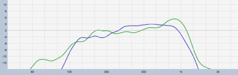

Anyway, here are four 4" mids' raw measurements, on two horn patterns with the same horizontal widths.
Both have the same size ports, both with ports 3.5" from the throat .(measured along horn walls).
90x60 (green) and a 60x60 (blue).
Drivers were different, but i don't think that would matter significantly to the comparison.
(4fe35 (green) & 4ndf34 (blue))
As you can see, both reached 1kHz handily, with the wider horn reaching up a little higher, which runs counter to your observation.
So i'm wondering how you came to your conclusion?

In a nutshell, I'm talking purely about geometry here:
As the wall angle gets wider, the mids have to get closer to the throat, or the xover point must get lower.
I must still not be understanding you. Because nothing i've read, or measured on my various synergy builds, would support either of those two conclusions.
In particular, this is because the Unity design stipulates that the midrange taps need to be within about 1/3 wavelength across their bandwidth.
Yep, although i'd change 1/3 wavelength at all frequencies, to 1/4 wavelength. I think nearly everybody tries to stay under a 1/4 WL.
If you use a wide wall angle, like 90 or 120 degrees, it won't be possible to satisfy that requirement unless you do one of two things:

Why is it more difficult to fit mids on wider wall angles? If anything, the geometry seems a little easier with wider. Or at least it seems easier on the two different horns I'm working with right now, 90 degrees and 60 degrees.
(I could have fit four 5" on either, no prob.)

I included an illustration with my response:
With a wall angle of ninety degrees, and the midranges 9cm from the throat, as measured down the centerline, the midrange taps will be 20cm apart. If you wanted to keep the taps within 1/3wavelength, then your maximum frequency for the midranges would be 567Hz.
It's that simple.
If you intended to use a xover point of about 1350Hz, you'd have to use smaller midranges, make the wall angle narrower, or both.
Or you could just leave it as is; but keep in mind that with the midranges this far apart, it's no longer behaving the way a Unity horn is supposed to behave, because the midranges are too far apart. Not saying it won't work, but it WILL cost you efficiency. The polars will suffer too.
It's that simple.
Yes you did. Thank you. Sorry i was dense and missed that.
