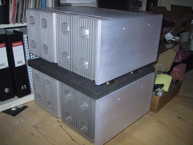

Since the ZenV9 is gonna be a pretty popular DIY object, I have been bugging my friend Magura to actually do something for the DIY community here! Until now with no result. He is quite helpful if you have a danish passport, allright. But if you dont, you can forget about it. I have had the good fortune to use the inductors of his make for several heavy load PSU's, and they are perfect for the job. No noise from them, the guy knows what he is doing😉
What I have been bugging him about is a chassis kit with heatsinks, suitable for a stereo ZenV9. The guy is capable of doing a thing like that, but he never wanted to. I think that I might have him persuaded🙂 What I had in mind is something like the chassis I used for my A-X's, only a little wider to accomodate a stereo amp. Take a look at the pic🙂 I have had him talked long enough into this, so I dare to post about it🙂 The heatsinks with fins on both sides is simply the best you can have. I am pleased that he said it would, just maybe, be possible to make a few chassis kits to someone who wants it🙂 I wanted a chassis like this for my ZenV9, and couldnt resist to talk Magura into a thing like this😀 Looking at his backyard, he really needs to get rid of some of all that stuff anyway😉 (dont tell him I said that😀 ) This is not a group buy, its not a sale or anything like that, I just wanted to mention it for those of you, wanting to build an amp with adequate heatsinks. Send me an email if you are seriously interested, and I will see what I can do.
Steen🙂
Steen🙂
