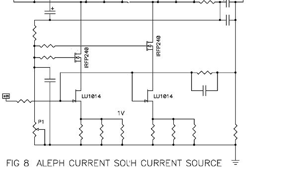

No problem paralleling as you show except that the input
capacitance is increased, and to keep the same bandwidth
you need to reduce the impedances in the feedback loop.
Also, you can parallel Mosfets without paralleling Jfets -
just watch the dissipation on the Jfet.

Mr. Pass, thanks for your reply.
And if I would lower the voltage to get a higher bias current at the same heat dissipation, does this affect the non-linearity as much as with the Aleph amps? I read you didn't like to go much below 25 volts (+ and - each) because of these non-linearities due to the capacitance.

dr.strangelove3 said:And if I would lower the voltage to get a higher bias current at the same heat dissipation, does this affect the non-linearity as much as with the Aleph amps? I read you didn't like to go much below 25 volts (+ and - each) because of these non-linearities due to the capacitance.
This circuit likes voltage even more, since it has losses due to
cascoding.

Thanks for you reply Mr. Pass,
So lowering the voltage isn't such a good idea...
And if used a mosfet in the cascode that is meant to operate at lower voltages like the irfp044 or irfp064n?
These devices should be more linear at lower voltages.
And the input capacitance of these mosfets (especially the irfp064n with 4000pF), is this of any influence in your cascode design?
